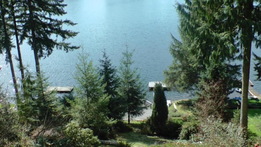

We bought this house that has a lot of nightmares that need to be fixed. The landscaping is in bad shape and so it the house. Hence, I need a tractor and a pack mule.
Some of the things that need to be done are:
1.Inside house demo, and haul everything up hill to the dumpster. You cant see this but the slope goes way back beyond the house. I would have to carry bricks, demo'd decks,tools, appliances,wood stoves, everything up hill!! You cant park a car next to house.
2.footing drain for foundations.
3. build a path to lake ( it is traversed, would need to expand, and gravel the path.)
4. fix retaining walls.
5. build retaining walls
6. More retaining walls
7. Have I mentioned retaining walls yet?
8. use front loader for a gazillion different things including lifting and fixing dock.
Where the house sits is steepest part of the property. I would need to do a ton of work, just to fit a tractor on the lake side of the house. Everything is blocked by walls,fences and landscaping that would need to come out or down.
I would cut by the house to make a little less steep and then need to bring in a little fill Once I could get to the traversed paths I think I could widen and bring in some gravel.
The wife thinks I have lost my mind and this is too steep. I just want to post this for initial impressions of BX25 owners.

Pictures are hard to judge as far as slope - but that would be a huge no no on my pucker factor !
I bet you have a 4' level around, take a part of the hillside - maybe one path that the machine will be on,
stick one end on the hill and level the level,
measure straight down while level,
then divide by 4
this will be the rise and run of the slope.
you measure 20 inches vertical ........dividing by 4 gets you 5......that would be
to convert that to decimal : look at chart .....
a 22+ degree slope .......
once you start going up a 4.5/12 ........you best have a bucket full
I have about that on my side yard - NEVER took the BX up it, have backed up - have gone down.......now the B7100 goes up it like a billy goat, then again it doesnt have a hoe on the rear or a bucket on the front!:)
listen to your wife this ONE time !!!!!!

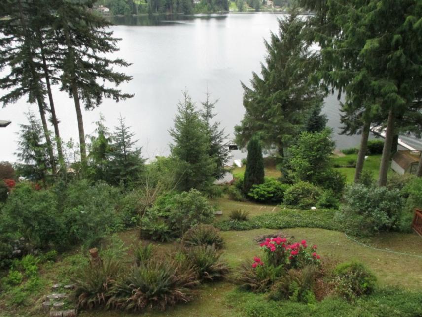

That's a beautiful spot you have there! So the lake house is built on a foundation or crawl space? Or is the drainage work for new retaining walls?
If the drainage work is for the house and you have a basement I would opt for installing a French style drain around the interior perimeter. Drain it out of the house where you would have to do the least digging. Installing a moisture barrier inside, draining to the French drain, and insulate it with spray foam or foam board. Grace Ice and Water Barrier works great for that. I roll it smooth on the foundation walls applying heat to help it stick from a heat gun. It wouldn't hurt to paint some Comproco Seal onto the concrete as a first step, awesome product. They also have a primer that goes on first and a bonding agent to mix the seal up with. Doing all of this on the outside would be best, but in all reality, it's going to take you a very long time to dig with a bx. That's a lot of earth to move including shoring up the ditches. The safest way is always the best way! Just something for you to think about.
Building retaining walls are a ton of work in easy conditions. Your conditions are far from easy. It seems like there a few nice ones already there judging by your photos. A lot of folks in your situation build stairs of some sort for a path and plant landscaping that takes care of itself but looks good. Something with a solid root base is good for holding the ground together. Why cut grass when you can fish :D? It can be done with series of side cuts starting from the bottom working your way up. I've built my fare share over the years and it that environment you need some serious equipment or some strong help. It's easy to dig it out, Harder to move the dirt your removing. Worst case scenario, dump into wheel barrows and wheel them out...
Cutting a nice path down in a S pattern would look nice too, especially with stone walkways.
My family did this stonework a long time ago, picture doesn't justify how difficult it was to build this, there is much more beyond this photo. The Goshen stone wall is 6' thick and is built at roughly at 75 deg angle to hold back that hill side. Extensive drainage work, half of the stones were so big we had to set them with a With a big JD trackhoe and a JD skid steer. The pool area is all Blue Stone including the hot tub and it has hydronic radiant heat everywhere and is heated in the winter. That was when I was strong young lad, my back hurts thinking about this now!
[/URL]
