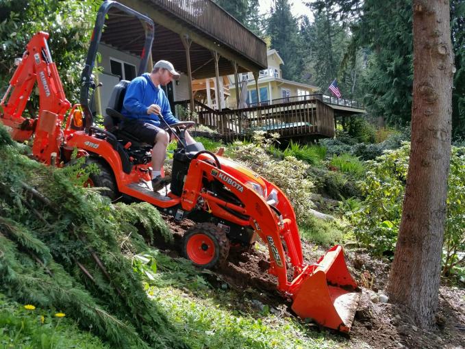

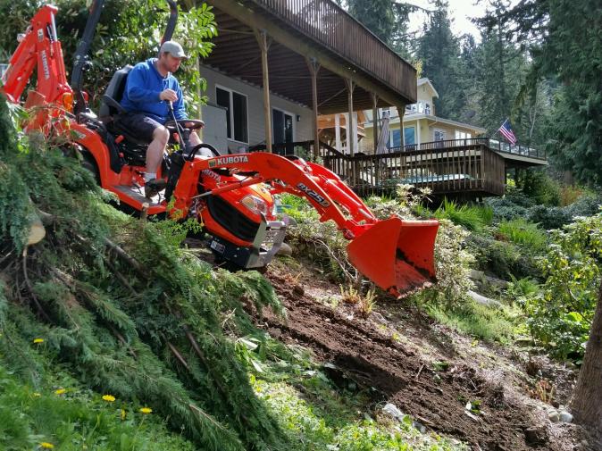

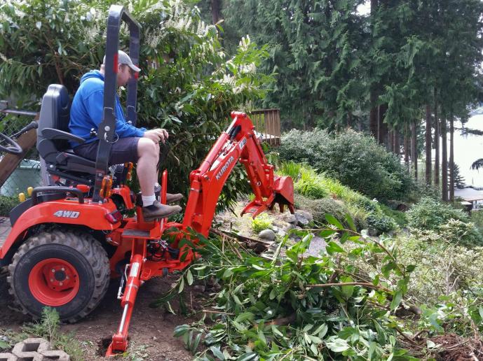

Well I finally made it past the house and on to the slope. After removing a brush stump, I made several slow and progressive passes going further and further over the slope to compact the soil. It was going well until we ran into some large rocks mid slope by the tree . My tires end up digging in and spinning. My biggest issue was the safety switch in the seat. In order to keep the engine running, I needed to put my left foot on the loader arm to keep myself back in the seat. Works great, but prevents you from pressing the already difficult to reach rear diff lock.
Oh how I wish the diff lock would stay engaged, and the switch was more sensitive.
We ended up winching the tractor up the hill with my buddies jeep. I then tried to back down the slope thinking the backhoe over the rear tires would help with the climb. Once again, the rocks in the slope caused issues. With a little persistence and friend in the bucket, I was able to get back up the hill. A little girl and gymnastics consumed the rest of the day.

Your picture 1 of 3 reminds me of the Safety Officer who showed up on a construction site wearing a ball cap with the "Work Safe" logo across his fore head.
Every worker on the site was wearing a Safety Hard Hat, that was the last day on the job for the safety officer.
Trust your jeep buddy has a little more fore thought maybe he can make some sense of the situtation, and he knows how to wear a SEAT BELT.

Your picture 1 of 3....
the same one that shows the outrigger buried and creeping down slope?
The pics you posted could be used for safety training.
I think you mentioned many years of operator experience. At this point I can't figure out if this post is to shock readers, or to impress others?
Everyone should make note to never operate a rubber tire implement in such locales.
