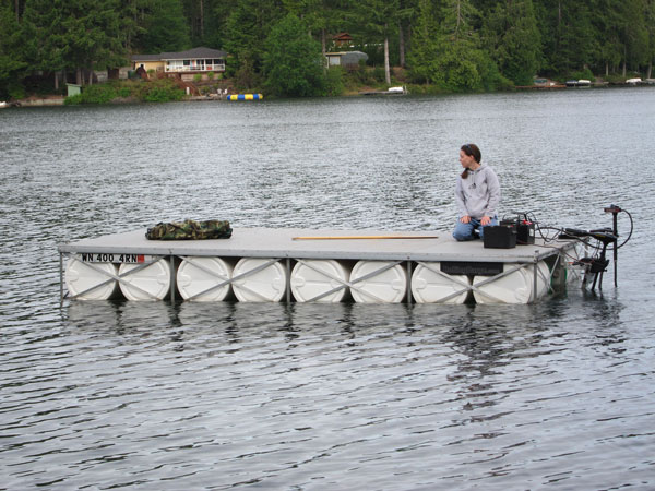

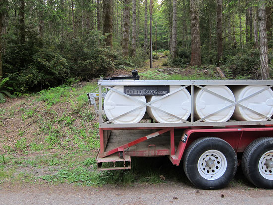

One other thing to consider is the lake can actually be your friend. If it has a launch ramp, you could barge things back and forth from it. We have vacation property on a lake and due to the steep slope that is what we do. Only electric motors are allowed on the lake so it takes a while when moving heavy stuff but it works out well. We just use several of them. The link below shows what we have. It's super stable, no maintenance, carries a ton of weight, and has the advantage of also being mobile. LOVE IT! Also, the "dock" gets licensed as a boat so no dock or shoreline permits are needed!
http://rollingbarge.com/

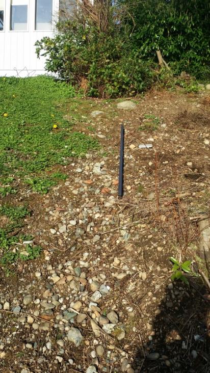

A few more pics, unfortunately it is much steeper than the pictures appear.
The bx will go up it and down it - using 4wd in both cases, and I am not talking about grip - going down you need it for brakes!!!:D:)
As far as sideways............can I get a heellllllllllllll no!:)

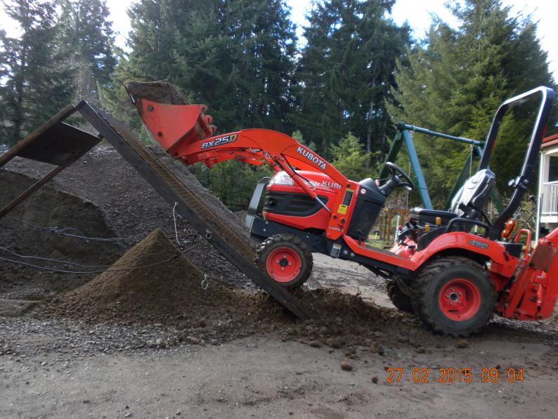

Here are the results to some work the BX25D has been doing on inclines
10" over 48" no problems, 12/48 still good, 14/48 this is working incline for most of the work, and 18/48 well what can I say, it better be short and sweet.
Kubota's office literature for steep inclines states a 20 deg. angle of departure for backhoe attached for loading and unloading on trailers (and in my case for the soil screener).
Oh, did I mention this is for up and down slopes NOT cross slope and as previously mention heeeeeeellllllll!!! is critical (soil conditions, weather, satuation, and SEAT BELts.
