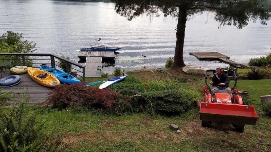

You state your lack of control here, what else do you need?
"My biggest issue was the safety switch in the seat. In order to keep the engine running, I needed to put my left foot on the loader arm to keep myself back in the seat. Works great, but prevents you from pressing the already difficult to reach rear diff lock."
Do you think rolling is the only problem?
When your machine slams into a tree where will you end up?

Ditto on the last two posts. Most contractors doing that kind of work will use an extended reach trackhoe and lay the stuff in. And attach a cable to a tracked skid steer to get it down to a lower step to work. Most folks will tell you your crazy for what your doing. I've fetched numerous pieces of equipment out of ponds, lakes and such that had milder banks then the one your working on. Couple of folks have died in the process cause they either got stuck and drowned or crushed by the equipment. Got a good friend that had to learn how to walk again after his pelvis was crushed by a rops. Required both hips to be replaced!!
Then on top of it, you have a piece of equipment that could potentially end up going into the water running. Costs around $8k to 10k to get a motor gone through afterwards. Then EPA fines for any oil and diesel that ended up in the water. Recovery costs, which usually will double or triple when the state steps in and makes you use there "approved" contractor.
Your playing Russian roulette with your future and your family's my friend. And seeing those pics scares the daylights out of me ;)

Flienlow,
What gets me is how you came on here and asked everyone if they thought it was too steep, and everyone said yes too steep and dangerous, and you still chose to disregard it.
I'm sorry to say this, but are you just that stubborn or have a big red S on your underroos and think your beyond experience and the laws of physics.
You have already stated that your doing reverse wheelies to get up the hill and that you've had to winch it to get it back up the hill. Both are severe indicators that your doing something that you shouldn't be doing!
You asked D2cat what's going to happen, here is my prediction.
I would say the ground is going to give out, and/or you'll lose traction and either it's going to run away down the hill or it's going to slide sideways and all heck is going to break loose!
Please take video of it as #1 your surviving parties will be able to sell it for a safety video on what not to do!
I'm really holding back what I really think but sadly I think Darwinism is going to take effect at any moment! :rolleyes: and that will be a sad waste of a good tractor.:(
For others out there reading this, DO NOT DO THIS!!! It's just a matter of time before it will get you or someone else seriously injured or killed!

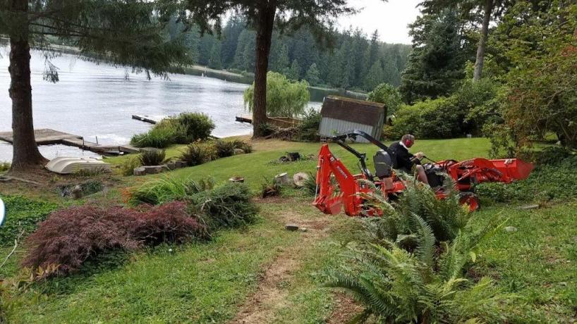

As someone who worked in the Engineering Division of the King County Building Department for years, I have seen MANY slopes slip after work like this. As mentioned above, BEFORE you continue "improving" the slope I'd STRONGLY recommend consultation with a Geotech.
Sorry, but given the history of the area and the type of soil I see in the pics, I CAN'T fathom why you're being stubborn and insisting on doing this without careful planning. Then again, it's always interesting to see the results on the news... Not being negative, I've just have seen it happen more than once.
I'll never forget the guy I warned on Lake Sammamish about doing something like this. He was an attorney and was very cocky. A couple of weeks later, I was called to the site because there was a huge sediment plume in the lake and of course helicopters were shooting footage for the evening news. It was on every channel and the guy received huge fines... Served him right! LOL!
Depending on the size of the lake, you also likely need a shoreline permit and will be fined if Sno County finds out about the work being done without a permit or engineering review. I think the setback is 200' from the high water mark...
Also, in the middle pic you posted, if you look carefully the bottom 6' or so of the tree, it is leaning downhill. The tree corrected itself over time and continued growing vertically. WHY DO YOU THINK THE BOTTOM OF THE TREE WAS LEANING TOWARDS THE LAKE? Think it was an accident or it was planted crooked? HMMMMMM..... I'll give you hint - UM, NO. Trees do that WHEN THEY'RE HOLDING BACK A SLOPE THAT HAS MOVED!
I hope it all goes well and you achieve what you're trying to do without getting hurt. That is most important.
Don't say you haven't been warned regarding the other stuff. You must have lots of money...

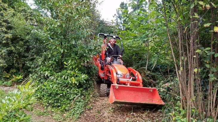

First off, I don't claim to know what I'm doing but I can tell you what I did and how diffucult it was. Based on the pictures it would appear that my front yard slope is less than half of what you have going on there. I know my slope doesn't look like much in these pictures but it doesn't take much to make a loaded tractor roll. I had a bunch of red rot 100ft pines removed and was left with a mess of rock/small trees/grading and drainage issues. I tackled it with my BX and it was a scary experiance at times. I lost count over how many times I picked up one or sometimes both of the rear wheels and only a combination of equal parts quick reaction and luck kept me upright. If my hill was ANY worse no amount of skill or luck would have saved me. Oh...and my target was only a 2ft deep stream, not a lake.
In all seriousness, you are asking for a disaster with the pitch of that worksite and it's not an if but a when you slip up and roll it.
Even if you do get what you want done, the runoff coming down a pitch like that will get scary fast. The power of gravity scary but the power of gravity and water will relocate your house in a heartbeat. I had a hell of a time keeping my topsoil in place and even had issues with areas I used stone on to help hold it together.
No one here is trying to be a buzzkill, we all like to do everything ourselves but you got to know when to walk away and call a insured professional with the right equipment.

We made it down the slope yesterday (or at least the steepest part.) We stopped at an area that will really need to be filled in order to proceed further. Did the tractor go back up the slope? yes it did, however in order to make this path feasible it would need more than just gravel and will quickly grow beyond the scope of what I want. If this was say a B7100 with big lug AG tires, it might of been easier to do, however as you all are painfully aware the slope is sill very steep.
All is not lost, I have a path to back side of my house for ingress of hot tub,and can start fixing foundation drainage among other things.
From my perspective the tractor operation was anticlimactic. There was no slipping, sliding, or out of control. More like just a loss of traction when trying to go back up. The machine would just spin and dig in. I will say that bucket down hill is the safest, and if I didn't have the hoe on, it would not be a good idea to go up that steep of a slope with FEL only.
I share this merely to chronicle my experience. I am not looking for praise or accolades. In no way do I advocate ANYONE trying this. And it is very fair to say the responces to this post and been filled with sage advice.
I have been operating these type of tractors since 1978 when granddad first turned me loose on the his craftsman riding mower. I say this not to justify it as being a wise choice, but to merely say that it wasnt done without significant seat time.

WELL... Time for an update. (And it has been a while.) Tonight I finally concurred my nasty hill. (sort of) After a year, a bunch of dirt, gravel, buying a 4x4 Quad and extreme patients, I got my tractor down the hill to the lake.
I decided to buy a cheap quad to "beat" a trail in. I use it to haul boat gas, beer, and my fat @$$ up and down the hill. It's also great to cruise to the neighbors house ect.
As far as the slope, I created an "S" type trail instead of going straight down or using the switch backs which were way to narrow. The big win was when my neighbor needed to dig out underneath his house to fix the poorly built foundation. He hauled out about 12 yards of fantastic fill dirt and put it in a very low spot. After that I used the quad for several days going up and down and finally built up enough nerve to get the tractor out. (I was also prompted by my buddy who is a 4x4 nut and loves this kind of thing.) The BX went down the hill without issue which was never my concern. Going back up was a much different story :) First I blew the bead on the front tire.we got that fixed pretty quickly. Then we also found a drainage pipe and broke it as it was only 2 inches from the surface ( tomorrows project.) Then there was getting back up the hill. It drops off pretty steep after the fill area and we spent the most time, driving up spinning out and then back down and trying again. After numerous attempts we made it back up. Now I will need to move the trail over to avoid the pipe, and imports some more fill and tune the trail some more. Since I have several more pressing projects, this will go on the back burner until I get time. I probably wont start my retaining walls until next year anyway.
