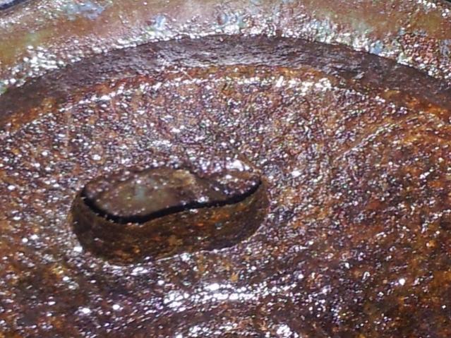

Can you clean it up with a power sander or fine grinding disk to see if you can make out the shape of a cross pin or grub screw?

Slow down boys!
Always so quick with the grinders!
John, I'm working on posting some pics for you so hold off for a bit if you would...

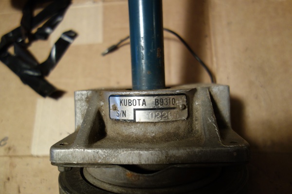

Greetings John,
My hat's off to you regarding your beautiful work thus far!!! Amazing! I can only dream of being able to work sheet metal like that.
You might want to know that the PTO assembly you're about to cut off is as rare as hen's teeth. It is no longer available from Kubota and has been discontinued for a long time. You will need that assembly if you ever want to run anything from the front of the engine (think mid-mount mower) and that shaft in particular is VERY tough to replicate. It's not the shaft that is the tough part, it's the odd number of splines that is nigh impossible to find. I searched for a long time to find one...
What happens with these is they don't get greased as they should and either seize to the shaft and likely the crank just like you're dealing with. Sometimes the splines themselves bet buggered up from no grease, but one never knows until you get them apart.
You likely already know this, but I would not recommend prying against the front cover because you will likely crack it as its only made from aluminum.

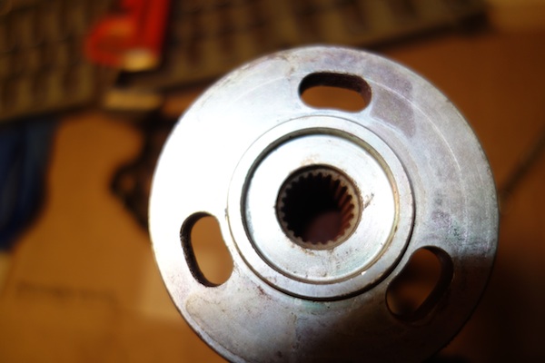

I tried to remove my hub from the shaft for these pics but mine doesn't easily slide out either. I can feel it moving ever so slightly, so I know its not seized. I put it in the press and took it up to 4 tons of pressure and it still didn't want to come apart. Not sure if Kubota pressed it in hot, but I think that may be the case. Honestly, I didn't want to put more pressure on it and chance destroying it because there is nothing wrong with it.
It should come off the end of the crankshaft more easily and that is where I'd focus my effort. If you can remove or cut off the three bolts that hold the flange to the front pulley, you might be able to jury-rig something to pull the entire assembly straight off the end of the crankshaft. The other option would be use a bigger hammer...

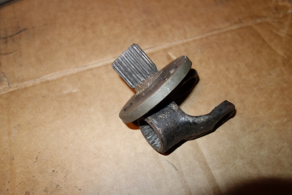

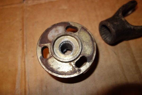

The pics to follow show the front PTO assembly from a B7100 as well as what I believe to be the same crankshaft pulley and u-joint taken from a B9200. I hope they may be of some help.
Finally, I'm not able to see any roll pin or snap ring holding mine on either.
Again, save that front PTO assembly if you can!!!!!!

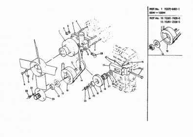

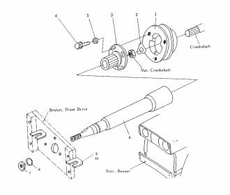

I found these exploded diagrams on the Kubota site. Doesn't look like there is anything holding them together besides either rust or metal shavings...
Hope these help!

If you'd be willing, it would be very interesting to know if your flanged hub will easily slide out from the end of the shaft. If it did, and we could get pics of it, it would give John a better idea of exactly what he's dealing with.
I'm now very curious about mine and would like to get it apart just to have a look. However, I really don't want to chance buggering it up...
Also of note, Kubota added a zerk fitting for greasing the splined end of the shaft on the B9310 parts diagram. Mine does not have that grease fitting. Perhaps they figured out that the lack of lube was causing the problem we are running into.

Steve , the adapter boss slides onto the crankshaft pulley but is a very tight fit even with lube it needs a good tap to get it on the shaft, and even more to get it off and both sets of splines are perfect.
From where i am looking there are several issues going here, none off them are really ideal and all of them are connected.
1) the outer sleeve of the pto shaft appears to be very badly salt water/air coroded and looks to be rusted solid to the adapter boss's splined shaft.
2) The Adapter boss also looks to be in same condition as above and rusted to the crankhaft pulley wheel, bolts could be cut off or ground down in an attempt to get the pto shaft and adapter boss off in one peice.
But, there is a strong possibilty that the spined shaft of the adapter boss may be rusted solid to the crankshaft pulley shaft in the same way.
3) The previous problem may have a direct effect on the 3rd option.
If after cutting/grinding of the 3 bolts the boss cant be shifted, then the crankshaft pulley whel nut cant be removed , thus that cant be removed, leading to a possible replacement of the pulley wheel.
these are prob worse case, but you should still consider the options carefully on this, as things never go acording to plan in this life.

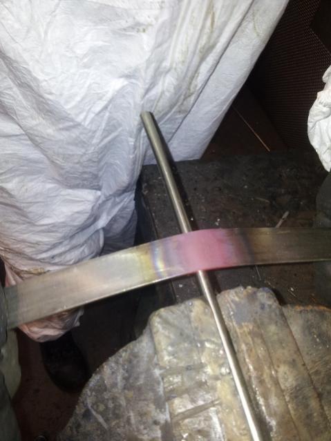

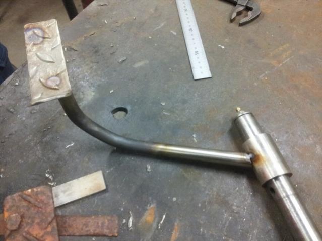

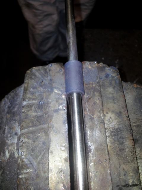

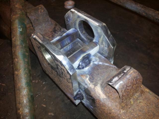

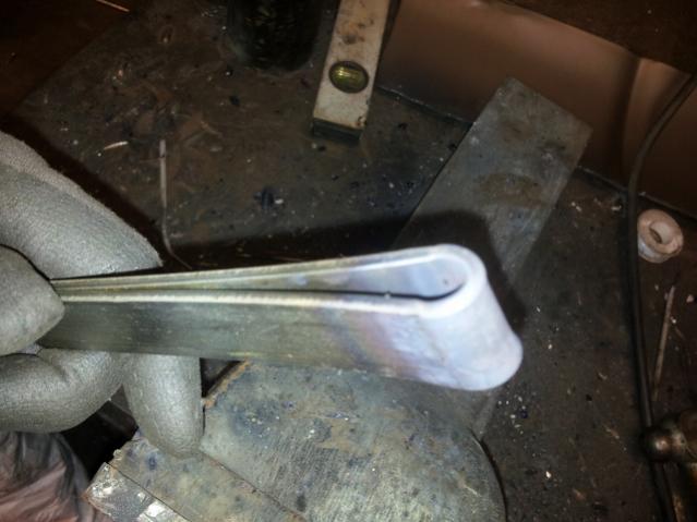

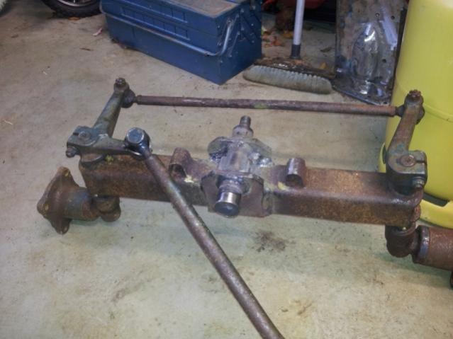

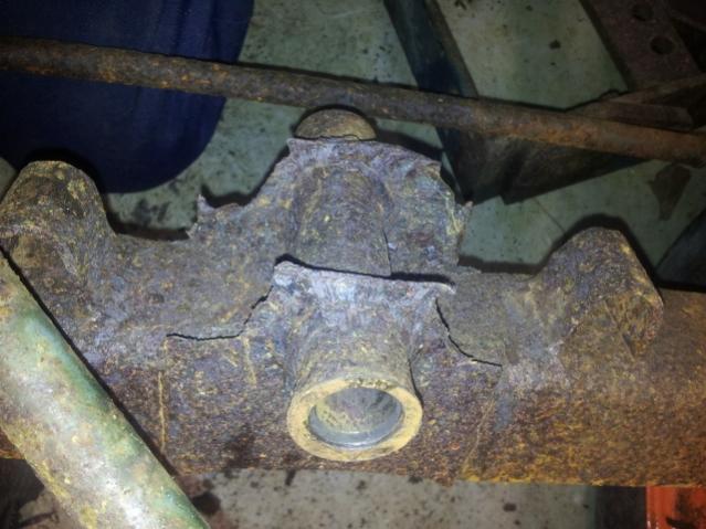

I have kept going on my stainless revival project.I redid the pedals and finished off the welding on my axle before and after pic's.

Nice work on the pedals and front pivot!

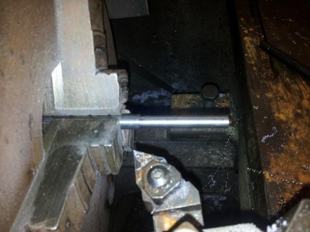

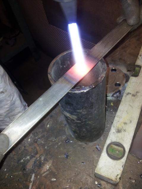

phone went dead for the main pedal making bit but this is what i have
