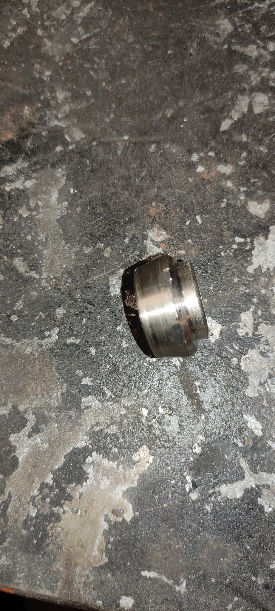

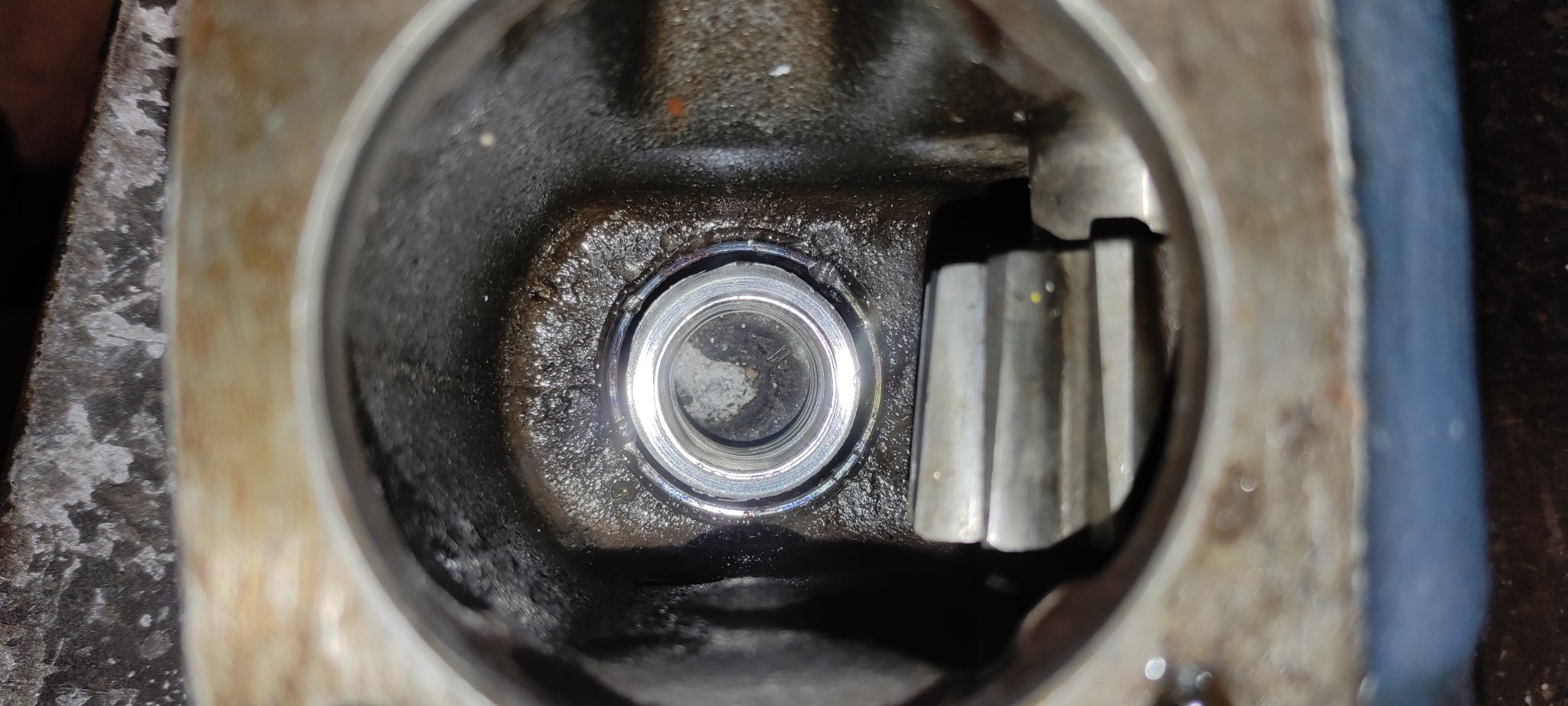

Repaired the my PTO seal only for the repair job on the steering box to give up again. So I bought a repair kit on Amazon. I had pressed a bearing in there ages back thinking it would be staying there. 😢. Tricky to get out . Tried heat..tried pullers but couldn't get a purchase. In the end I turned down a 16mm nut to the shape of the old bearing and welded that to the shell. I then used a tap to press out the shell. Repair then was straight forward. IMG_20250223_003753.jpg IMG_20250223_004929.jpg IMG_20250223_004944.jpg

I Tested it then in the field. It worked perfect . Using it with a 5ft rotavator . It's too big for this little tractor but it gets a good work out trying.
