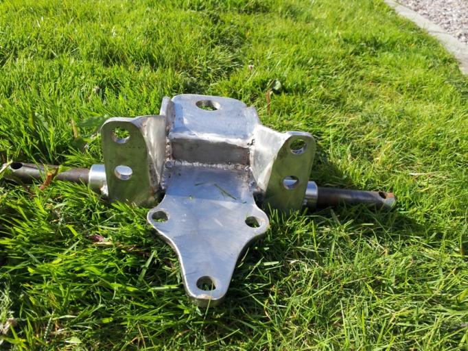

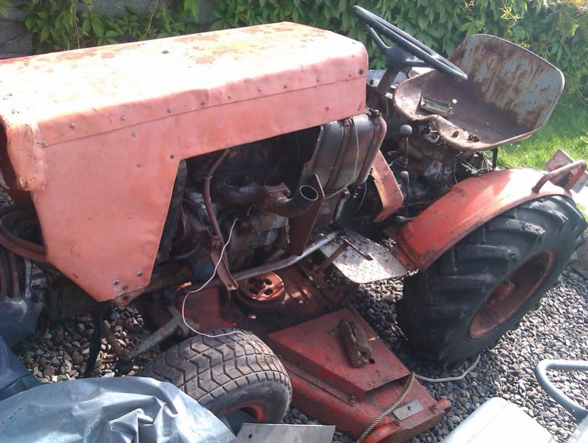

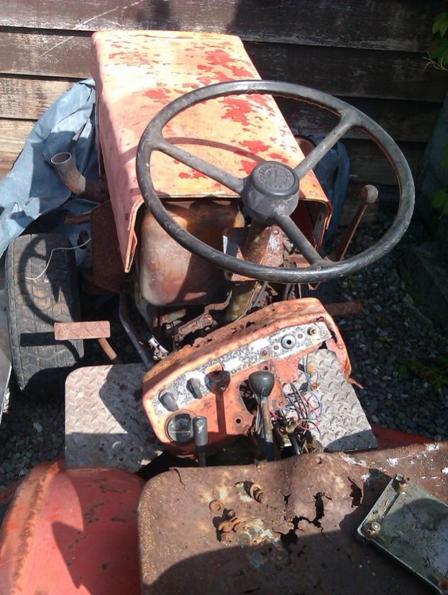

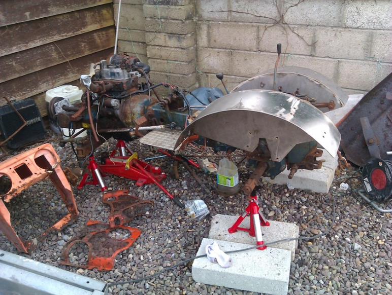

My poor kubota has sat on a wet damp west cork Island in Ireland for 25 years before my uncle handed me the keys.There is not much left that hasnt rotted passed repair,but I am going to ensure it never rusts again.Where I can I'm going to replace parts with stainless steel.Why? ...I dont know, sentimental value maybe..I learned to drive on it a long time ago.
My aim is to do it thru innovation and as little monetary investment as possible,over this side of the water parts are hard to come by and very expensive when you can get them.......I dont know will this thing even start, saying that Ive been hooked on this little tractor so I know I'll get there!!!!.Progress is slow but here are a few pics so far.Ive managed to make new mud guards,new battery diesel tank holder and rebuilt part of the radiator fan cover all in shiny 316L.

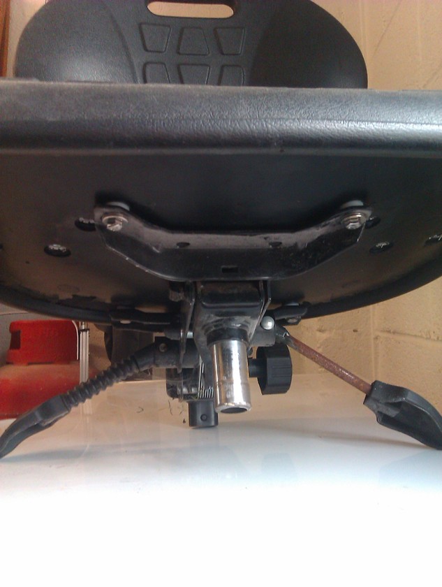

Not sure will it work, but this is my attempt of a new seat.I found it in a skip.It was one of those telescoping self raising office seats.I chopped the shaft on that and fabbed a bracket to take this and to bolt onto the tractor.

Looks like we have another expert fabricator in our midst fella's!!!
Stainless even. I never was any good with stainless.
Oh and welcome!
8,075
3,411
Are you sure this tractor wasn't recovered from the Titanic? :eek:
That is one rusty tractor, and that hood certainly wasn't original. Nice fab work, can't wait to see it finished.

Great work so far. Looks like we have a stainless steal artist here. Are you going to copy the hood or create your own design?

Wow you're good! I've always like the idea of a Delorean better than the execution. It was never going to rust away but the motor was an expensive paper weight and the handling was mediocre. I've only seen the US version though. I applaud your efforts and it looks like that tractor is in dire need of it!
You must have some neat toys too, show us the workshop! What do you weld with? I've got a little air cooled Miller TIG that I pretend to know how to use some days.

Thanks guys,yeah its in pretty bad shape alright.But when you get those encouraging comments it helps to knuckle down and do some more.I started this project last october,having never restored anything before I have been tackling the small bits to redo first.My confidence and will to get this thing done has been growing after each little milestone.I Keep telling myself its like eating an elephant,1 bite at a time.The gear I have is :a good size anvil,vice,air cooled tig welder ESS 211ATG,set of oxy/acetylene bottles and I have the ocassional use of my mates lathe.
As for the hood I'm not really sure what way to go,I was toying with the idea of modernizing it with newer looking headlights and whatever else goes comes to mind,but the easier option is to follow the poor copy I have and try make it better.What do ye think??

As for the hood, if it was me I would build a grill shell I liked first. Then it would be much easier to go from grill to dash and then build side panels. you could make the hood hinge at the top of the grill shell or at the bottom as factory does. its up to you. when building a custom anything nothing is wrong, unless it doesnt function when its suppose to. Your the designer, make it the way it makes you happy. I think you have some great skills, keep up the good work-just keep us posted on progress.
