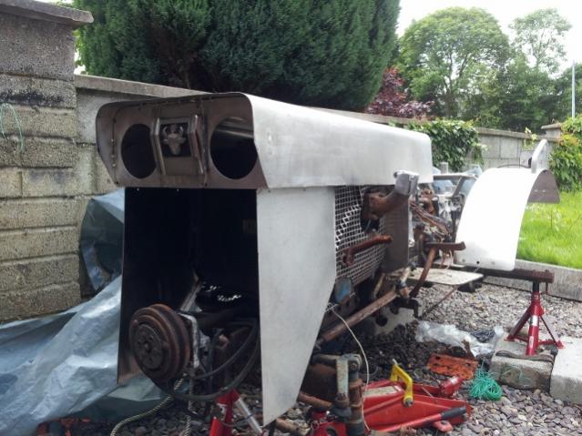

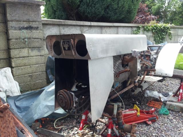

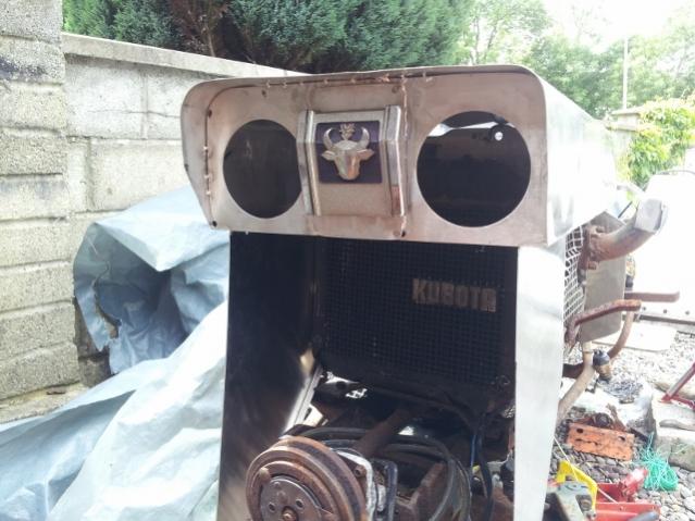

Thanks Aardvark,I got the bonnet almost finished I put 100mm holes in for the lights,my thinking was that that was a standard size.Guess when i go to buy lights I'll find out.I might take you up on that offer for a few pics of your B51.But for now I'm still waiting for it to stop raining here.In june alone 228mm of rain,thats 9 inches of rain in one month during the SUMMER WTF.July is heading the same way.If summer is going to be like this then Im lucky this thing is made out of stainless. http://www.met.ie/climate/monthly-data.asp?Num=3904.

OK John. I tried to find the old thread where the 5100/6100 headlight issue was discussed but couldn't find anything useful, apart from people who had no luck finding a cheaper alternative to the Kubota item also tried LED spotlights and LED bulbs in original Kubota units. The bottom line is the dynamo only puts out a paltry 10 amps so don't go for anything that sucks more than 35 watts per bulb. Good luck.

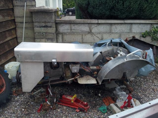

Wildfire,I'm humbled that you you have enjoyed the post.Its because of you and the likes of you on this website that I have attempted this project.I was making so much progress up till monsoon season!!!!.Its depressing looking out at my stainless project turning greeen with mould.I have landed the bonnet up loosely on the frame.Needs plenty more work but its a start.

Thank you John for your kind words. I know what you mean about the stainless turning green but at least it won't rust out. Maybe if you waxed it or clear coated it or just spray some light oil over it when it's parked. That would stop it from turning green ;)

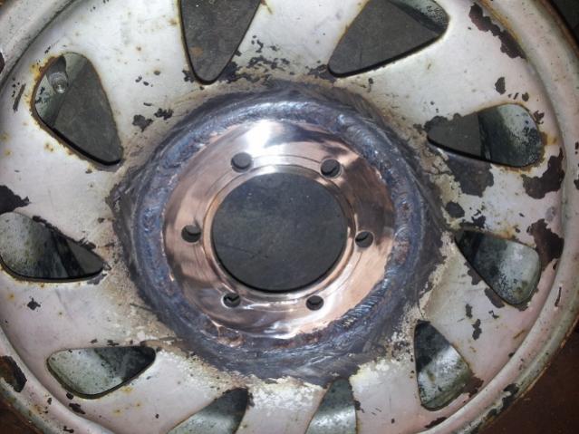

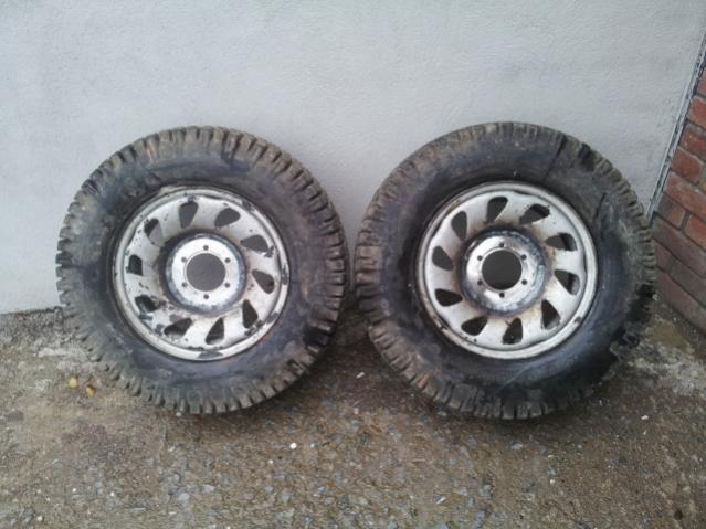

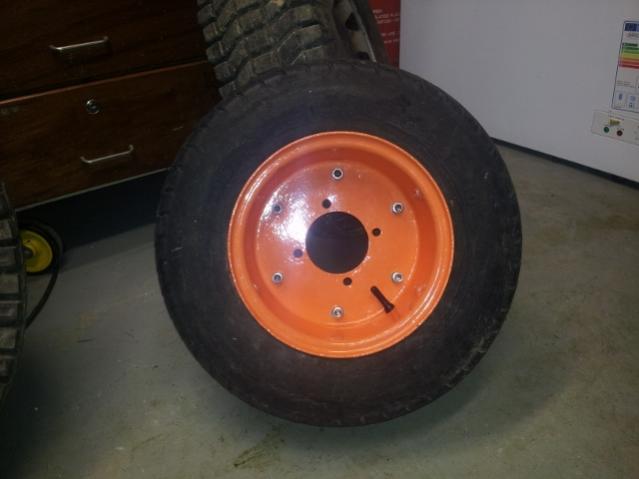

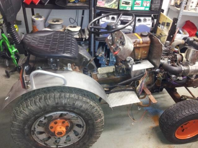

Alright boys,I'm back in the game again.Built a garage to house my little shiny tractor so there's no stopping me now.I have continued with my drive to spend as little as possible to get this thing back in the field.....Mean Jean gave me a great idea on how to replace my shot rear wheels,painted the front ones after a bit of remedial work.See pics below.I have fired up the engine,started after a few turns, very little smoke and no unwanted noise.great stuff!!!The one thing I did notice is that my clutch pedal doesnt seem to be doing anything.possibly seized,possibly hasn't worked in years I dont know.Looks like I'm splitting the engine and gearbox next to investigate the cause..Hopefully it isnt anything major.

Thanks lads.I was hoping once I get this clutch back together that I would begin to rewire then rebuild.......just spotted that where the front axle is bolted on is completly corroded....barely hanging on:(.Continue strippin i guess.I'm going to know every bolt on this little beast.
