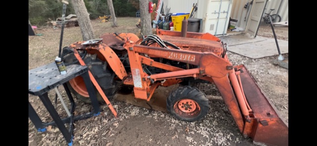

Recovered B8200 - Found abandoned

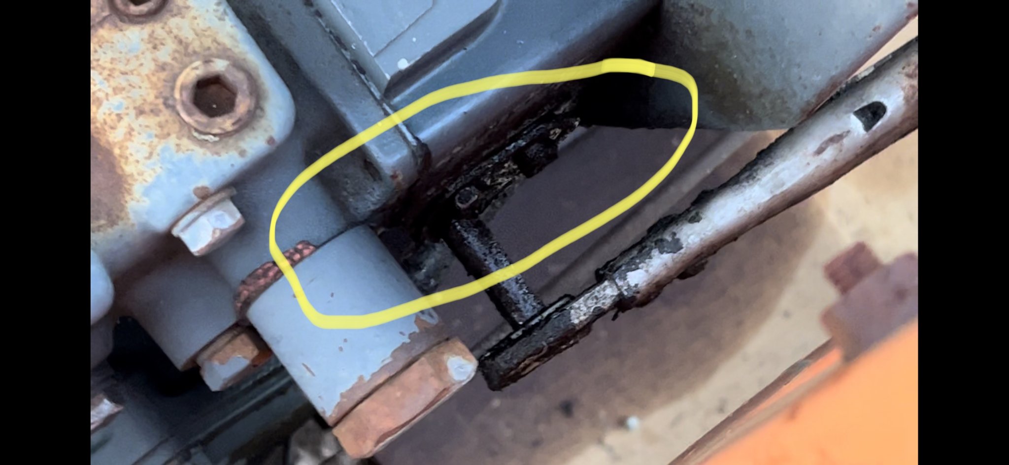

I have a couple of leaks that are contributing to why the machine has no hydraulic fluid on the dipstick.
This is the 3-point hitch lever area:
Don't be overly concerned about those leaks. They keep the rust down! ;)

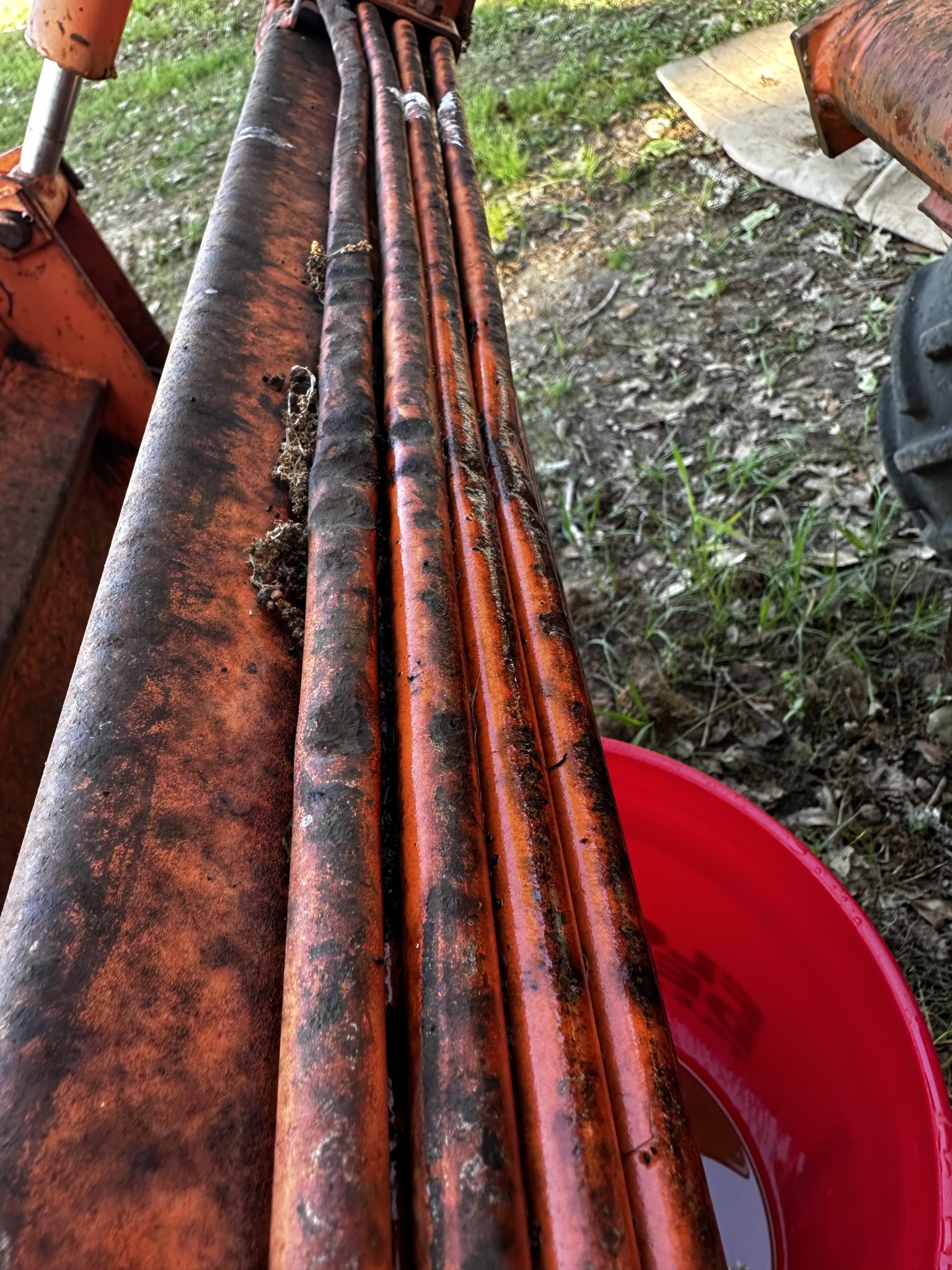

Loader works! But I have an issue. Do they still sell these steel hydraulic lines?
It looks like one of the previous owners had tied chains around the loader, crossmember and crushed the lines. But just as well it appears that they have been rusty, and eventually gave out.

If they don’t sell these hydraulic steel lines anymore, I may have to get my son to cut and TIG in replacements sections.
On another note… Dot The 3- point hitch does not come up .👎🏻 Maybe I just don’t know how to work it, but when I lift the crescent wrench lever, it just groans.

My guess would be, IF, they are available once you see the price you will decide to fix them.

I noticed that they do have the steel hydraulic lines available on Messicks. It looks like all four of them will run about $700 before tax and shipping. My plan is to find one or two that are currently leaking and just replace those for now. If it turns out to be a permanent fixture around here, I’ll end up replacing the other ones I’m sure.

I would think it a bad idea to try to "tig in replacements"
A local hydraulics shop could make those lines for you, or depending on your own capabilities you could make them.

You need to find a shop that has a hydraulic tubing bender and bring them an old one to duplicate. I had a problem with my Mercedes that had hydraulic shocks that were powered by the power steering pump and the pipe was crushed in an accident. The body shop repaired the body damage, but I had to take the car to an MB dealership about 100 miles away that had the equipment to bend the new pipe. MB in their infinite wisdom only provided a straight pipe with the nuts and flair on the ends and needed to be bent to get it into the vehicle.

My B1630 loader was in the same state as this one is - crushed and rusty lines. I'm using this as an opportunity to learn a new skill and to bend and flare some new stainless lines with new fittings. I'm basically rebuilding the loader hydraulics from scratch and reusing the arms, uprights, and bucket.
"Vevor" pipe/tubing bender ...$130 - Amazon
Will make perfect SS tubing bends.
Well worth the price, compared to paying someone else for hyd. lines.

Since some of those hard lines meet steel blocks at either end of that middle section, it should be fairly easy to repair those by welding fittings to the steel blocks (which will be much easier to weld to since they have a lot more mass) and then just doing some good old hydraulic flare fittings on some new straight sections of hard line.
Or, to be honest, you COULD just weld fittings to those blocks and replace the middle sections with pre-made hose! You would just want to install a hard cover (4" steel channel is my first thought) to prevent them from being cut by a load falling on them.
And.. honestly.. lol.. you probably could just tap npt threads into those blocks and then just screw in NPT fittings to them instead of welding anything at all!

UPDATE:::::
Over the past 3-4 weeks progress has been made. I ended up taking the steel lines and related hydraulic hoses, the control the bucket of President scoop and dump functions down to the hydraulic line store and getting them completely rebuilt all new. $700 later and the loader is fully functional and working. About 1/2 of the grease zerts I have tried to live are rusted and locked. Will need to replace these.
I drain the entire hydraulic system, clean the screen, and refilled with all new fluid. So the hydraulic system is working really well. I was able to fix the leak down at the screen by simply tightening the nut fully. 🙄
The gear selector boot had dry rotted and cracked, which was what I think caused water to get down inside the transmission. I put a new boot on and have sealed that up.

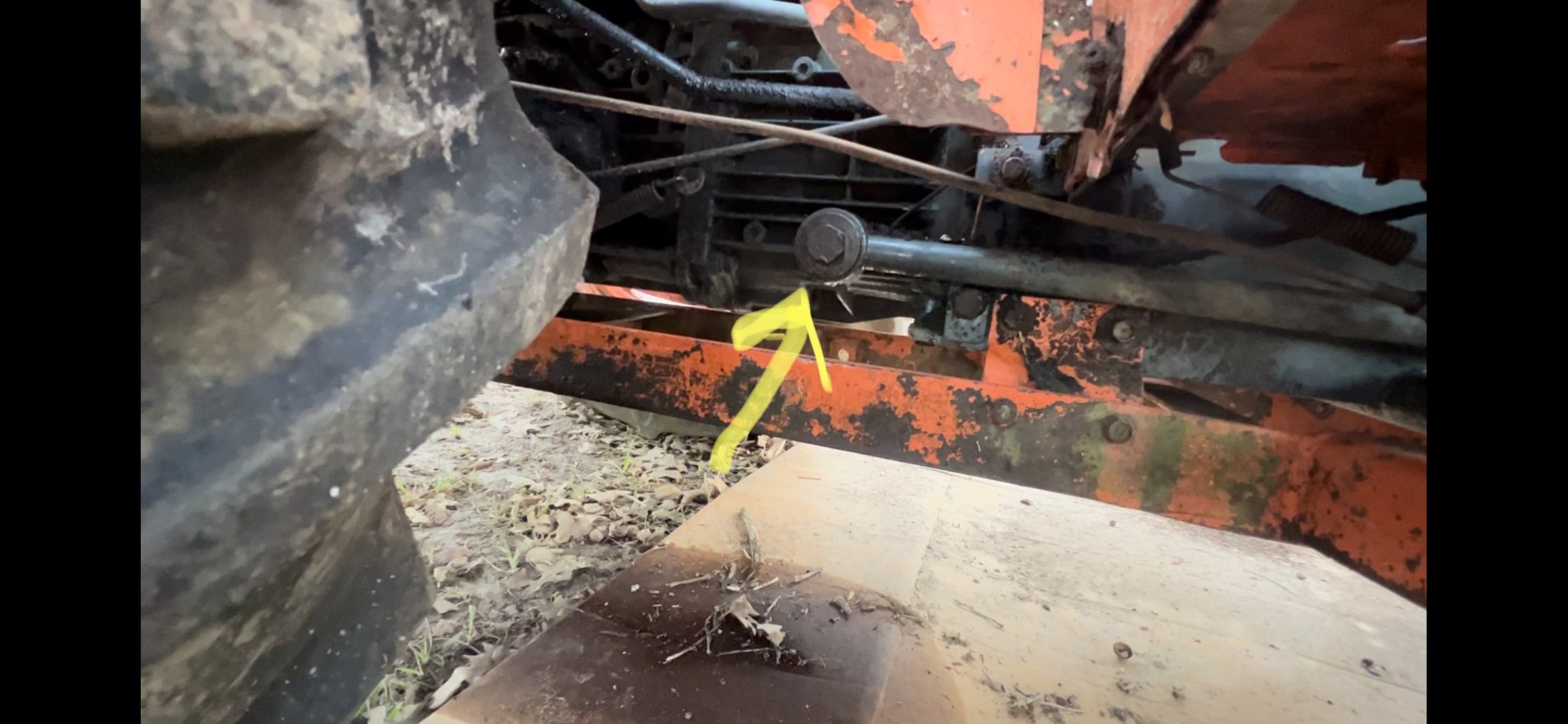

The steering has a tremendous amount of play in it. Any idea on what I could do to tighten this up? Also, do you know if there is a power steering add on kit?
The only thing that’s not functioning is the three point hitch. I’ve tried everything, and it simply does not come up. It is in the fully down position. I noticed that there is a directional valve nut that you can turn, which seems to control the hydraulics. I played around with it in a matter which way I turn it, it does not lift the three point hitch. I’m not sure where to leave and start to look to start to chase this down. I am only interested in keeping this tractor for mowing if I could get the 3-point hitch to function. Any ideas?

Need some pictures of how the loader hydraulics are hooked up to it.
There was a PS add on for that model but it's long obsolete.
There are some things you could add to it, but they are not a simple bolt on unit.
This is a cool thread, been watching.
As for power steering, on my old Fords it became second nature to use the brakes to help steer. A lot of weight on the back helps too.

Thanks. I can get over not having power steering BUT the play in the steering has got to go. From 10 o’clock to 2 o’clock. I don’t have the three point hitch working yet so I’m not able to use it for mowing but I can only imagine what it would be like trying to drive around trees on our property mowing with this much play.

I took the little tractor to a local Shadetree tractor mechanic who is strong on hydraulic repairs. We were able to finally get the necessary part to fix the relief valve assembly and the three point hitch is now working. It’s quite a story and I’ll come back and tell it to everybody as soon as I get through the next hurdle….
We’ve noticed that the hydraulic pump produces good volume but there is a lack of power and so I’m looking to replace the hydraulic pump. Any recommendations on where to find a good aftermarket pump if there is such a thing?
Also, still need to chase out the steering play on this B8200 non-hydrostatic tractor if anybody has any experience?
