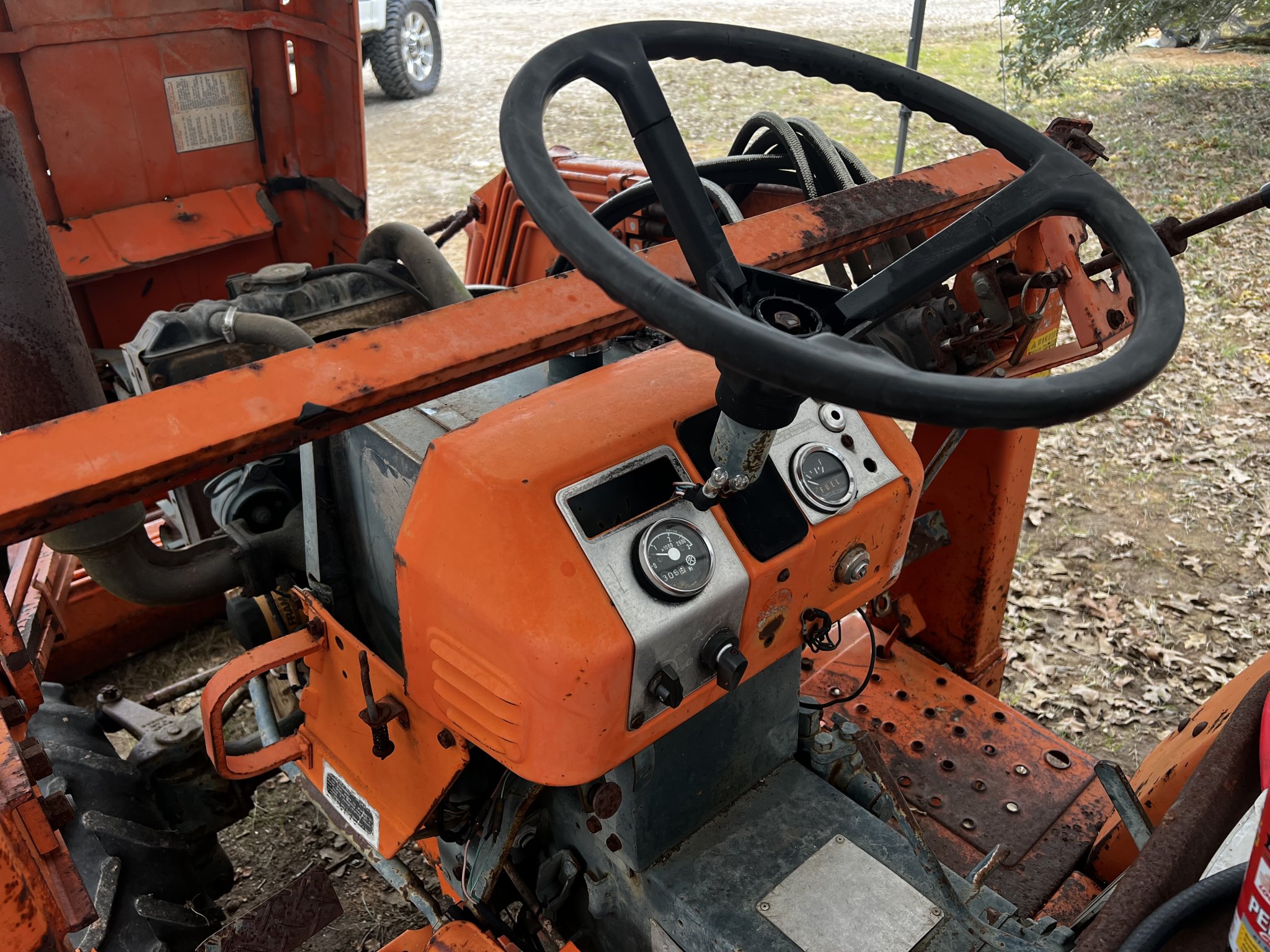

Basically, I disassembled the steering wheel and remove the dash. I must say the electrical has been tampered with quite a bit. if I get this thing to run, I’m gonna go through the entire system and fix it correctly.
Stick a 2x4 in the dash to hold it. Shade tree mechanic🤠
Got the new switch connected. Holding old one in hand. ALL of the connectors and wires need work! I set a battery in the battery tray and connected the terminals, gave the key a twist backward and got the glow plug to start smoking. So I turn the key forward to see if the starter would bump and sure enough it bumped about a quarter revolution and then stopped. Gave another bump a little further and then one more bump and it made a full turn so I stopped right there. 835F1877-E7DA-4BA4-999D-0571289BBEBC.jpeg

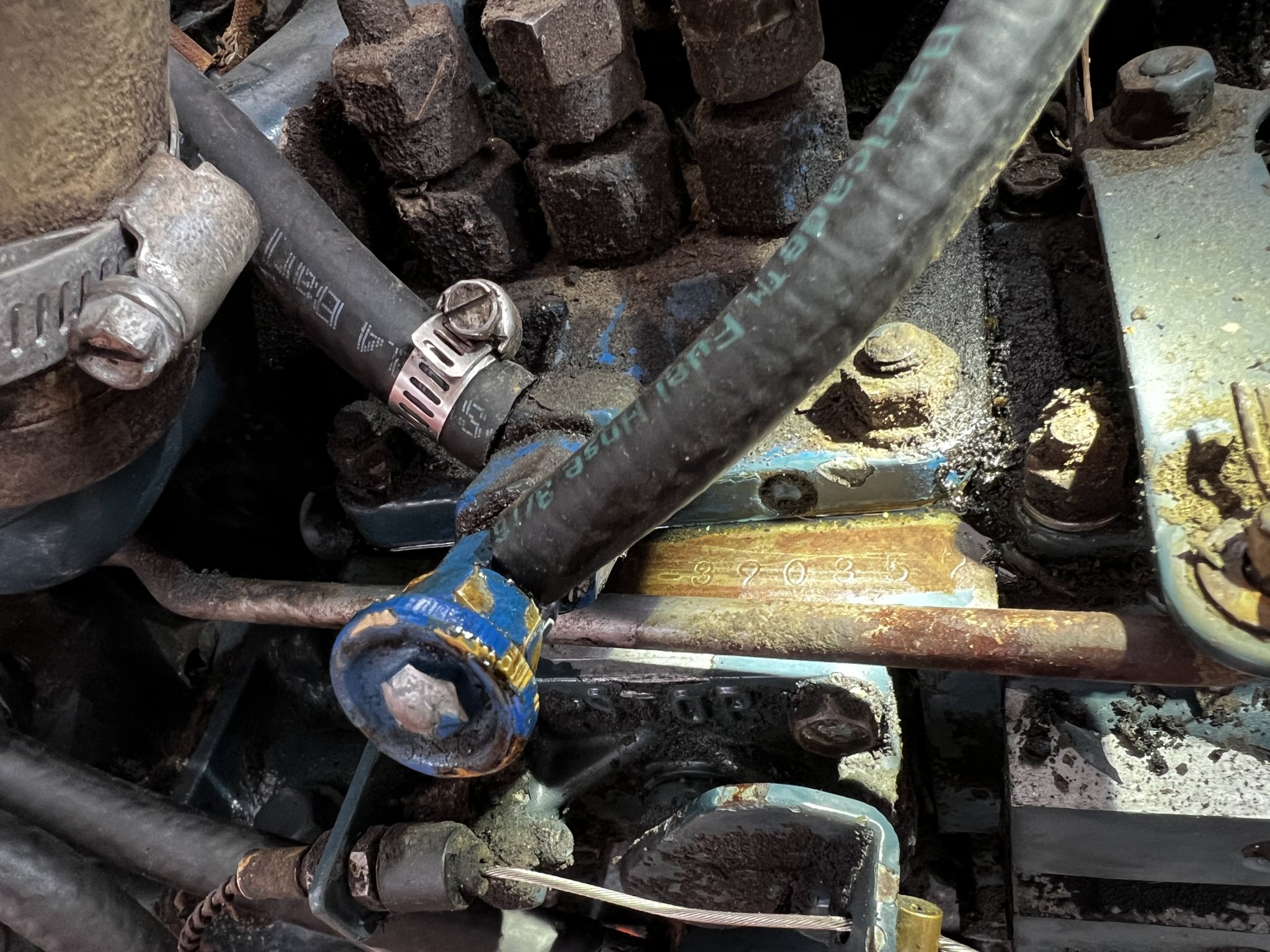

Well, I replaced all the fuel lines, primed, everything as best I can, and I’m not getting any diesel coming out of the injectors with the fuel rail cracked open.
I’m wondering if it’s the lower fuel pump. To me when I take the fuel line off the pump and crank the engine over. Shouldn’t the pot be putting out a pretty good squirt? It doesn’t seem like it’s putting out much fuel. Just very small dribbles with each revolution.

I went to the local dealership and bought a new fuel filter and O-ring. Also, when I explain to them that the bleeder valve leaks when unscrewed and drips, they said it may be sucking in air and should not be doing that so I got a new bleeder valve.
I will give that a try tomorrow. A new pump was like $170! 😳

I went ahead and ordered this $23 electric diesel pump. Should do the trick IF the pump is the problem.

Forget adding stuff like a fuel pump, just bottle feed the injection pump from over the engine, bleed the injection lines at the injectors not at the injection pump.
And see if it one, it moves diesel out to the injectors, or 2 it fires up after bleeding injection lines.

It is returning fuel to the tank through the injector return lines but my gosh how much cranking do I have to do to get fuel to come out at the injector end lines??
Did you crack the injector lines at the injectors to bleed the injectors?
Are you getting fuel from those connections?
If your not, your going to need to pull the injection pump and the injectors and have them cleaned and possibly rebuilt.

Is there a fuel shutoff solenoid or fuel shutoff lever in the wrong position?

yes I have cracked the top hard fuel line loose at the injector and have cranked a lot. No fuel is coming out.
