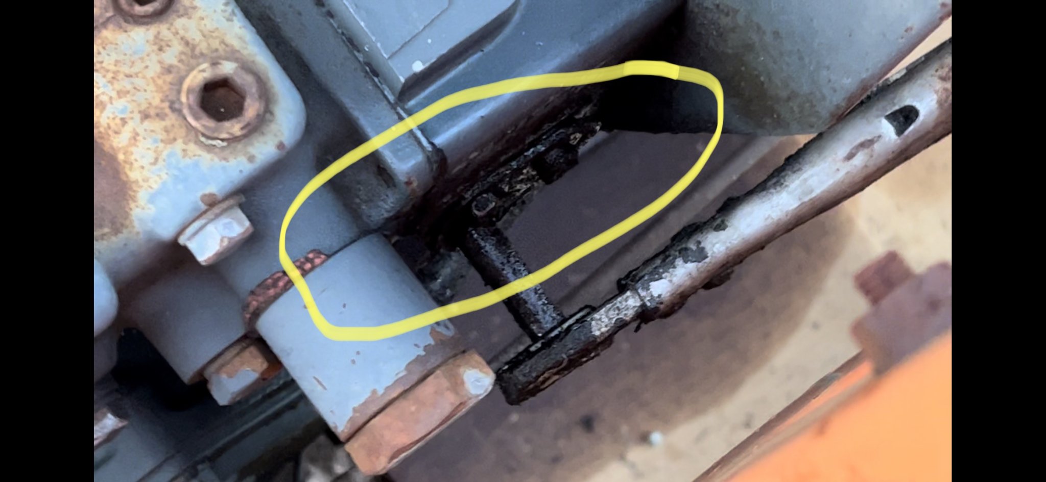

Sorry in advance for the silence. Wife and I are building a barndominium down here in Texas and between that and work I have had zero time to focus on the B8200.
On January 11th I finally got her to light up and she runs! Sounds smooth and like a diesel tractor. I have a video but have not had time to upload.
None of the gauges on the dash work so I have no info on oil pressure. That said, next step I guess is to reassemble the dash and steering wheel to see if it will drive.
There is zero transmission fluid showing on the dipstick. There is a leak at the 3-point lever. I guess I’m gonna top it off and test the functions of the loader first to see if I can raise it and keep it up before driving.
Any suggestions before I attempt this next step of testing the functions and driving it?

Thanks! I’ll dig deeper soon. Starting to see some time freeing up here in the near future to get back to the project. I have to walk by the thing every time I go to get any tools. It’s torture because I’m excited to see what comes next now that I have it running.
I have a couple of leaks that are contributing to why the machine has no hydraulic fluid on the dipstick.
This is the 3-point hitch lever area:
