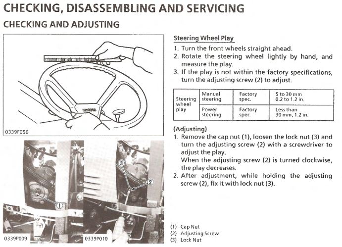

This is the section for adjusting the play on a B9200 HST but I think the process is similar on the B8200:

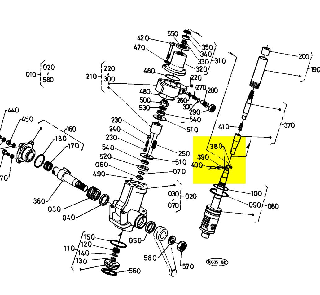

I adjusted mine until it was fully maxed out and I still had about 2-3" of play. I dissembled the column and this connection was very loose and worn-out.
I reworked it and shimmed the parts and now have about 1.5" of play. I do have power steering and am not sure if your has the same connection.

Thanks!!!!! I missed your post somehow. I will definitely dig into this when I get the tractor back.
