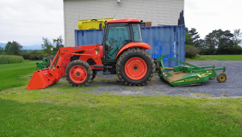

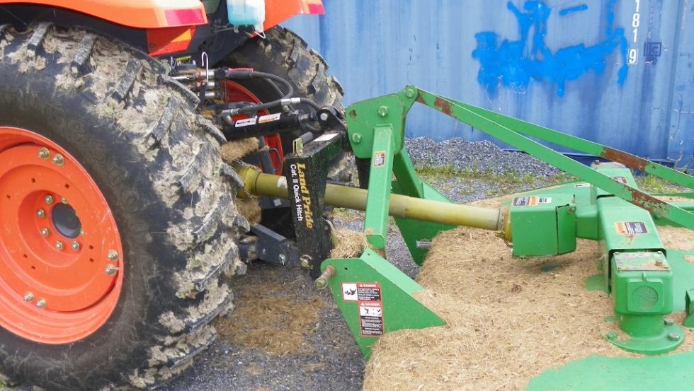

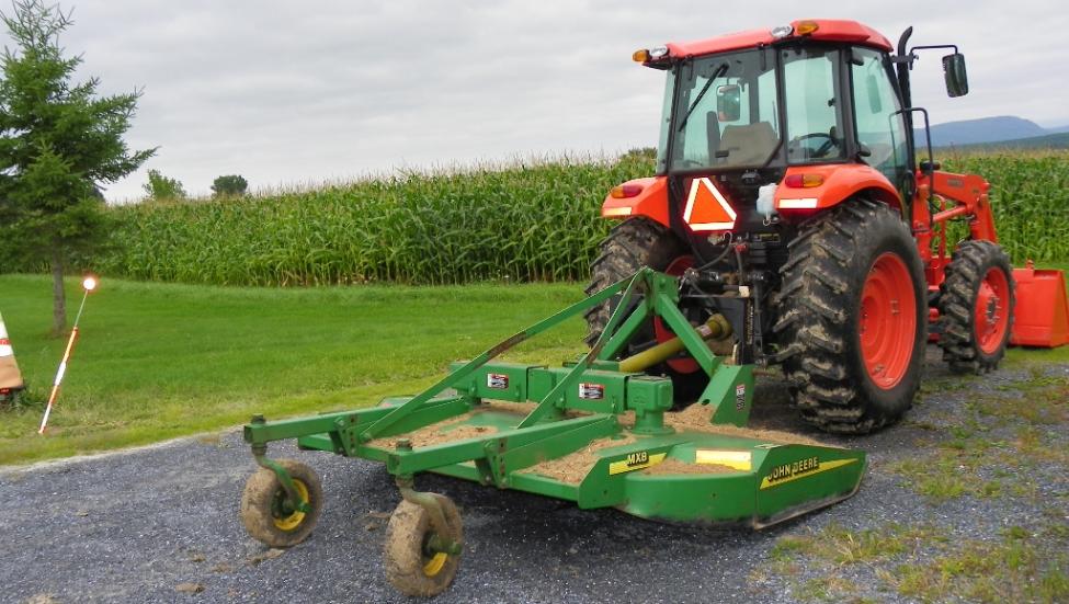

bmotojoe, I just purchased the LP RCF 2072 and am waiting for the chain kit to come in. Didn't notice the ends sticking out without support until seeing your post. I like your approach to addressing the problem with extra bolts and spacers and will do the same with mine. Any other issues with the mower?
I have found no other real issues with the implement. Just make sure it is setup correctly (Deck Leveling & Cutting Height) portion of owners manual. Mine has the slip clutch and I do check the tightness of the bolt going through input shaft to gearbox every time I use it. Other than that keep the tail wheel well lubricated. Make sure you receive all the original guards if you feel you need them or the material in the future, you paid for them.
