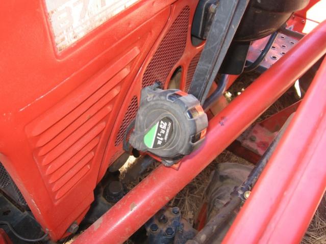

Also found a handy place to keep a cheap tape measure for assorted tractor projects.
Lil Foot ----Is that a brace going up to the side of the muffler that you have the tape clipped to? If yes is it factory or did you add it? Don't think I have ever seen one before. Wonder if all B7100's had them when sold?

Yes, that is the muffler brace. But if you look closely, you will actually see two braces- the shorter lower one is factory, and I added the longer upper one when I turned the stack vertical & added the taller pipe. The factory one is even used when the stack is horizontal, the orange 90˚ bracket at the lower (tractor) end can be rotated, allowing use in either position. I have seen it on other B7100s, but maybe it's an early model thing. Mine's a 1979.

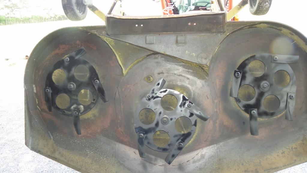

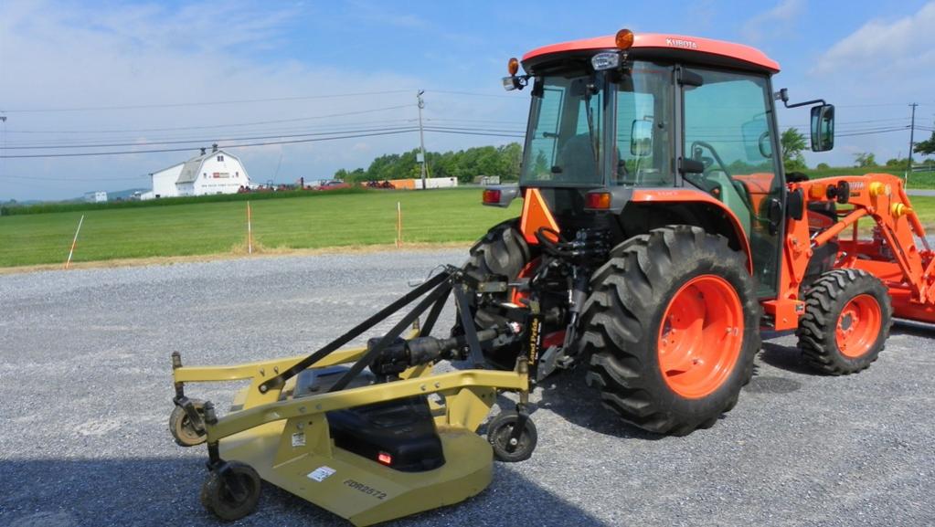

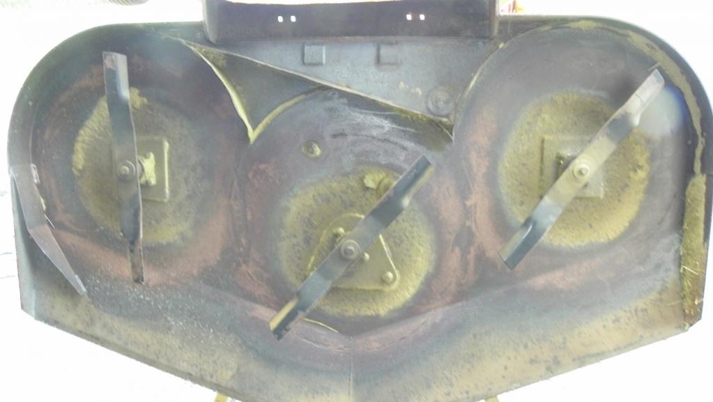

I made a change of Blades on my Land Pride FDR 2572 mower that I use on Kubota Grand L3540. I went from factory blades (photo 1) to the Meg-Mo System Blades (photo 2). I like these a lot.

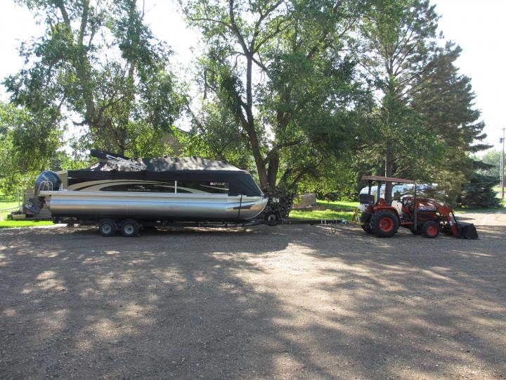

Just figured I would throw a pic in the pile, Had to move my pontoon around and I do it regularly in my yard with the Kubota as it can maneuver it in my tight spaces quite well.
In the background of the one pic you can see my 1972 Avion TT, the Kubota moves it around with ease as well.

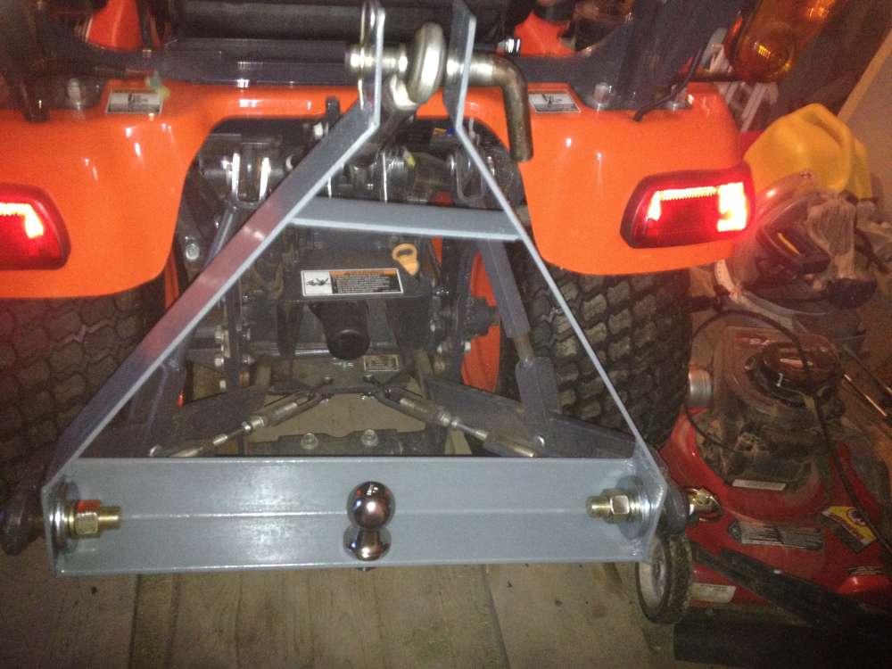

A 3 point hitch trailer ball adapter for my BX2370. I have the sketchup 3d plan with dimensions if anyone wants it, message me.
$14 in metal
$10 hitch ball 1-7/8
$10 2 side pins
