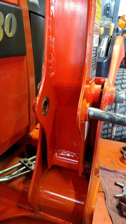

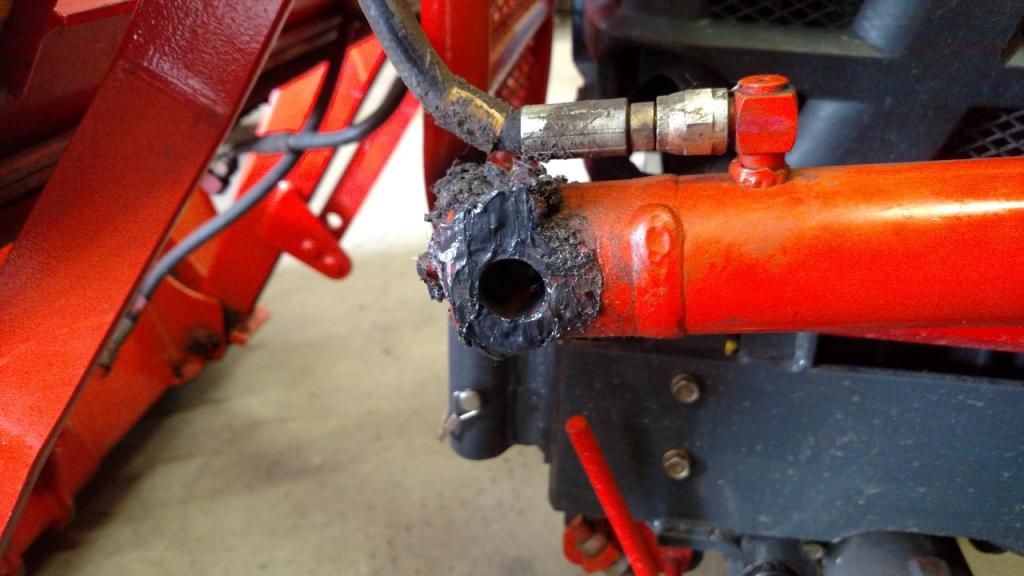

I pulled the pins out of the FEL lift cylinders and dropped them down so I could clean out the mass of old grease, new grease and dirt where they attach. I'm not a neat freak, but that mess did need to be cleaned out. I'm going to drop the FEL so I can pull the lift arm pivot pins and clean up those areas also. Then I'll tackle the bucket cylinder ends and the bucket pivots.
It only takes a little grease to lubricate the pins, not several pumps.
I need to do this, that looks a lot better. Less crud catching dirt
