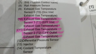

It started to lose power then stopped. Gave me a code e9310. If anyone says take it to a dealer I’ll be furious because how do you load a dead track loader?????
E9310 is usually triggered by a dpf temp sensor reading too high. On the earlier SVL-90-2 this was usually caused by the insulation tube around the temp sensor wires wearing through the wire insulation and causing a short.
I'm going to check this issue and trash in the fuel line going into/out of the water separator before I take it to the dealer.
The dealer said to check them both before bringing it in.
Thanks
In case anybody need this in the future:
