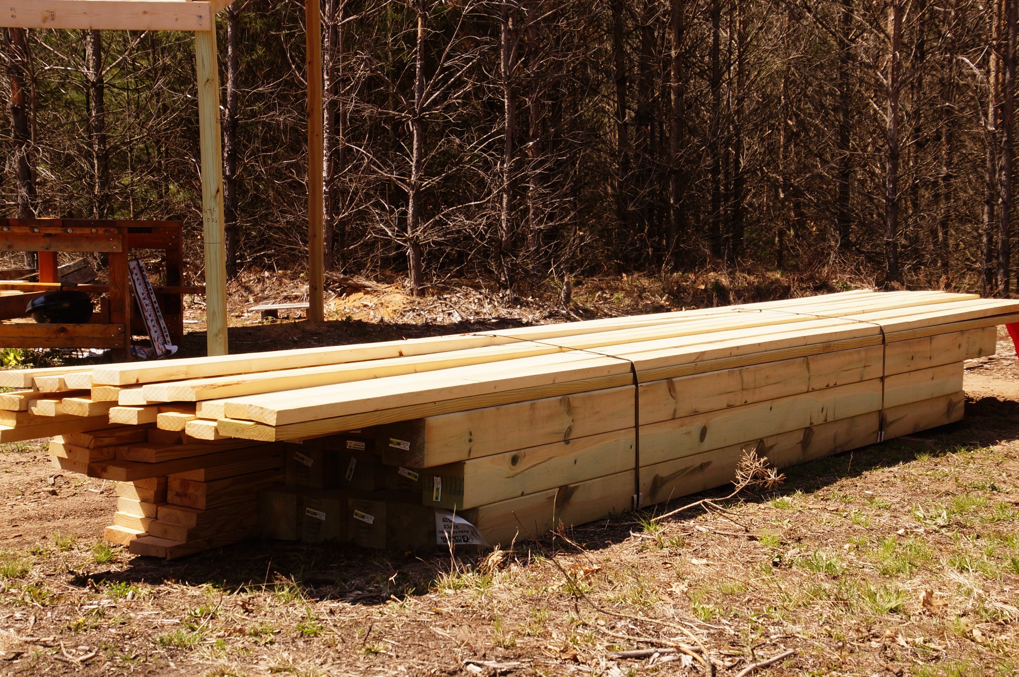

And a quick picture that represents a sizable portion of my retirement savings, considering the price of lumber! LOLOL DSC00479.JPG

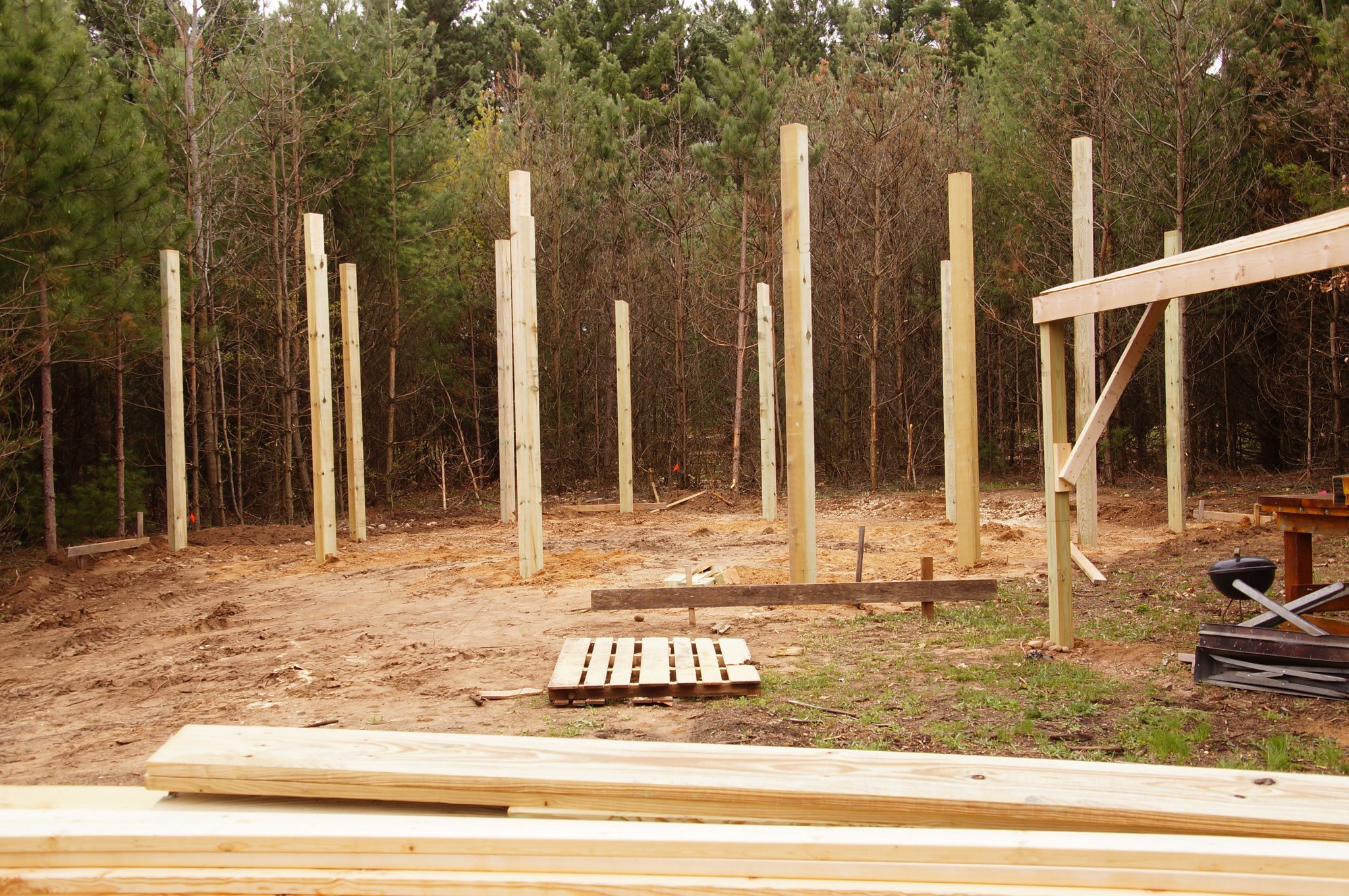

Popped in at the land quick yesterday and discovered the builder has set the posts. Not sure how fast things will progress from this point on. I think he mentioned early last week the trusses take a few weeks to be built and delivered.
Side note; I am picking up 1200 seedlings, 600 white spruce and 600 white pine, for a friend of mine that has land near the Wisconsin Dells this morning.
His tree planter guy will be meeting me about 9:30 am, should be interesting to watch them get planted.

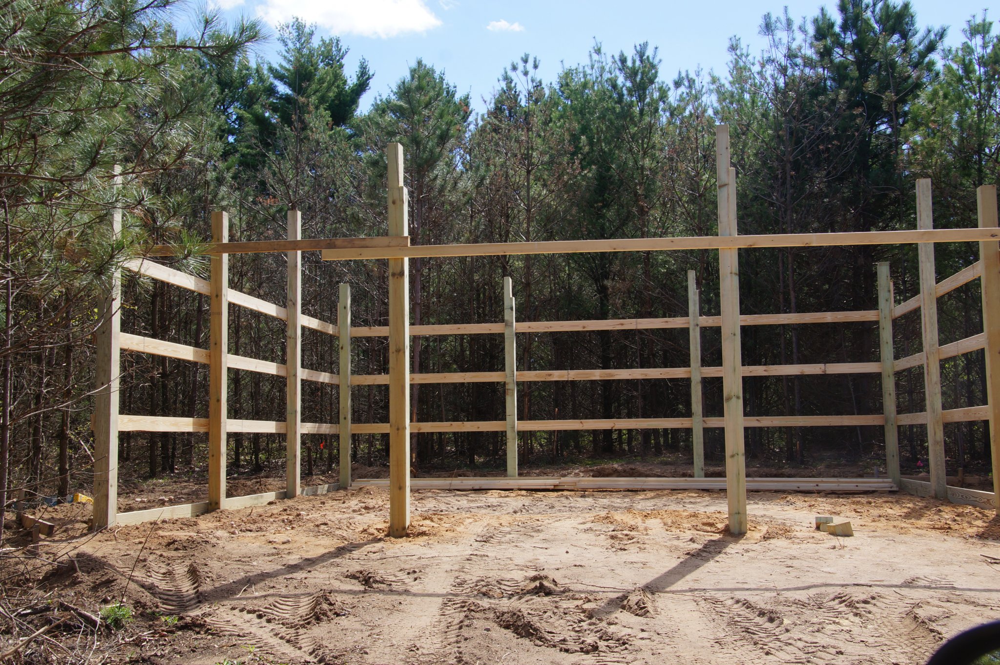

Turned out to be a wonderful day for a road trip and watching trees being planted.
I did find out that 1200 pine trees 100 per bundle fit in my older Jeep Cherokee with not much room to spare! :)
The tree planter fellows used a Kubota L4400 to pull the planter with the operation going very smoothly. I headed back home before the planting was completed.
I did swing by the tractor shed build on the way back home and was pleased to see more progress. My plan was that if the builder had been on site today I was going to get out of my Jeep with a level and check his work! lol. That plan was dashed as I picked up a blackberry thorn in one of my wheelchair tires at Petes land helping laying out end row markers, which left me with a flat.
All in all it was a great day, fresh air, catching up with my buddy and his land projects and watching the planting process.

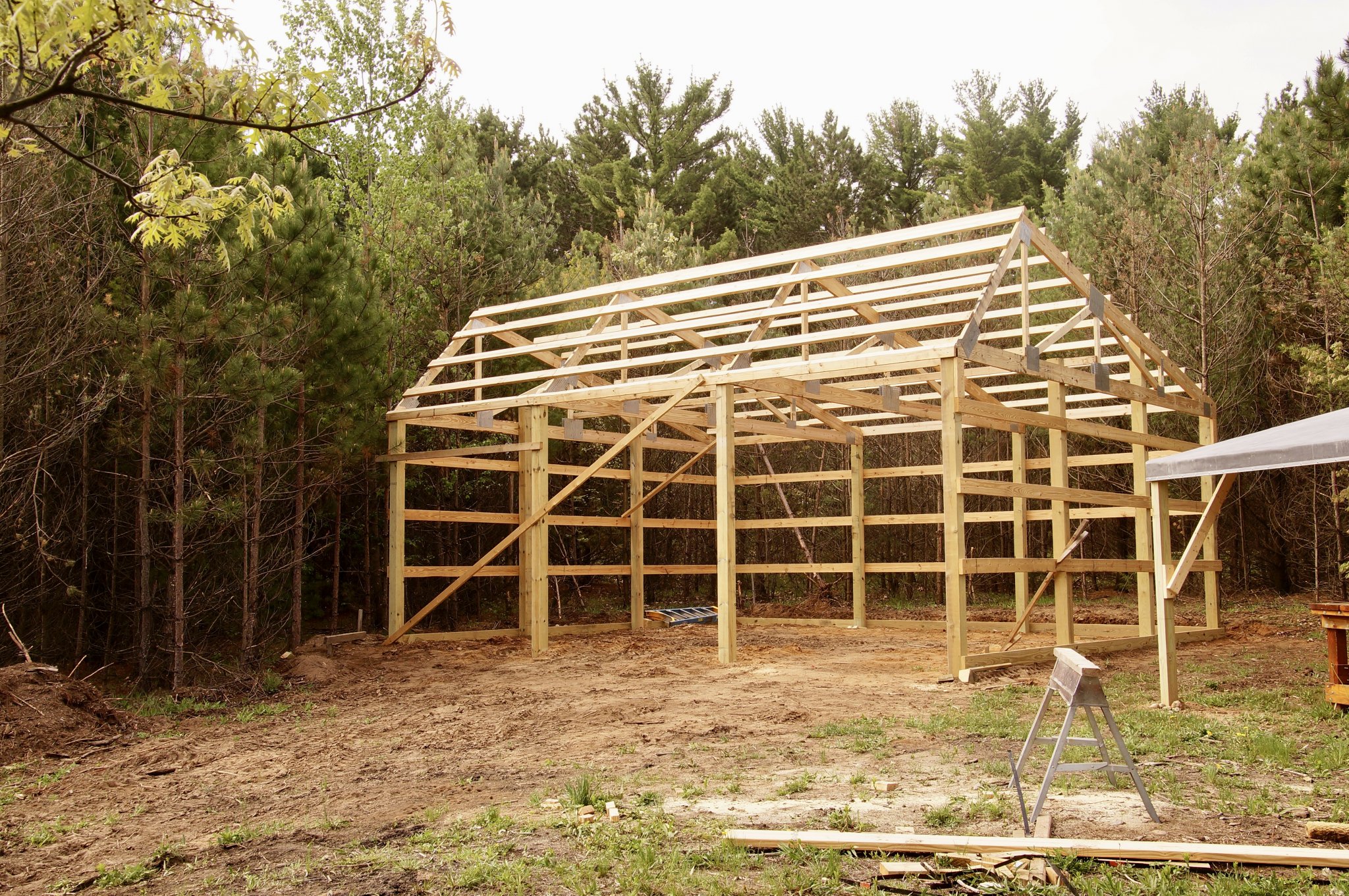

The trusses were delivered Thursday afternoon. Yesterday the builder finished the framing except for some minor details. Running some carriage bolts and adding some diagonal bracing in the trusses if I understood correctly. Today I picked out colors. He mentioned that the steel should arrive in 7 to 10 days. I must say this builder does not waste a lot of time if he has materials in front of him. :)
So far I am very pleased with the construction and my vision of what this would look like when completed.
A generic question for folks that have experience with this type construction . Does the steel add any structural integrity to the building or are all loads, wind or otherwise carried by the framing?
8,356
11,757
Looking good! I'm not a structural engineer but intuitively I would say that the steel panels provide very little in the way of structural integrity since they're so thin and can buckle easily. I would expect the panels to help in any loading that results in tension within the panel but I can't think of a typical situation where that would apply. There are arrows on sheets of OSB indicating proper orientation in order to provide structural support in the vertical direction but they're much thicker and can resist buckling.
