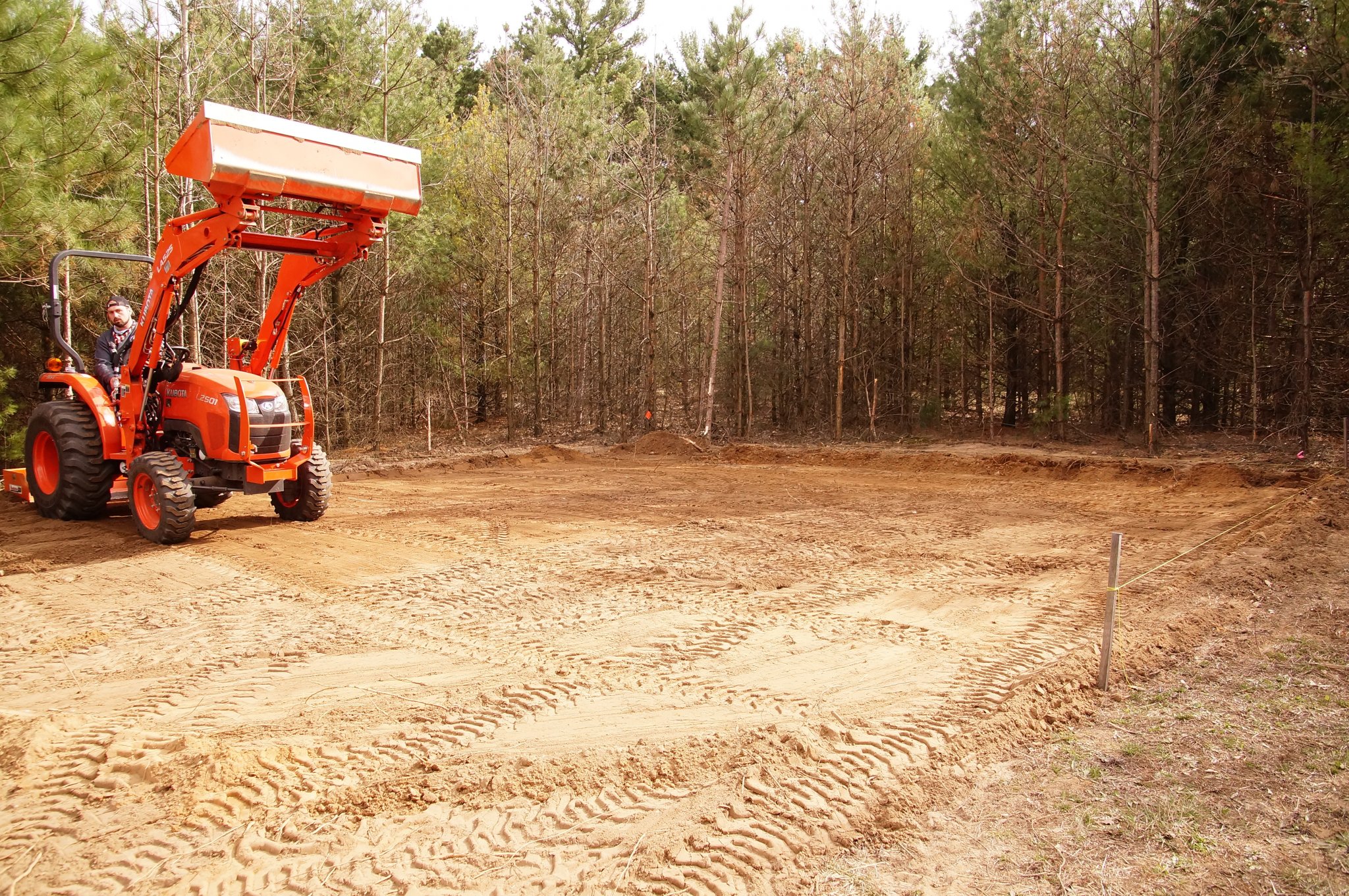

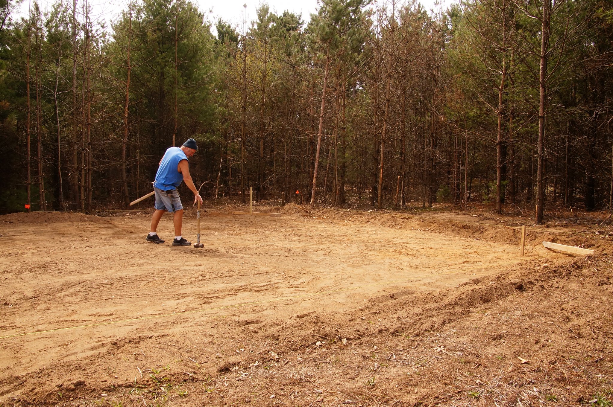

I started the process by laying out rough corner flags for the area I needed to clear and level.
The next step was to use my L2501 with grapple and rip out the Scots pines, roots and all so as to not be a issue when the post holes were augered.
I laid out level strings around the back and sides with a conventional line level to help guide me as I brought the surface to finish grade that the builder was comfortable working with.

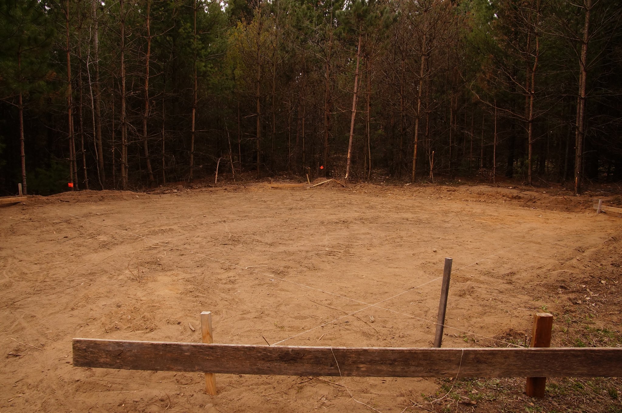

Received a call early this morning from the builder. He mentioned he was going to do a quick site survey and rough in some batter boards and string.
I met him, (my land is about a half hour drive from my house) , ironed out a few details etc.
I have no experience laying out buildings but have seen batter boards set up. I was a bit surprised to see that he used only one long board and two stakes running the board at roughly 45 degrees. I am familiar with 3 stakes, two shorter boards forming a 90 degree corner method. Comments welcome.

I like his method. It makes stringing the line much quicker and is an indication he has been around the block before.
