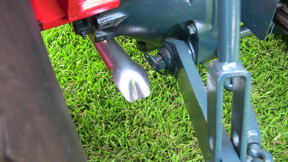

Nice job on the exhaust!!!
I flared the tip on my exhaust like the diesel after treatment systems use to knock down exhaust temps. It deflects the air into multiple directions to mix the heated exhaust with cool ambient temps. The benefit I like is that the deflection also keeps the exhaust from kicking up dirt, grass and loose items on the ground.
The exhaust hardly stirs anything at all around the tractor and it is diverted so well there is no odor to have to smell.

Yours look very nice as well. Cool tractor!

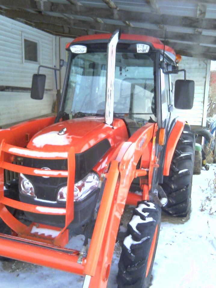

my fix to the exhaust on the loader of my L3940 also added a turbo under the hood:D
When I went to do mine I bought the stack and even machined a few parts to do what you did there but I decided not to because I didn't want to put a hole in the hood of the tractor for one and if I did that meant the hood couldn't open easily so It was easier for me to extend what was there and doing that I never had the other two issues. How do you get you hood open now? Do the stack impair your visibility?
