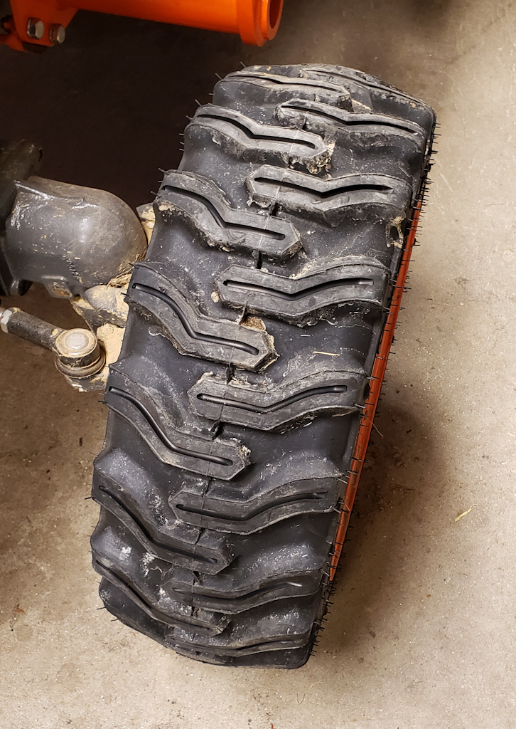

I have R4 tires on my B2910 and in mud they fill up and basically become slicks. I thought the R14 would be a great compromise.
Then I watched a Messicks video featuring R14 tires. And it looks like there is a lot less meat there than R4s, to the extent that my impression was they would wear out quicker than R1 tires (even if wear is not really a concern for the most part, not running on pavement).
So now I am thinking if I were to buy a new L2501 I would probably go with R4 tires. The 15" width might perform better than the 12.4" width R4 tires on my B2910 I suppose. And they just look more robust than the R14s...
Am I misguided in thinking this way?

Details on how?
I did mine and the traction increase is noticeable.
Love the results you guys produced with the tire groover. !!!
Excellent to say the least!!!
If you lived closer to me I'd bring you a case of beer and ask you to help me groove my tires!
