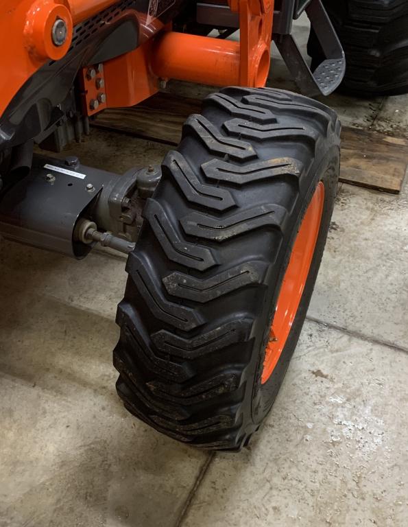

I have 4 tenths of a mile driveway to plow with hills and turns. Gave up on the plow truck because I always ran out of room due to piles and had to get the tractor out to move piles so I could continue to plow. Thought this is stupid and sold plow truck and tractor and purchased a low hour Kubota L4240HSTC-3 and a 72 inch HD pusher. I was having problems with the Industrial R4 tires when temps were twenties or higher. They acted like slicks and when I pushed off road downhill and tried backing out I would be stuck and had to use diff lock and FEL to get out or make a sharp turn to free the tractor.

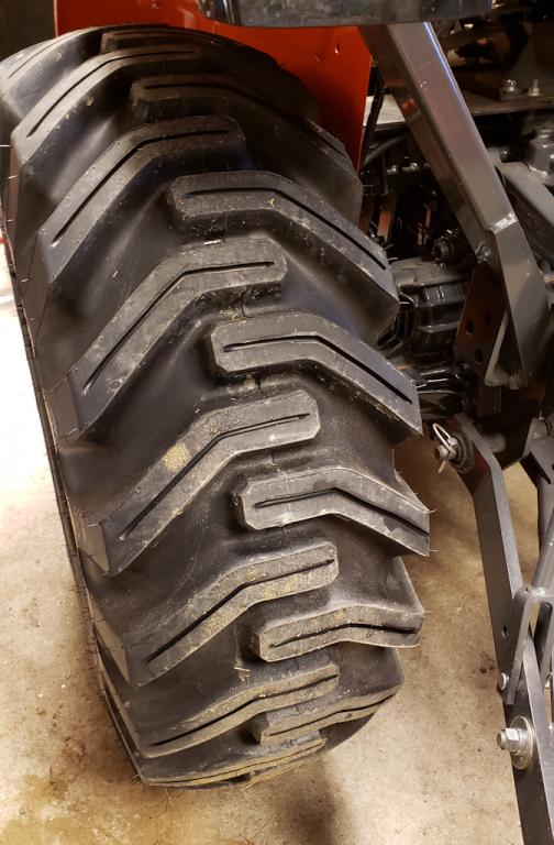

So I was considering chains, straps but didnt want chains to mess up my concrete pad and barn floor. Then I ran across a post in another forum on tire grooving. Bought a #4 groover off Amazon for 86 bucks. Spent three hours doing the fronts and making a template for rears and another three hours later I was finished!
Long story short, temperature was 27 degrees and I pushed the snow today with the grooved tires. I tried to get stuck and couldnt!
Grooving works!
Special thanks to High Compression for your tire grooving post!
