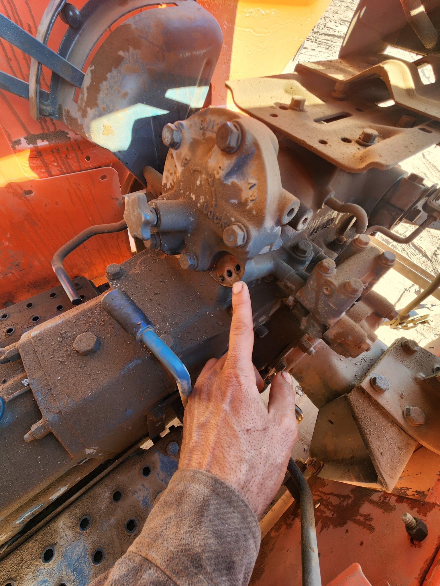

When she get hot, I notice bigger leak from this area, diesel line from the tank to the engine, I think the valve that close the tank is leaking
You are moving serious earth, she is getting hot in temperature, this line lose its prime, and engine sputter off
seal you that area next time you do service

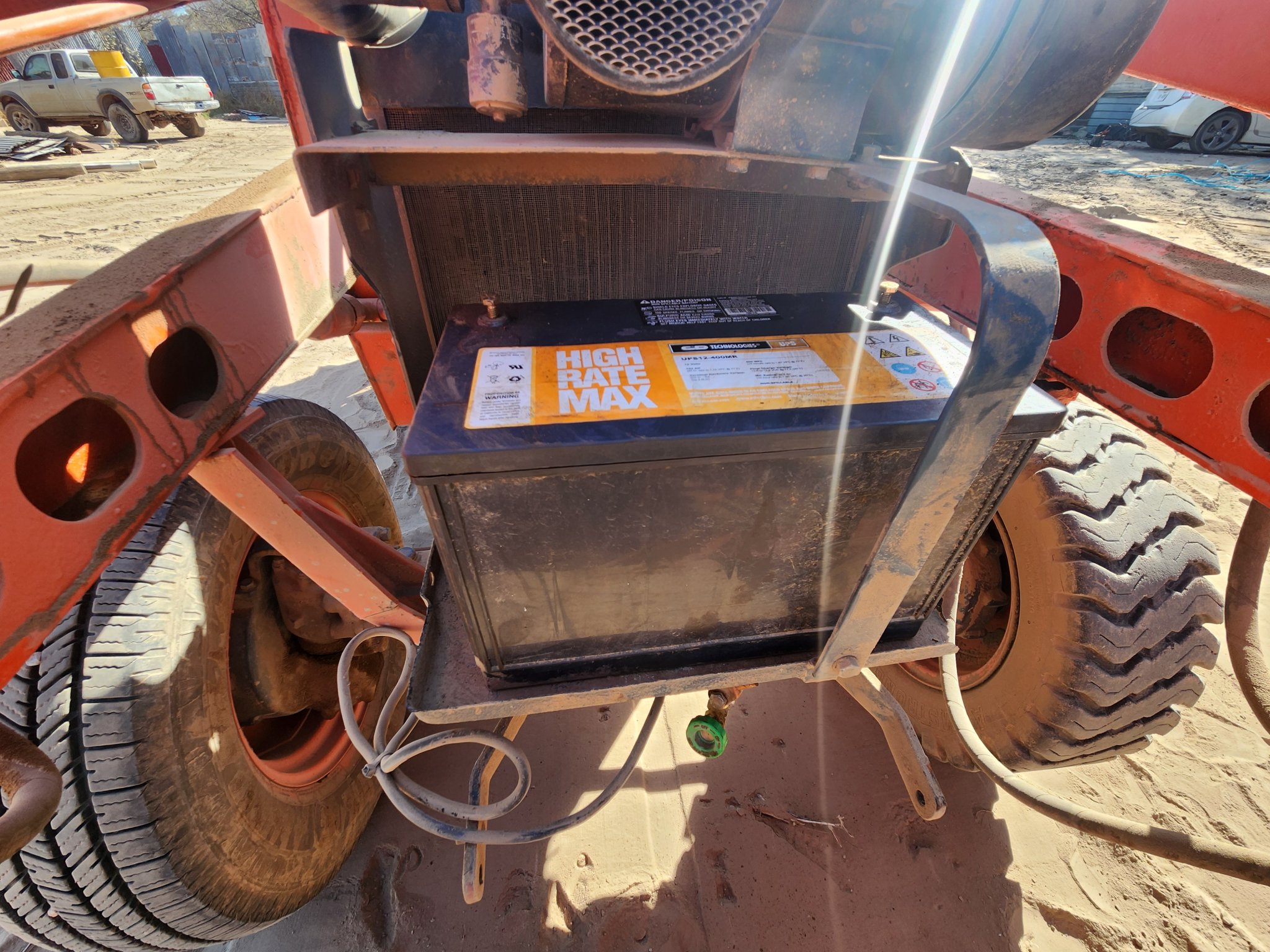

install you semi truck battery you got for $20

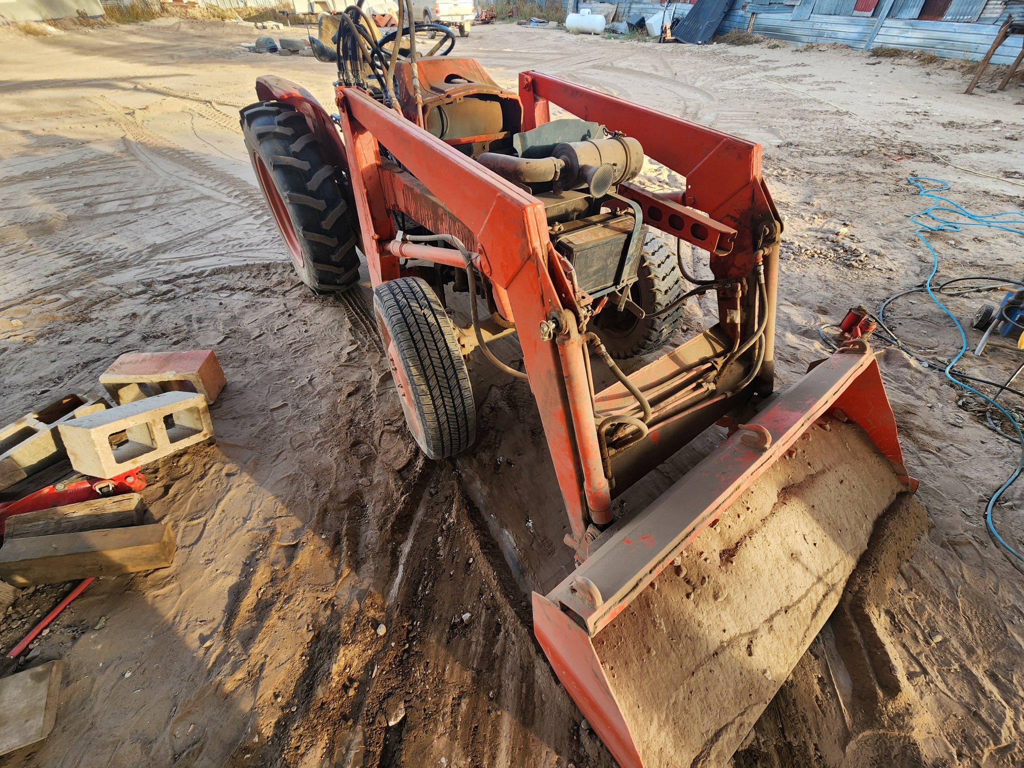

there was no problem but the hydraulics, bucket stuck scraping ground, and engine cant drag it,
drag you back L295DT to the shop, fully attack all the issue:
Take you off all hydraulic cylinder, do surgery and try to seal them with gasket maker, and
address all other hydraulic leaks, when I look inside transmission, the fluid is bubbly, meaning
you are pulling air into the system from somewhere
seal you up all your hydraulics, fill it up with fluid

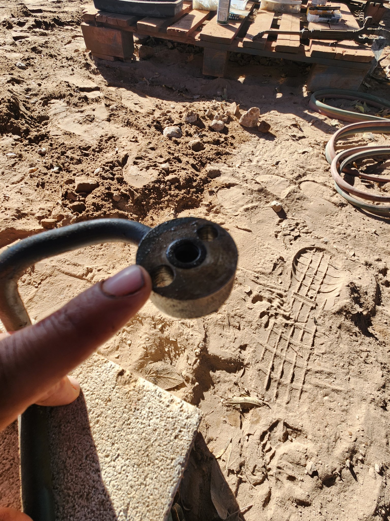

I point here to the ring that hold in the cylinder, last time spent too much effort dealing with it, maybe my protocol wrong, my protocol:
seal up the cylinder, then hammer the ring in millimeter by millimeter, takes too much time
is the protocol:
put ring in then close the cylinder over the ring, it will take less time doing this
let me know which is correct

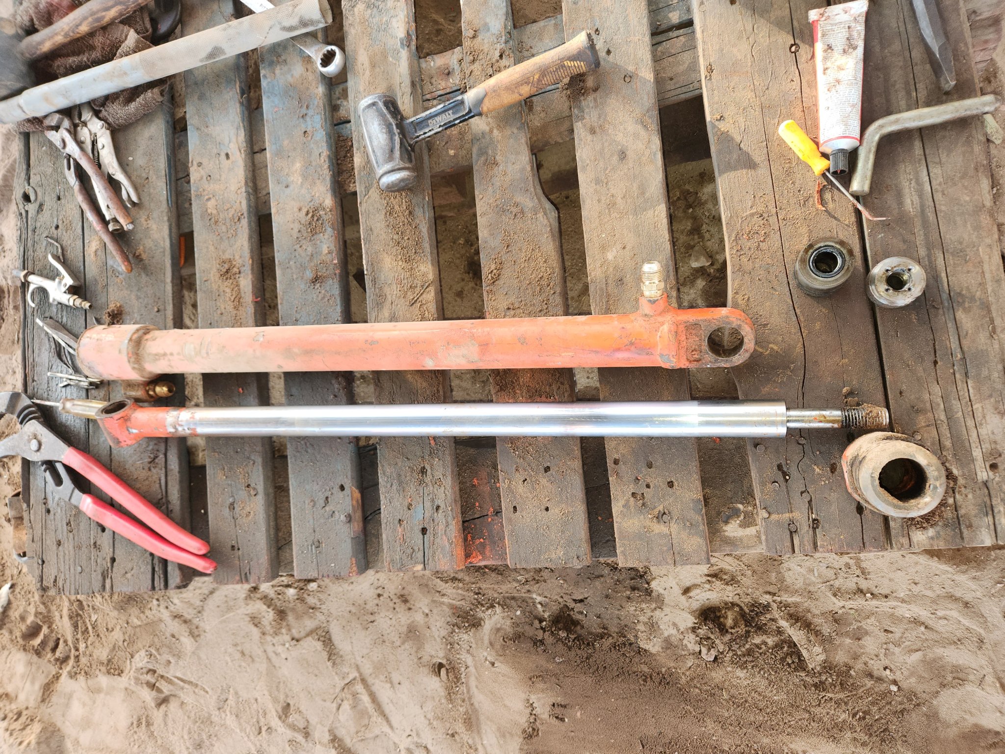

take you off all 4 cylinders, take them apart, clean them with intent, then
glob you bunch of gasket maker to seal where the hydraulic fluid oozing out
from what i remember and the looking at the diagram, you can seal that part where the cylinder moves up/down, there is rubber seal there
if gasket maker cant seal it, then get you the proper seals made for them etc

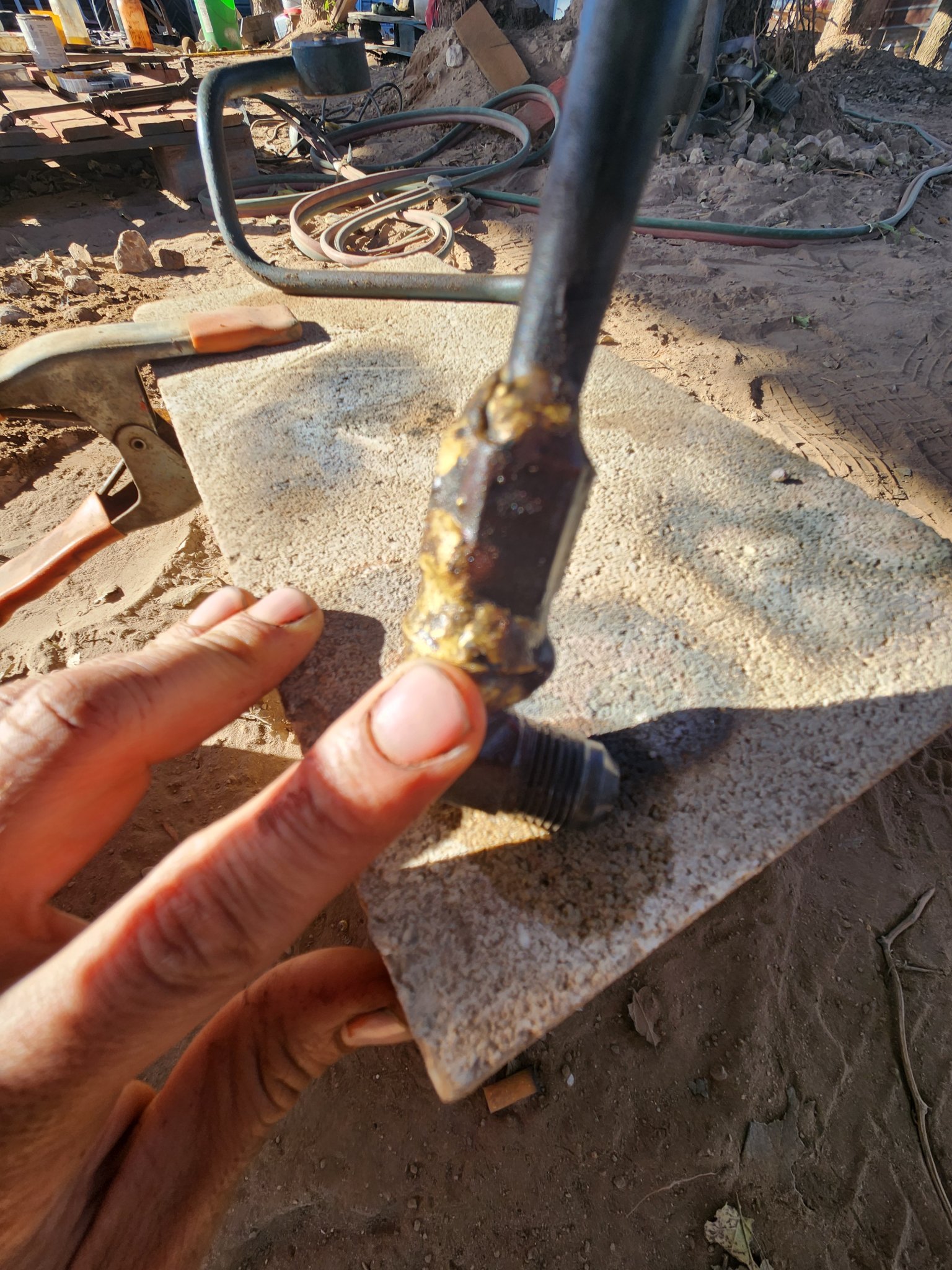

figure you out where the leaks are in your plumbing, maybe melt you some bronze on the leaks
you notice fluid all over injectors, you might've found your loss in diesel pressure that cause the sputtering down

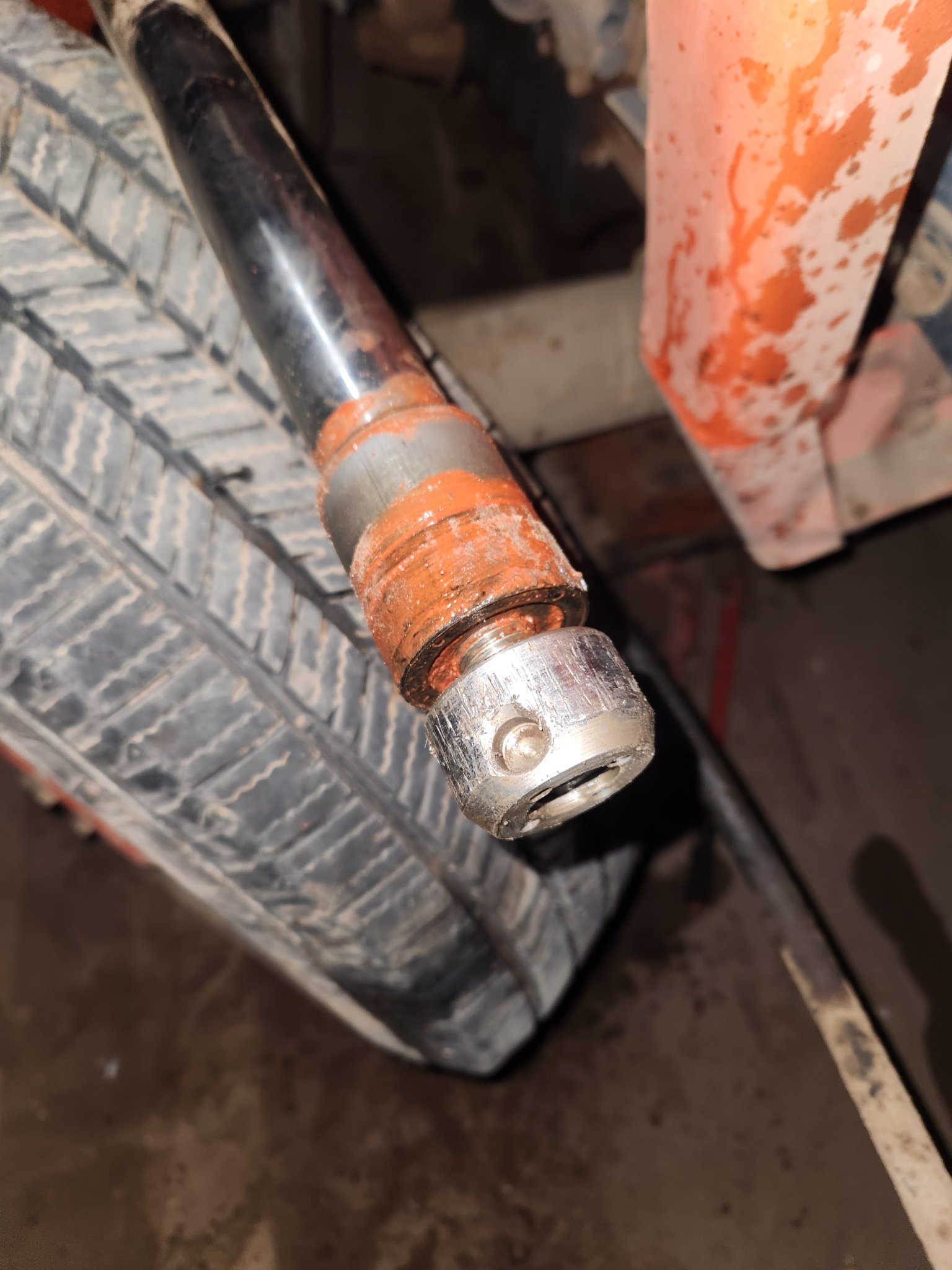

no way to take apart cylinder without removing the ring, almost destroyed it trying to air chisel it
got your cylinder apart, I point to the leaking area
to get to the leaking area, unscrew this part and the rest of it should come out
almost destroy your cylinder trying to get it unfastened, look at diagram again maybe there is a better way
figure something out where you get something hold on to it tight, then hammer on that
yes, you found a way to unscrew top of cylinder
put one side back onto the bucket, now she is hold tight, you you massive pipe wrench, torch hard soak in diesel
tired of dealing these 45 year old leaky cylinders, destroying them trying to fix them, so grateful that you got them apart and can move show forward

might've found a way to save big $$ by rebuilding your own cylinders, rebuild your cylinders try to seal them
so grateful you got it apart, and you can see the pathway of the leak, dirt trail going through all the seals
clean you everything surgically, get you gasket maker and build back with gasket maker and clean seals and let it cure, do that for all 4 cylinder

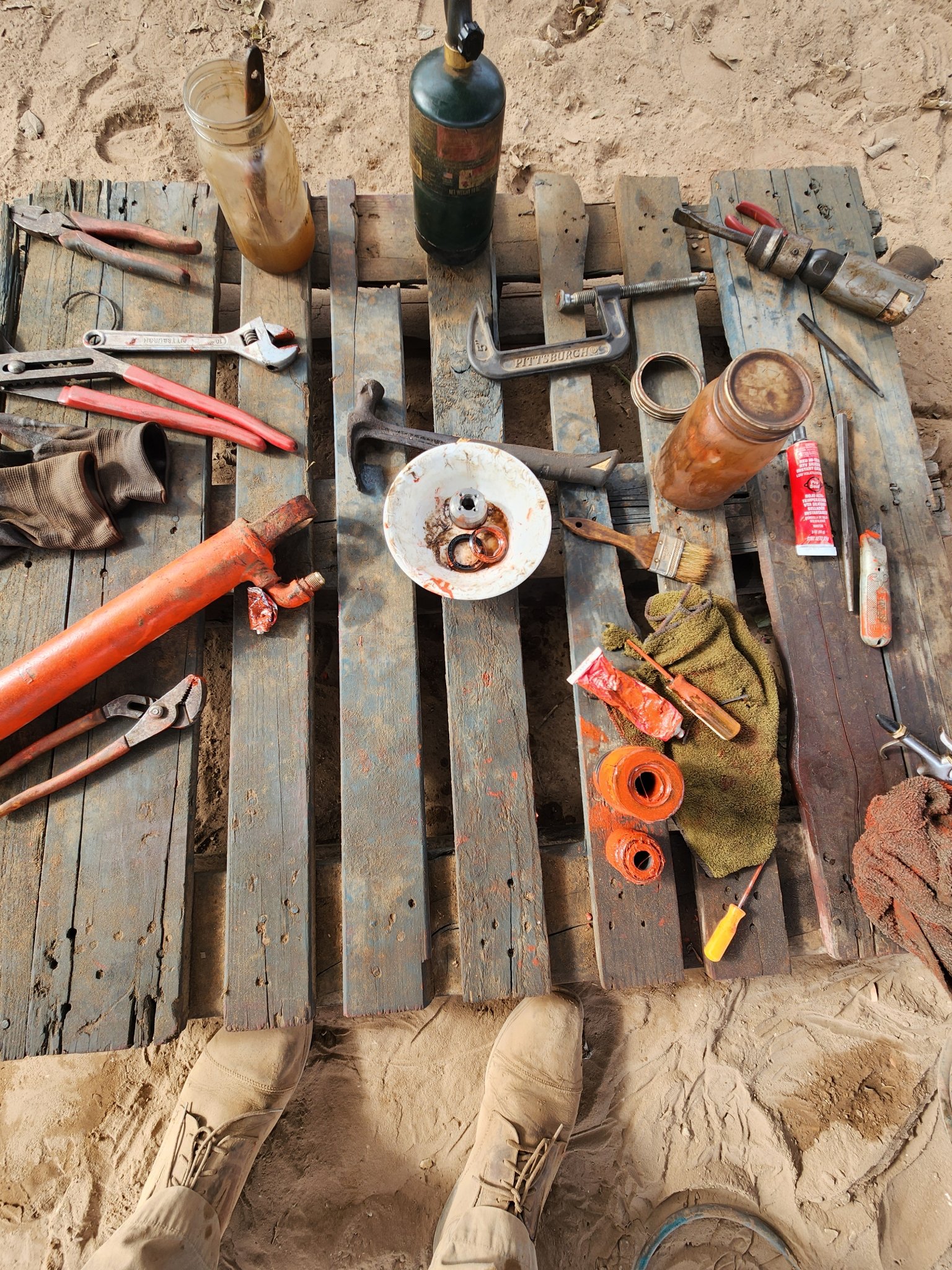

make you workstation out of pallet, clean everything with solvent/air, take you out all the seal, who care if some break, gob everything in gasket maker
keep you going, taking them apart, sealing them up in this way, and sealing up all the fitting, anywhere there is hydraulic pressure, you seal
show you before you close up the cylinder
one done, 3 more to go, your close to having your robot functioning

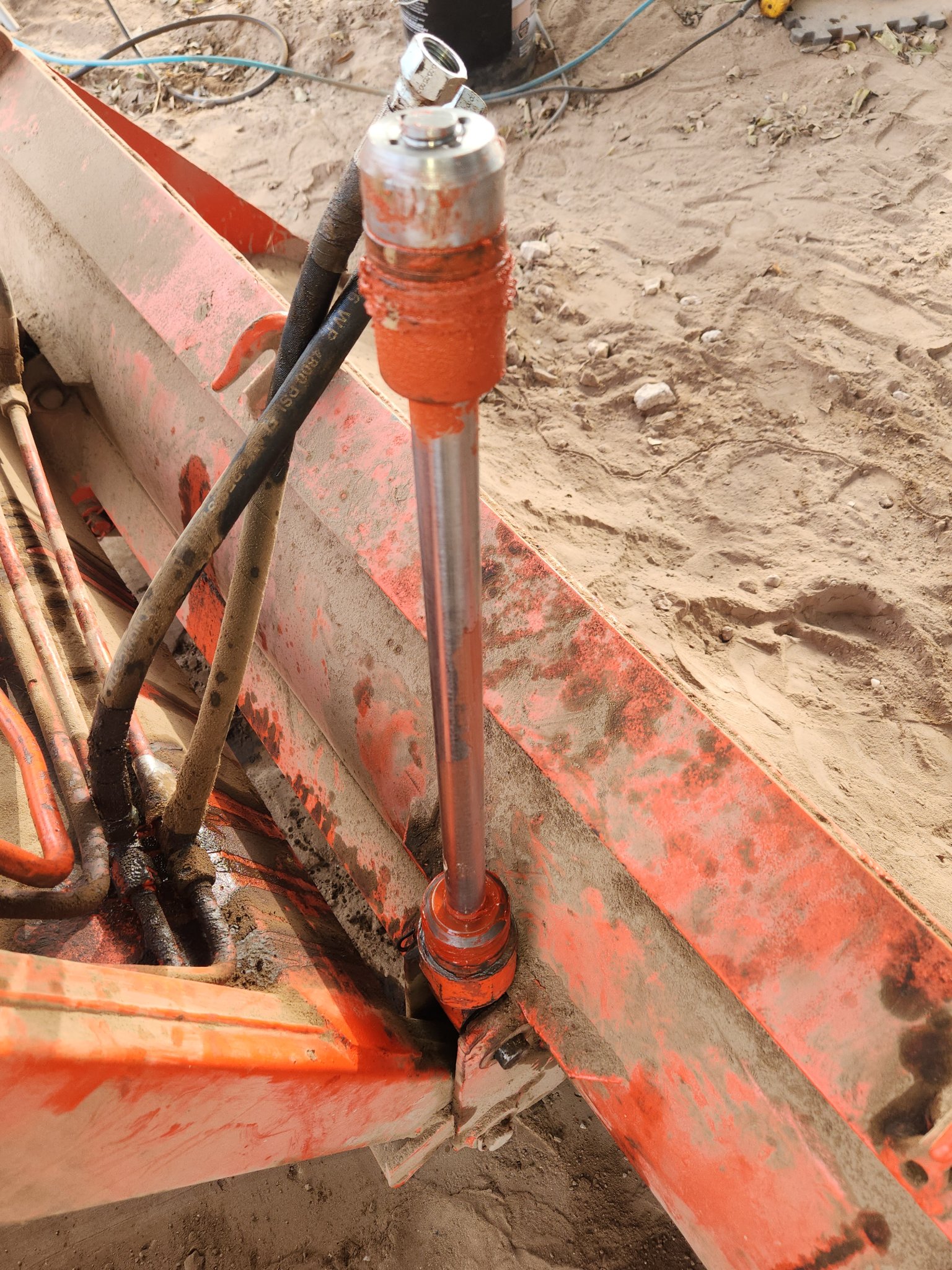

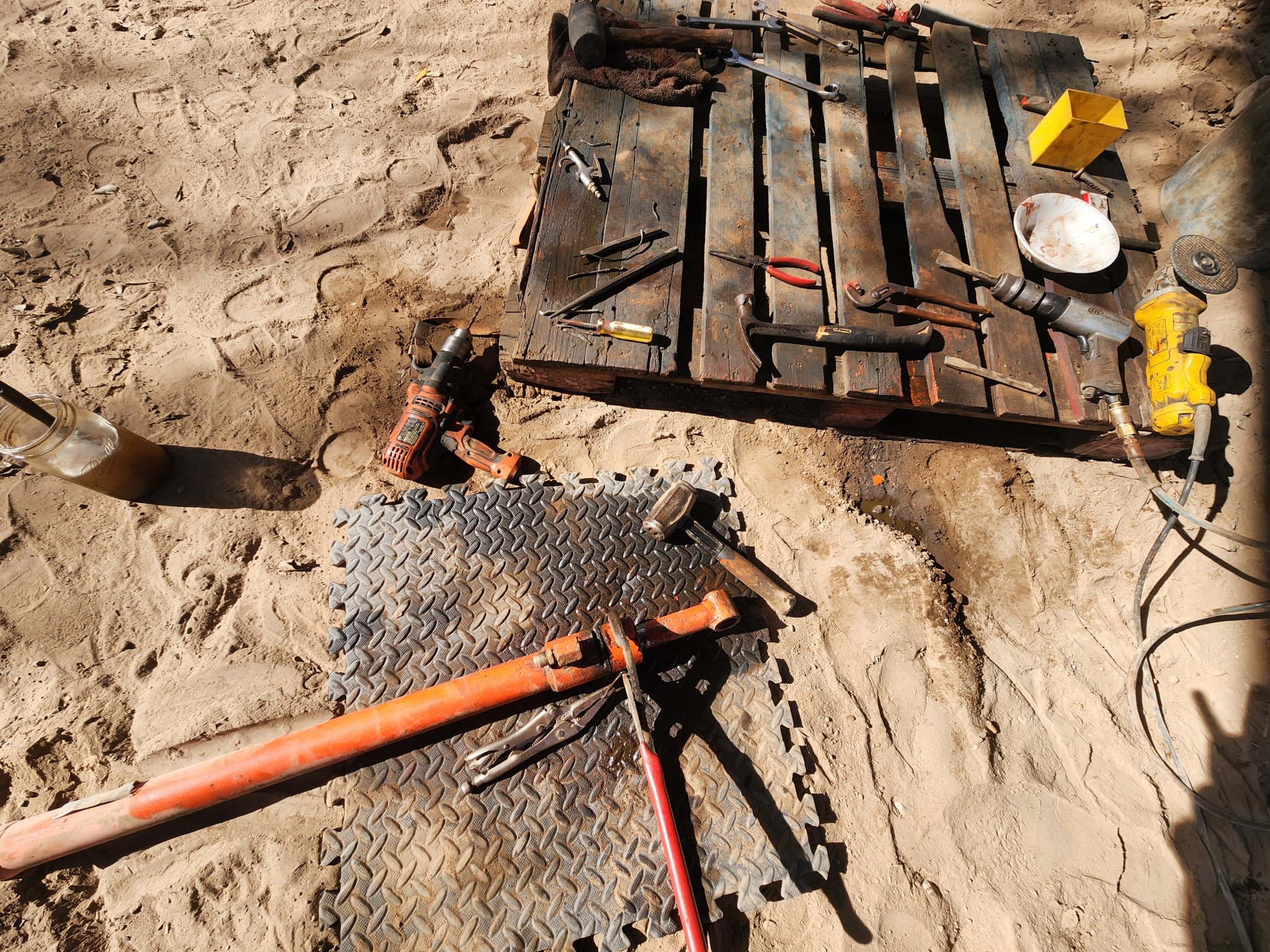

Lift cylinders are welded on, grind everything down, hit hard with small torch and maybe big torch, sledehammer and big chisel, get you out one pin, get in there and do surgery on both cylinder
@north wolf
yes I listen, I have not pump hydraulic into it yet, let it cure, i was fixing to remove lift cylinder
ok i see what you mean, hydraulic fluid will break it down and flood the system with small pieces
hit you both pin with grinding wheel until you see separation, then soak in diesel, hit hard with torches, smack with sledgehammer
take you out 3rd cylinder to rebuild
I'll never understand this ring, got it fully stuck inside cant open up cylinder
@dragfan66
yes, I see that now, I just grinded welds for an hour or more for nothing

get you a cut off disc, cut into it, get a nail and hit the ring until it come out toward you, go in there with surgically stuff to pull it out
that ring is the reason why people give up and get new cylinder,
get you inside that cylinder and do you the surgery to seal it

got the ring out, rebuild cylinder
proof of flaws:
I just spend 2 hours hammering like no tomorrow, cutting, sparks are flying from my strikes
only to find out, all you had to do was spin the cylinder and reveal you the ring to grab, and yank on it and spin more and it come out
2 hours of maniacal destruction for nothing, unbelieveable
entire day of energy gone and you still have not separated cylinder
I bet there is a really smart way to do this, you would pump pressure into the side you want to push and it would pop it out
fill it with transmission fluid and acetone, leave it alone, go take off other lift cylinder

stop hammering, chain you up both side, pull on cylinder with pickup truck
Separate you your cylinder, unbelieveable
rebuild your cylinder while you ponder -
why did I waste all that energy? Why do I forget about the methods that I have already discovered?
just unscrewing this took big effort, big torch time, tons of diesel
take off everything, clean and reseal, put back onto loader
cannot screw the piston head back in, fully defeated, unable to stand
grind you down those threads to let it screw in easier
you wasted ton of energy incorrectly, you plan to do 10 things, you didnt even get one done
Chanceywd
Mar 26, 2021
744
687
central ny
proof of flaws:
Maybe not look at a hammer as the first tool you reach for every time??
