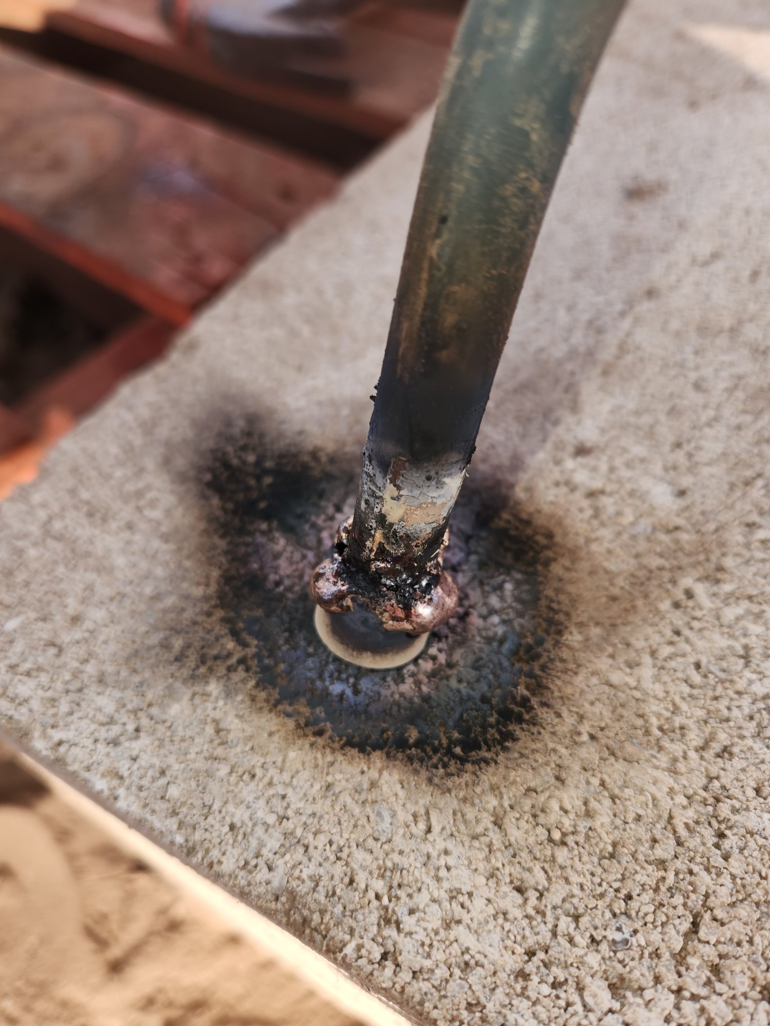

clean that area up with solvent, put you some carpet over the big hydraulic mess, first tighten them and see how much she leak, then if she still leak,
get under there with the aceytelene torch, and try to seal those leaks up since you dont have the right plumbing etc
fasten you all the lines on everything, nervous that the robotic might knock the tractor off of its blocks, put you the wheel back on

unbelieveable, your little weld job on the busted manifold holding, no black smoke dirtying up engine bay

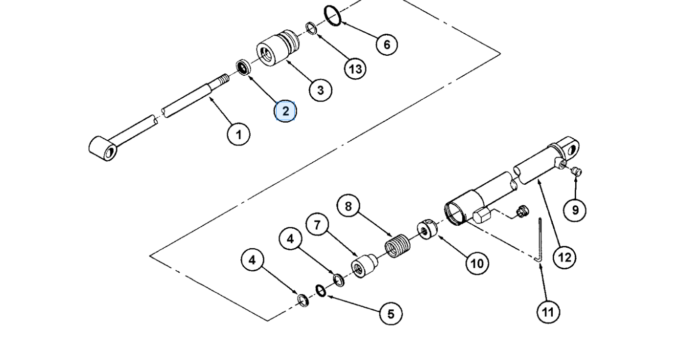

take apart cylinder: at a glance, it need to be clamped down, get you a pipe wrench, try to loosen top,
look at diagram, see how it screws into itself, and then see if you can take it apart
you study this diagram until you understand how it come apart, maybe go hammer on that other cylinder pin and get that 2nd bucket cylinder remove

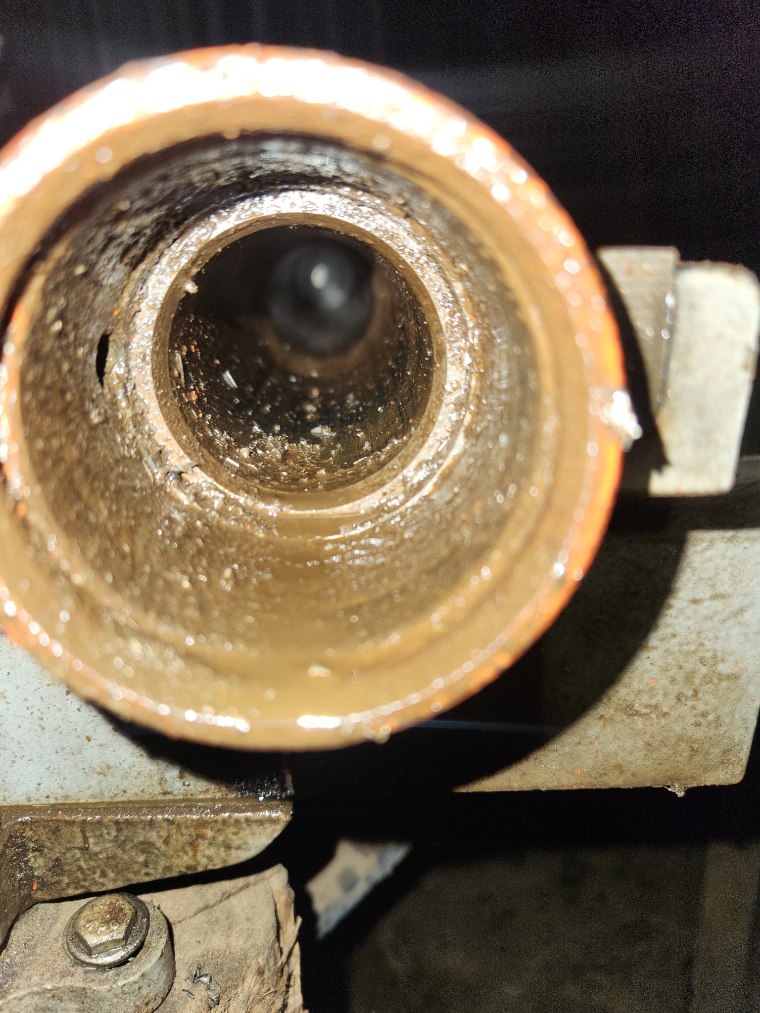

look you inside your cylinder, filled with ton of dirt/metal
turns out, all that debris was completely blocking the flow of the fluid
clean you everything and put back together

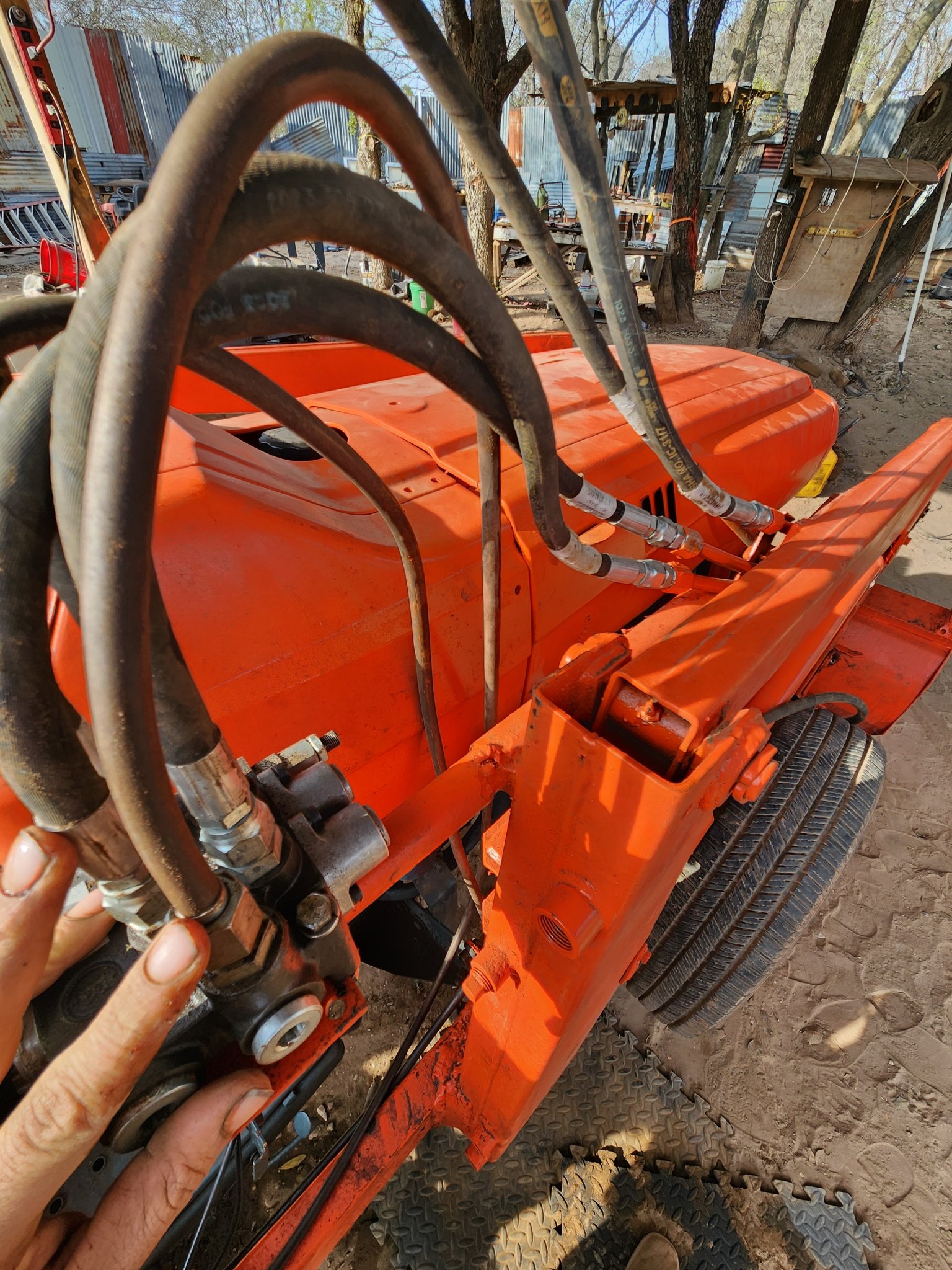

I may be wrong but in looking at the tubes you ran after cutting into the pressure line. If that first one is from the pump and you connected it to the right side of the valve it could be wrong. I would think that it would be on the left and the one going to the back of the tractor is your return. Yeah you introduce a lot of junk into your cylinders and they need to be cleaned but if those 2 lines are crossed nothing may work right.

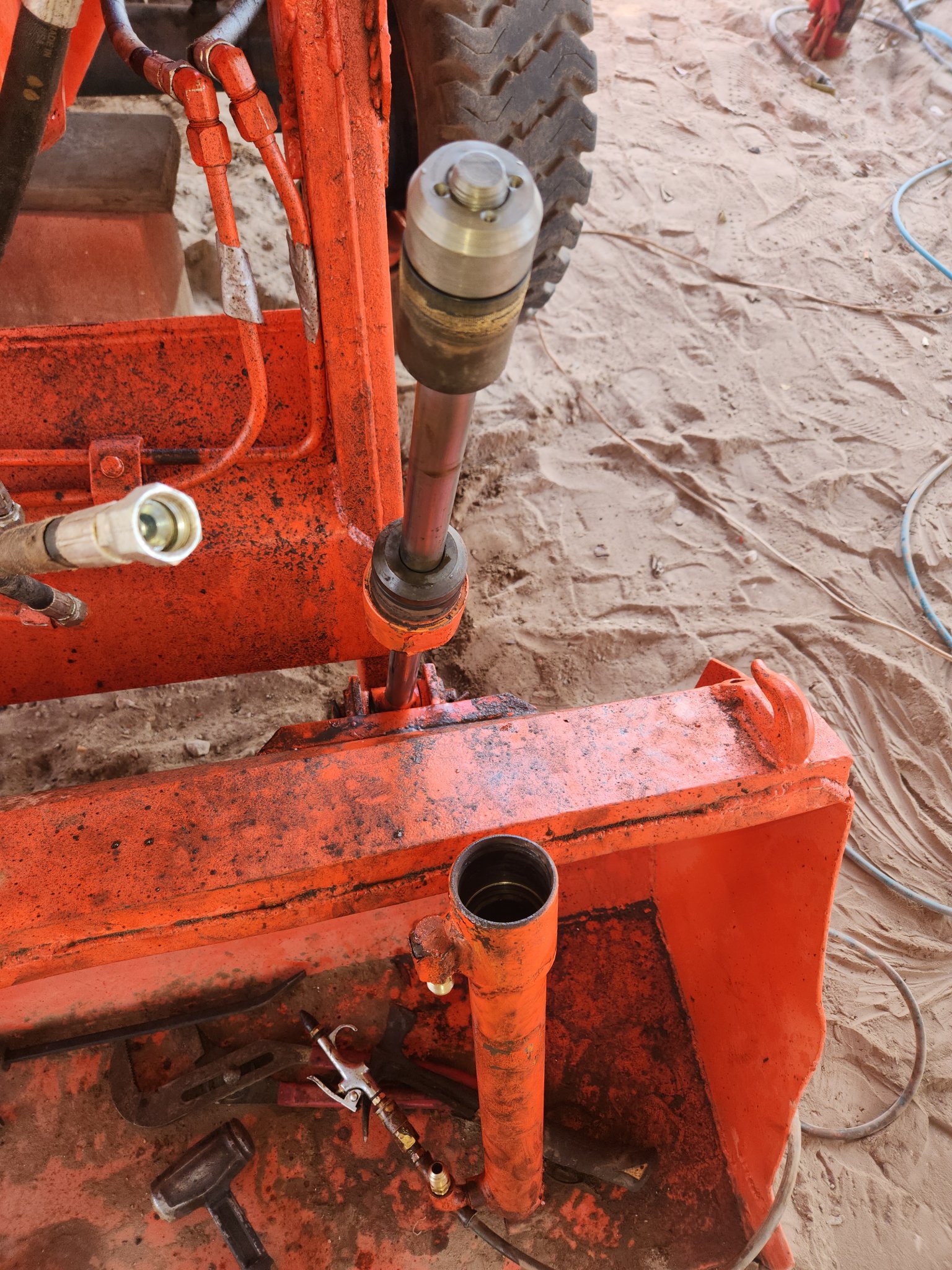

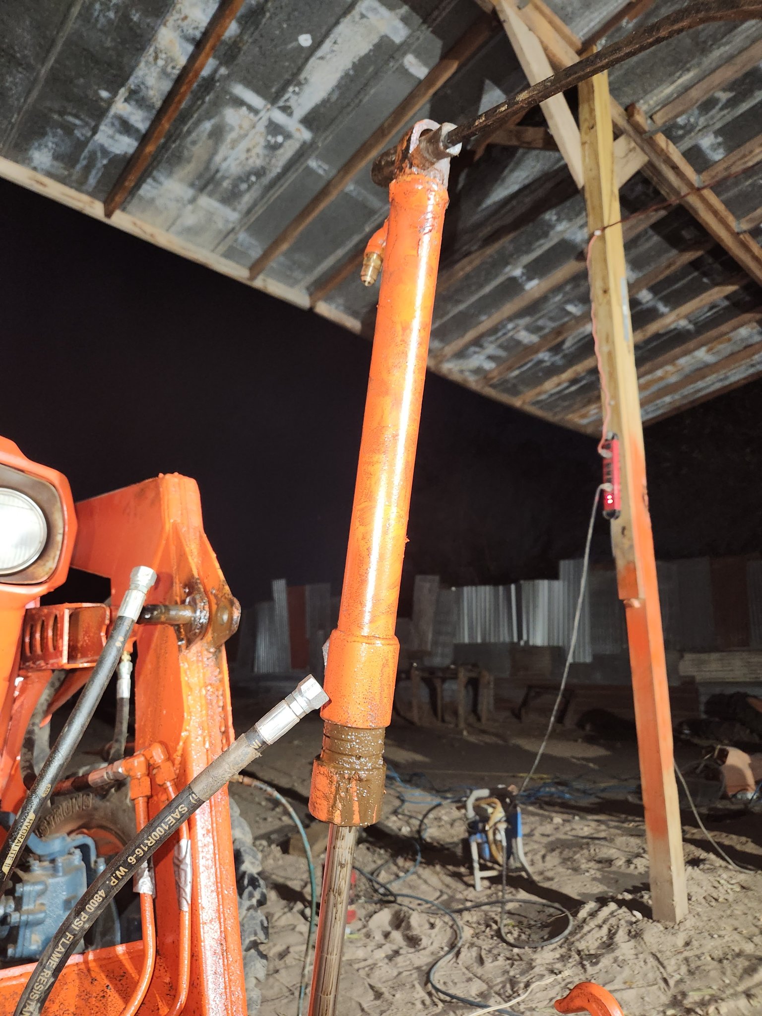

clean your cylinder, grind down where the pins hold the cylinder, mock it up and test hydraulic
clean you 2nd cylinder withouut taking out bottom pin, compress air and solvent, and files, etc, get all the dirt out
clean you out where the pins slide using hard wire wheel or big drill bit
grind down the pins so they slide easily, reinstall both cylinder, see if your cleaning worked
clean you out those pins, now they slide easy, put in your cylinder, fasten hydraulic line
Start you up your tractor, get you hydraulic pressure, play with the valve and see if you can move the bucket, nope

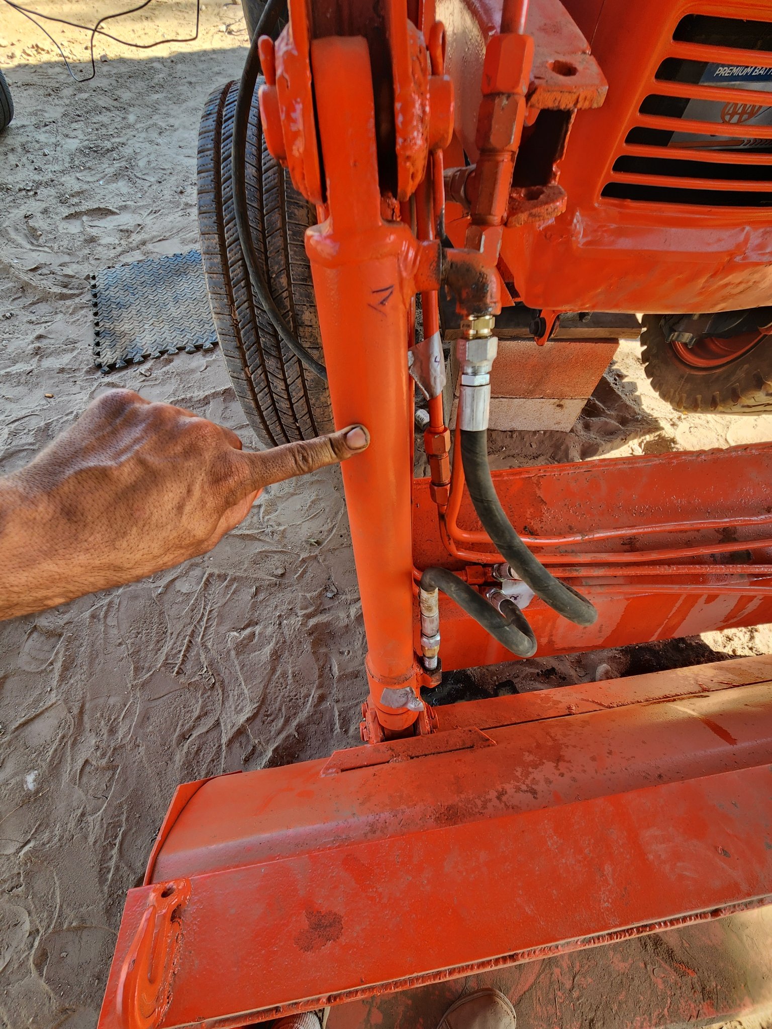

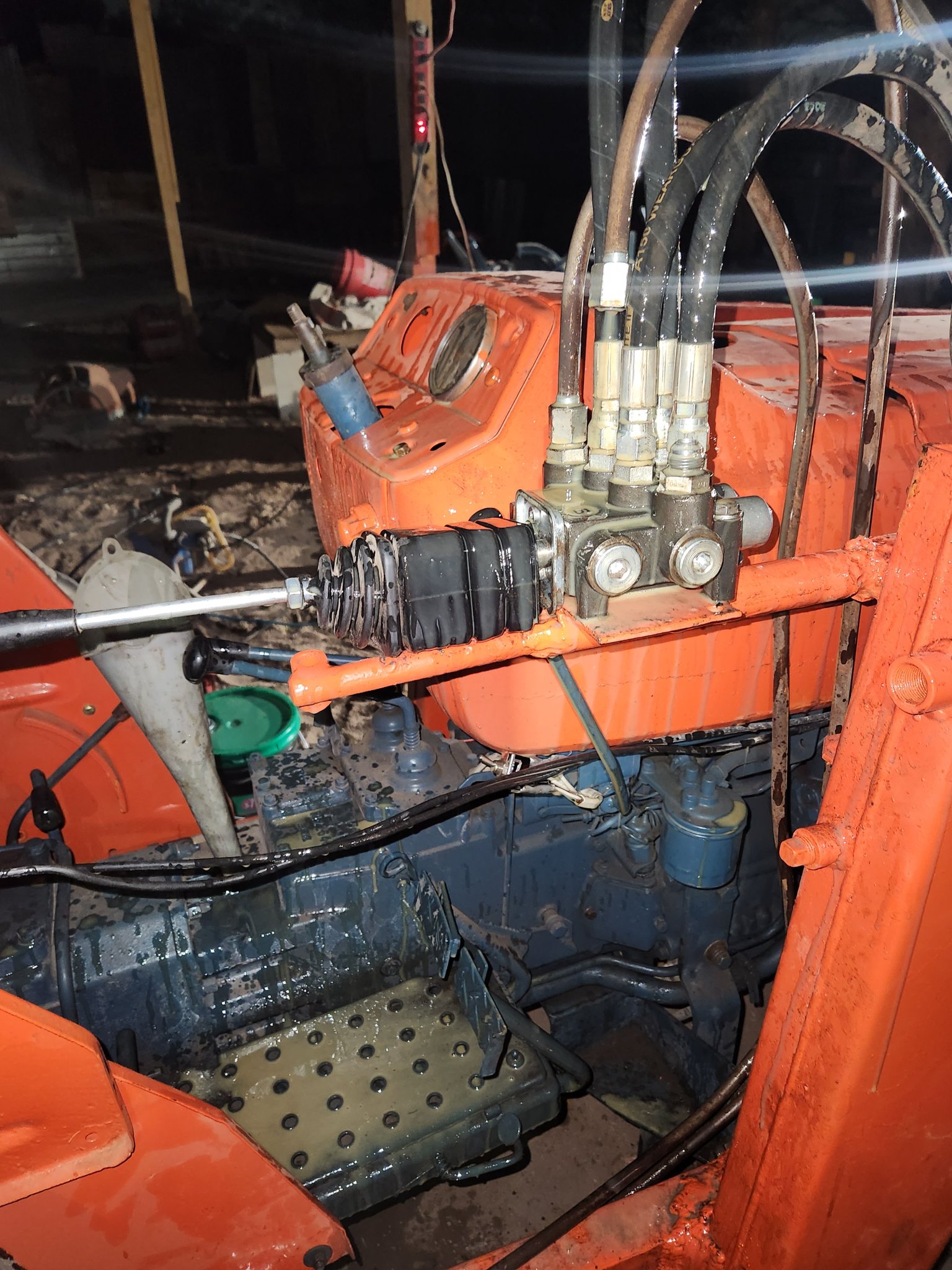

your finger touching the two lines to switch, you fixing to maybe try to switch the input and output you ran from your hydraulic pump into the FEL valve
switch you out those two lines, try again, nope
something else is wrong: maybe the route I have them connected is wrong
look at the diagram, see if your lines are proper
could also be the leak that you havent fixed yet
There is a smaller leak where I spliced the hydraulic line, maybe
that leak is stopping it from building enough pressure to move the heavy bucket...

I retraced line 1 which is bucket down, its route:
Controller - goes to top of bucket cylinder, to extend it down
Line 2: go to bottom bucket cylinder
you did look at diagram and that is how they have it

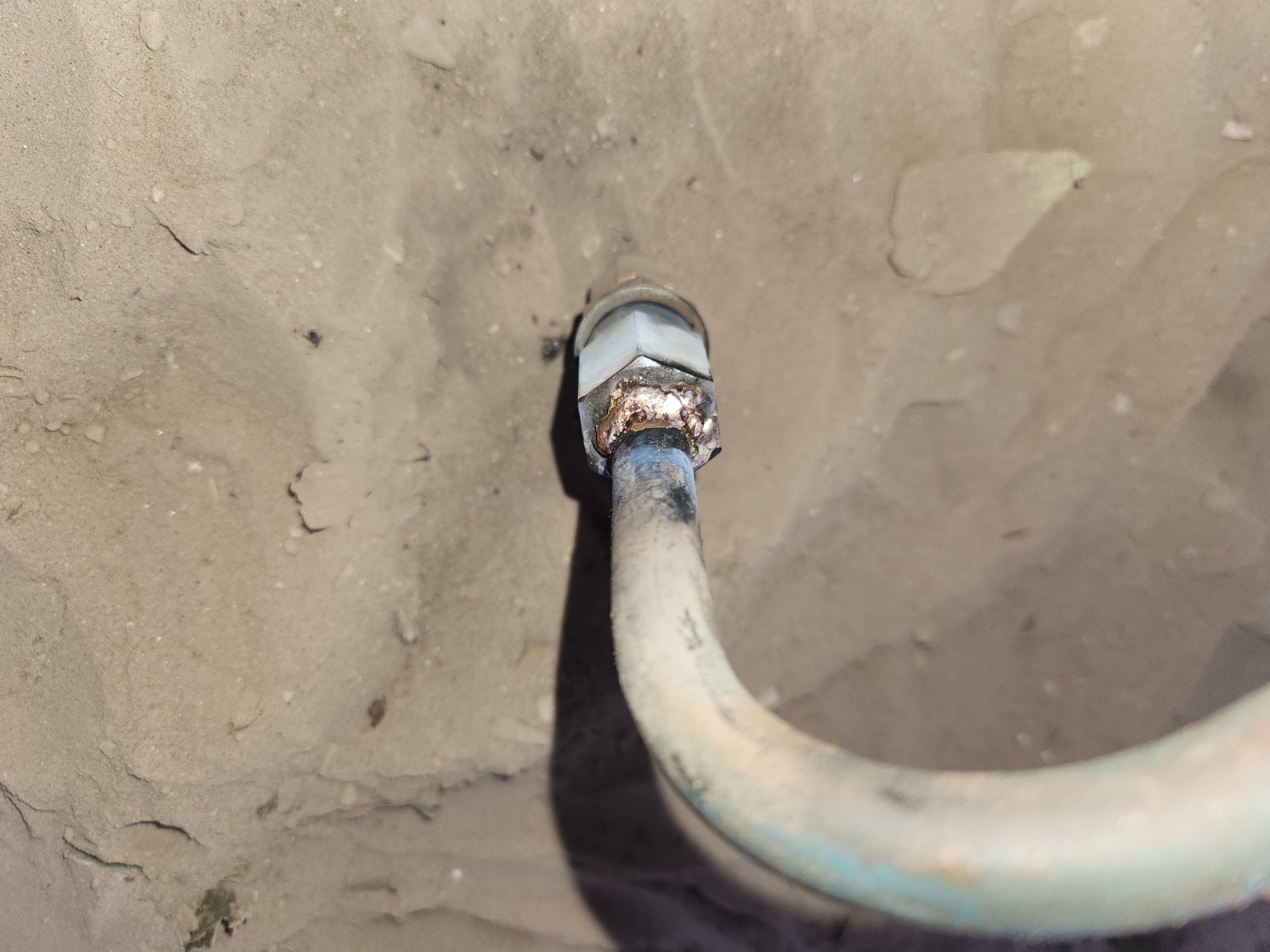

weld you that collar onto the line in the position shown in photo
long as that collar seal to that pipe, your screw tapered fitting will seal that leak
do that for both line, maybe: hydraulic fluid in system too low to build pressure, put you some fluid and raise RPM for next try
weld you on that fitting you couldnt flare
grind it down enough so the female screw can go above it and make th seal
put you another weld on the outside of the female piece and the hydraulic,
make you your own plumbing, dont rely on the part store
This is the 2nd flaring that was leaking one of the harder welds you need to do:
bend you that line down away from tractor, get you in the prone position flame pointing forward, lay you that bronze trying to fill the gap, lay you on your side, bring the bronze in from back left and the flame from right side and melt you that backside that you couldnt see
if that weld dont leak, it would be a surprise
Hook you everything back up, no
Your welds did not stop the leak, both weld have tiny leak

notice that it is not pushing out fluid, but air
Put you some hydraulic fluid, it gushes out the top get your new paint cover in transmission fluid
robot move!

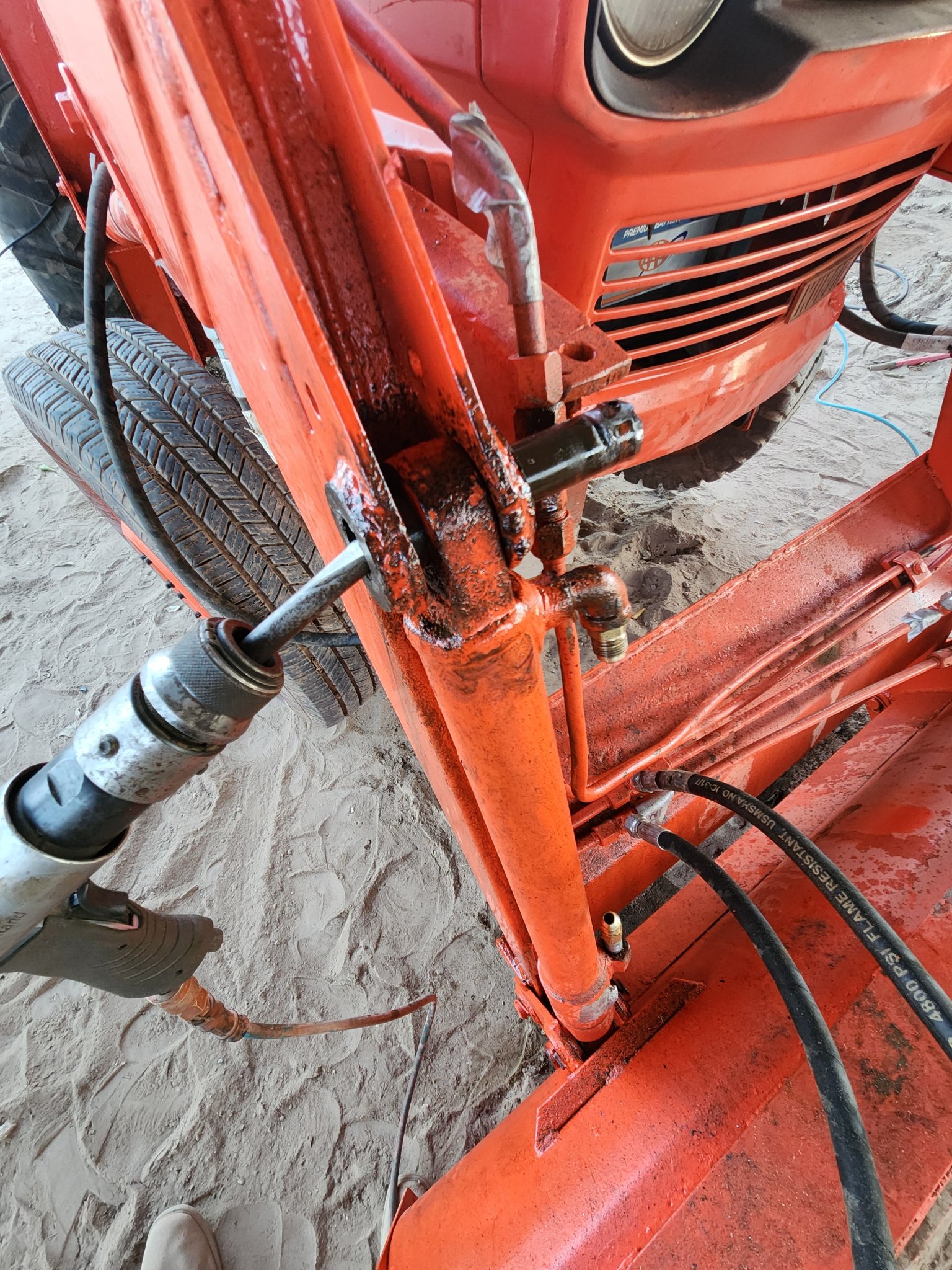

put you 4-5 gallon hydraulic fluid, turn on your engine, pump sounded way different, had no pressure before, turn your levers,
robot start to move, pop out your two cylinders that you cleaned but you improperly put them back together,
there is a ring that I damaged and dont know how to reinstall that hold the cylinder from coming apart
lesson: sometime the problem way simpler than you think, go smoke you some fatty meat and the answer reveal itself
up close of you putting in the ring, it keep the cylinder from popping out
you mustve spent 1 plus getting those rings in, only in the end you found a way to get it in:

Is that copper tube? :eek:o_O
The maximum working pressure for a 1/2 in copper tube is 769 psi at 100°F,

grind you down where your fitting pop off, slide you in another fitting, fasten it tight
bend hydraulic line down, brush the area with solvent,
bring you out that big flame and make you some magic trying to seal it again
dont bend back everything into place until all those leaks are finished, use a hydraulic hose and get engine running, see if she still leak
"you happy now? finally got your robot fix"
that weld you just did has zero leak, take you off your other leaking weld and fix it, reinstall it, then
go carve you some earth
make you your own plumbing, eliminate any chance of leak, do big oxygen and tiny acetylene
let it cool down, dip in bucket of water, install it, see if it still leak
you aint carving no earth
ton of leaks: bottom of 2 cylinders that you cleaned, tiny leak on your last weld, leak where input into transmission, might have dropped the seal, check it again
you want to carve earth but you cant, leaks are too big, also
it has big trouble lowering the lift, it almost want to shut off engine, why?
Fluid inside so dirty, it is messing with the flow of hydraulics causing system to come to halt, ie straining the engine
does not happen with the cylinders you cleaned
carved you some earth, hydraulics now fully stuck, i dont think it is low on fluid but maybe, keep carving earth
later: take out all loader cylinders and clean them and seal them surgically, now
enjoy the machine doing the work for once
