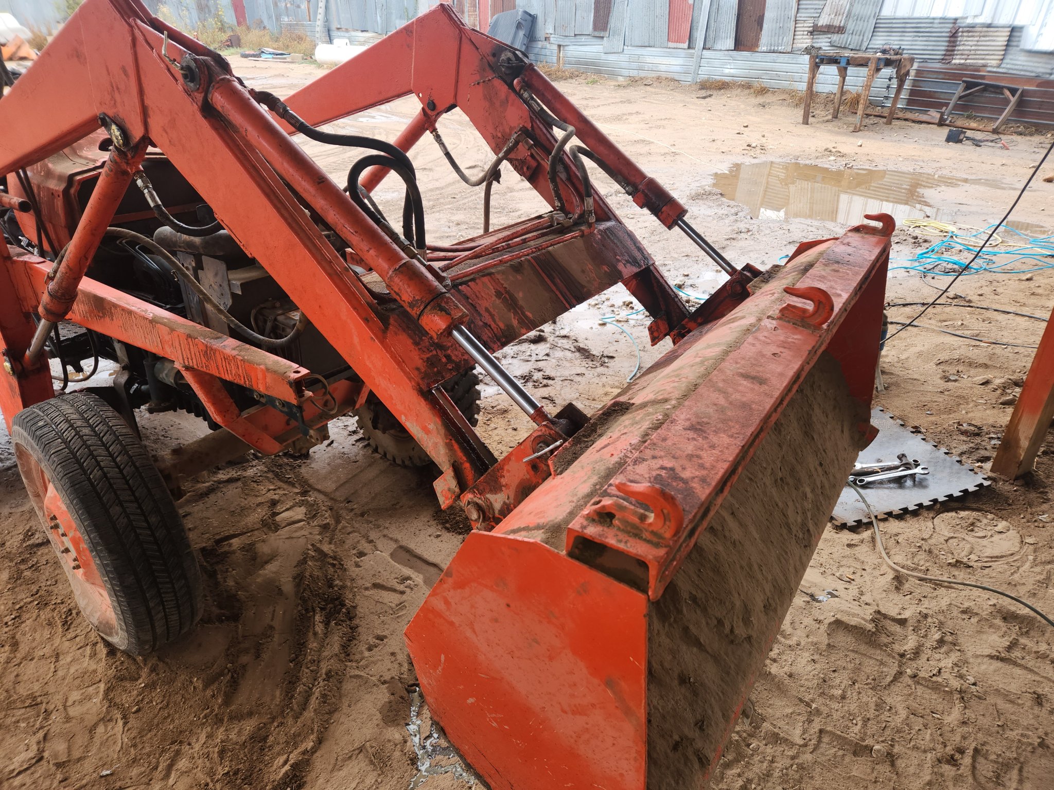

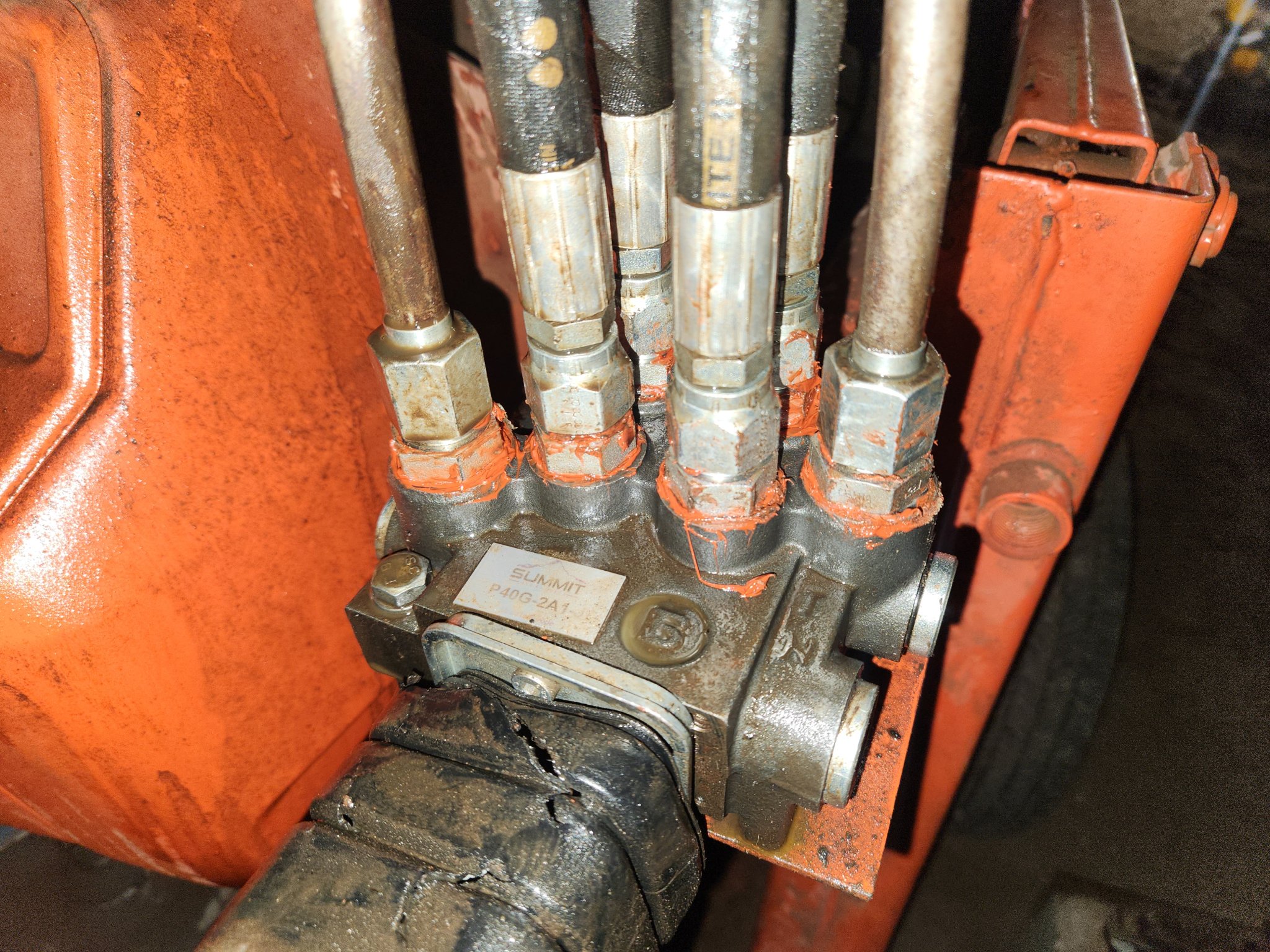

seal up hydraulic/diesel, give up on the last cylinder

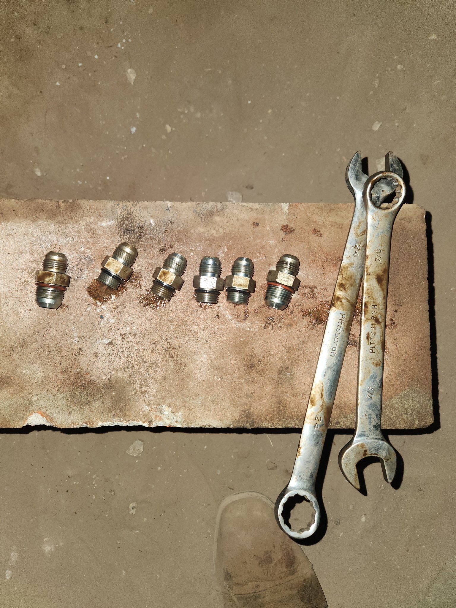

all your fittings from your FEL, take them all out, glob it all in gasket, make them tight
there was nothing wrong with the fitting, you just didnt fasten it all the way
seal you everything
the diesel leak was so obvious, one of your injectors from all that pressure, come loose, you surgically seal it
seal your diesel line

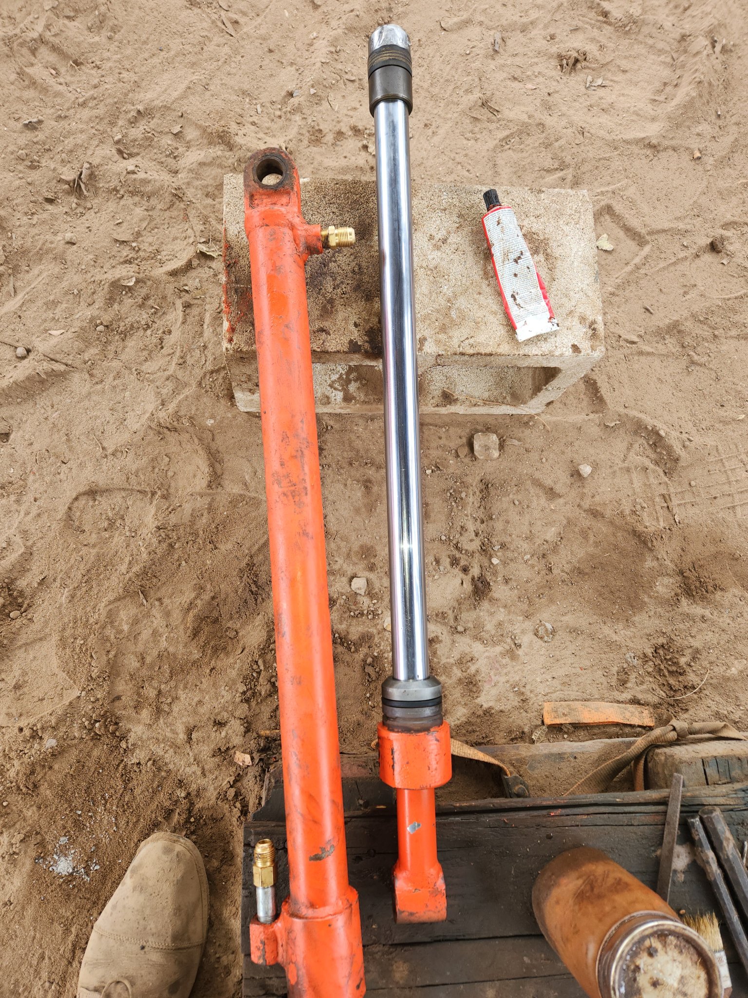

decision: you were defeated by that last hydraulic cylinder, clean it, and glob gasket maker around the seals, and hope for the best
go ahead and reassemble your hydraulic cylinder, and your hydraulic robot should not produce bubble since you seal up all hydraulic route, and your engine should not sputter out since you solved the diesel leak
you should be able to carve earth today even if one of your hydraulic cylinder still leak a bit, the hydraulic system should not produce bubble and your robot should function fine
do you a hillbilly rebuild, glob gasket maker and hopefully the pressure pushes it into the leaking area

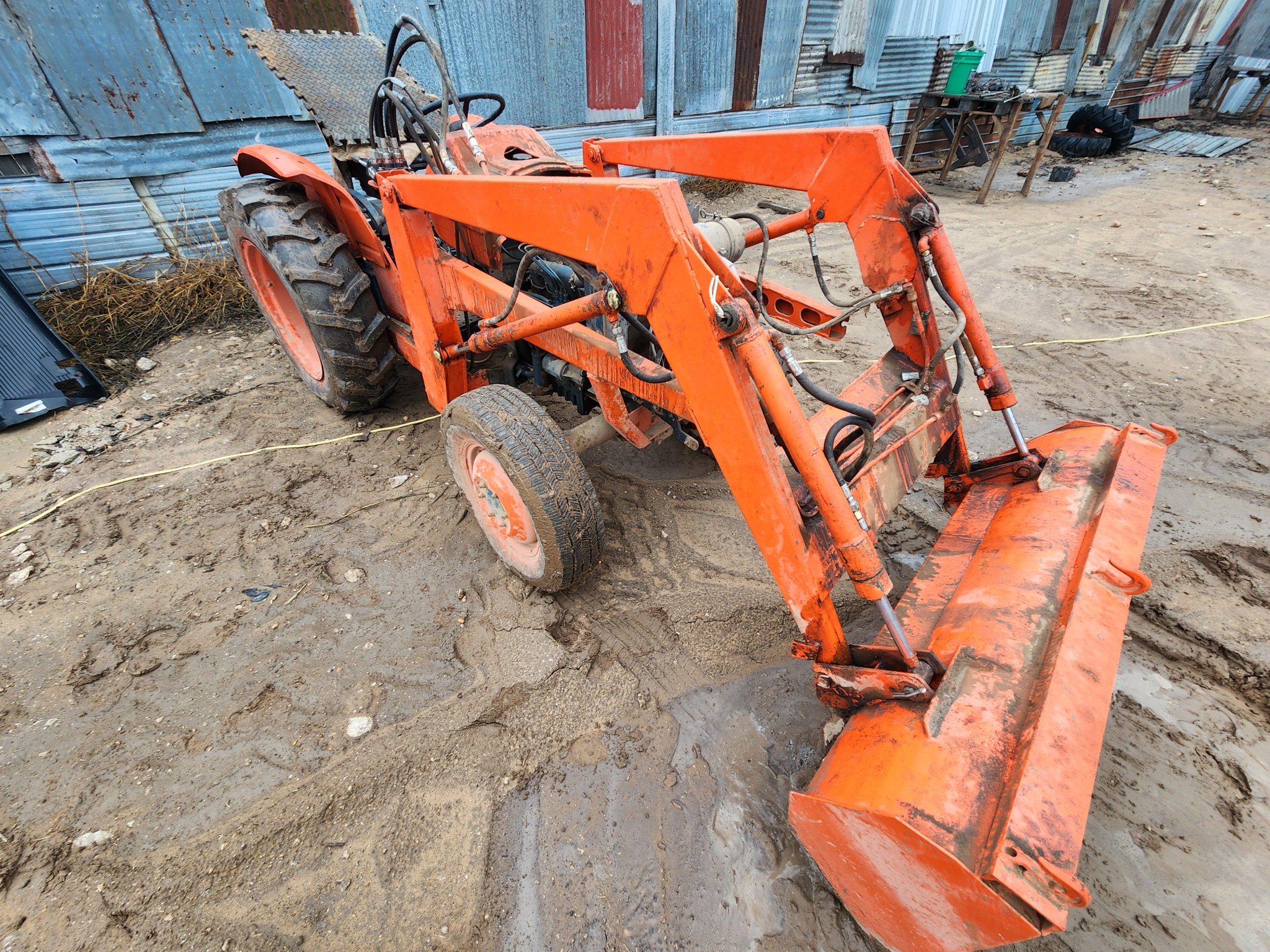

earth
hydraulics work, but still leaking cylinders
unbelieveable, the 2 cylinders you fully sealed are leaking,
but the 2 cylinders that defeated you are not leaking
wrap your head around that narrative while you go change the shape of your realm

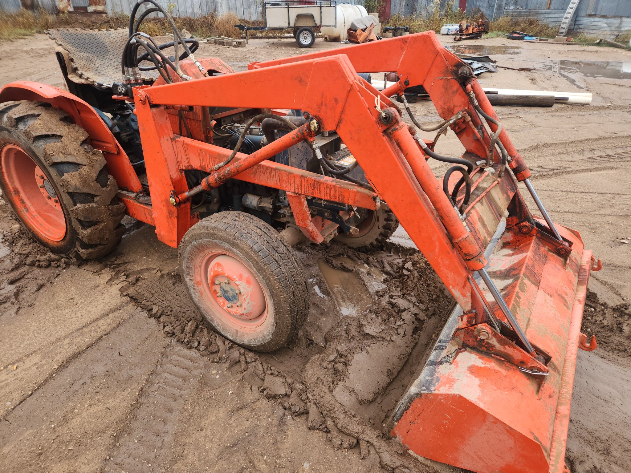

machine fully stuck in the dirt, hydraulics doing same thing, work when its cold, then nothing when it get hot, add some more fluid
add you 5 gallon hydraulic fluid, there are about 10 gallons of fluid total inside
describe what happens: turn on your engine, hydraulics work, 5 minutes later, hydraulics lock up
there are zero visible leaks, and you can see ton of fluid inside transmission, not bubbly
there is whining when hydraulics work, zero whining when they dont work
3 point hitch works fine when hydraulics work, does not work when hydraulics lock up
some dinosaur probably know the problem, go take off your hydraulic filter and see whats inside
take of cover of filter, let it spill out, work for 15 minute, hydraulic lock up
take you out your filter, boom, your hillbilly instinct was right
filter fully clogged, the fluid dirty

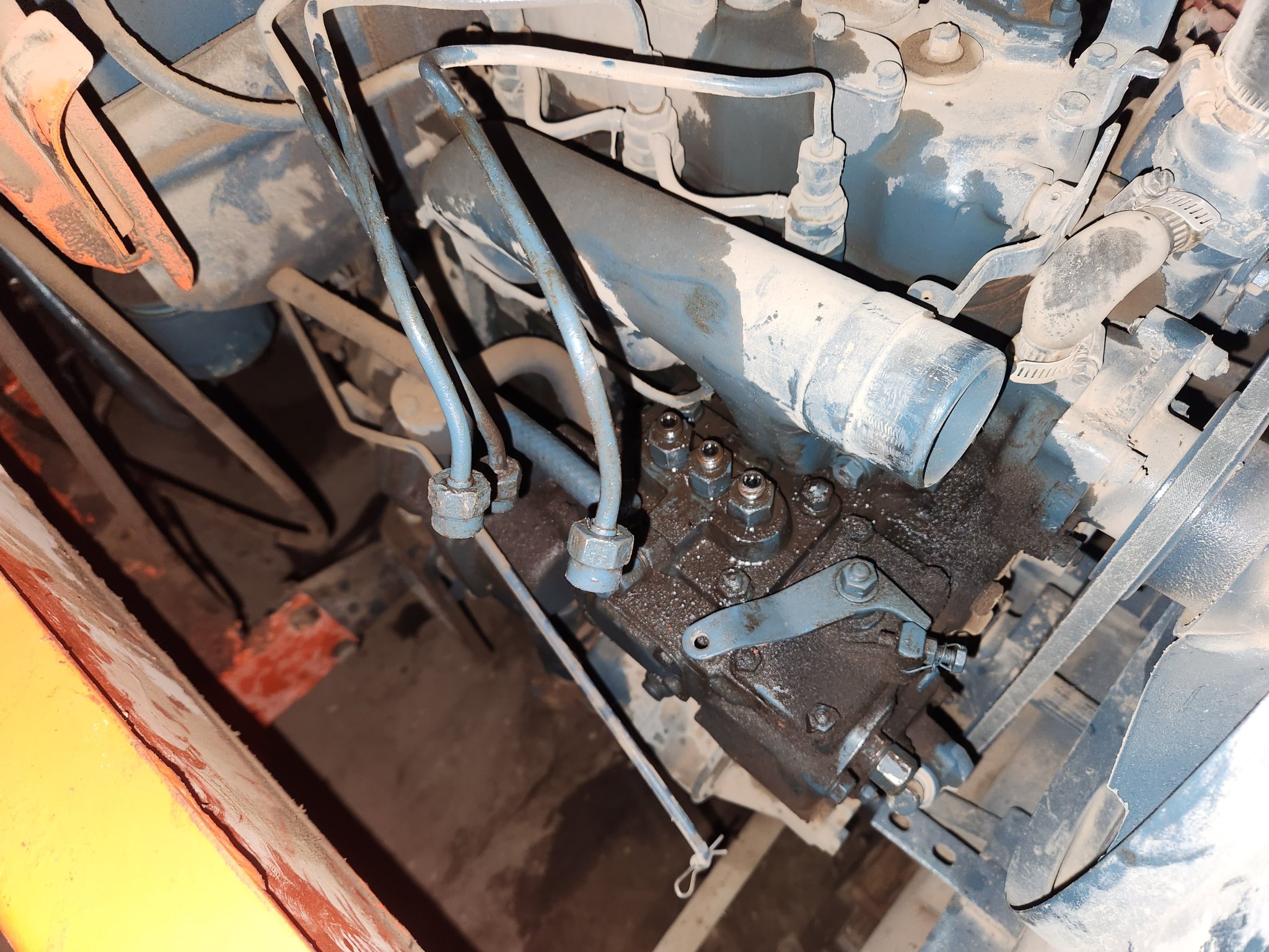

dip stick not showing oil, your engine eating your oil
give the haters a little something will ya?
its harder to start once she is hot because I think too much oil inside combustion chamber
please nature let it be something fixable in the head and not something where you gotta take off the loader
but you can still manage it, you can spray gasoline into intake when cranking, it helps alot
dont be mad your diesel engine eating its own oil, just be happy your diesel engine eating period

starter fluid: no, it does nothing, has zero effect on starting it when hot
only thing that works: spin you that injecton pump without engine compression, pump diesel into your combustion chamber, until the diesel wash away the oil

So, disassemble & clean all parts, check bore for size & pitting, (and if within tolerance) hone bore, polish ram, replace wear ring, replace all seals & o-rings, replace spring key, lube all parts with clean hydraulic fluid, and reassemble, and pressure test.
Right?

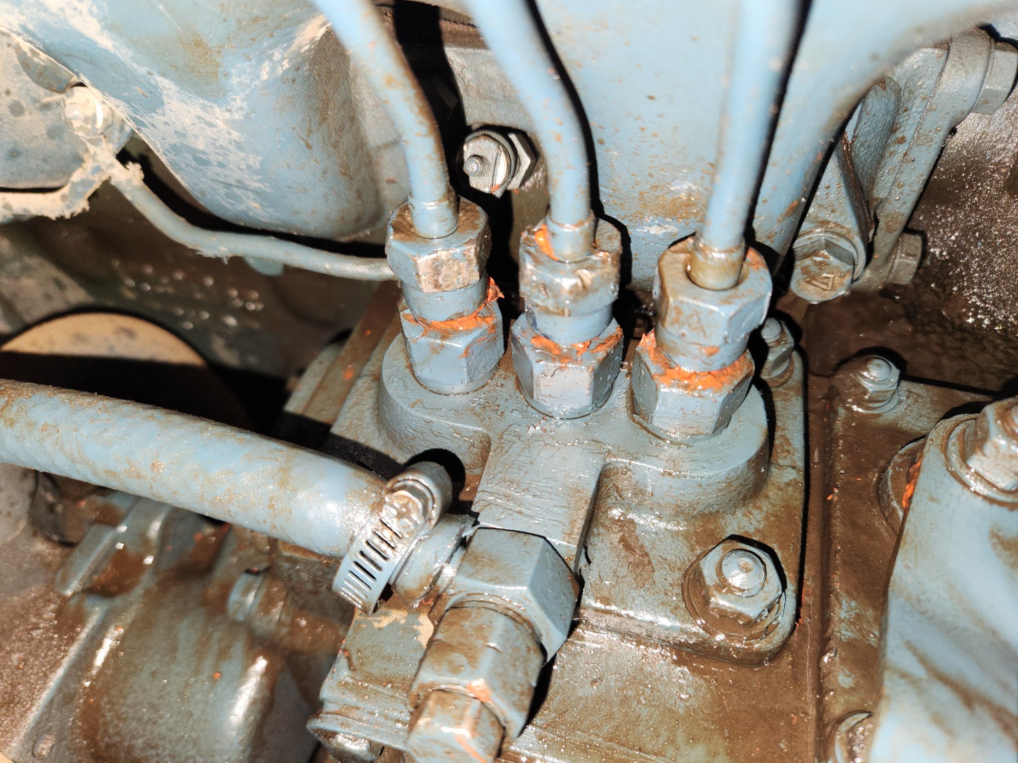

unbelieveable, turns out there was ZERO coolant in your engine
You carved 20-30 hour of earth with ZERO coolant in your engine
You point to it showing them where you think it is evaporating:
This used to be a temperature gauge, you put some sealer on it thinking it was good enough,
no, your an idiot, it has been evaporating this whole time and has been BONE DRY for the past few days that your machine has been smoking
Soak in that narrative while you go and SEAL with ton of jb weld that crevice
It was not your fault that much but still, check your fluid daily until you hash out all the problem
gob you up that area with jb weld while concluding:
