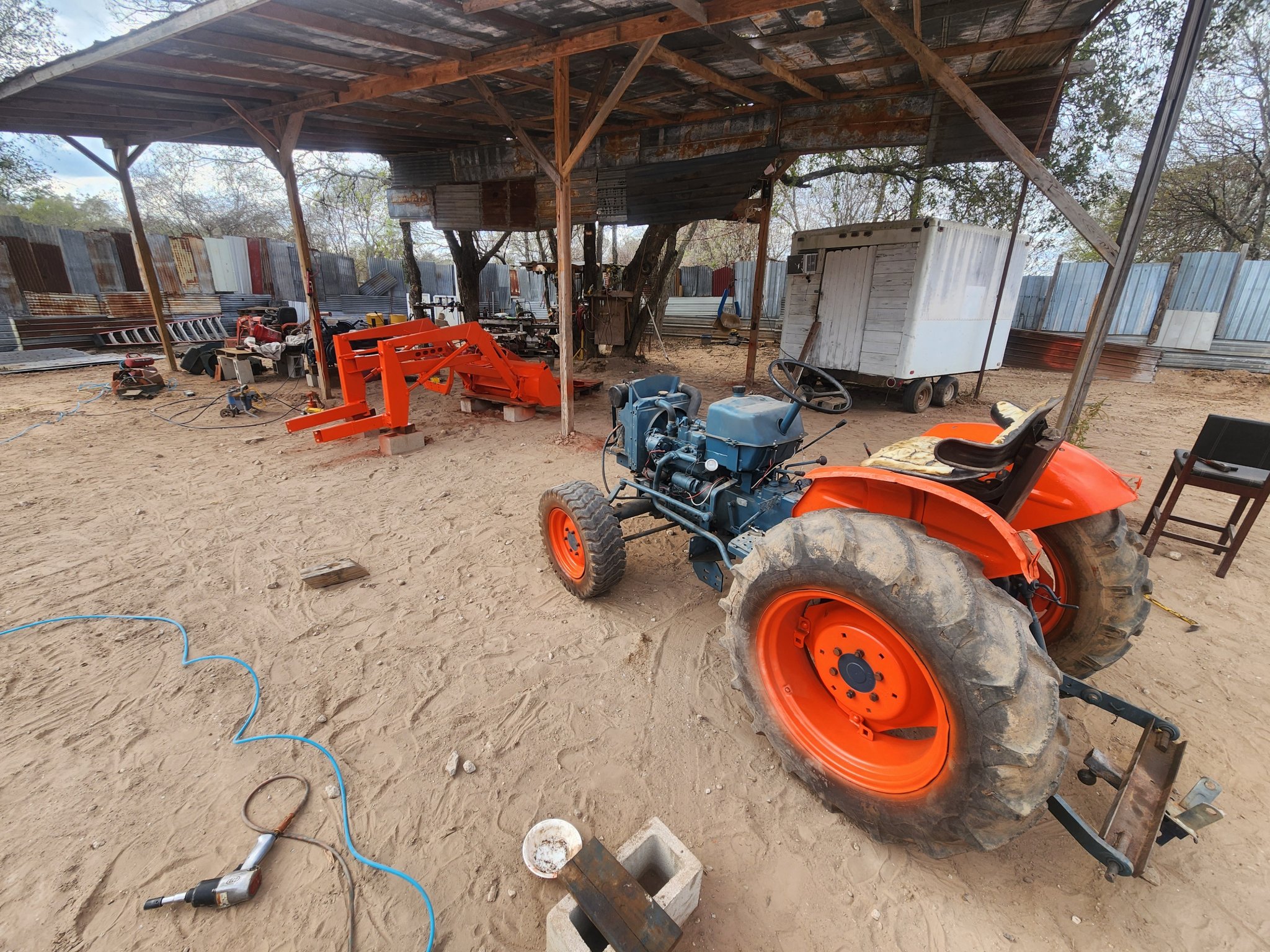

remove all cinderblock and lumber away from area, clear your workspace
(i write this to talk to you or myself if I read this later)

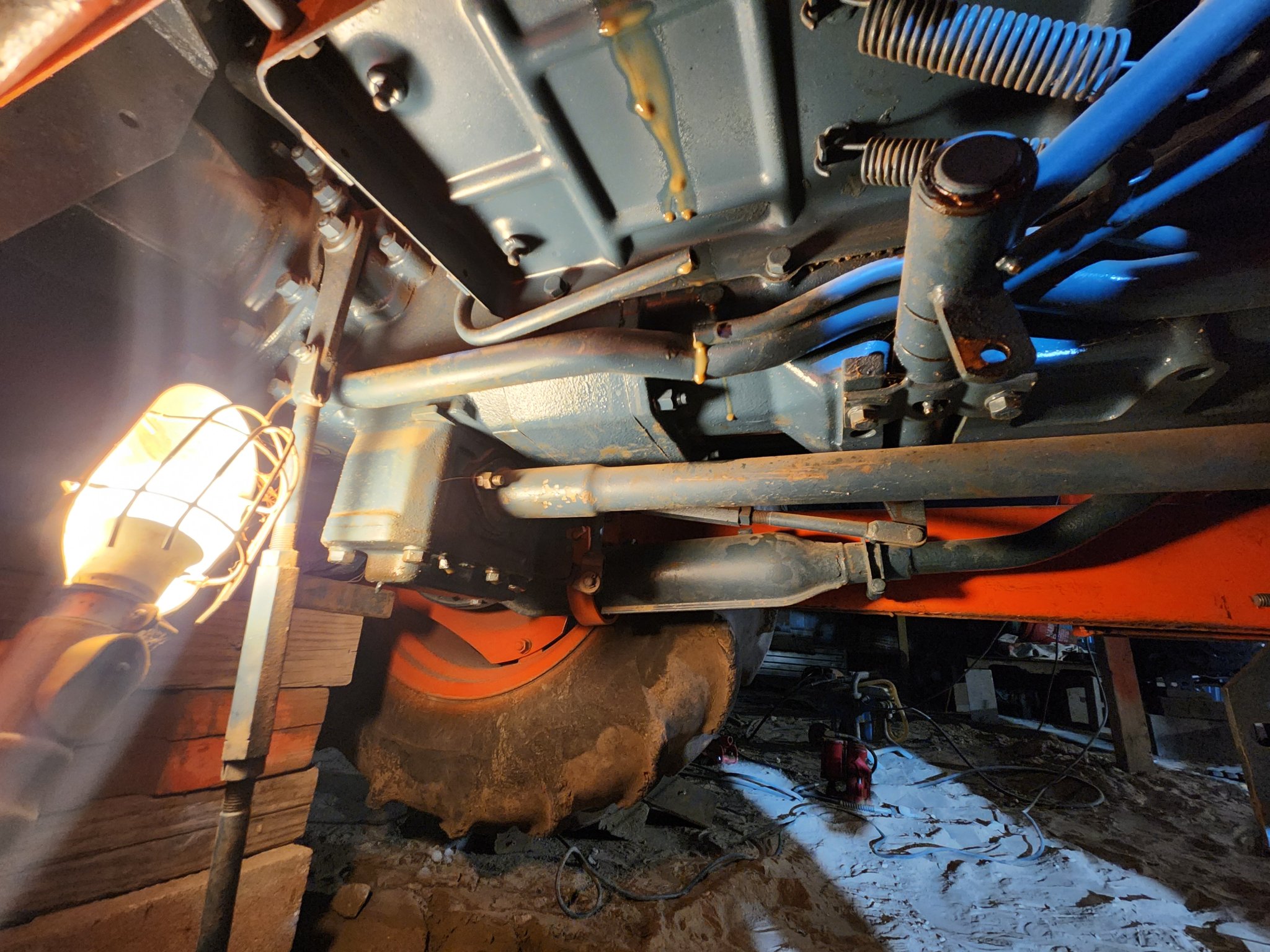

Here's a pile of lumber/cinderblock that was used to put the loader on, and the infinite amount of cheap jack to line up bolts, and the DEEP crawling on ground trying to get the bolts in

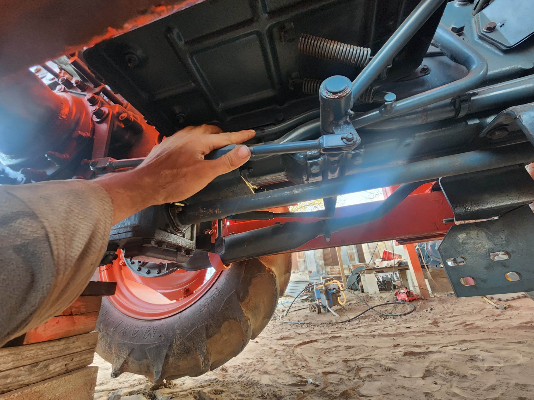

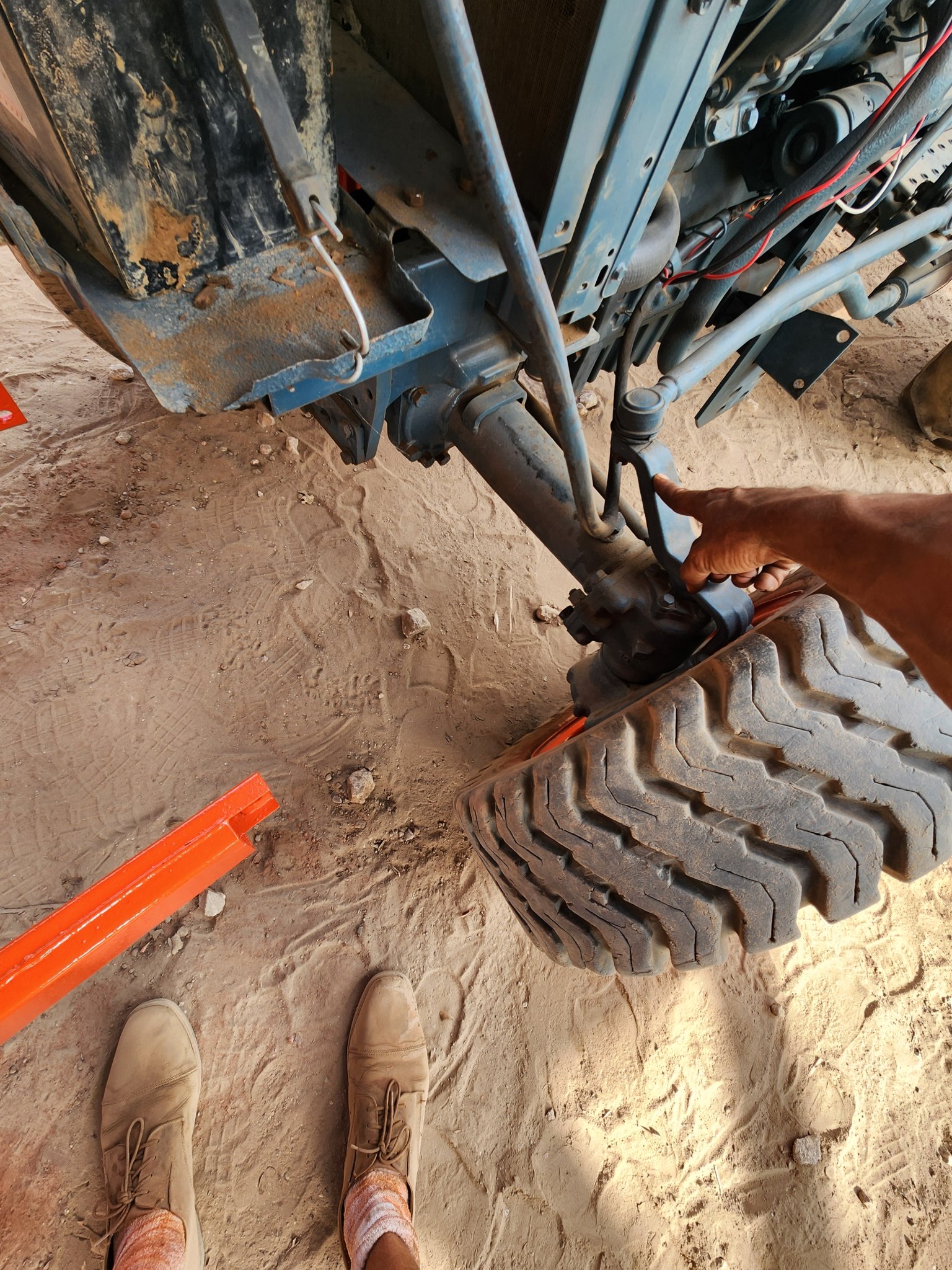

I was thinking: why does this make me so dizzy and consume all my power?
That task where you bend down get real deep underneath, then have to lift your entire existence over a little washer,
is a huge energy consumer. I am at the point where I want to rig up massive structure above machines, then I simple lift up entire machine and make those areas accessible and not make me dizzy
you cannot "work hard" because you'll be so tired and unable to make progress, and not get the gold...
bring the blocks back out because you cant reach anything underneath without getting a head injury
spend another hour chest to the ground getting blocks in place
yes, deep in this region, cutting your arms tightening the bolts, trying to emulate how it was,
dont make it too perfect, rig it back up good enough,

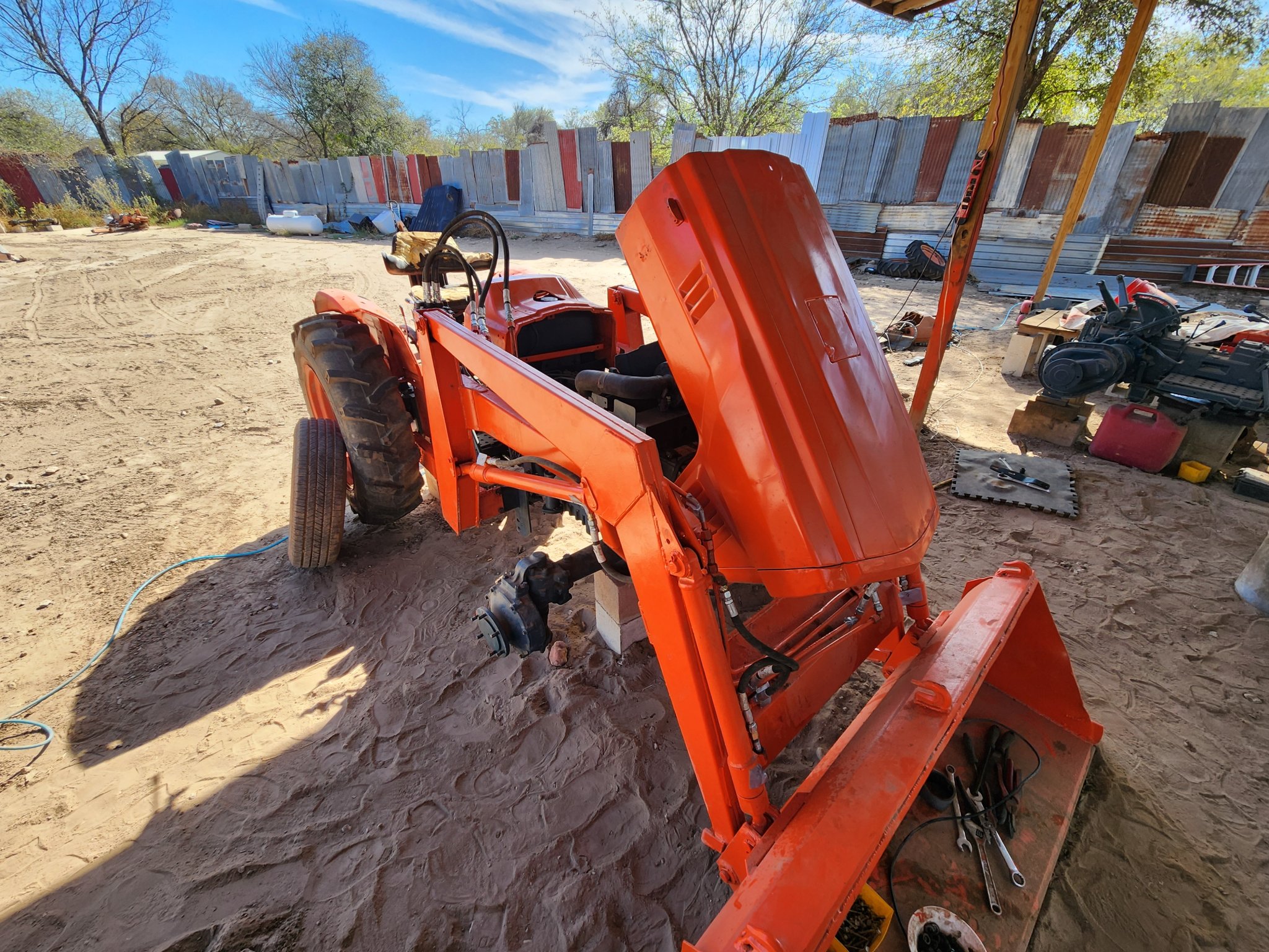

Take hood back off, clear out a pallet, bring all the hydraulic part, bring the hydraulic controller, mount it...
she's mean, angry, ready to tear the earth, you can sense it
clear out a pallet, bring all jic 8 fitting/hose/ and the controller
mount the controller, start to mock the hose connection...
controller: take it apart, clean with compress air and diesel, mock it up onto tractor, drill one hole to fit another bolt
last I mocked this up, it fell and tractor ran it over, now the levers are not turning
plan: get the bolts on it tight, put real pressure on the switch trying to see if it can work again

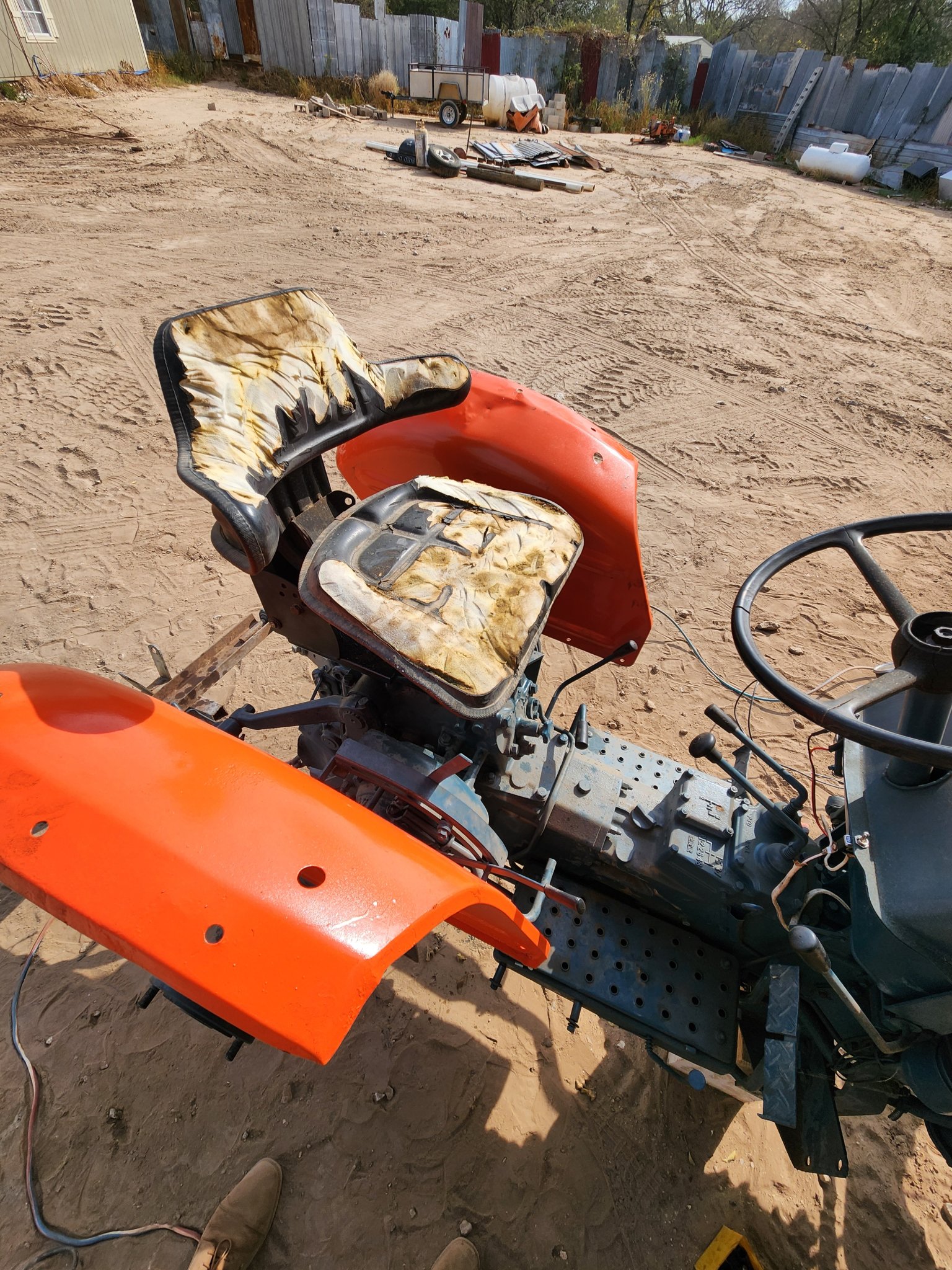

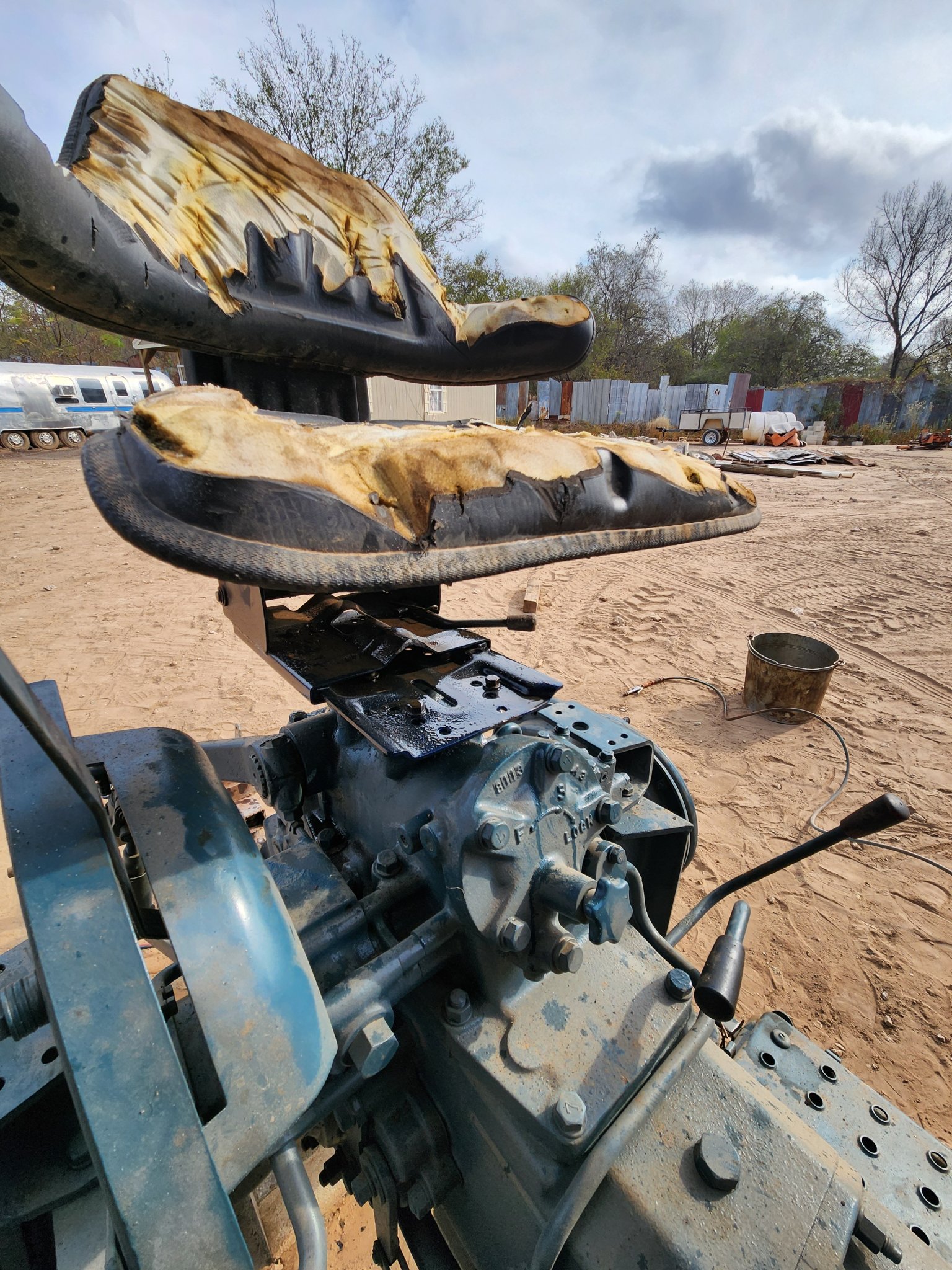

grind down seat, hit with compress air, got 2 or 3 bolt on the seat more straight, good enough for now, put towel over it, keep show moving
install fenders, seat no longer sharp, all it needed was 5 minute grinding wheel

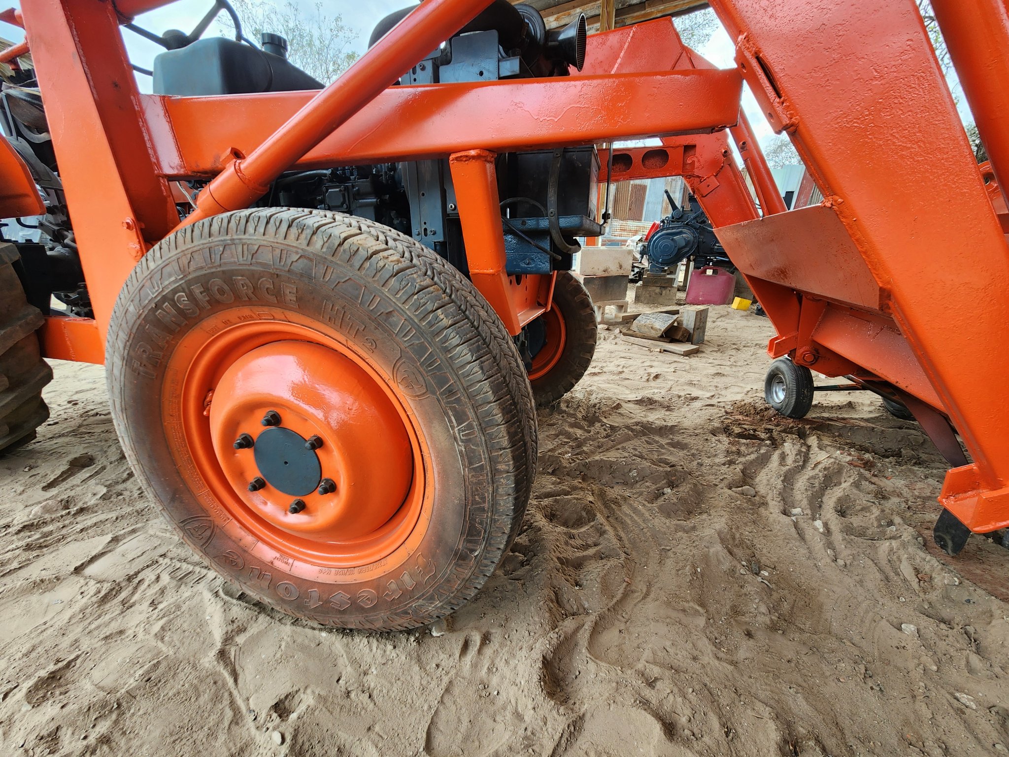

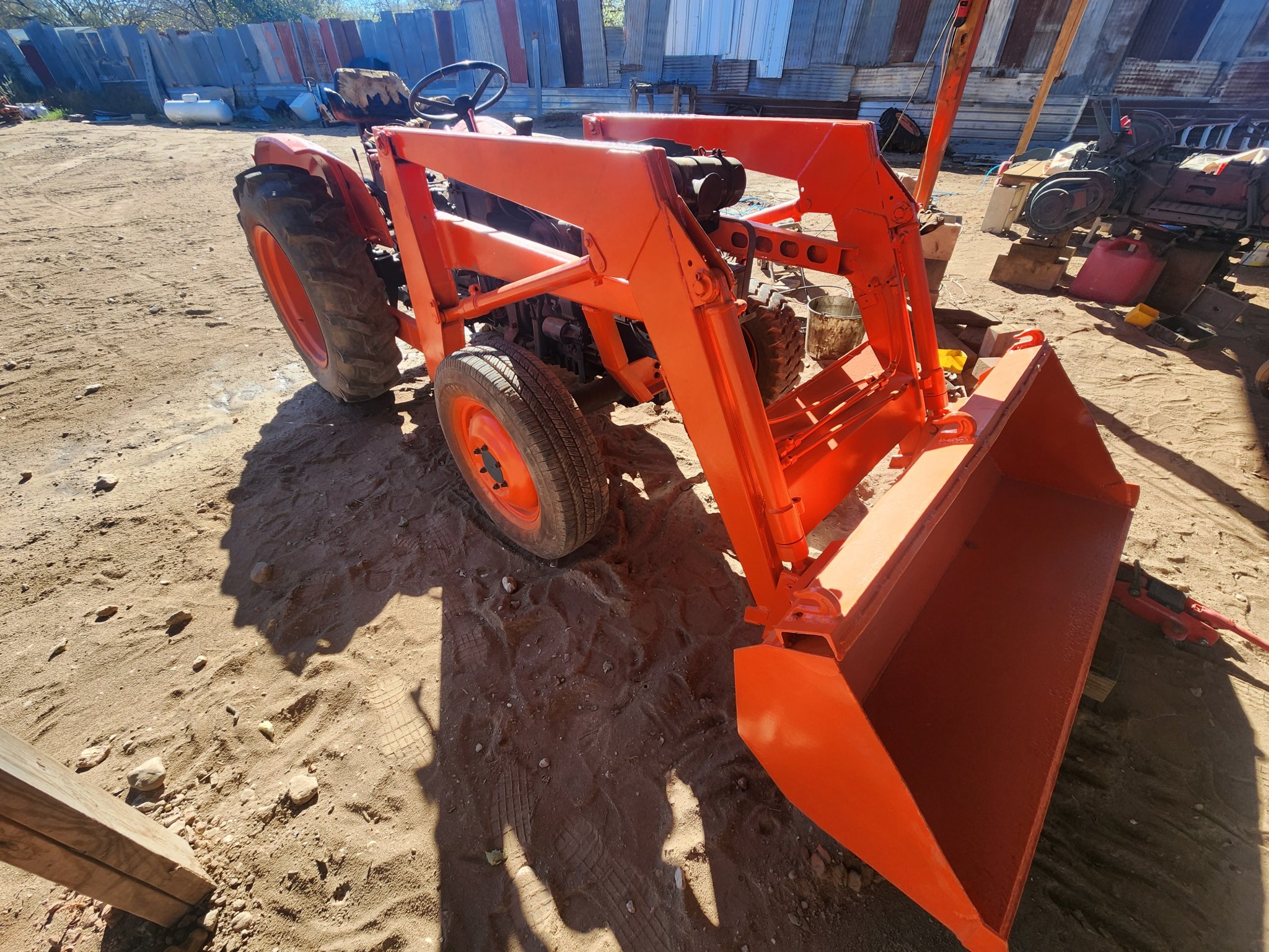

put on all 4 wheel, get L295 off of block, lift up on loader, ease L295 into position to get bolted to its loader...
get the wheel on, lift up on tractor, take out all blocks, she back on her feet
dont scratch paint too much when putting wheel back on
assess the charging/hillbilly ignitiioin situation, get her started, go get her connected to the loader
i wish bx1500 was not fully seized, I would lift up and down on loader using its 3 point hitch,

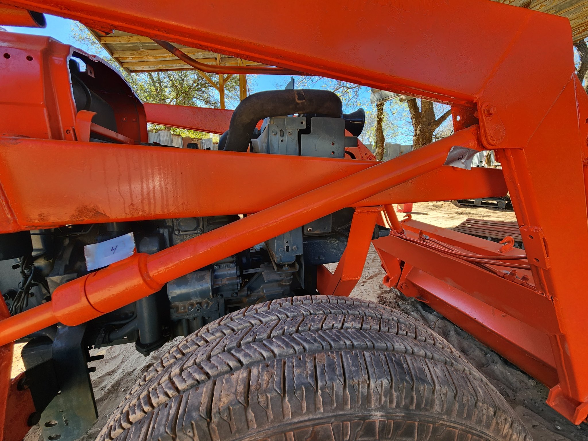

as I get L295 chassis bolts to line up with the massive freshly painted loader
small win: the hillbilly ignition work. It killed the battery, recharged it, and started without a jump, and
seat actually comfortable in the state it is in
move L295, line it up with rails on loader
rails have to be lifted where I point to clear chassis,
lift up on the rails using cheap jack, get over the hump, move L295 forward, drop loader rails, align all bolt hole, get bolts in there
keep lifting up on loader until axle goes past the brackets, then drop the loader, move L295 forward, line up front bolt holes, then rest of bolt hole

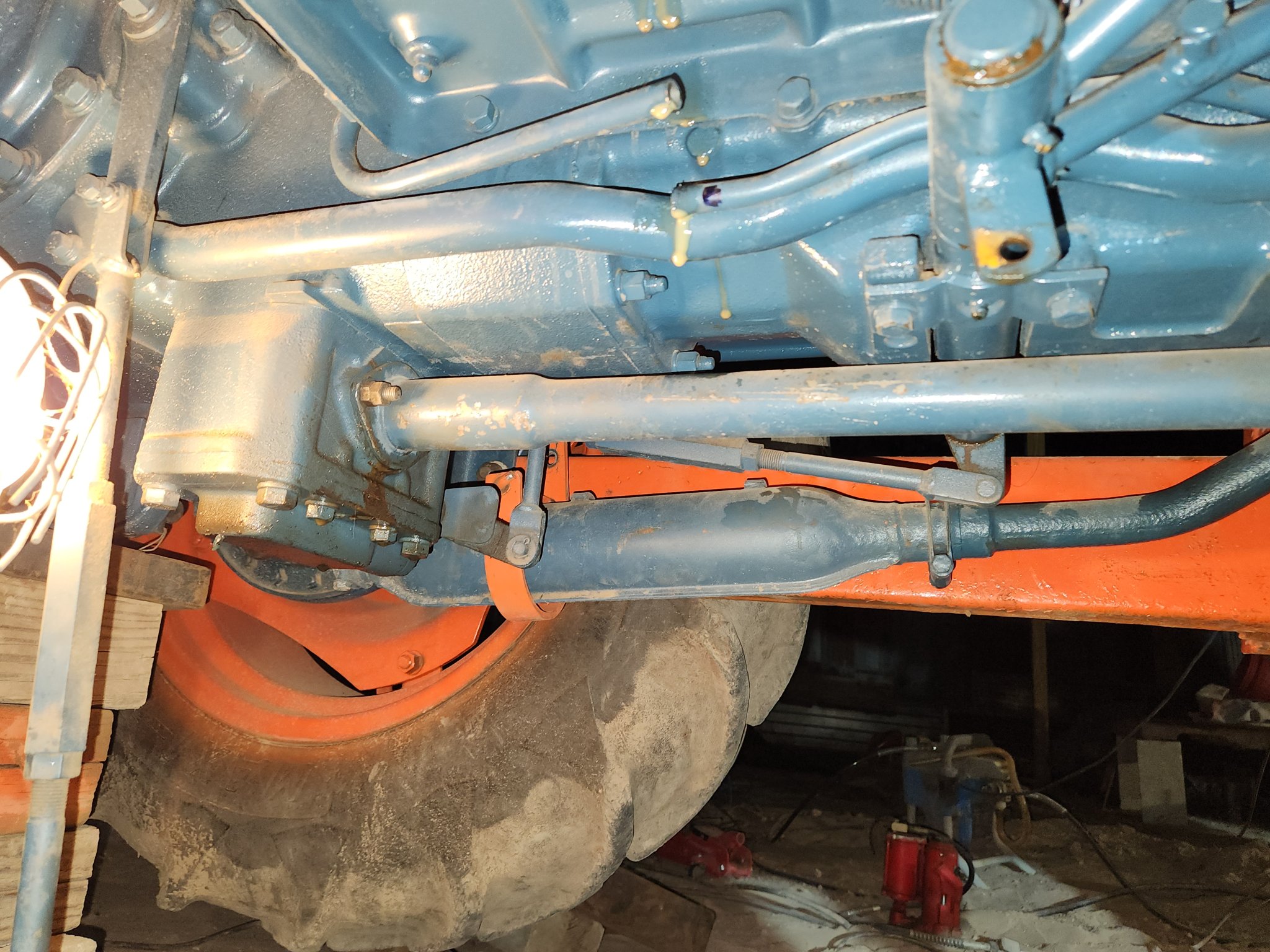

wrestle around in the dirt getting blocks in place, get up maneuver L295 slowly forward, get back in the dirt, lift up on certrain areas, almost got bolts lined up
somehow got 2 bolt in one corner, lift up on bucket with cheap jack, get your dolly underneath, now
use dolly to pull left/right, use cheap jack to lift up/down, get your bolts in, make sure you put washer, fasten them tight
Finally got the six bolt that hold front of loader, and got a mock bolt into the four corners holding onto tractor
this task take way more out of me than all the engine/piston/gear work,
underneath machine, covered in dirt, one wrong move and you injure yourself especially head,
in the dirt, dragging blocks all over, going deep underneath to fasten a bolt, dont forget a single detail or you wear yourself out from too much motion

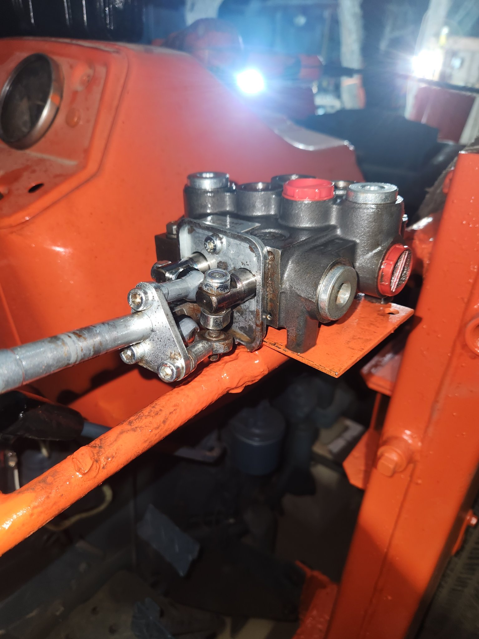

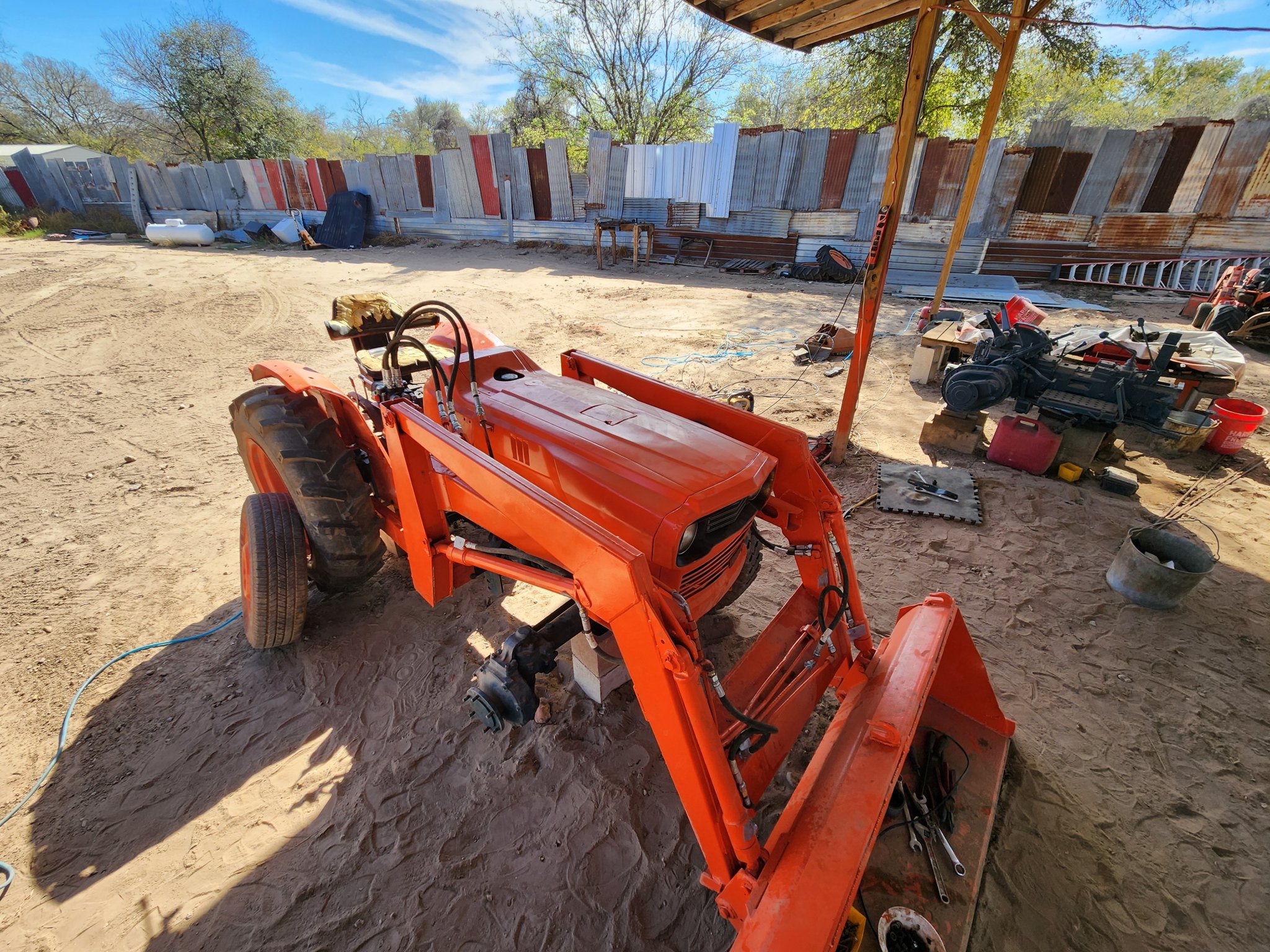

Figure out hydraulics
drill out new hole for bolt to hold controller, fit 2 strong bolt hold controller well
take off boot that cover controller solenoid, hit solenoids with hammer, successfully able to move lever now
now: study the lines and guess where they go trying to use hillbilly logic, connect controller to the hardlines, assess the whole situation

Hydraulic continued
use hillbilly logic to imagine where the lines go, left/right of controller go to bucket, up/down on controller go the arms of loader
the controller: where i point is what I think is the input / output from transmission to controller
beside the 8 line that control your hydraulic arms, there are another 2 lines:
1. transmission to controller
2. controller to transmission
When taking apart the other L295 tractor, I remember noticing a line out of the transmission
I assume this line go the the controller input
But, what about the controller output? How does that get back to transmission?
go make progress on the lines that you know need to be mocked, while you let question marinate of the unknown line
basically, consume all the plumbing that you already have while figuring out the rest of the hydraulic
tasks available: get your 8 lines connected, mocked, installed, weld on new fittings where it rusted, do metal work etc

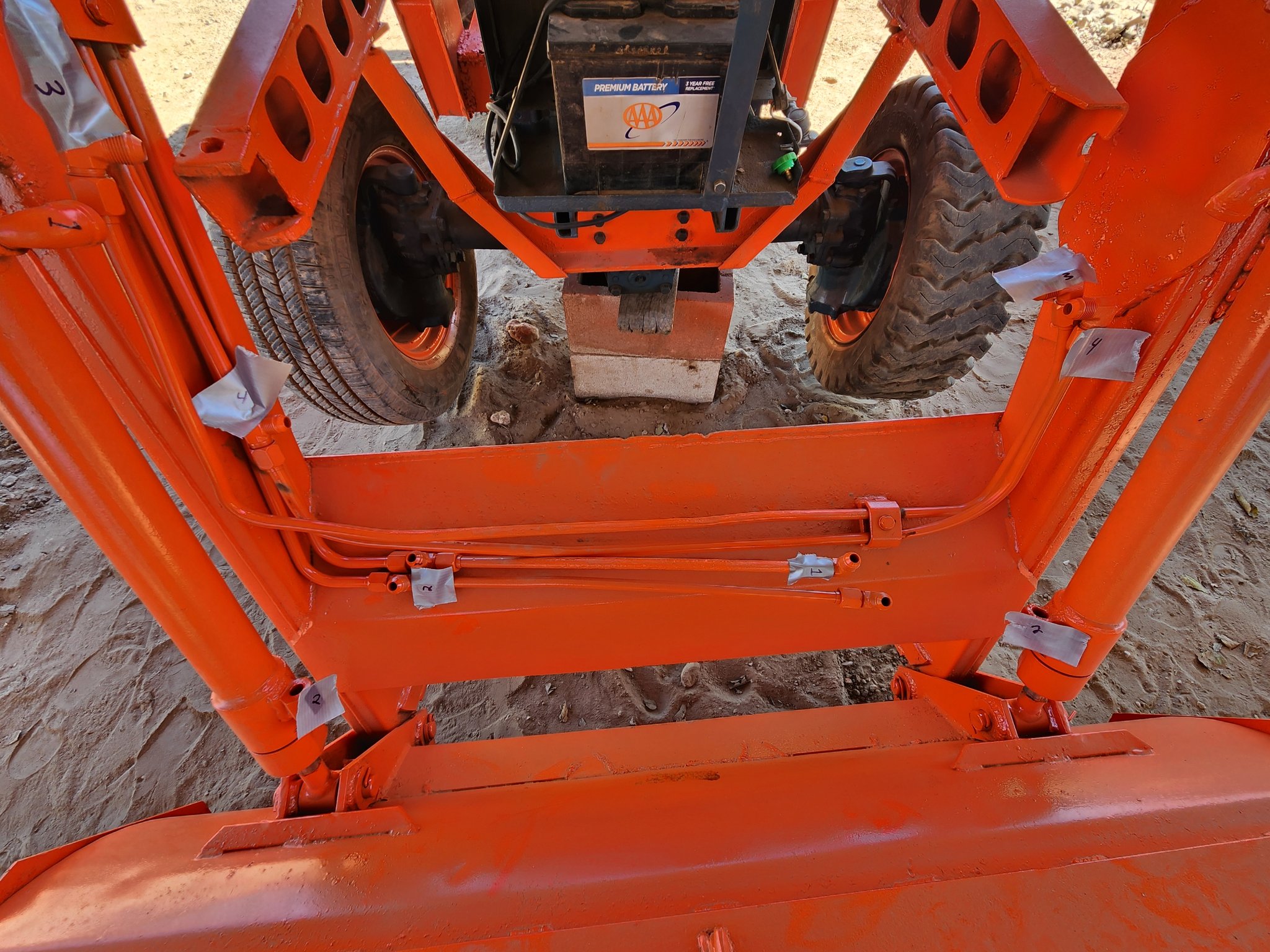

make hardline hydraulics: yes, I remember dinosaur teaching me to make hard hydraulic line, and I do have flaring tool, and male/female connectors, and extra hydraulic hoses to do:
if you cant run rubber hydraulic line from transmission to controller, make a hardline and then use a small rubber hydraulic line, start to imagine that task
Everything is jic 8 and can easily fit together
escalate your hydraulic effort: bring cheap table close to tractor, bring all hydraulic related part
decide to come straight up out of the controller, and bend into the 4 port
2 bigger hoses can be half foot shorter, having trouble consuming the smaller hoses intended for this area,
proceed: save those long hoses for the long shots, try to use 90s etc to make use out of the tiny hoses,
dont think about it too much, consume the parts that you have then later assess what you need
4 lines coming from controller, label them depending on the action of controller
in my case: 1 is right, 2 is left, 3/4 is up/down
dont worry if they are off, later once you get the hydraulic flowing, you can switch them at the controller, but
make sure the numbers match where they split, ie connect them in the way they are numbered in picture

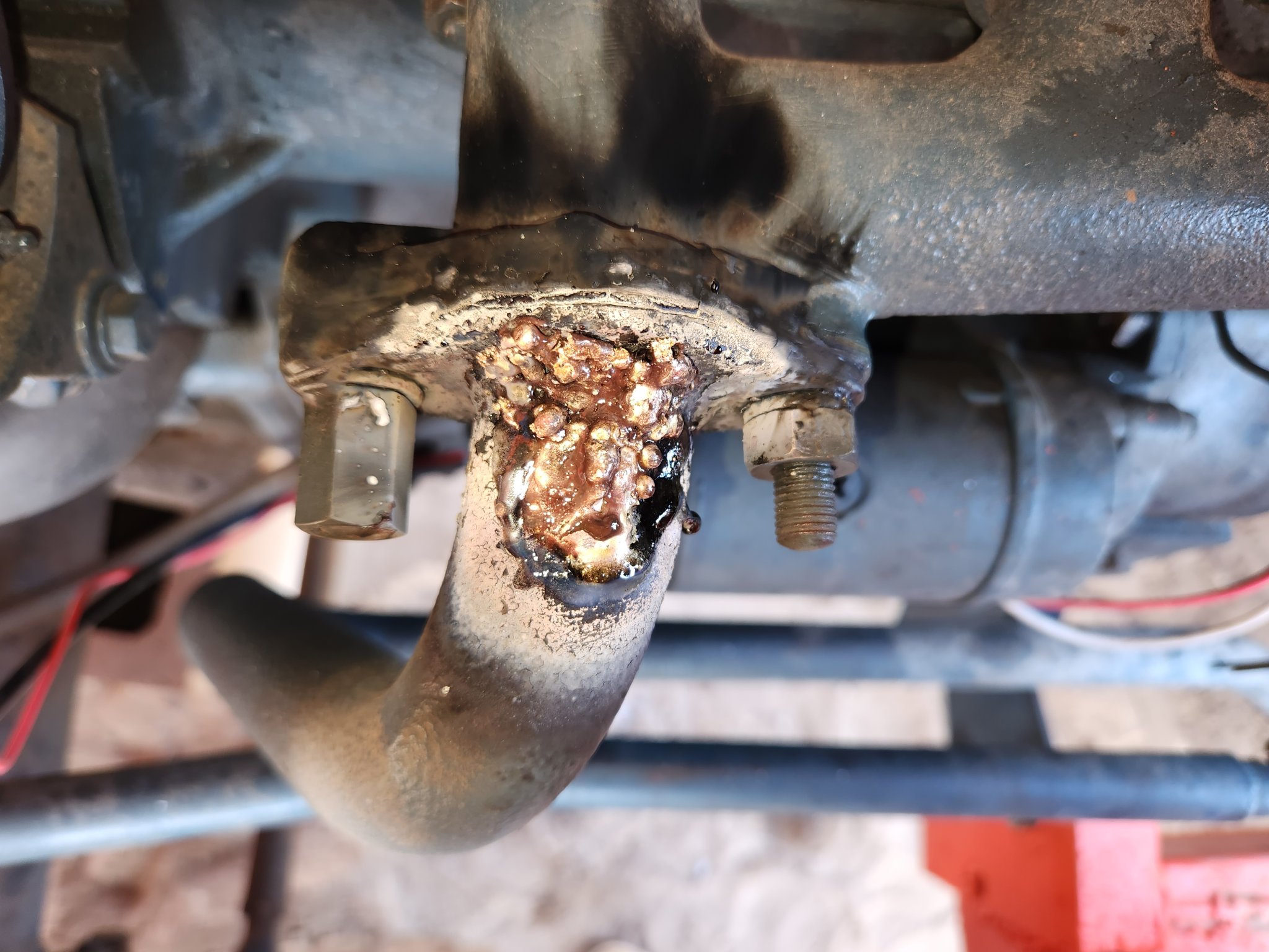

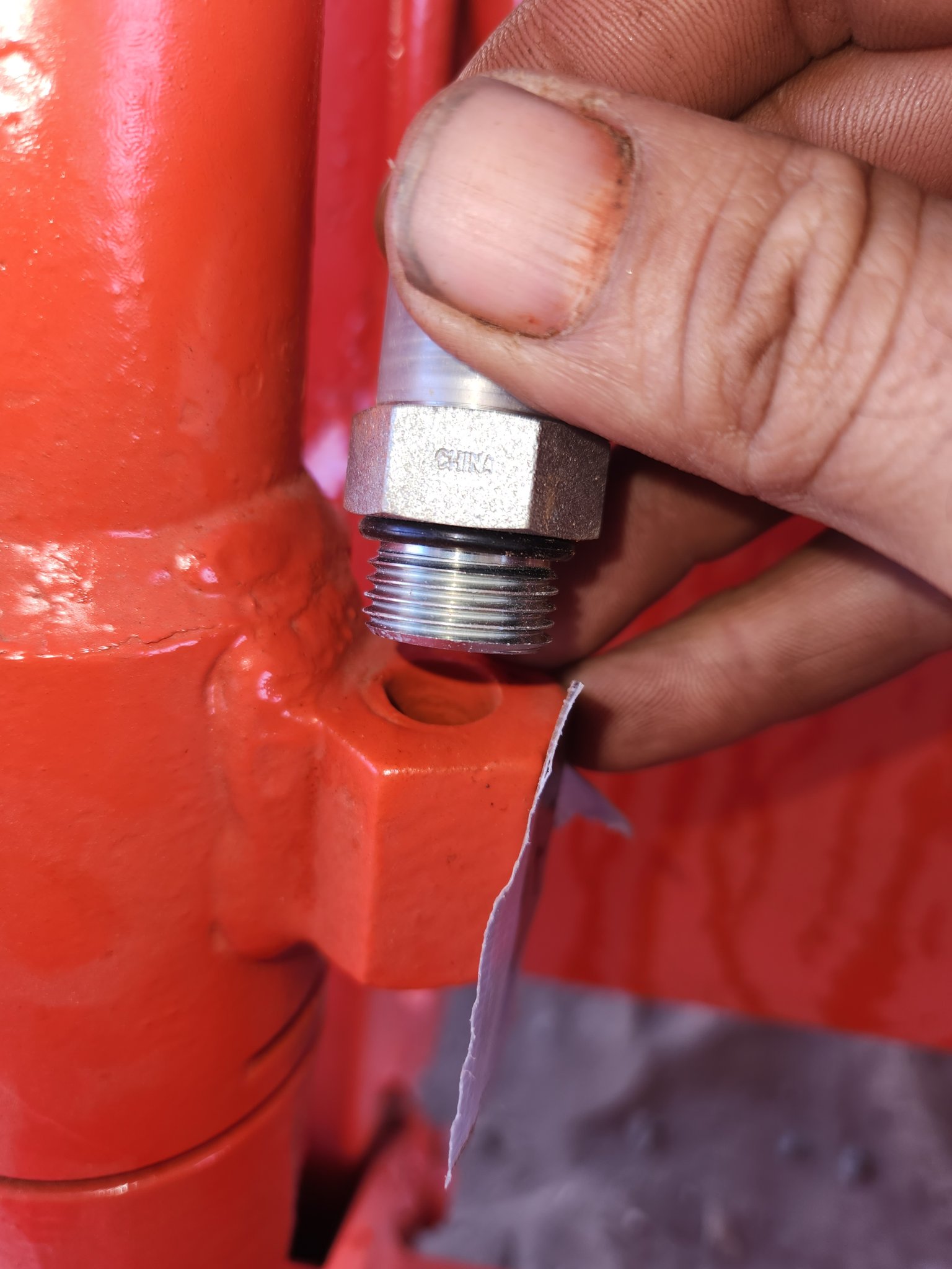

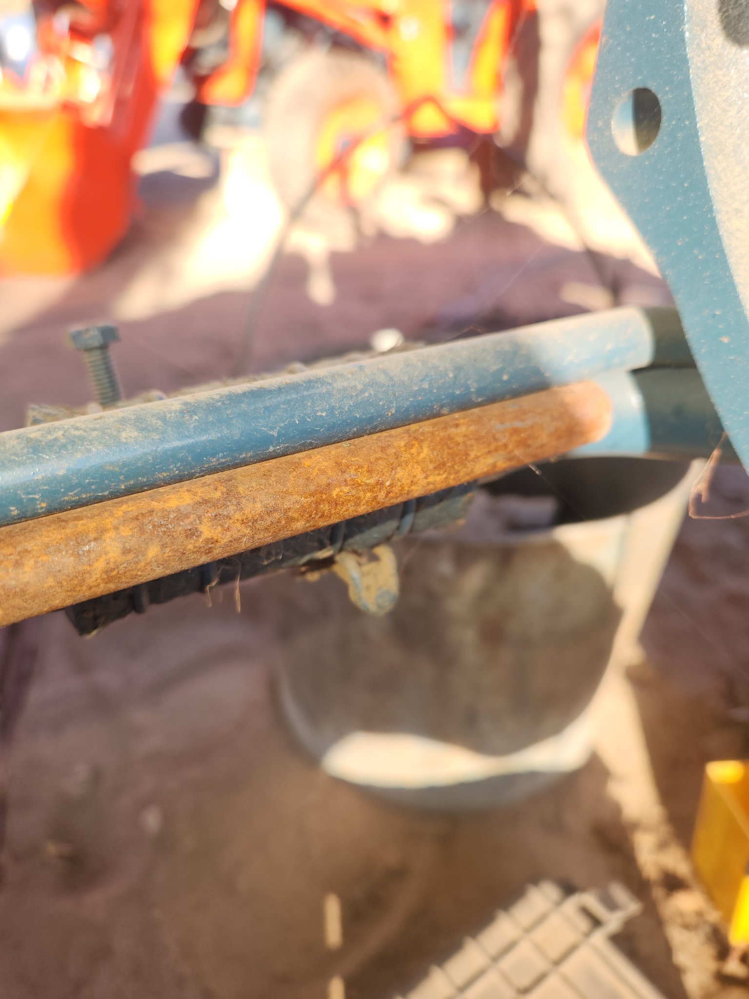

adapter I have does not fit these factory fitting, check to see if others are like this, and figure out the conversion
count number of fitting needed for this conversion:
8 total fitting, 2 are rusted out
convert:
6 converson: (size could be 3/8 Im guessing) - jic 8 male or female
2 rusted out: get the proper drill bit that can fit the fitting you have tight, then weld it shut
take picture of exact fitting used for the rusted out ports
jic 8 fitting next to rusted out fittingg that was sliced
plan: get exact drill bit size of jic 8, drill out the hole bigger, get your fittin in tight, weld it on, or

More hydraulic
yes, mocked up all the hoses going to their final destination
let me know if 1 and 2 are OK being that short, I can also add 90s that would make the route easier on the eye,
My guess: probably get a few more 2 foot hoses just to cover if some are too short,
I can see 3 and 4 needing to be longer, since it extend forward, needing more slack
so far we need:
6 adapter that go from the factory smaller thread to our thread
really good quality drill bit exact size of fitting we want to put into the rusted out ports
quantity 2, two foot lines for connection 3
quantity 2, four foot lines for connection 4
at that point we should have enough long/short/medium hoses in case it is not correct
let it all marinate while you do other task since the two lines going from controller to transmission and back are not yet understood
find the port that come out of transmission, make sure you have that thread, then imagine the line going to the controller
find the return port from controller to transmission: imagine the route it take from controller to that location
you might need more hydraulic line for those connections

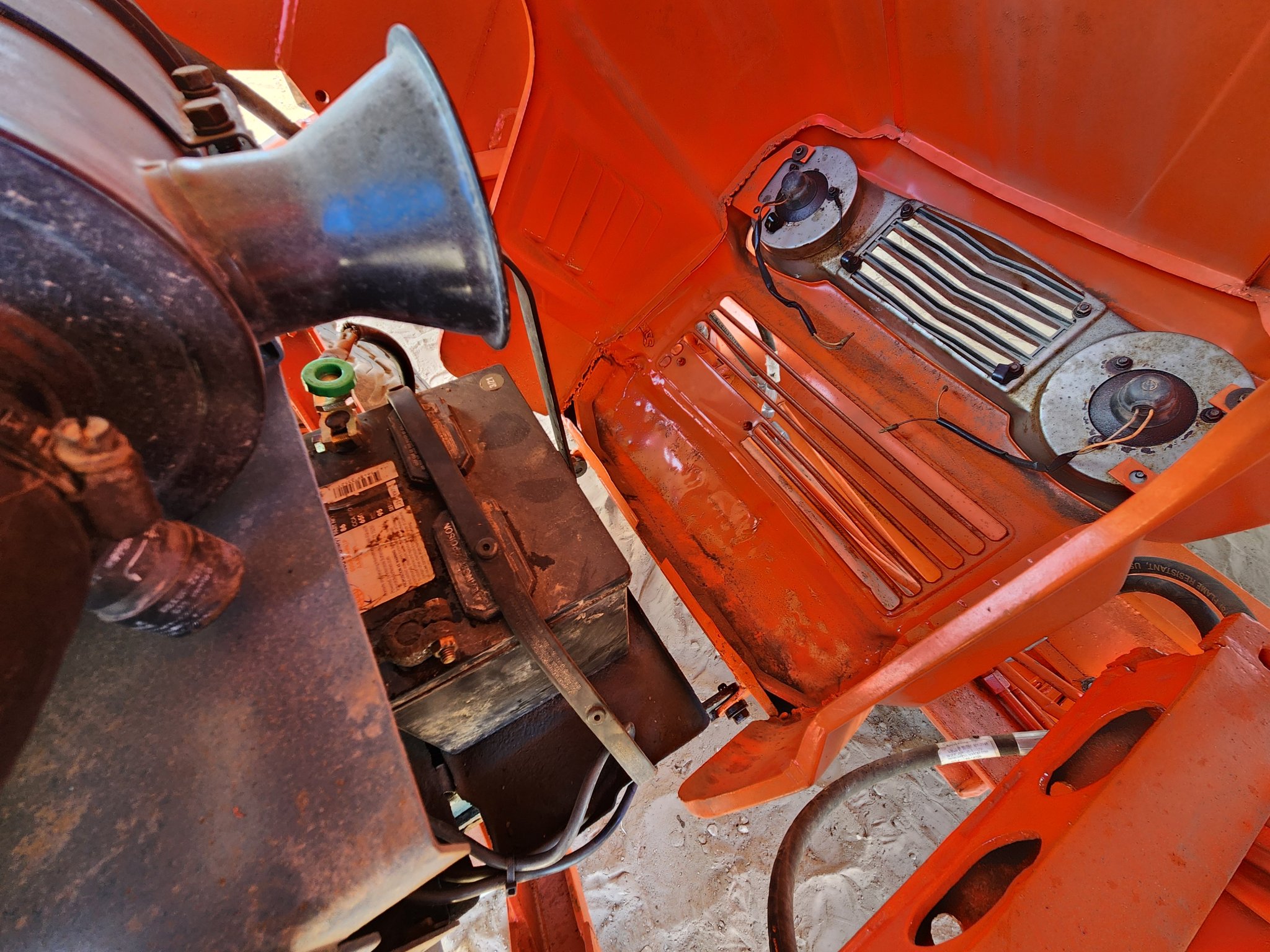

mightve found port that go to controller
this picture is the other L295 that this loader come off of
underneath your left foot is this port coming out of transmission,
I'm guessing take this one off and put it on the current L295, and make sure you can adapt to that thread
underneath left foot of current L295: bolt where that other tractor has that hydraulic line
Rear of L295 that had attachments: this is connected to the rear spindle
do I need this for the loader or is this just for the backhoe attachment?

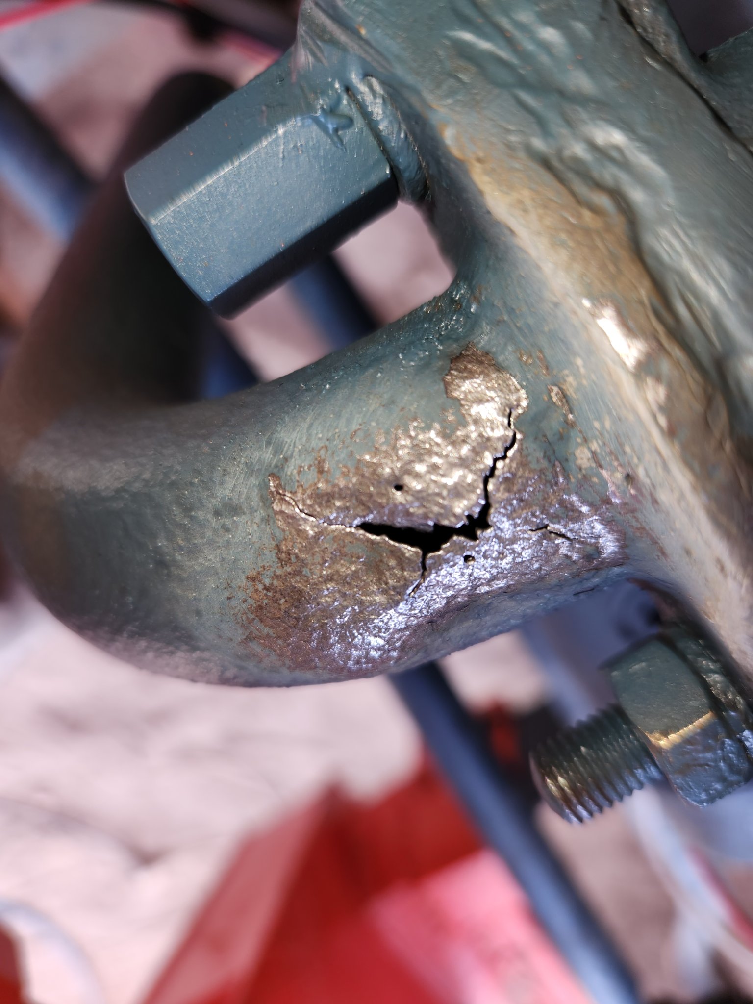

hissing sound gone: she busted open her exhaust manifold, need a good weld since jb weld cannot handle the heat

Now: go get the 6 fittings to go from 3/8 to jic 8, get the drill bit that fit snug on that threaded jic 8, get a few hydraulic hoses just in case
take those fittings with you and take one hose while you go around, dont make any mistake
exhaust manifold busted open, you can feel it affect the idle
got these fittings: 3/8 MIP to 1/2 FL
installed 6 fittings, got them connected to the hose successfully
titanium drill bit that will be used to drill out the seized thread, then the 3/8 thread should fit snug, weld on it if it leak
go work on drilling out those ports and successfully getting hose attached, then finish up steering wheel
might have got one in successfully: use your titanium bit, bore out the seized metal, hit with compress air, come in with the diesel on brush, screw in the fitting,
try to make it straight, then do the same on the other fitting
took out crooked fitting, hit with torch/diesel/air, then screw fitting in straight and put hose on properly
the other seized fitting: extract it with your titanium bit, burn new paint with torch, hit with air/diesel
unbelieveable, seized fitting came out intact, and screwed on cheap fitting successfully, connected hose

How was it done on the tractor that the FEL came from?
yes, these are pictures from the tractor the loader come from
The first picture: Pump attached to the rear PTO
2nd picture: They had a line coming out of a port, underneath your left foot if you're sitting on the tractor
I guess: they had the front end loader controller getting hydraulic pressure from the PTO pump (picture 1), and dumping into that line underneath left foot (picture 2)
To give power to the front end loader, you would have to engage the PTO, and once it spin, then you have power to the loader
(the engine running and the PTO on for loader to work)
But according to your statement: there is a way to give power to the hydraulic controller by splicing the line 050 and running a line into the loader controller, then
(I'm guessing) run the exit line from the loader controller to the port underneath left foot (picture 2)
yes, I read 5-6 page of that thread where they made a "block" that do the task that you are suggesting:
that pressure line coming out of the engine bay (050 in the diagram), you can come off of that line, and pump into this block, and from that block,
you can run all kind of things, long as you put a return line that will pump fluid back into the transmission
If you don't, wolf said as soon as you crank on the engine, and that fluid don't have anywhere to go, it will bust through the seal and maybe fill the engine with hydraulic oil
(going this route, if the engine is running, your loader will work WITHOUT PTO engaged)
(sorry I am just narrating my understanding, until it is comprehended)
You can just cut that pipe #50 in two and use compression fittings to extend the pump side to the FEL valve and then from the FEL valve power out you would connect to the rear half that would then power the three point hitch and dump into the sump (to be pulled into the pump again).
yes, keep reading this statement until it click
Narrate the route of the hydraulic pressure:
Hydraulic pump (engine bay), line 050 come down, cut it close to the FEL valve, don't put a TEE, route that line directly to the FEL valve,
Then run another line coming OUT the FEL valve, going to where it was originally/factory, which is underneath the seat (take picture)
I point to line 050, pressurized hydraulic line, and show you the FEL valve
Cut that line, route it up to the FEL valve, and route back from FEL exit into the remainder of the line
here is the line I use to make hardline hydraulics, it could be the same size as line 050
I think this is the input on the FEL valve
This could be the exit line coming off of the FEL valve, run a line back down and continue the route of line 050
I show you where line 050 go, top of transmission, right under your seat
summarize exact route of transmission fluid:
hydraulic pump - line 050 - you cut line 050 - go to input on your FEL valve - exit FEL valve and come DOWN back to where you cut line 050 - let her continue her journey to the factory route
basically, cut line 050, right side go the input on FEL valve, exit the FEL valve and come back down and connect to the other side of the cut hydraulic line
By the look of it and shooting from the hip, I COULD have everything necessary to make hardline that go from/to line 050 and FEL valve
Long as line 050 is the same size as the lines I made, I should have the flaring tool/compression/everything jic 8/ half inch flared fitting

busted exhaust manifold: grind it down, reveal all the crack, get all the welding tool ready: glasses, tanks, rods, maybe some flux, then always
take a moment of silence and commit that -
you keep your brain on where that flame pointed at all time
and really mean it, then
form big bronze puddle on that whole crack area, encompass all the leak
could not unseize studs, ended up making hole with drill bit, cut screw to right size, then get it tight in that hole and it make its own thread, its holding good enough

Hood installed, weld exhaust, continue hydraulic narrative
hood installed, both bolts and bracket holding, and weld on hood bracket holding for now
inside the area that i did hammering/welding/everything
open and close hood with some force, it sit fine in its natural state
clear out floor, get your welding supply, try to get the weld on exhaust without taking it off, but
take it off if you feel it is necessary
hit busted manifold with dab of diesel, front facing wire wheel, brush it with solvent, hit with compress air,
clear all the floor, bring all welding stuff close to you,
use a tiny flame, first hit the busted area with the flame, get it up to temp, come in with left hand flux coated bronze, seal it up, gravity on your side
cover your busted manifold with bronze
experiment: before bringing out the big torch, i sprinkle flux on the area, hit with regular torch, make a puddle of flux
then turn on big torch, watch where you point that flame, cover the damage,
now I understand why you need to remove parts since I only had one angle to point flame, see if she hold, if she dont, escalate effort
its so tight in there, you can barely get in there to grind away at your weld
declare task: dont take off frame of seat, take off individual plastic pieces you sit on, see if you can get replacement or get material that you can cover it DIY

picture: that is hydraulic line available, next to line 050 that needs to be cut, they look exact same size
narrate hydraulic plan: cut line 050, use 90s and straight shots to make your way up to FEL valve, then do the same coming back down
there is one small hose available if need be
use flaring tool to get your fittings proper
scout the job for 20-30 minute, imagining the route of both hydraulic lines, put your mark on where to cut hyraulic line
route lines will take: come toward me few inches, shoot right underneath bracket, then shoot straight up to the FEL valve
raise tractor even more, loosen the hydraulic line, go under tractor with cutoff wheel, cut your line at the mark, try to remove the two halves of the hydraulic line,
dont start cutting the factory line until you fully have proper plan, but see if your fittings/flaring tool will work on it
hillbilly ignition: the power wire pulling on it, put a 90 on it and somehow release the tension the power wire putting on your hillbilly ignition
the battery not strapped fully down, secure it properly
dont put the wheel back on since you gotta do surgery on the hydraulic line coming from engine bay
summarize: grind down your fresh weld, fix the seat, fix the battery terminal and battery, look through your flare fittings and see if your compressions will work on the factory line
I honestly cannot think of anything else that need attention/bugging me
or if you cant remove them, try to flare them right there in place and build custom pieces all the way up to the FEL valve, without
getting it in the way of the brakes/brackets/etc, try to keep it snug to the frame of tractor
raise tractor 4 or 5 inch more, remove both ends of the hydraulic line, cut off anything holding it,
go in there with cut off wheel, slice it in half, shoot metal and transmission fluid on your eye protection
zoom in picture: try to flare them and start your plumbing
Your flare tool and fittings, if typical fittings for that type tool, are completely inadequate and dangerous for this job. Don't do it!
You're dealing with steel tubing and 3000psi class fittings here, not some domestic plumbing job. While I'm at it, I'll mention the malleable iron fittings in some of your earlier pictures - they're typically intended for 300psi only. Even if they were already there, that doesn't make them safe.
Oh, and BTW, you'll need to determine if your tubing is metric or imperial. And your loader needs to have a relief valve routed to the tank, since you're cutting in ahead of the existing one, to avoid dead-heading the pump.
Once you've figured out what you have, compression fittings for hydraulic service are available that don't require flaring. I used a couple on my third function installation and they've worked flawlessly.

run hydraulic line from and to FEL valve
get your files, get lines ready for flaring/coupling/plumbing
refamiliarize yourself with hydraulic fitting you had laying around
build first the hydraulic line going to the FEL, then if that one works, build the second one along the same path
try to flare your line with cheap flaring tool, it keep slipping, wont flare
yes, get you a bigger flaring tool, flared it a bit, enough to tighten the fitting, put in your first fitting
get hydraulic line, go underneath, mock it up and mark where to cut hydraulic line, cut it, flare it on both sides, and put you the female fittings on both side
build it one piece at a time working your way up to FEL valve
no, dont build it up one piece at a time, too much work
get you a big line, put it up to your path, mark it with sharpie,
take that big piece and bend it using clamps etc
use that bit of strength you got to bend it and make one piece connecting both end
bend you that hydraulic line the shape needed, get it connected on both end,
build you that exit line, same route, move show forward
it was easier to bend than expected, you were worried about a bunch of nothing
You're not sure which is input/output on the FEL valve, but your hillbilly mind say it doesnt matter
bend you that hydraulic line in the shape you need
put the hydraulic line in place, fasten everything, put you some clamps all over, bend hydraulic line
install you that feed line successfully
now: fabricate you that return line, same duties,
while you do that, come up with the plan to clear those hydraulic lines and not let them get back to transmission
figure you out how you going to:
turn engine on, get hydraulic flowing, disconnect the part where it goes back in transmission, open each line each time you get pressure and push out all the contaminant, something like that, let it marinate while you go fabricate another hydraulic line
connect you both lines successfully
connect it at the bottom, mark it with sharpie, bend it, keep doing that until both side fasten
moved the intake/outake port since didnt have 90's of that size, make sure brake pedal doesnt hit your lines
big chance those bottom connections will leak:
someone said "some lines not made to be flared" is correct, I am not confident the flare will be leak proof
next: system ready to be pressurized, get you some pressure in the system, then go to each hose, crack it open, move lever on FEL valve and push fluid out that port, do that for all the port until you push out all the extraction/contaminant
first: disconnect your back connection, turn on tractor, expel out that line, reconnect that line, then do the separate lines up front

Joe, google Swagelok fittings.
Sidekick
Jul 29, 2023
1,096
1,539
N.Y,
Not all tubing can be flared. May not just be your tool.
