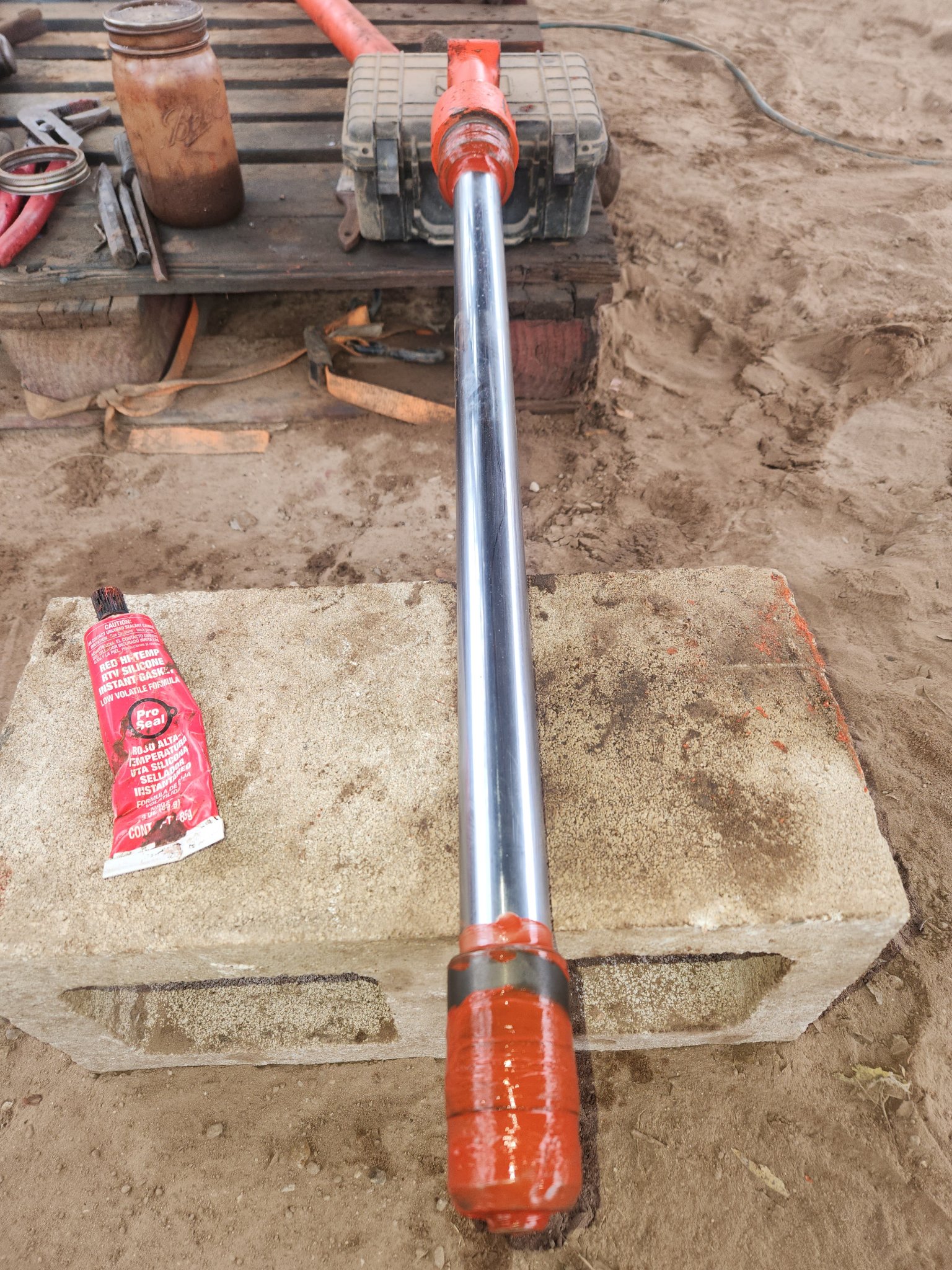

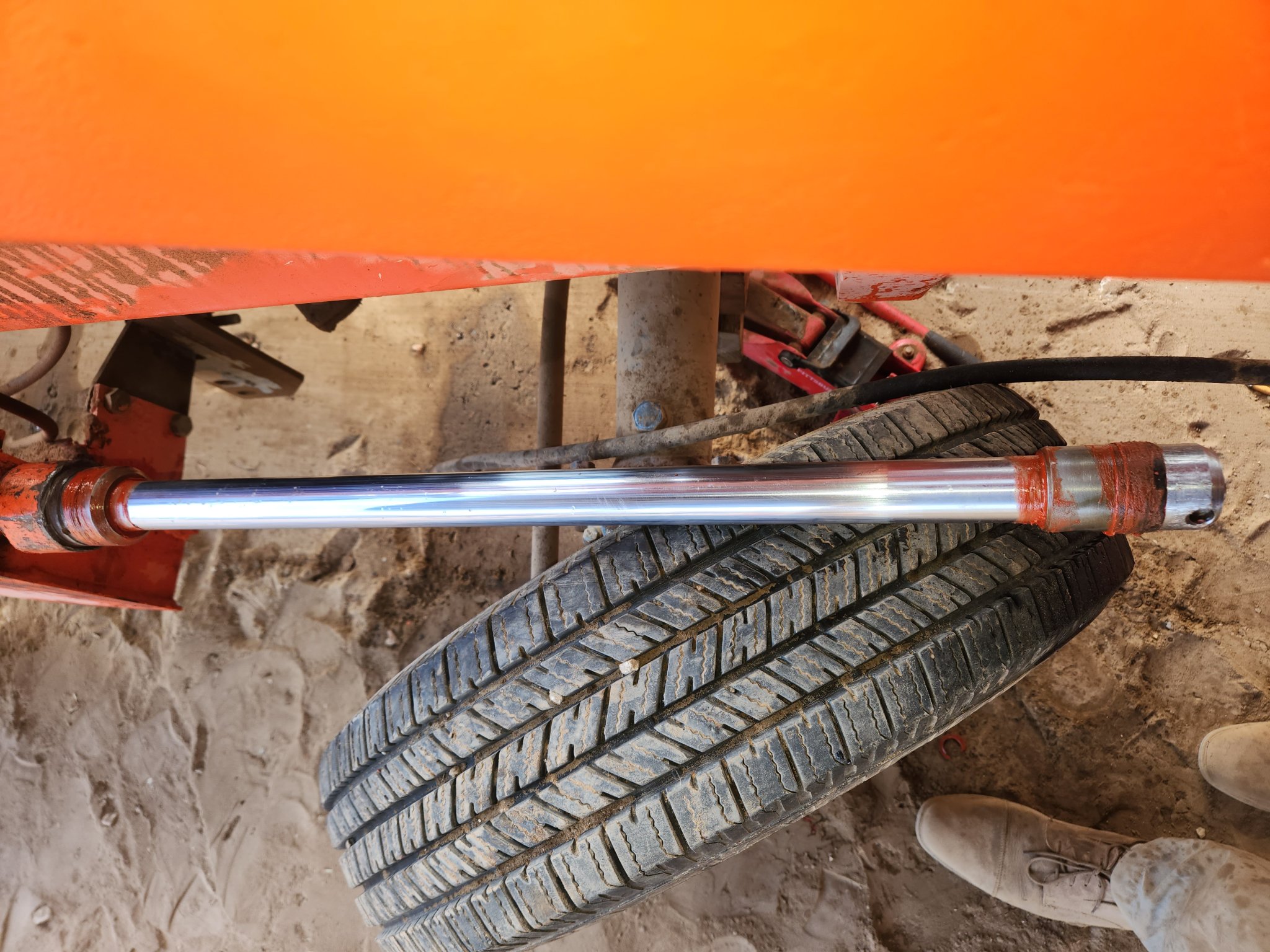

got the ring out, rebuild cylinder
So, disassemble & clean all parts, check bore for size & pitting, (and if within tolerance) hone bore, polish ram, replace wear ring, replace all seals & o-rings, replace spring key, lube all parts with clean hydraulic fluid, and reassemble, and pressure test.

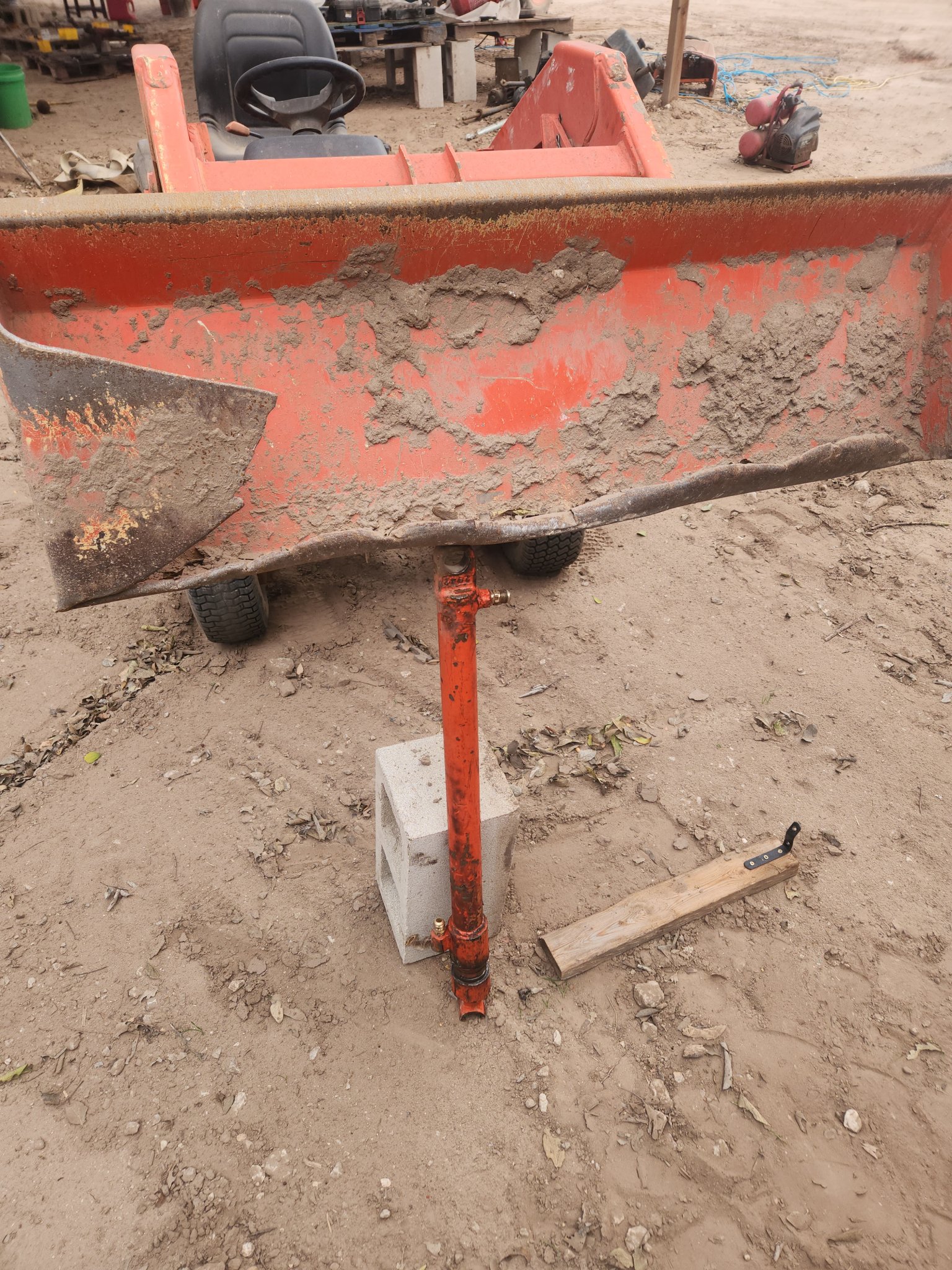

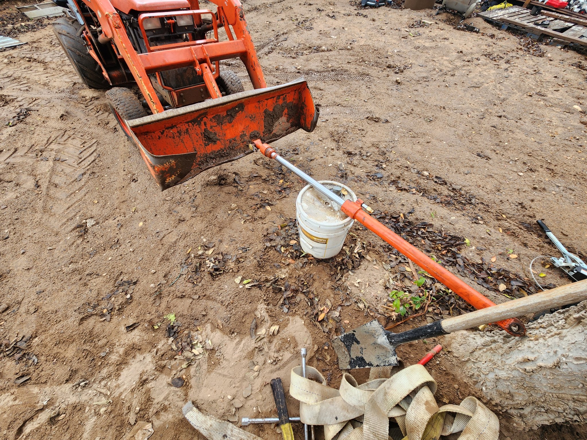

I'm thinking: set it horizontal couple feet above ground, with one end up a against a tree, drive you pickup truck straight into it
another idea: bx1500 cannot move, but it can move its loader
set you up your cylinder upright, crush down on cylinder with bx1500 loader...
Didn't work

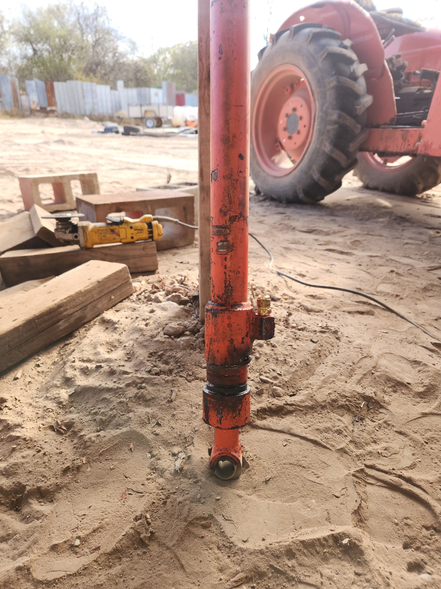

Go get you a press already

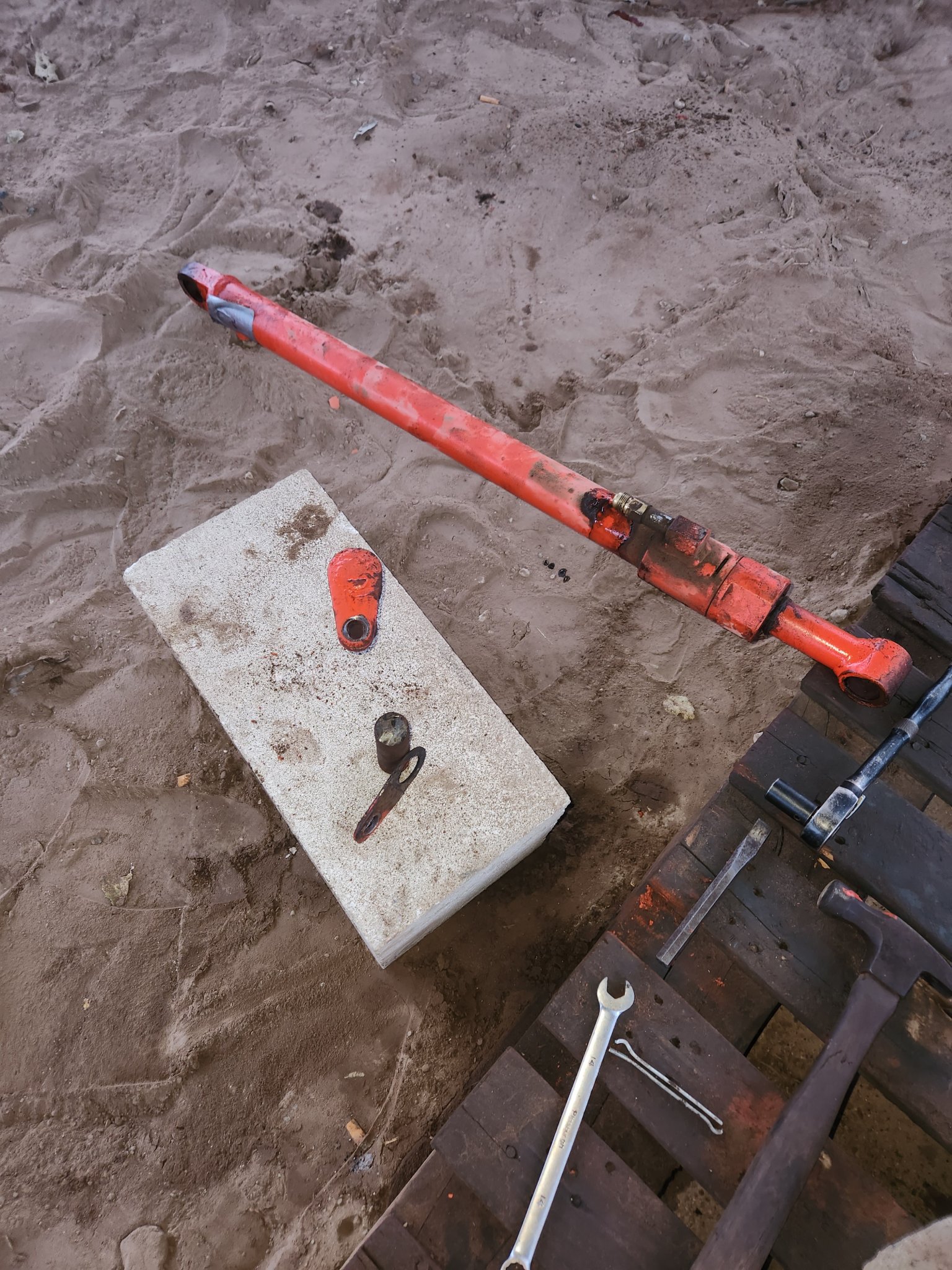

solved, I point to the part you hammer on to to close up the cylinder
You had the other end completely in, thinking it needed to go in further
your definitely slow for forgetting that but glad you got it closed up, install ring, get going on the last cylinder

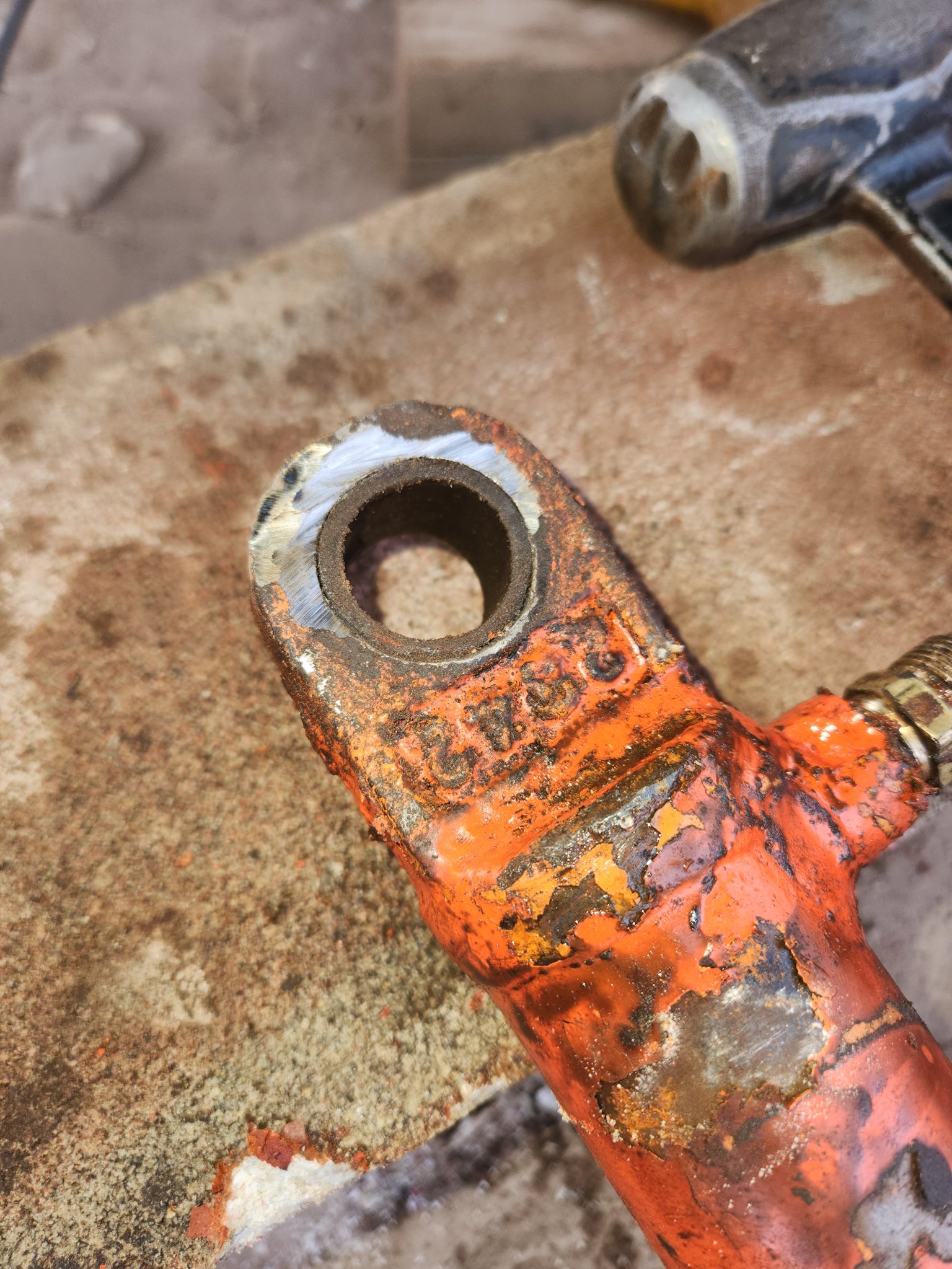

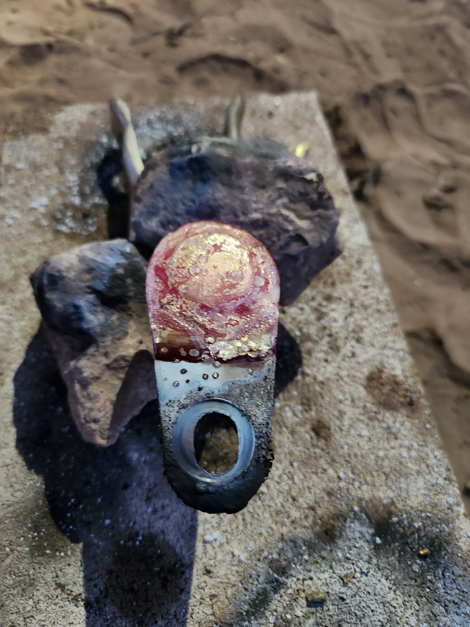

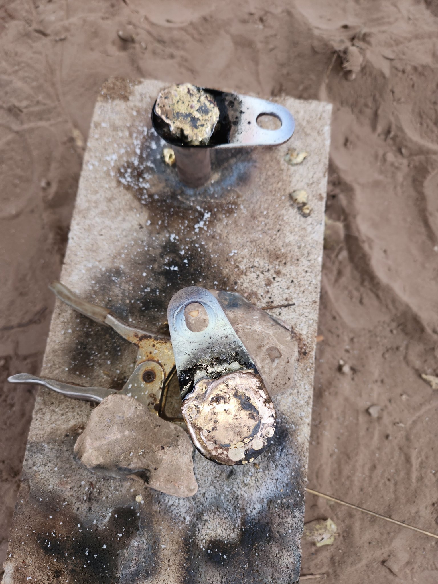

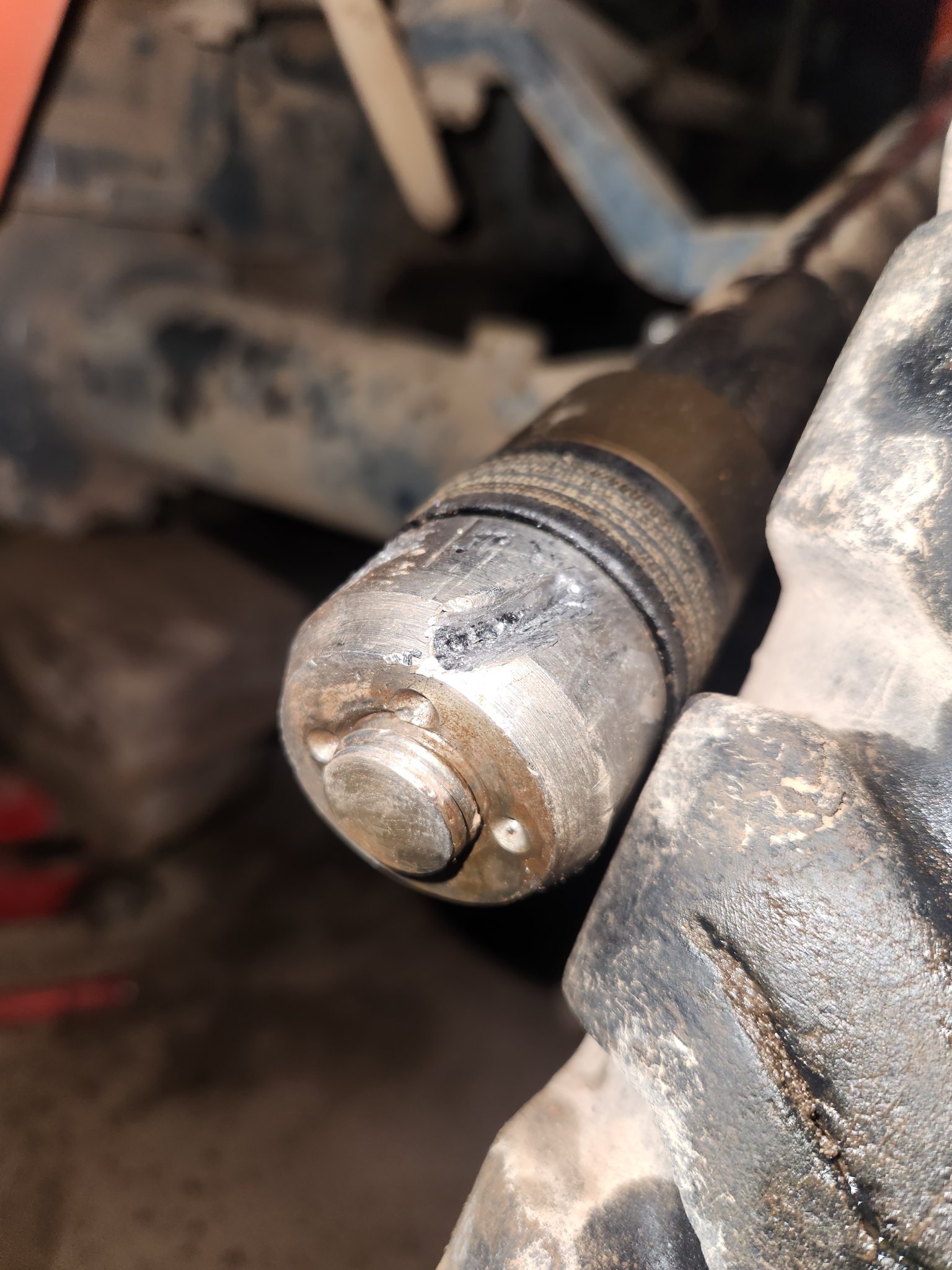

tons of things done wrong in this clip: you come in too soon with the bronze, way more heat on the pin, aim the flame mostly at the center of pin, get the pin 4 times as hot as shown, do the weld with gravity pulling the molten toward where you want it, not angled, start the puddle on the pin, and melt it down to your other metal
you fixed the welds after this clip, they didn't hold, later in this post you see better weld
cannot get the ring in because hammering too hard on the pin area
grind down with grinding wheel and drill bit, hit it with torch and diesel, sledgehammer
the magic you witness did not hold
you had to go back in there with big flame

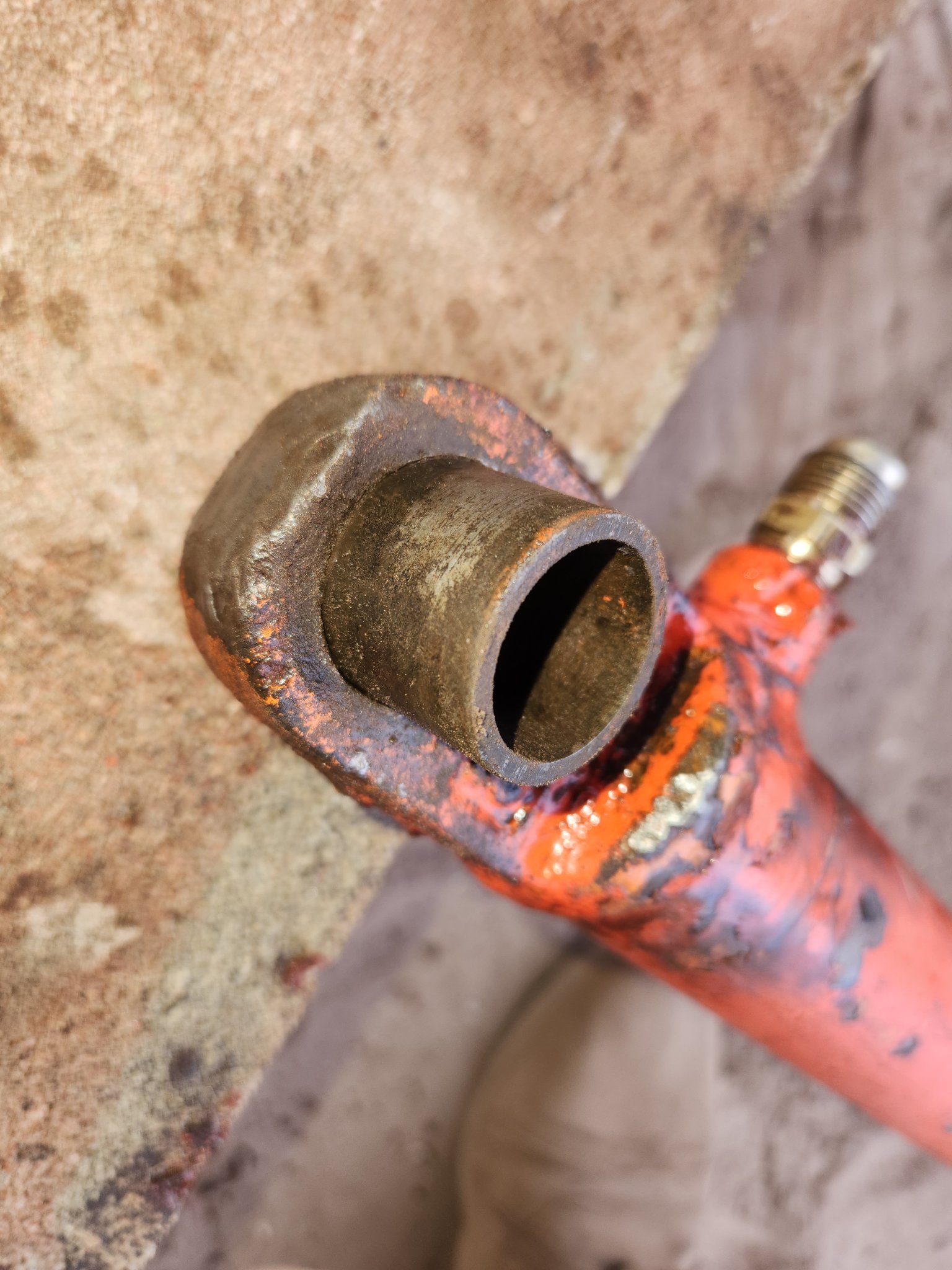

understand you the nature of the weld, you have a massive pin and a small piece,
hit you that pin hard hard with big torch, then drop you bronze on the pin,
and once bronze stuck to pin, gravity molten brought it down and connected it to your smaller metal
after you lay bronze, get you comfortable, hit it dead center facing down the pin until you make big molten puddle
that thing will be hot for 40 minute after your done, its always the same issue, more heat on the bigger metal to get it to accept the molten...
make progress, hammer in your newly welded pins, put back your hardware, your weld holding

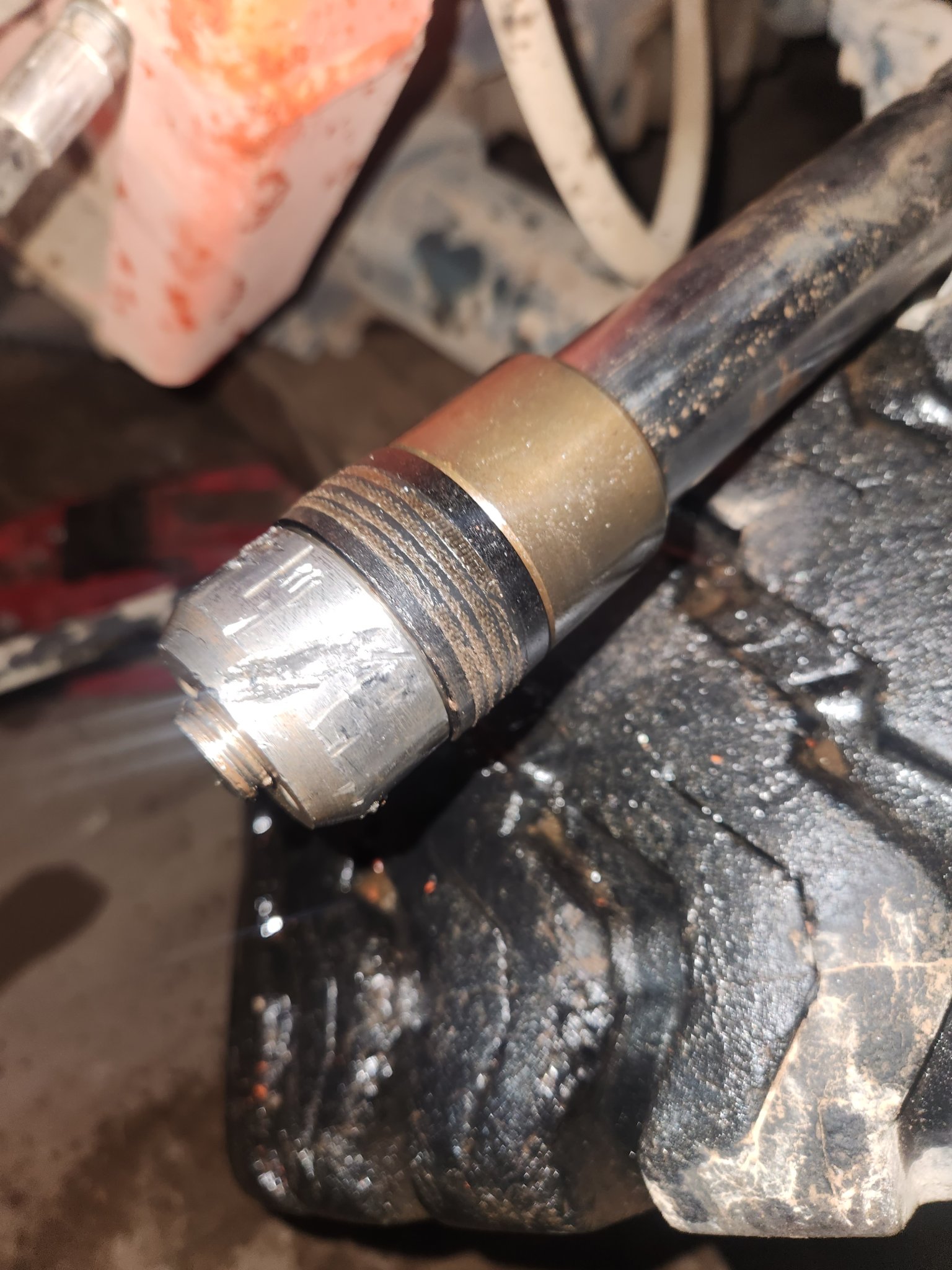

you are so grateful for figuring out how to take out the ring,
hold the one side with pipe wrench, bend out the ring a bit, smack where I point with sledgehammer, it spin it out perfectly

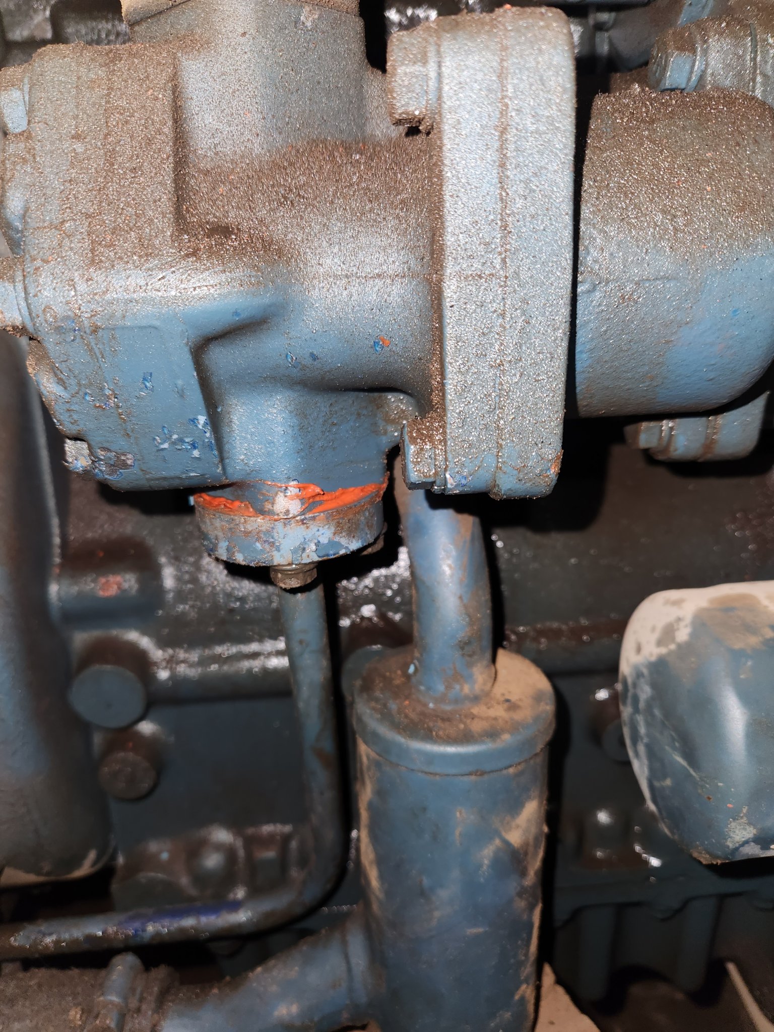

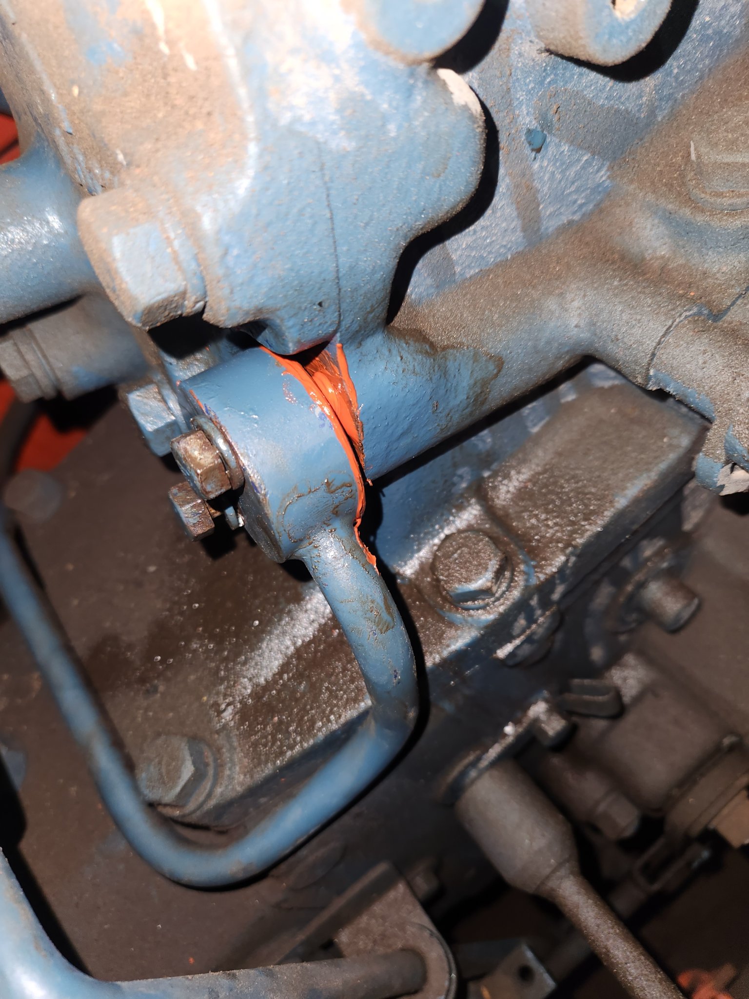

leaks at the transmission both side of pump and transmission
leaks at the valve, take off all ines, label them, seal everything
and hit the other leak with big torch hard and make it molten until you are sure it is sealed
and seal you up all the line coming out of injection pump
surgical seal of both clapped out transmission connection, at the engine and transmission, transmission line connected

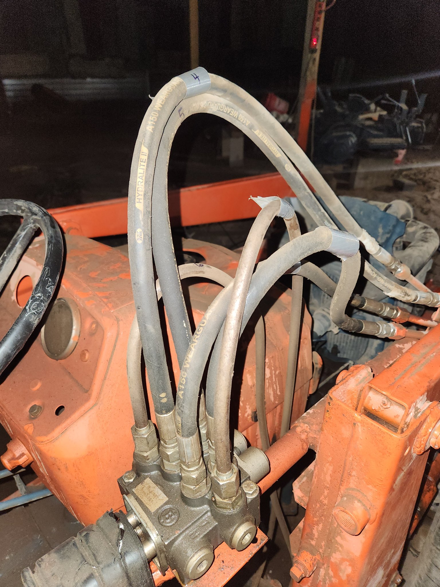

now: seal your FEL valve., all 6 lines completely and surgically, then seal your diesel lines from injection pump to injector
label your 6 lines
take off all fitting

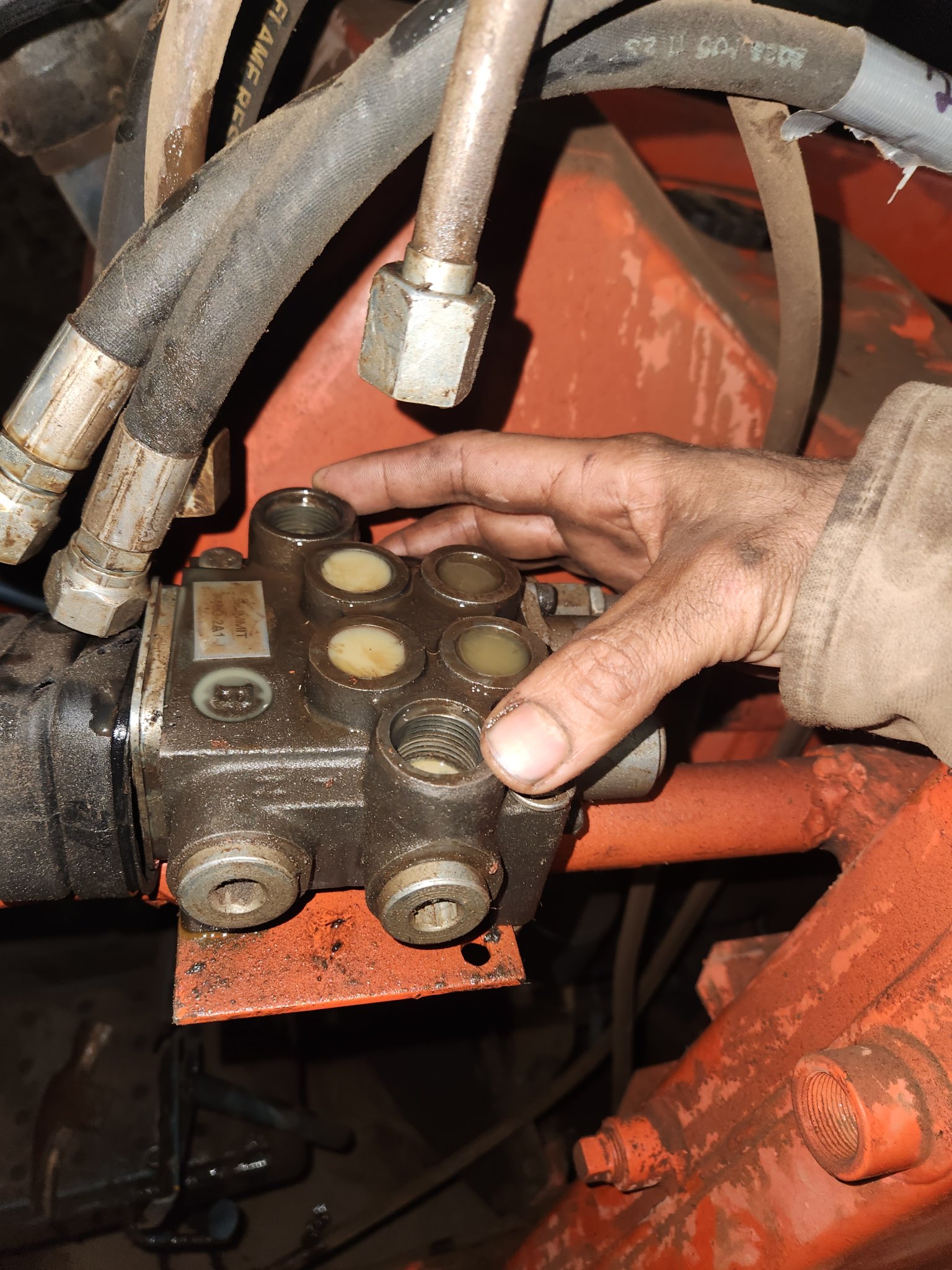

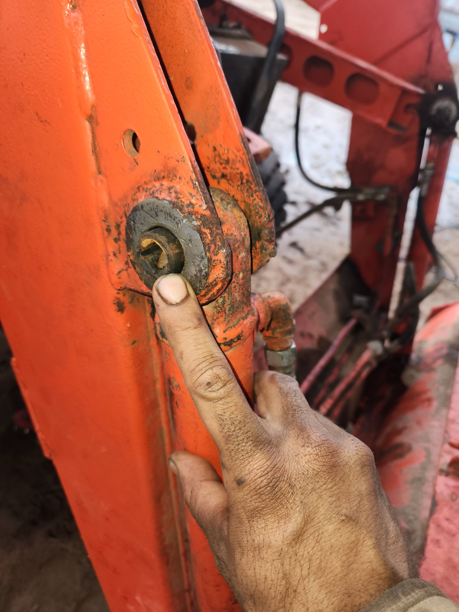

i point: these 2 thread do not fit properly, feel loose, wrong fitting, try to seal it

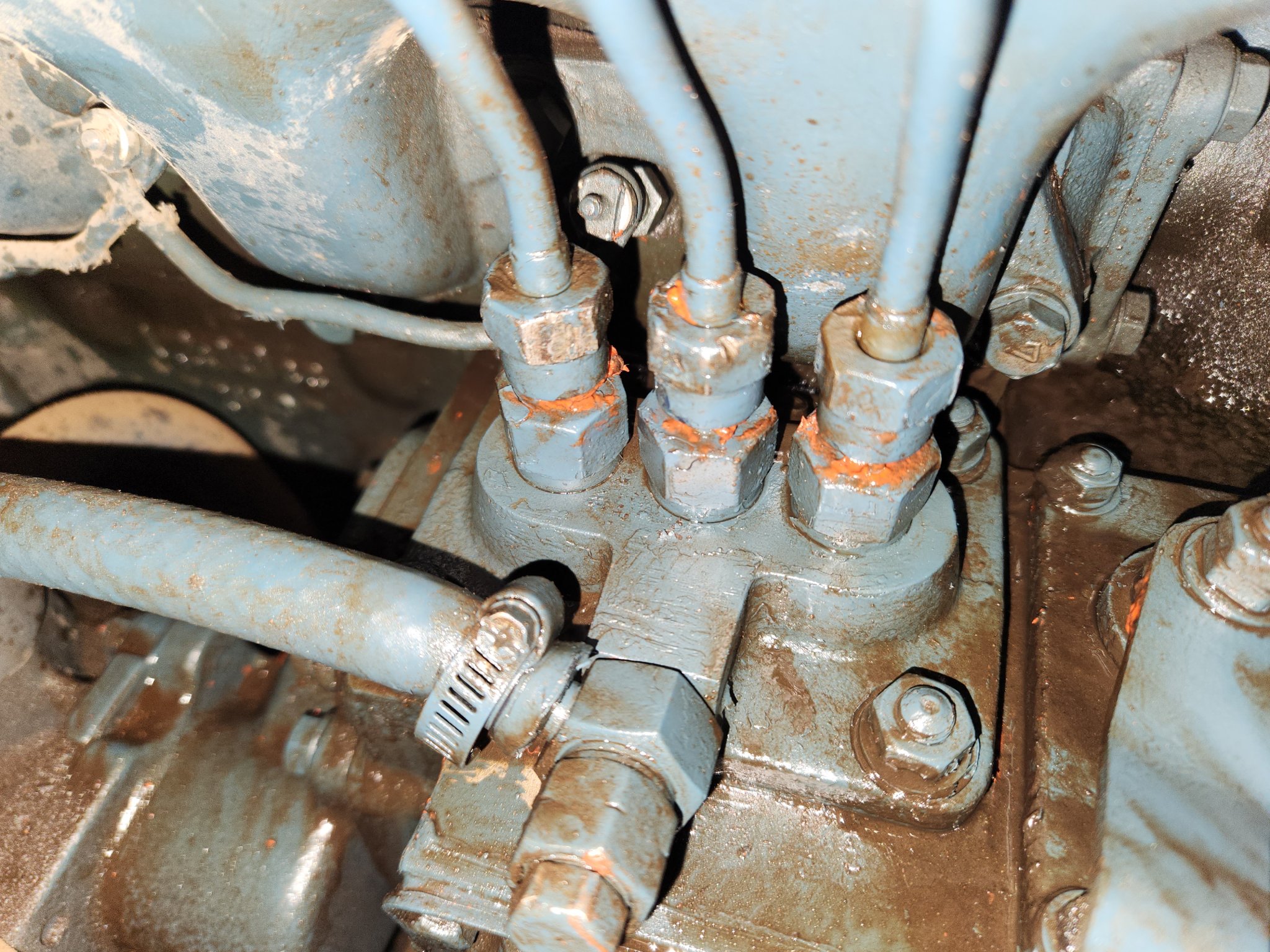

the diesel leak was so obvious, one of your injectors from all that pressure, come loose, you surgically seal it

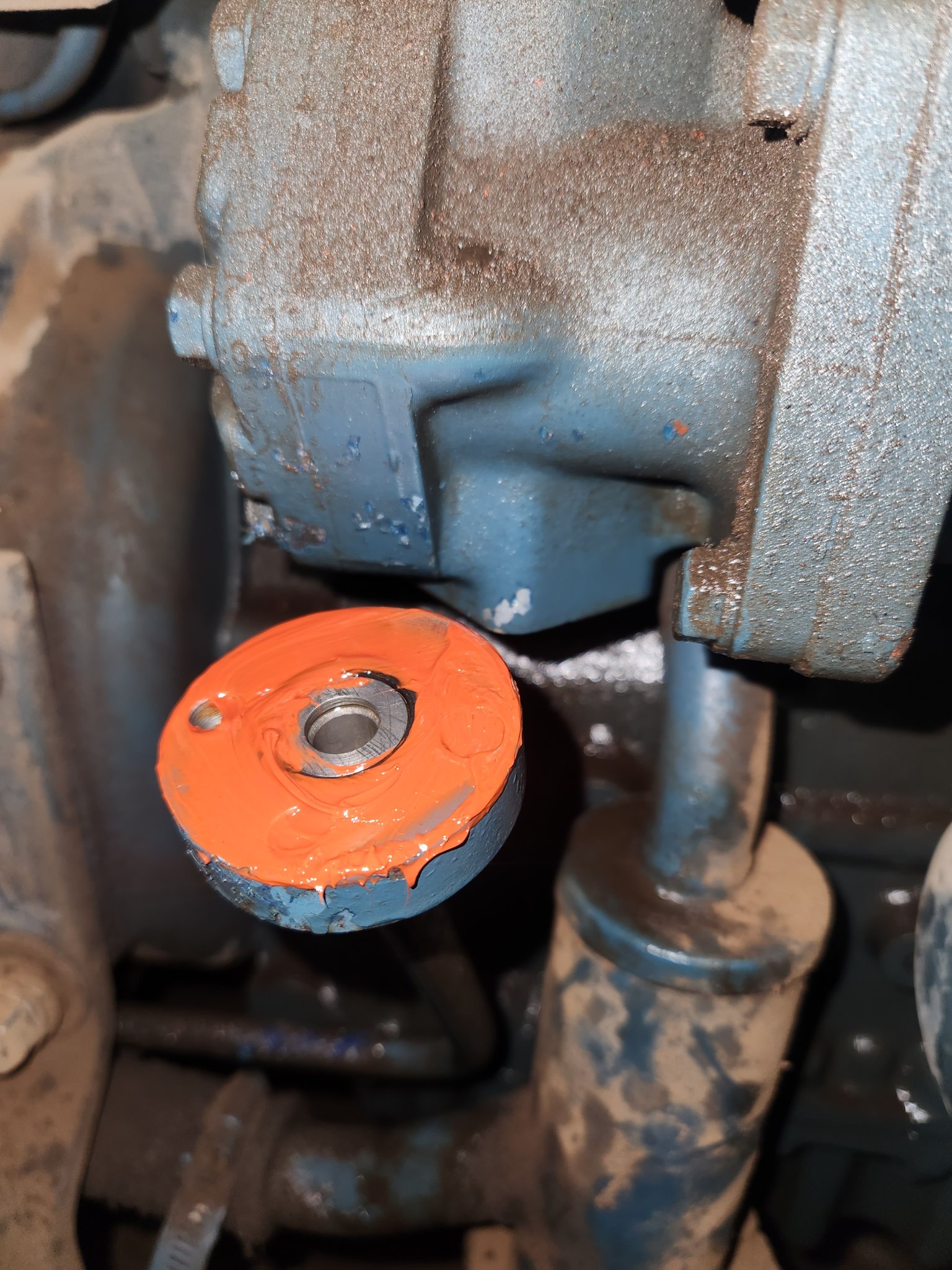

decision: you were defeated by that last hydraulic cylinder, clean it, and glob gasket maker around the seals, and hope for the best
go ahead and reassemble your hydraulic cylinder, and your hydraulic robot should not produce bubble since you seal up all hydraulic route, and your engine should not sputter out since you solved the diesel leak
you should be able to carve earth today even if one of your hydraulic cylinder still leak a bit, the hydraulic system should not produce bubble and your robot should function fine
do you a hillbilly rebuild, glob gasket maker and hopefully the pressure pushes it into the leaking area

brush everything with solvent, hit it hard with compress air, glob you on gasket maker everywhere there was leak, put extra hoping it pushes it and wedges it into the leaking area, hit it with torch to move the show faster

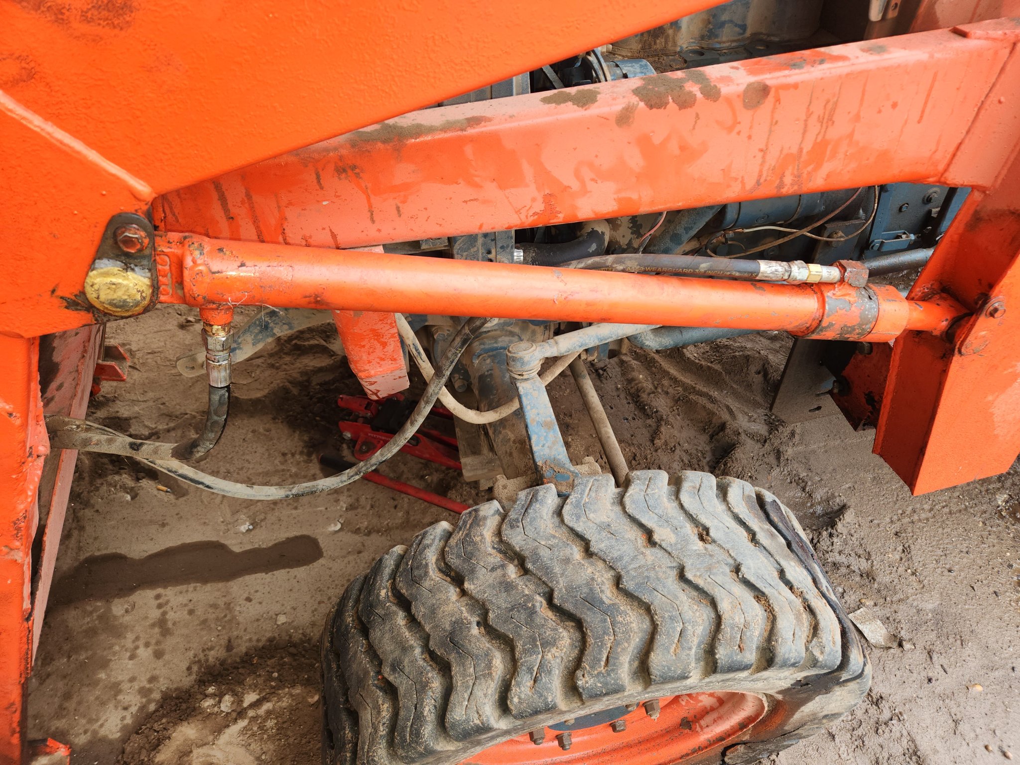

break your bx1500 front axle even more trying to push in your cylinder, push it up against a tree,
rig something up so it stay straight, calm you down and vow to never again try to rebuild cylinder without a press
your receipt that yes, this is a trainwreck

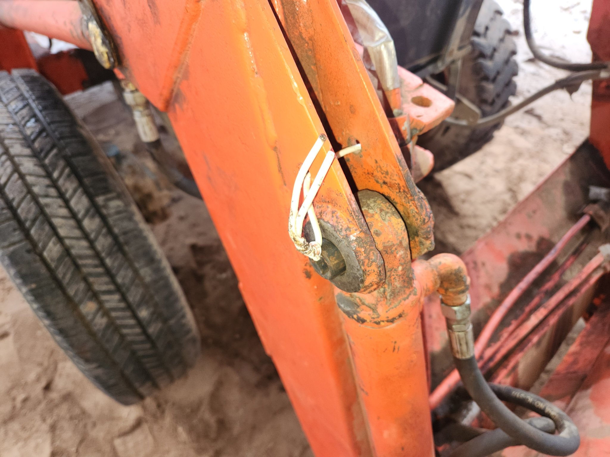

defeated by the cylinder, install it back on, tigthen all fitting, put in your hardware for the pins
hillbilly pin, you cant find this cylinder pin, get you a long socket that fit snug, rig you something that will keep it steady
rig you up copper wire tight around socket pin, temporary
pump you up that diesel pressure without compression, heat you up glow plug, get her started,
time to see if the leaks are gone enough to make hydraulics somewhat function properly

I would guess that those 2 fittings are some kind of low pressure flare to flare or JIC to JIC 2 size couplings not the proper adapter for use on the valve body pressure in and return lines.
