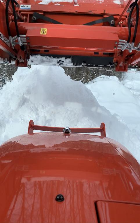

Update! Just pushed 4 tenths of a mile of snow with temperature at 34 degrees. We had several small snowfalls and after settling it was 4 inches, wet and heavy. I cannot be more pleased with the grooving of my tires. Pushed downhill and off driveway into piles and stacked. Not once did I get stuck or any indication of trying to! I was even able to push uphill!
Best $86 I ever spent!
Sure glad the supplier was out of tire chains for my front tires!
If your mule has tires that act like slicks in snow and ice, groove your tires!
