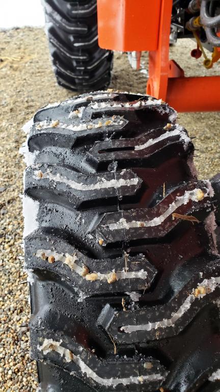

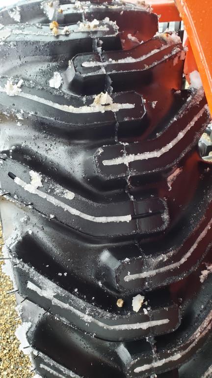

Driveway is solid ice, so I made a few passes up and down chewing up the ice with the rear chains.
Pushed off excess snow in a few spots I missed yesterday
All in 2WD with no steering issues at all.
Another vote for groovin':)
glad to hear you had success grooving your R1's! would you be able to post a picture when you have time? we understand that plowing just got a lot funner, and you may not have much time now :)

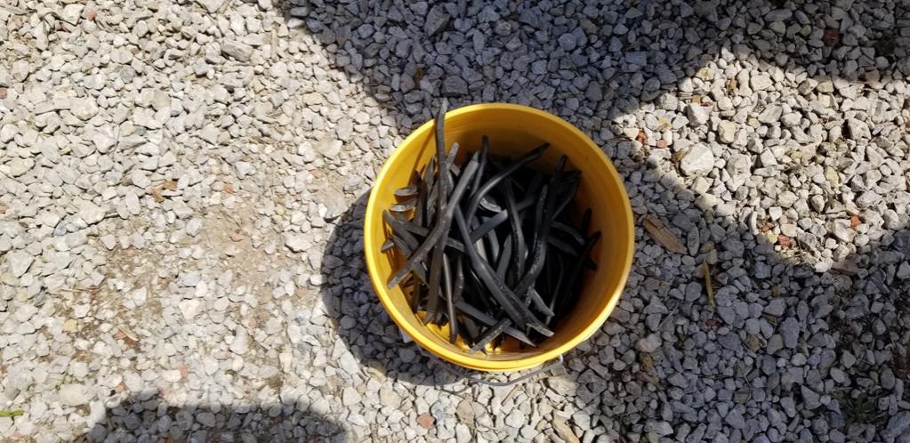

A couple of weeks ago I was waiting for a delivery truck so I waited by grooving the front tires. I left about 3/4" on the outside to possibly help save chunking on gravel roads. I only got the front finished. These are older tires have have considerable wear, but fine for what I use the tractor for.
The day after grooving I needed to go 1/4 mile on asphalt road to get some fencing supplies. The difference in sound was like street tires on a PU as compared to aggressive mud grips. Can't say about traction, it didn't matter!:D

It's really a pretty easy process. I got the groover in the winter, but decided to wait until warmer weather to use. The groover depth is adjustable, but the tip the cutting knife is clamped to needs to set down on the tire to heat it as much as possible. The speed the groover is pushed determines the ease of the cut. Slower means more heat, less pressure to push.
I'll get to the rears before too long!
