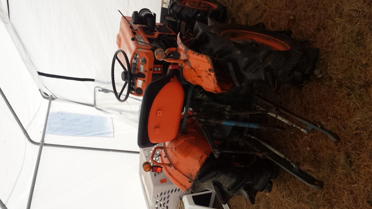

Thanks so much for the advice all. I did download a manual. The labels are worn off. (I have ordered new ones ). I didn't realize that there may be a pedal to drive both back wheels so I will check. I did push the lever on right all the way down. It only moves about an inch but seems the front wheels don't engage. I'll try moving tractor a bit to see if it will help. According to dealer, my tractor is almost identical to the B7100 and that's the manual that I downloaded for it.
I'm attaching a picture

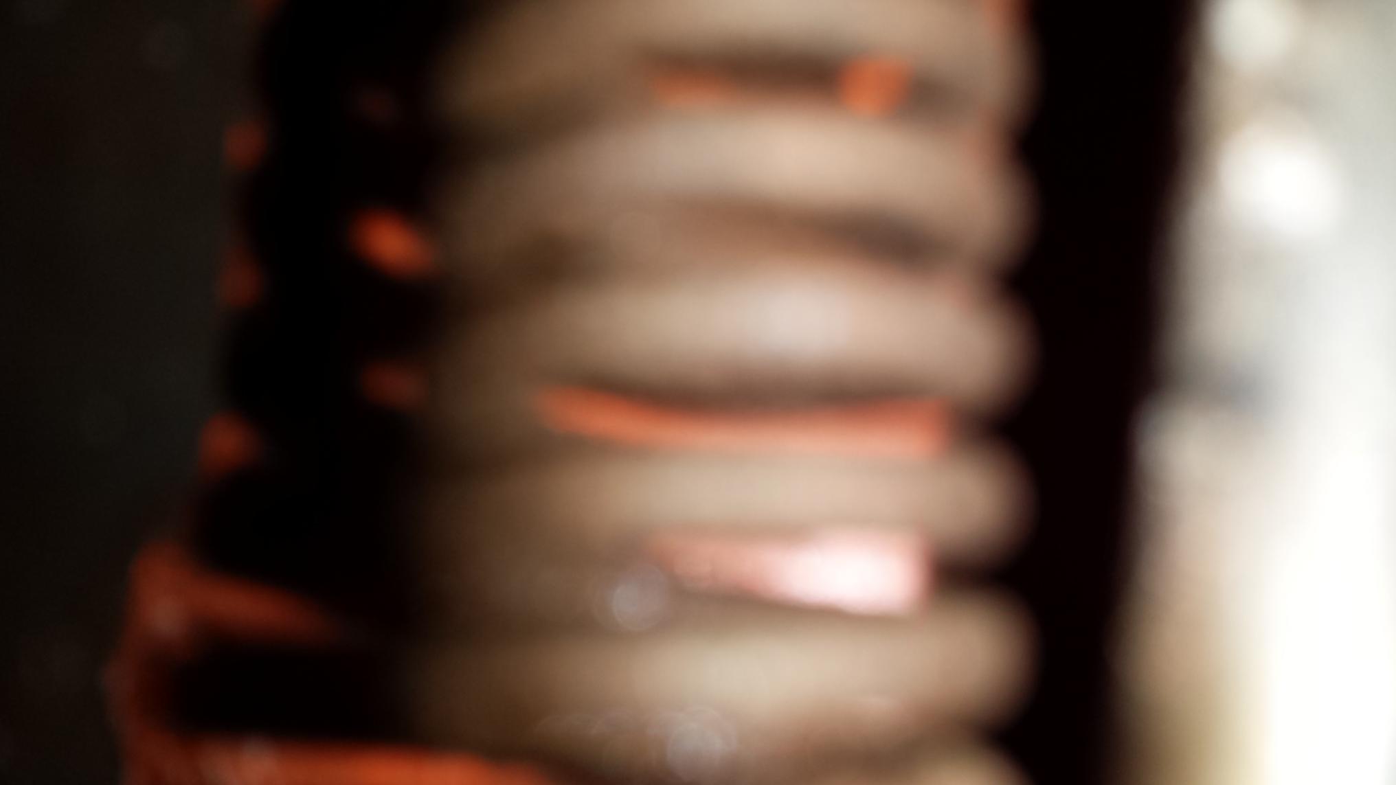

Hello. Still trying to get to the bottom of my 4x4 issue. I have found out that I have water in my transmission oil so I've drained it and will put fresh oil in over the weekend. I found a machined hole in the side of the transmission, left side near the floor. It has a hole about the size of a nickel with two threaded holes each side. Looks like 1/4" NC but may be metric. I've attached a picture. Does anyone know what goes there and does anyone have a picture they can share of theirs? Note, there is no loader on the tractor so it's not for oil feedback. Ideas?
33,304
8,648
If it's like the B7100, that looks like a hole for a shifter fork shaft.
but there is several that aren't used, and they are plugged on the inside.
Are you sure the hole is open all the way?
Give us a wider shot, it'll help determine its location.

Thank you. I can't get a better shot of the hole because the fender is too close. Ill try though. I did hold the camera and try to get a shot inside. It's poor. Looks like a spring.
What does the lever in this picture do?
