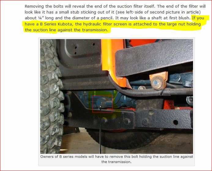

Thank you for your reply. Actually, I finally found a picture and description of what the darn thing is. Literally about 15 minutes ago. I love this site!! There is a cap that bolts on there and behind the cap is the transmission filter screen. I am now on the hunt for the part number and if it's available.
Here's the pix I found on here. It's very clear

That is not what's missing on yours, that would be the filter screen on an L, completely different.
it's also at the bottom of the case not halfway up.
Your filter screen is located on the other side, go to kubotabooks.com and download the 3 parts B7100 service manual and it will show you the filter location.
I'm really wondering if someone has tried to do something and put a hole in the case, as that hole on the B7100 is just a blank cast hole.

I do have that schematic a number of times but I can't find anywhere on it where it says filter or screen. I even had someone at work look because I can be daft.lol he couldn't find anything on the numbered items of the parts breadown either.
This is the link is stumbled across:
http://www.orangetractortalks.com/2...uction-screens-everything-you-wanted-to-know/
Note where it says "Where is my suction filter" My tractor is a 1971 B7001.
Serial number B700 1617
Thank you for your help and patience

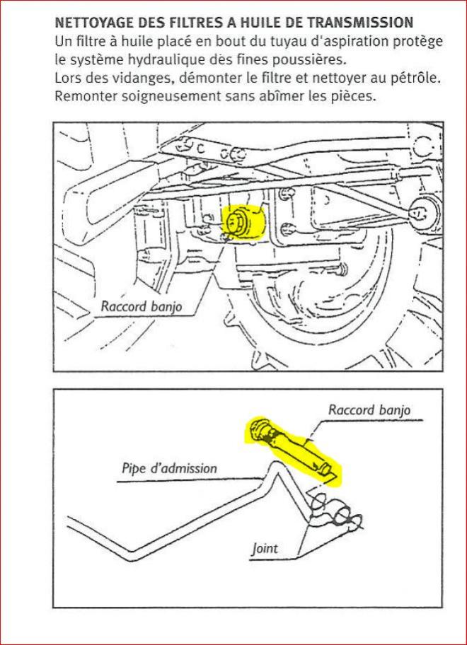

Ok here is a picture from the B7001 ops manual (in french) off of kubotabooks .com, I thought I would use this one opposed to the b7100, just in case I was missing something. ;)
The other pictures are all L's that show the filter on the left side, B's are on the right.

Thanks again for your patience and help. I was all excited thinking I had gotten to the bottom of it all. Lol
So that explains where the filter is. Any ideas what goes over the hole on left side?
