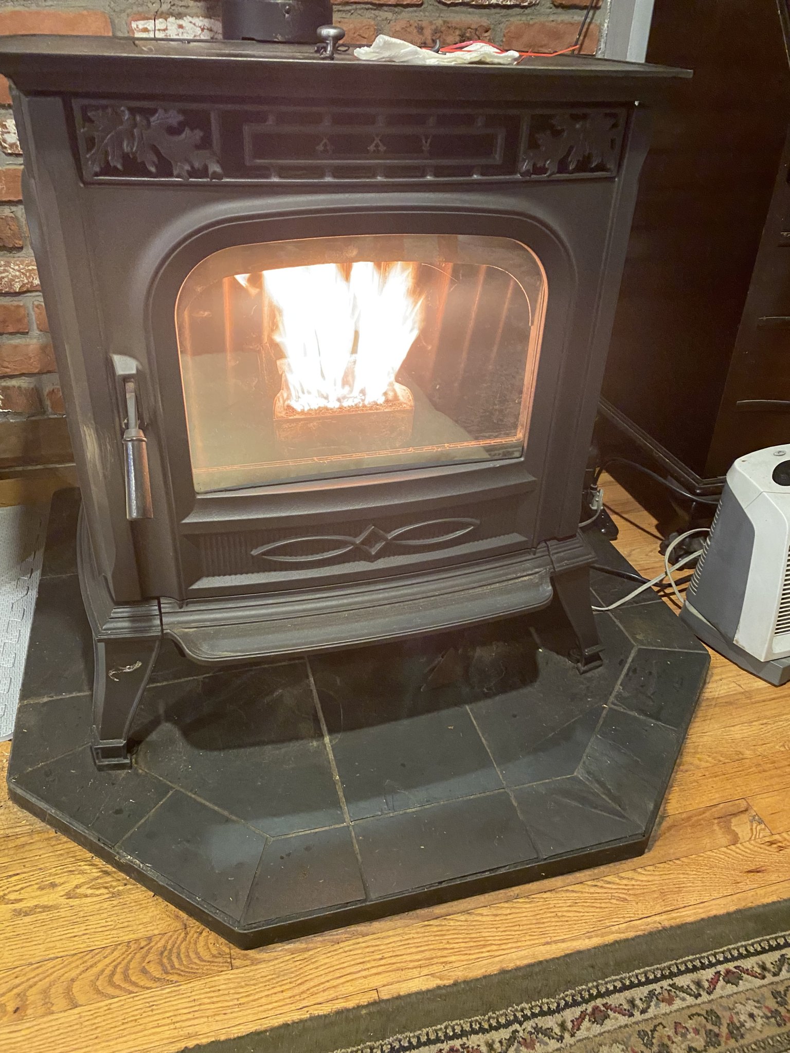

Holy smokes - - - the old XXV is fighting me this year. Won't run, and I've always had good luck fixing it as needed.
At first, controls acted a little funky. Ignitor would get hot and pellets would smoke, but it wouldn't take off. No error "blinks" from circuit board. Was thinking I missed sealing the new door glass, but no error code to indicate same.
Then ignitor went cold after a few attempts.
Changed ignitor, no go. Controls still acted odd, so changed circuit board. Then got a 3 "blink" error, meaning Exhaust Sensing Probe (ESP) not detected. At least I got an error code, so step in the right direction...maybe...
Working on a new ESP now.
The Ignitor, Board, and ESP are all old, and had replacement parts on the shelf.
Now I feel like I'm just throwing parts at it, and it's not a good feeling....

Hallelujah!!!....Hallelujah!!! :D:D
Tom - - thanks for asking!
I literally had a great moment about the time you asked the question.
I was so frustrated.....Ollie the dog is sick, cracked ice maker is on back order, washer is making noises,.....
If I had to guess, the Board crapped out...caused no ignitor heat, odd control response, and low combustion blower speed.
The problem was two dipswitches....
The first "dipswitch" was the 6' 4" idiot doing the work, and second was the 8 dipswitches on the Board.
The dipswitches on the new Board were not set like my old Board.....set them correct to old Board and good to go...
I wasn't smart enough to look first.... 😳
FWIW, dipswitch #5 is "off" for an older black wire ESP, and "on" for a red-wired ESP. I also had to change 1 and 7. Same Board, but probably the Board was set for a different model Harman stove.
I've bought aftermarket parts for a few years. The Ignitor was $20, and replaced one 3 years old. The ESP was also about $20, and the one it replaced was original. No loss for either....but I probably replaced good parts.
The Boards run about $200 +/-.
I'll probably get a replacement for each of them to have on the shelf......

Take a good look at your bad circuit board! Check all the soldered points with a good magnifying glass. You may notice a solder point that looks perfectly fine to the naked eye but under magnification you can see tiny hairline cracks in the solder. You would think there's no way that can cause a problem but it does. Especially check the area where the plug connects to the board this is a common failure point. These areas just need to be soldered again. I just went through this with a circuit board for a Hayward pool heater as it is a common failure on these units.

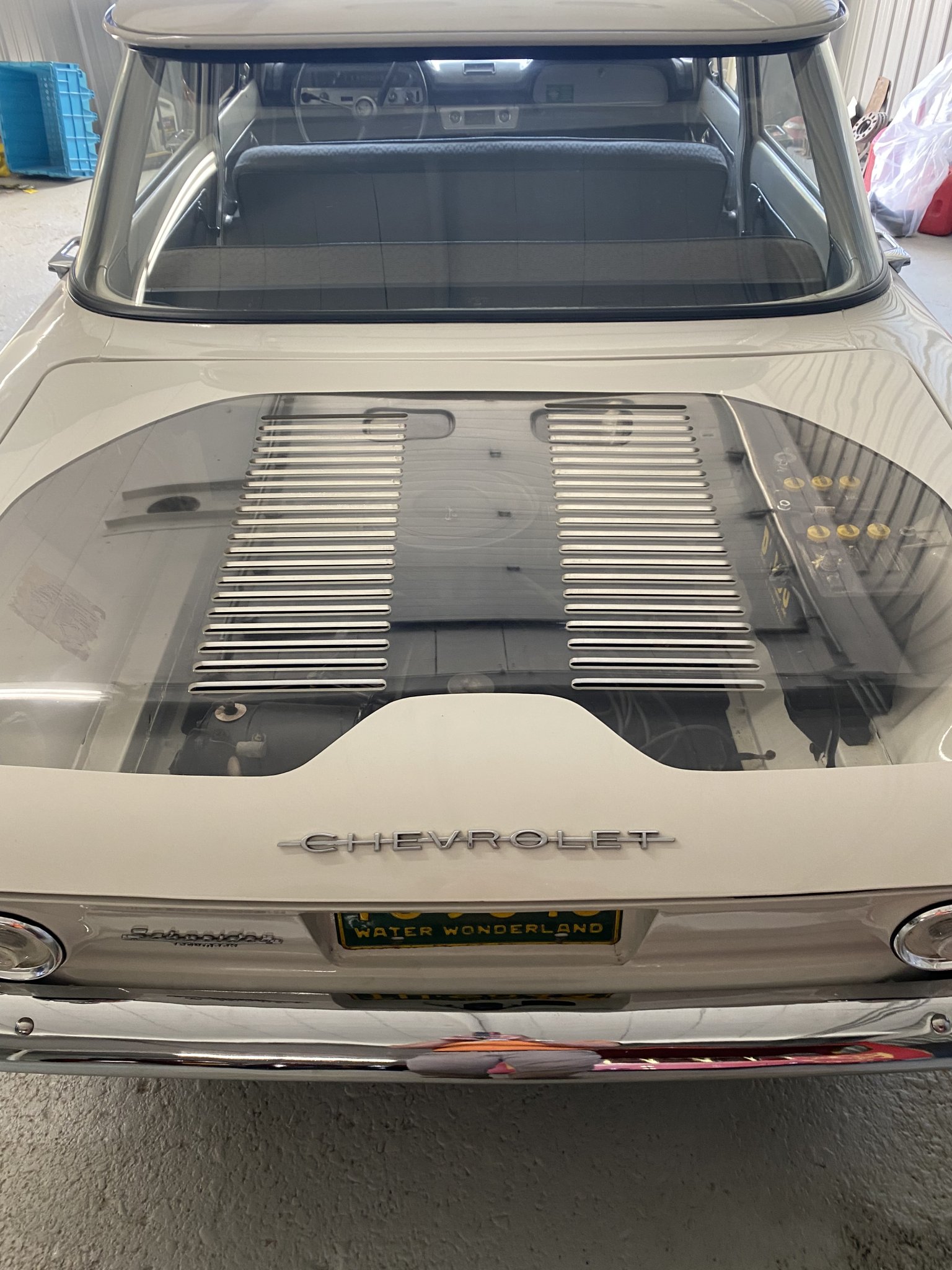

Dusty - - that's a real beauty!
Couple weeks ago I posted a Corvair photo when we were moving cars at the Car Museum I'm part of. Thought the hood or trunk...what do you call it?!?! was really neat.... Had never seen one like it.
We put it in the exhibit with that pointed out close to the guests, and have a Corvair engine on a rolling stand next to the car.

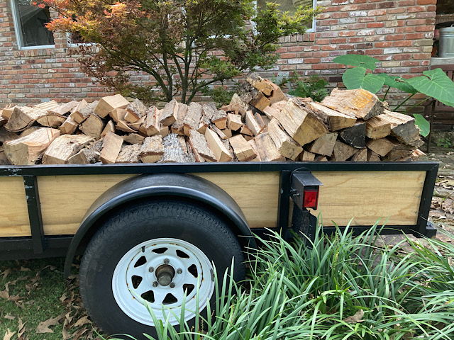

I had a few more sawmill slabs that needed splitting so......
I went ahead and split them before I put the splitter away. My trailer was full so I'll haul these sticks home the next time I am at the farm property.
Well, full was a bit more than my ZT could handle.
It was a different view for sure looking at the sky.
So I rearranged the load and......
Made it just fine. It was a funny sight. ;)

It is called an "engine lid". That is a 1960 first-year Corvair with the plexiglass engine lid that the dealers were instructed to put onto the car that was on the showroom floor, so prospective buyers could see the engine, without opening it. Every dealer got one in their initial stocking order of Corvair parts, and today, many have survived because many dealerships never installed them. Next time you are at the museum, look under the front bumper to see if there are a few stamped slots in the sheet metal. If there is, then that is a very early Corvair know as a "horn slot" car.

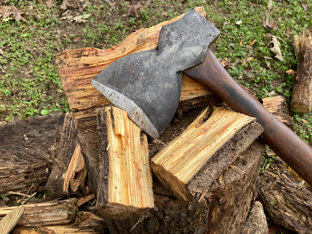

Sooo with my firewood stacked, this morning I turned my attention to splitting some kindling. There are lotsa colloquial terms like; fat lighter, lightered, fat pine, pine knots, etc. but it is all the same, and very rich with pitch.
I used the 'handaxe' that I rebuilt. It's certainly not designed for splitting but it serves me well.
I got started and didn't want to quit. Anyway, that is more kindling than I will ever use this year.
