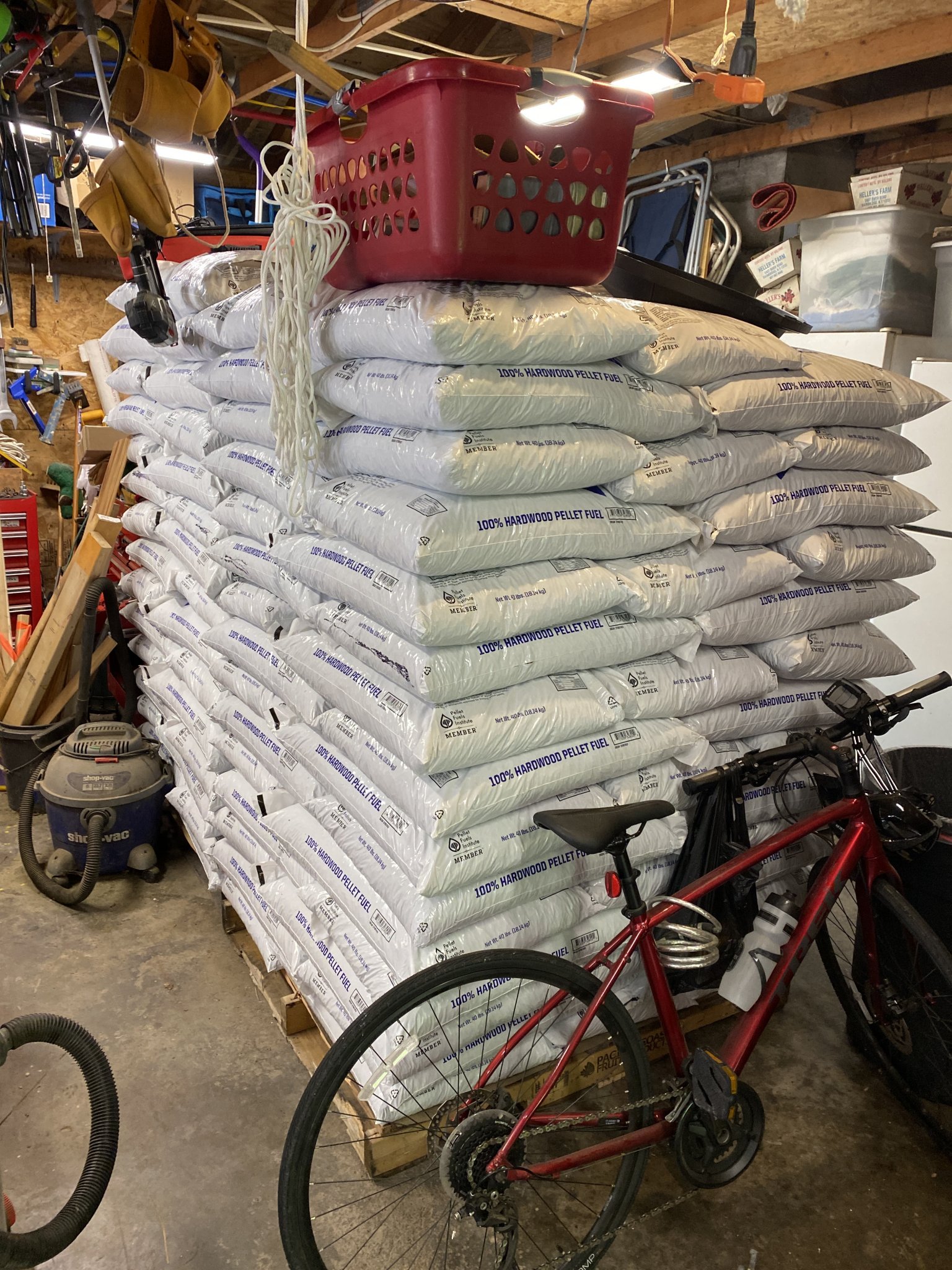

I will need to get 4-5 tons of pellets. Can’t store them too early, no room.

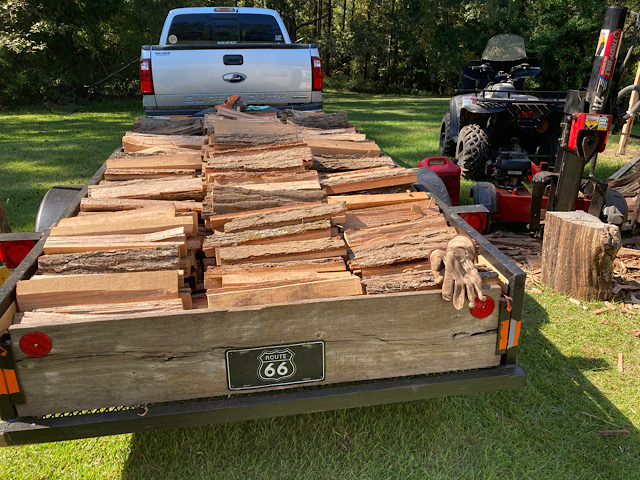

I'm pretty much set, good wood stacked, just have to take stupid tooth bar off tractor and put rear blade on.

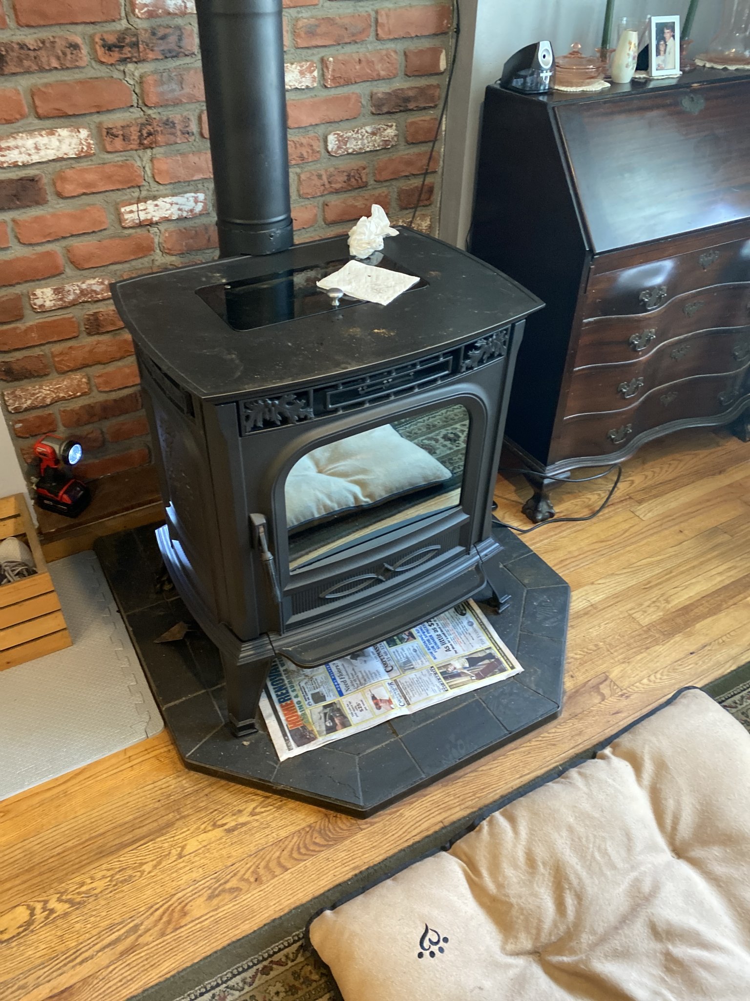

Three tons of pellets in…have another half ton left from last season. Will get another ton in October.
Tore pellet stove apart for preventive maintenance. Replaced the door glass after 15 years and about 80 tons. Old glass was getting pitted on the interior.
Putting it back together today.

Three tons of pellets in…have a half left from last season. Will get another ton in October.
Tore pellet stove apart for preventive maintenance. Replaced the door glass. Putting it back together today.
Is that a XXV/ I had one in a place we sold last year, nice stove. I bought a Absolute Harman for the home I'm in and love it. A bit harder to clean but that's about it.
What happened to the door glass.
10,333
7,366
Tom - yep, an XXV. Had it 15 seasons. It’s our primary heat for our 1,500 sq. ft.house.
If I bought another pellet stove tomorrow, it’d be an XXV.
We have an oil boiler/hot water baseboard system, but prices can get scary for fuel oil. We burn about 20 gallons of fuel oil per year now, versus 1,100 when I burned wood.
The glass was just eroded close to the burn pot. I would clean it and the ash would coat it overnight. The price was scary….$250 for a small piece of mirrored glass.
