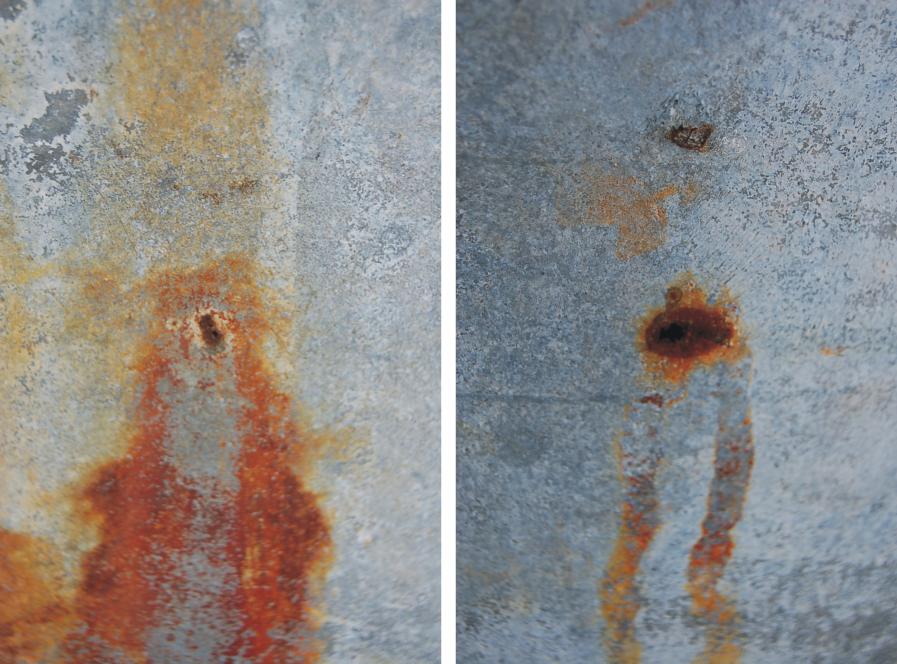

Picked this up today, a freebie, 20" x 58" water tank,
think it will make a nice "roller" for behind the box blade
after driveway fixin :D
Has two maybe three pin hole leaks, but a quick weld-fix.
Unless I calculated wrong, it is about 18228.57 cubic inches or 78.9 gallons :confused:
or 631.20 pounds of water, plus the weight of the tank?
Probably close to 700 pounds said and done :rolleyes:

If you can get away with not welding galvanized... then do it. Nasty poison gasses are released when welding galvanized metal.
Since they are pin holes just put a sheet metal screw in them with an Oring or just silicon on the base of their heads.
Another option is fill them with sand instead of water.

Yep, I know that but there's no getting around doing some welding, I need to check and see what kind of masks I got and also I will have to have a fan blowing the gases in the opposite direction of me.
I thought about possibly using sand, that will get me another 4.25 pounds per gallon roughly.

When welding galvanized iron, the main thing is don't do it in an enclosed area without ventilation. Grind off as much of the coating as you can where you'll be welding.
I would consider filling it with sand. Then there is no concern about getting it drained before winter, 'cause one time and you'll have more welding to do!!

Zinc is not harmful. It will make you ill but its non carcinogenic and pretty much non toxic. The body will eliminate any excess zinc you ingest.
When welding it you create zinc oxide, same stuff people cover themselves with when they dont want sunburn.
I would still ventilate.
If you get flu-like symptoms afterwards, it will pass. If i recall, drinking milk helps with welder's sickness.

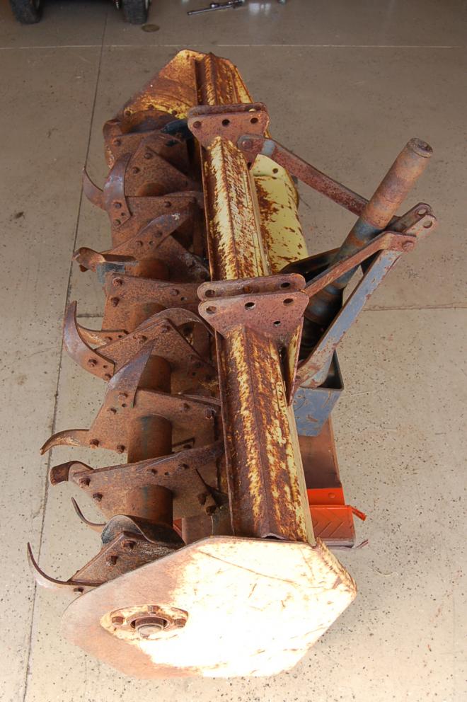

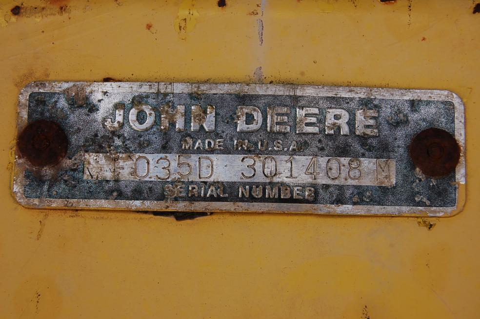

Thursday I picked up what I thought was a model 48 John Deere Tiller.
It turned out to be a model 35, same make, different model,
did not find the S/N Plate until it was home and movable...... :rolleyes:
Seller wanted $175.00, got it loaded up for $100.00
A bit rough, has two bad bearings, but I will change all three, it's a project :D

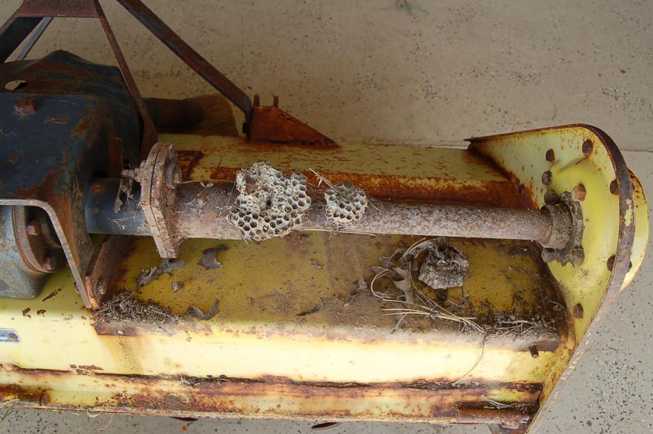

So as usual, once an implement is brought home,
it is immediately torn apart, it's just what you do :D
The drive system, chain looks to be a bit stretched
Pair of shot bearings
So Friday got the bad bearings and tines removed.....
.....and everything cleaned up, today I will tackle the last bearing and gearbox. :)

Finished the complete tear down, short of removing all the tines. :rolleyes:
I was amazed as to how easy it all came apart, considering all the rust (one snapped bolt) :mad:.
The gearbox, which turns and sounds great, had NO oil at all, NOT A DROP :confused:.
I flushed it up with kerosene, no bits came out ,
but I will need new seals and two new bearings for the tine shaft.
