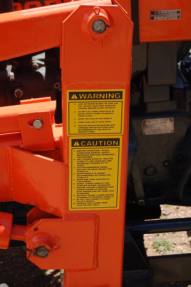

Got all the new, decals on the Great Bend loader.
One more thing off the "To Do" list,
Only have one leaking hose to replace! :rolleyes:

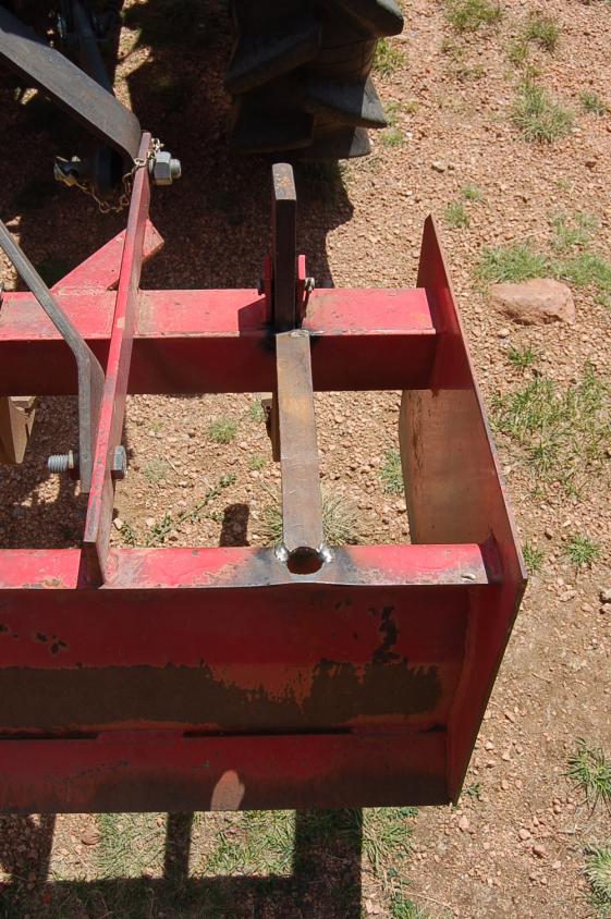

Added some weight to the rear box blade so it will dig in better....
Added a post hole for additional weights
Added a post hole on the right side for angled trenching also
Currently have 65 pounds added
A coat of black paint for rust protection
