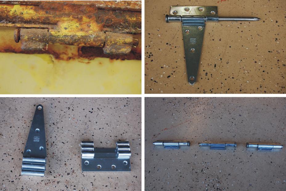

A little premature on that statement:mad:, the safety door (which is missing) hinges, are completely rusted into one piece. So replacements are in order.....
A few hinges of the correct dimensions, just modified a bit.

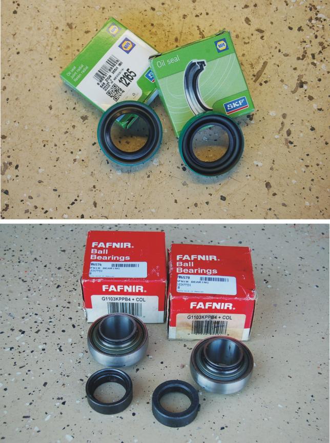

Got new seals and bearings

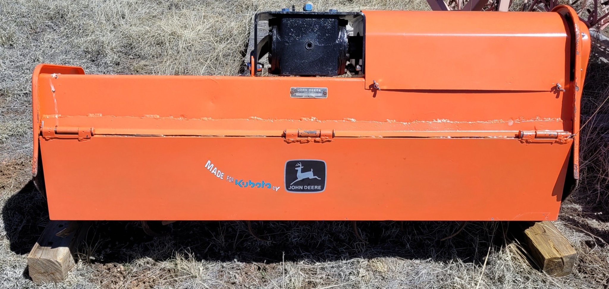

Well! Six years later, I am finally finishing the John Deere 35 Rotary Tiller.
Everything is painted and reassembled;
Tomorrow I plan on mounting to the tractor and sizing the driveshaft to the correct length.

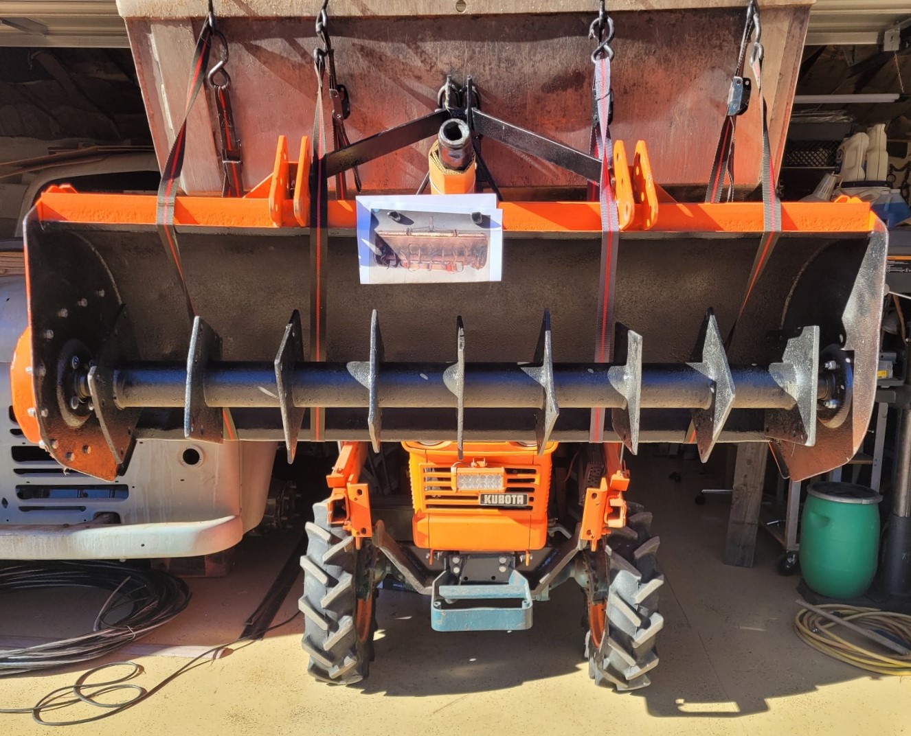

Got the nuts and bolts for the tine re-installation, last warm day for a while so lets go,
Tiller at a good 'working height'.
Everything set out and....
....ready to go.
72 nuts and bolt later!

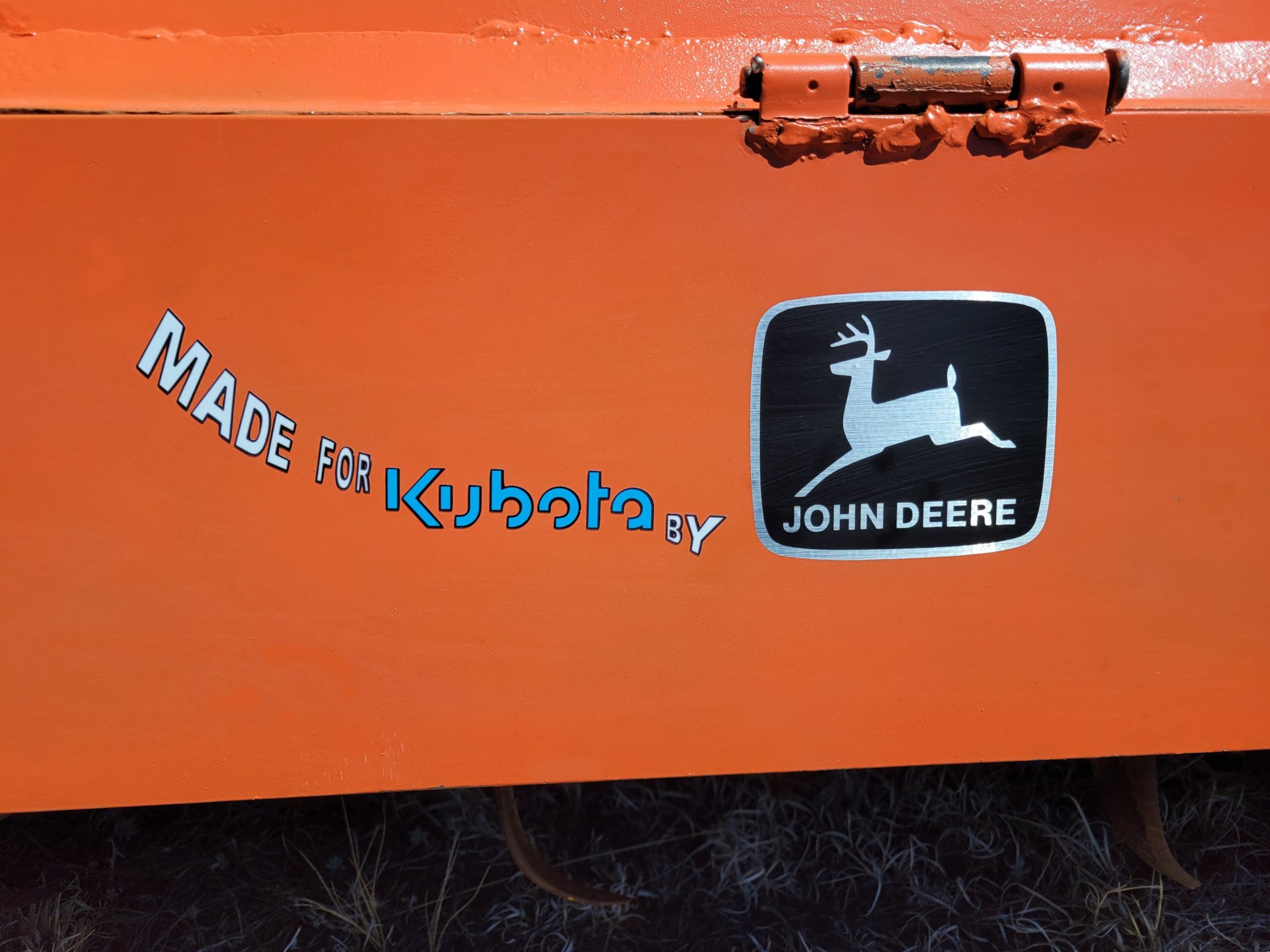

Be glad to have this done and out of the shop, six years later, still need one decal.

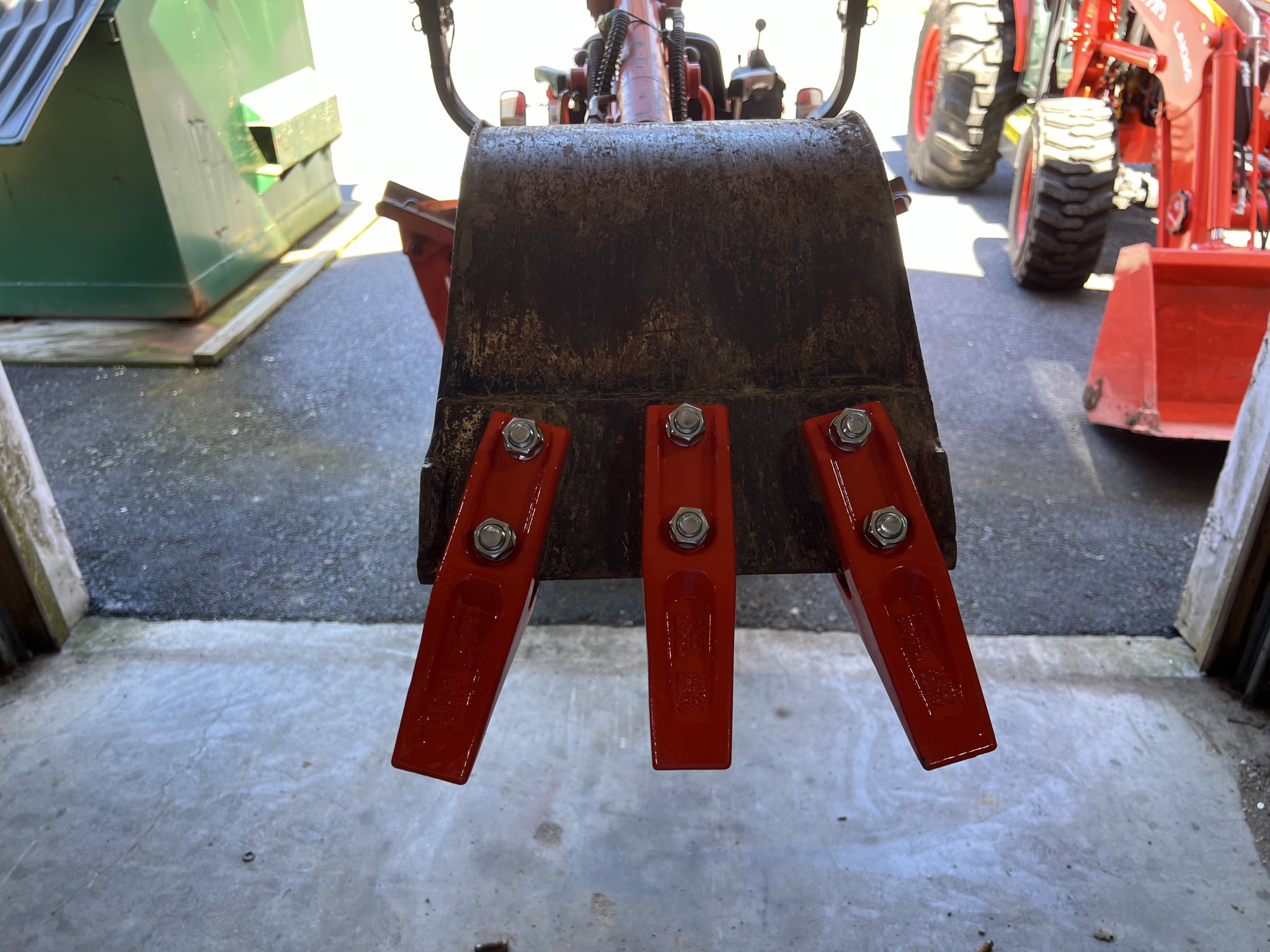

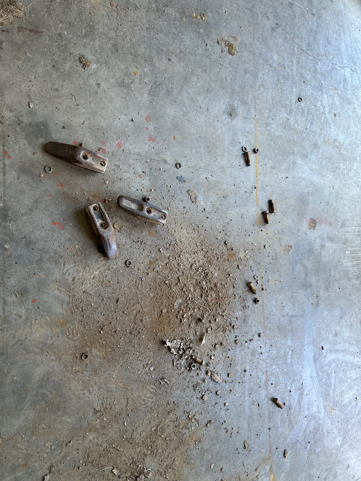

The hoe got some new dentures :ROFLMAO:
