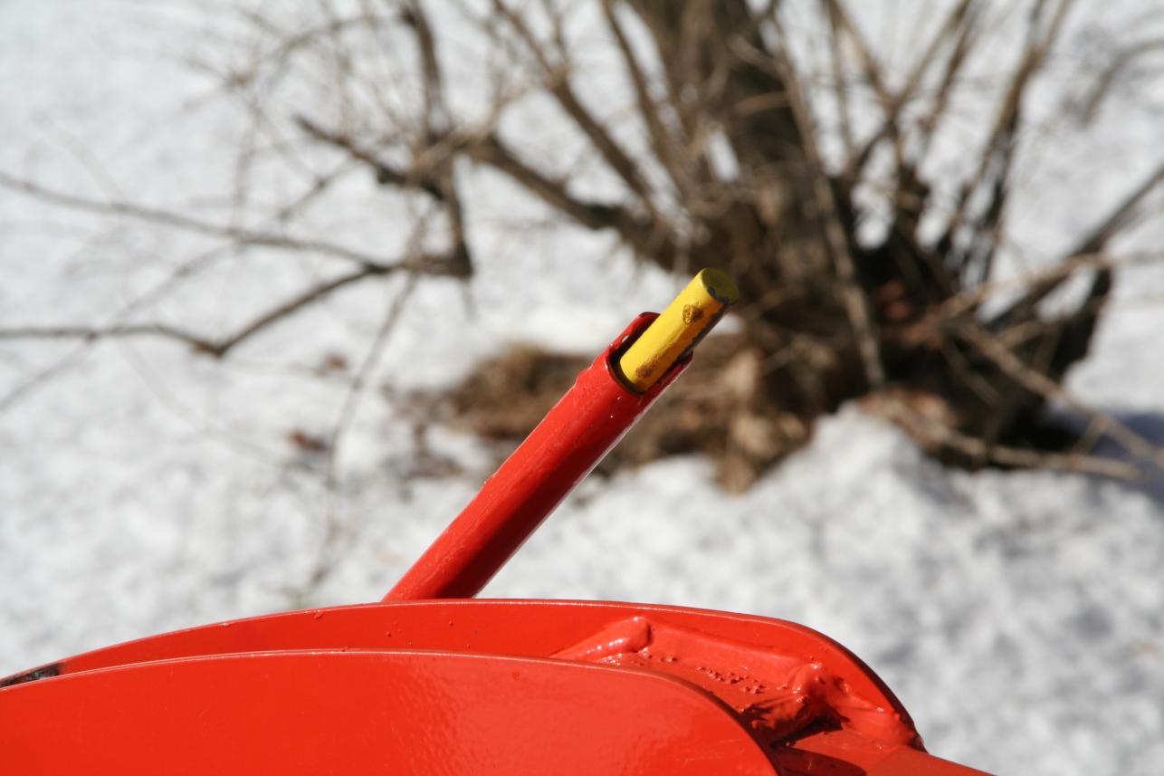

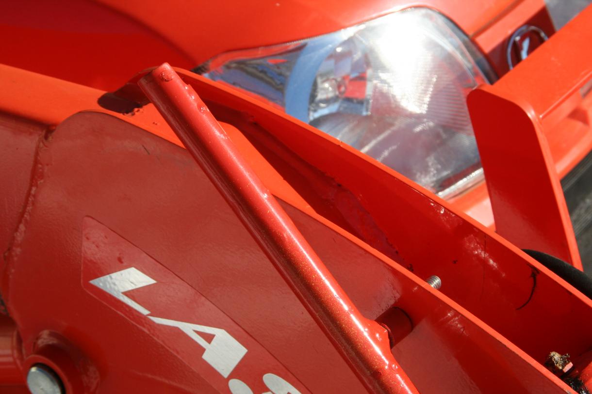

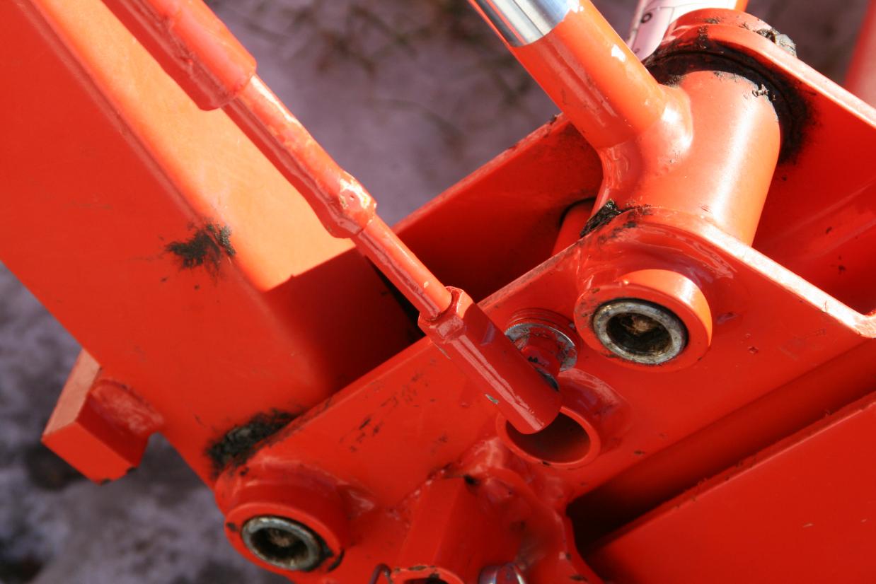

Didn't do anything on the Kubota today. It was -11 F this morning with 10-15 mph wind. However it is warm inside so I thought I would get around to posting some pictures of the Sight Guage I made for the bucket to indicate level. Pretty simple, used a Hound Joint, a piece of smooth rod and pipe. Welded a long nut to the rod, drilled a hole in the quick coupler, threaded the Hound Joint into the nut using a jam nut, slid it in the pipe and bolted that to the loader where the cylinder attaches. I notched the end of the pipe at the top to see the rod as it is getting close to level. With the threaded nut and joint, I can fine tune the adjustment as needed. Works slick and makes it much easier finding level.
Thanks for posting, I know what I'll be doing next week.
