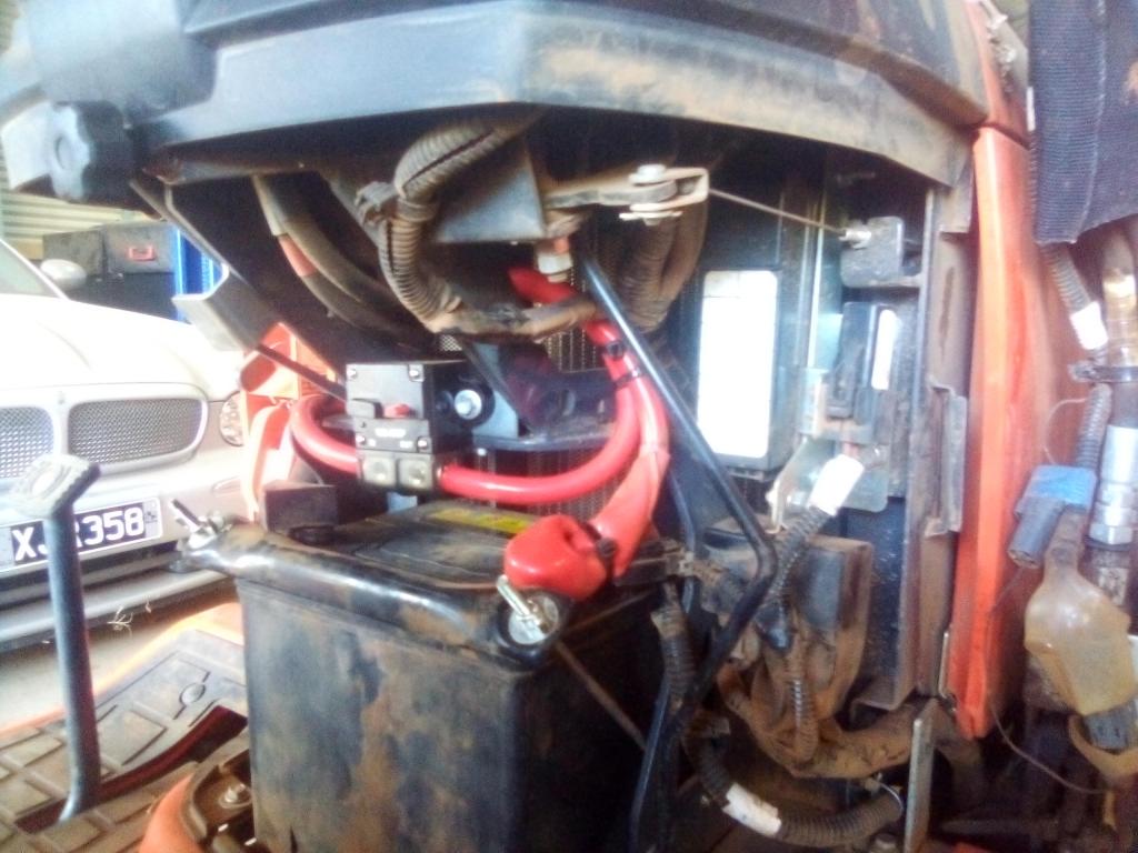

Installed a 120A anderson plug on the back of the BX.
Also mounted a 120A breaker at the battery to protect from a short
