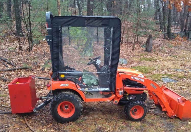

Installed a Bercomac vinyl cab on the little beast this weekend. Had to remake rear vertical pipes taller and with an offset to get in front of the ROPS.
Once we get past mud and the ground freezes up I will swap from FEL to snowblower.

This is perfect, how much did it cost you? Iv been looking for a low budget cab just to use for plowing in the winter, I’m sick I freezing already!
It is a universal cab for lawn and garden tractors. A little short for the BX. I remade the rear uprights (1/2" EMT) to be taller and shift it forward of the ROPS. For $300 it should keep the blowing snow off me while using the snow blower. Test will come this winter.
