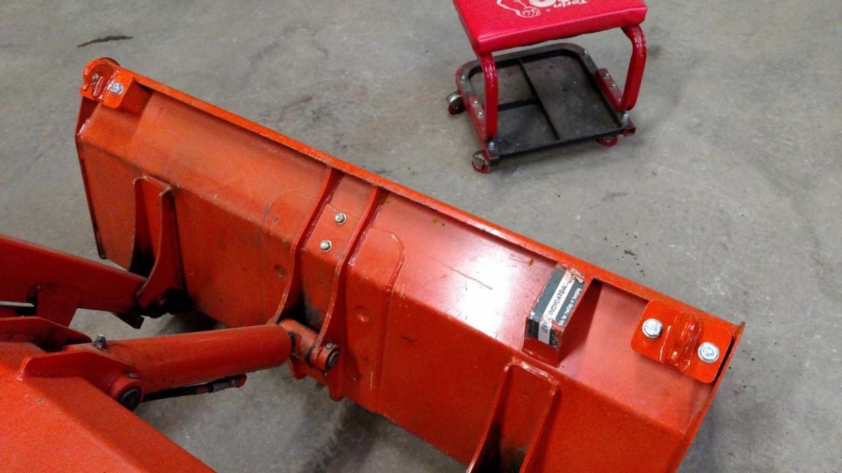

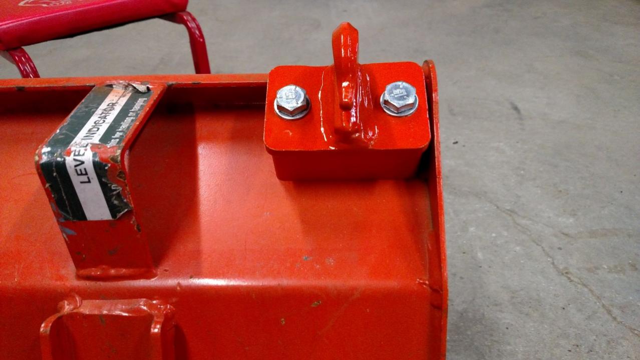

Mounted a pair of Titan 5/16 chain hooks on the bucket of my BX2230. I bought them on Amazon and welded a 1 1/2" piece of 2" X 4" tube to them so the would clear the top lip of the bucket. I also made a couple of reinforcing plates for inside the bucket out of 1/4" X 2" strap. Sand blasted everything and painted them Kubota orange, let them dry for a couple of days and bolted them on last night. I already have a D-ring in the center of the bucket, which I have used several times already.
I'm working on a plate to bolt to the ROPS mounting bolts behind the seat to mount a tool box on.

My tractor had hooks welded on when I bought it, but if I ever do that to another tractor, I would weld the hooks on the bucket in line with the loader arms instead of at the ends - I was pulling on something or another recently and my bucket was flexing more than I would have liked at the ends.

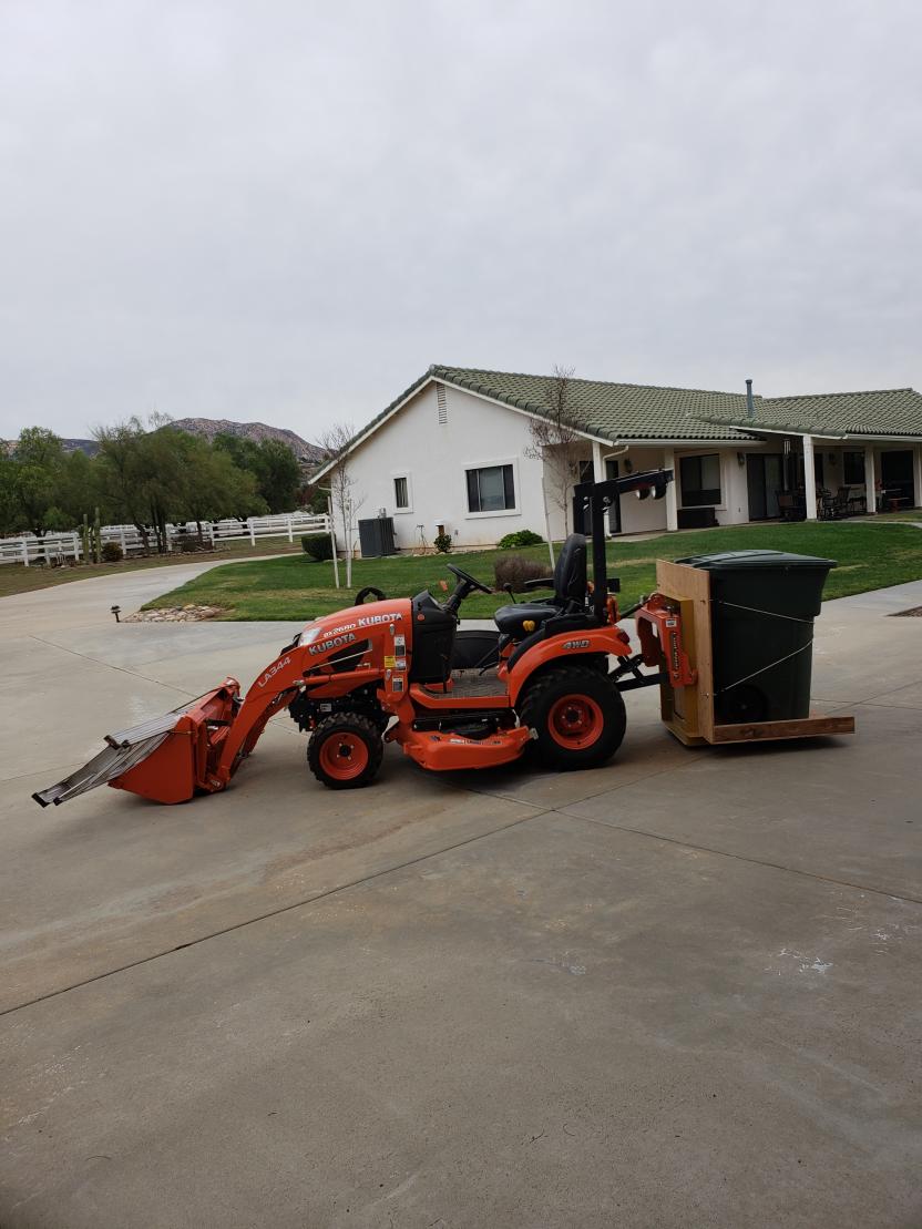

I used mine to help put my hardtop on my Jeep for the winter - after the last snow storm I figured it was time! (I don't have a garage...)
The Kubota with the pallet forks clamped onto the bucket did the heavy lifting for us!

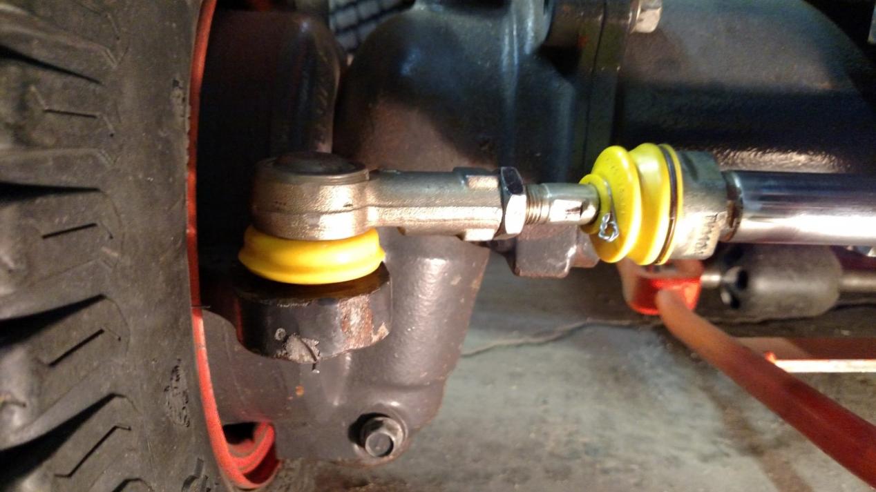

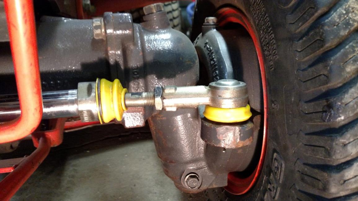

I installed the silicone tie rod seals I bought from Specialty Repairs in Canada. It was pretty easy and they should keep the moisture out of the joints. The original boots were all torn and one was completely gone.
I used safety wire to secure the small ends of the inboard boots. Worked better than trying to reuse the crimped on rings from the originals.
It doesn't appear you can buy the boots from Kubota, at least they aren't listed separately in the parts manual.
No worries now.
It only took about an hour to do both sides.
