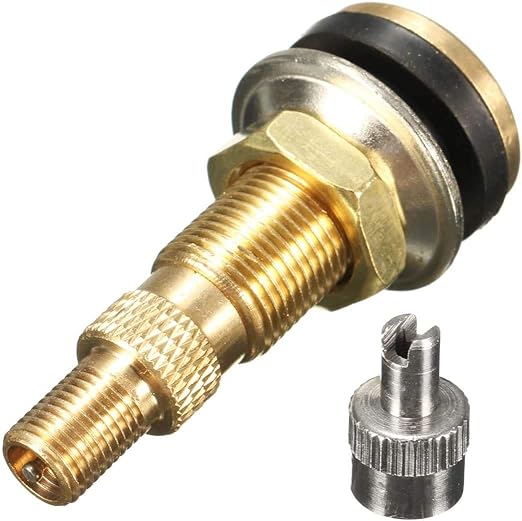

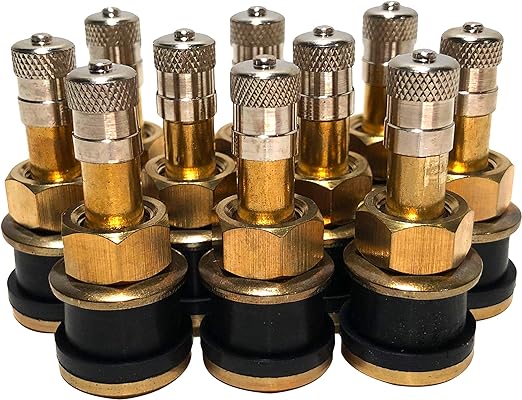

Learned a lot about metal valve stems and now the difficult part is determining which is the best choice. Here are the 2 choices that I have narrowed it down to. Price isn't a factor, because we are only talking about a $7 difference in the 10-pack of valves. Both say that they are for filled tires. Can you help with the selection? These are to replace the rubber stems when I fill the tires with Rim Guard or some equivalent. The Kex is the First Picture and the full thread is the Hornet second picture. Pictures of the actual part courtesy of Amazon dot com (US)

People always say, "You get what you pay for!" If that old saying is true, buy the more expensive ones! Since I don't really know about which might work better I'd buy the ones advertised for agriculture.

If you're going to just air fill them either will work.
If you're going to fill them with liquid get the second ones.
