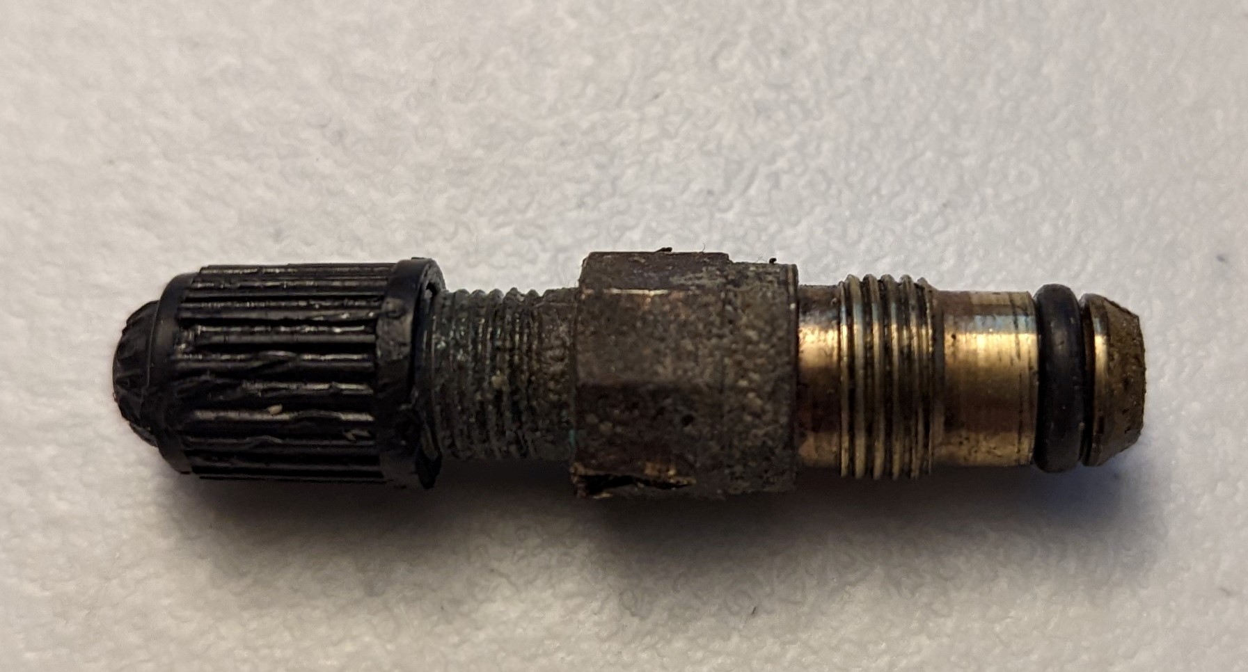

So I cried my sad story to a buddy and he came over with this part.
We took a couple pair of vice-grips to see if we could get the top part of the old valve stem apart, and low and behold, it did!
This is what the part looks like that we removed.
And here is the base of the old valve stem with the new top piece from the part that my buddy brought over.
After jacking up that side of the tractor, the whole job took about 15 minutes!

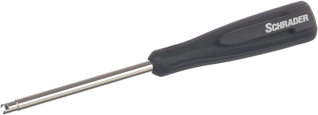

Now you're saying a schrader valve can be replaced with a "special" screwdriver? ;)
Here they call them a schrader valve torque tool.
