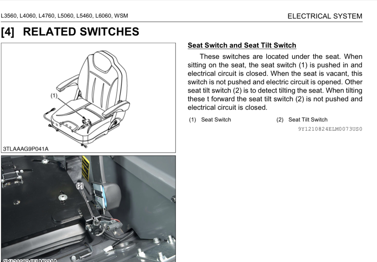

I don't know how the new 3560LE is wired up, so you should get a shop manual to identify the part you connected to. Wiring diagrams and parts lists can be found online at Kubota website. However the 3560 has a seat switch INSIDE the seat, so you may not have connected to the right part.
I don’t know the difference in the 3560 and 3560LE. But the 3560 manual clearly shows two sensors. One in the seat and the tilt switch is external.

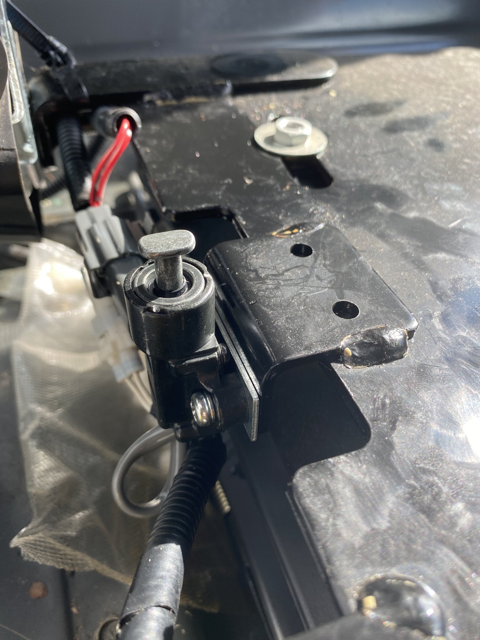

I just installed a PTO switch on my L3560LE that mounts on side of seat to keep tractor running when I get out of seat with PTO engaged. How come the tractor still shuts down when I get out of seat. The connector was there already just had to plug it in and screw it down. View attachment 66573
hard to tell from the pic, but is that connector fully seated on the new switch? In the picture it looks like it may not be?

Well there is one two wire connector going to switch in seat. The second two wire connector in picture is the one I connected the new switch to. It is fully seated as I checked. The difference between the L and LE on the LE there’s no cruise control switch…No PTO Switch (The one I just installed) and there is no seat tilt switch. So I know it is wired correctly as it is plug and play. Why it’s not working is beyond me.

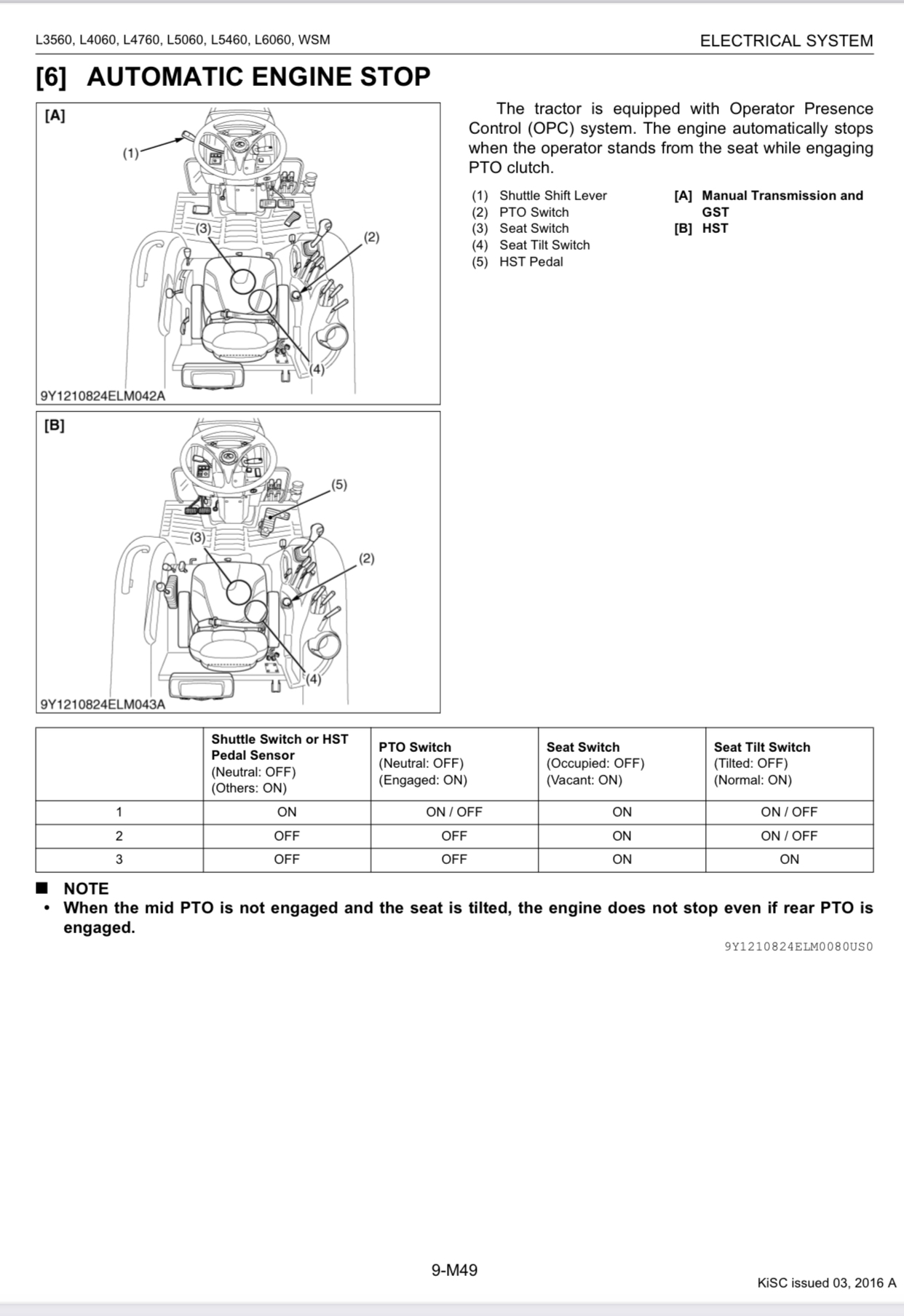

Do you have the seat flipped up before engaging the PTO or are you engaging it while sitting in the seat then getting up and flipping the seat?
. If I’m seating in the seat with PTO engaged and I want to get up with PTO engaged the tractor shuts down. The switch I installed is supposed to keep tractor running while out of seat.
The way I read it you need to have the seat in the flipped position before engaging the pto
Well I guess that defeats the purpose I installed the switch for. Im going to try that later today. Thanks For You Response. 👍
I guess that’s only for running a generator; ect when not in tractor. Guess I’m going to have to unplug the wire going to switch inside seat and put a jumper wire on it.
