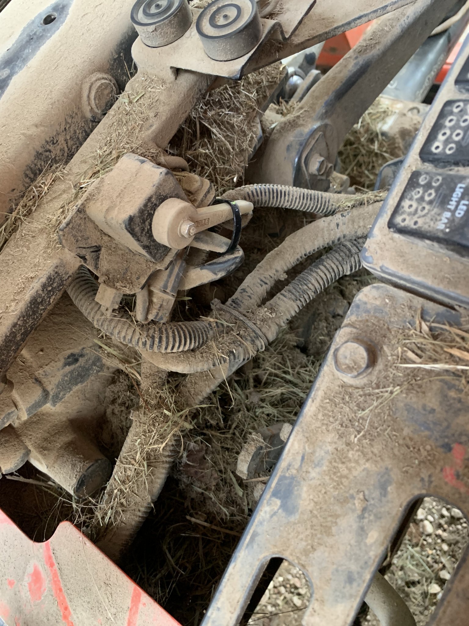

Mine is nearly identical to yours. Yes the gear models have the safety on the range selector, hst have the safety in the hst pedal. For the few times I need to stand up and move the tractor I will take a zip tie and tie the switch under the seat down, then just cut it when Im done.
It can be a little awkward though standing up and trying to use the clutch and loader at the same time 😁
I had to load it up tonight so I figured I would get you a pic. I just tie it down to the wiring harness under it. It doesn’t need to be pulled very tight.
Edit:don’t mind the dirt 😂
Mine doesn't get washed and waxed, I did pressure wash it last week for the second time in 90 hours,
I just put it away with a bunch of clay soil stuck in and on the front bucket! Thanks for the picture of the switch too!
