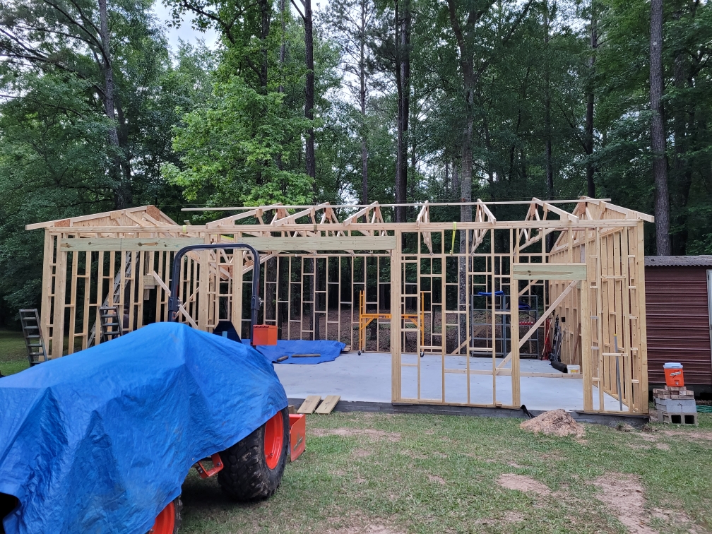

4 of 10 trusses pointed in the right direction. 18D00627-4640-4D45-89BA-755A97429608.jpeg
Being the only person here that ain’t afraid of heights gets a little inconvenient, so I’ve done most of the work by myself except for gopherin.

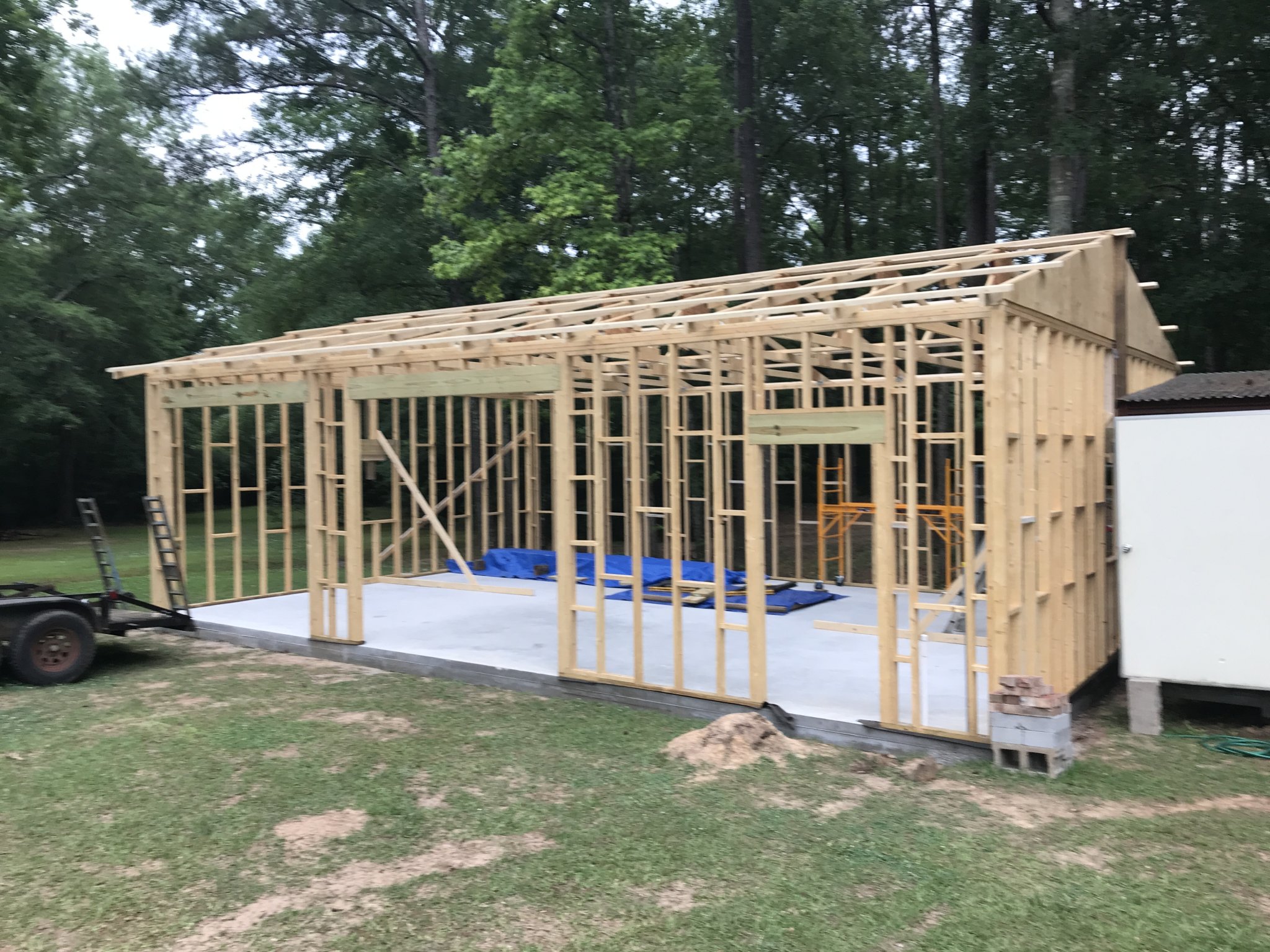

But, still managed to get 4 more trusses pointed in the right direction and the walls pulled back into a straight line. My photo:
And a couple the missus took:

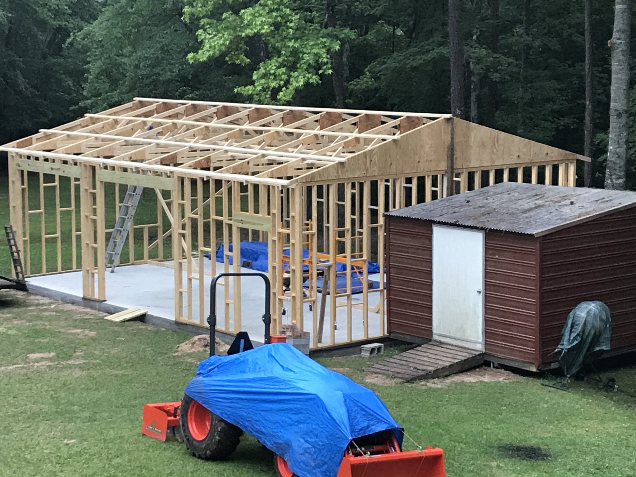

North side purlins installed and leveled (ok except 1). 1268E23C-CD25-426B-A883-C9B0A6797C86.jpeg

All purlins up, straight, and leveled. Silly me forgot some very basic practical science and didn’t use a string on the four purlins on the north roof section. DUUUUUHHHHH! Did all four purlins on the back slope in half the time and half the arboreal acrobatics. With the exception of the faux rafters on the gables, the bones are up and it’s ready for some skin. Even gave a blood sacrifice to the slab in hopes I can get a roof on it by next weekend. Had a small scrape on my left thumb and caught it on one of the screws I had started in one of the purlins. Pretty minor wound, but looked like I needed a transfusion with all the blood on my hand. Sweating profusely at the moment probably didn’t help matters. It be summertime in Alabama boys and girls. The missus is gonna call a strike if I don’t finish it up soon.

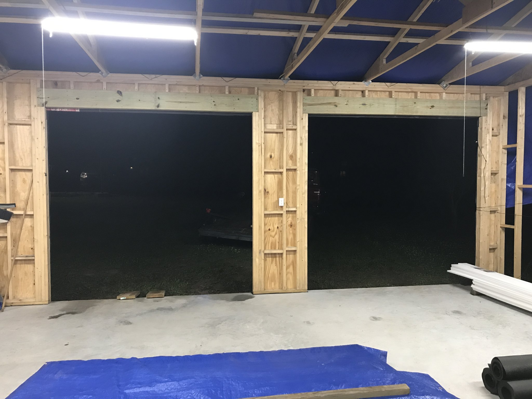

Lil’ O’s new house lit up the first time. Overhead wiring done. Running whole circuit with a cheater cord plugged into an extension cord from the old shed. Hoping to reverse that situation sooner than later. Once I get the roof on, I’ll call the inspector. He said all he needed to see was the bones and the juice. gonna put one receptacle on each end, two on the back wall, two on the front wall, and one exterior outlet with GFCI to help keep me from frying myself.

I used a motion sensing switch for the lights. For now, I have it programmed for manual on, Auto Off, which guarantees I won't leave 'em on. I may change that later to Auto-ON/Auto-OFF with Daylight override, similar to the flood lights I have on the house. It should be dark enough with the roll-ups closed to still work in the daytime. I'm more concerned about something obstructing the view and it turning off the lights while I'm working though. Guess I'll have to stand up and wave at my invisible friend every now and then. Still gotta wire the outlets. Gonna run two circuits with 12/3 wire rather than pulling in two separate cables. Gotta lotta holes to drill in the studs, and may not have quite enough wire. I had plenty 14/2 for the overhead lighting stuff. Old inventory just saved me nearly $250 for the wiring. It's UB, but I don't see that being a problem since the insulation is better than Romex. The outlets are getting AWG 12 simply because I don't like AWG 14 for power tools. Again, that thing about using a 20 lb sledge hammer for a flyswatter. Got a few tools that will be getting upgrades/upsizes, so want plenty ampacity to run them.

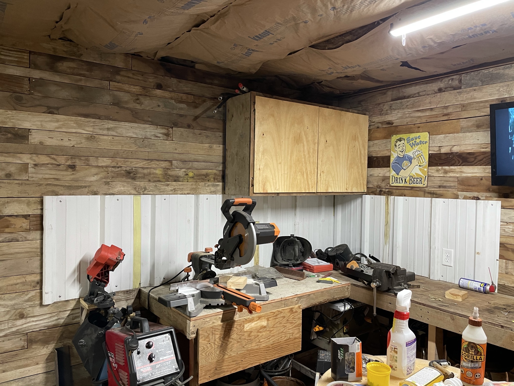

Nice build, you're a lot like me in that you save stuff from other projects to build new stuff.
You should re-use the aluminum siding from the old shed on the walls inside your new shed. Might look nice as a wainscotting.
Or if you plan to do some metal working in there it's nice to have something fire proof on the walls where you grind and cut metal. I was in a similar situation in a small workshed I just built. I lined the walls with plywood strips I got from a custom concrete company that used them a forms. I was worried that the sparks from metal working would catch either the plywood on fire, or get between the cracks and catch the paper face of the insulation on fire. Luckily I had some oddball metal roofing that I was kicking around and almost threw out. So I cut it down and lined the back of my workbench with it to catch the sparks.

That’s actually a brilliant idea. Would help insulate a little bit by creating air pockets and reflecting heat when I put the wood stove in. Gonna have foam underlayment with vinyl siding outside, so don’t anticipate horrible conditions inside. Have 3/4 inch foam panels under the siding on the old shed that I can repurpose as well. Some will find its way to my home brew hobby as well so I can make a lagering chamber to expand my brewing skills. Just hope the shed builder didn’t glue the panels to the studs. Don’t need a lot of heat here, but concrete floors can suck a lot of body heat out of an old man like me. I ain’t as tough as I once was, but I’m as tough once as I ever was. Was just gonna scrap the siding at the local recycling center and use the old flooring for custom peg/tool boards and make lean-tos out back to store fire wood as I clean the lot. I think I’ll put the wainscoting at least 6 feet high around a welding area(probably the center bay) and start collecting old pallets for siding like you have too. Nice looking work, btw. I like the appearance of the rough boards inside. I like the idea of roughing the inside a bit while keeping the polish on the outside.
I married an Aussie gal, and if there’s anything I like about Aussie culture, it’s the fact that if they throw something away, it was used up beyond any further use. Those folks are thrifty. I helped my BIL build a veranda (called a porch in Alabama) on my second trip to Oz with 100% reclaimed materials. Doesn’t hurt that I grew up so poor I couldn’t even pay attention. If we couldn’t grow it, catch it, or steal it, we didn’t have it. I was brought up to be honest, so the third method was never an option. I learned recycling long before recycling was cool. I doubt I have more than 1 or 2 percent waste so far.
One immediate problem with welding will be equipment. I have a flux core welder that I either ventilate, or let it kill me. I don’t like the latter option. I see a welding vent in my future.

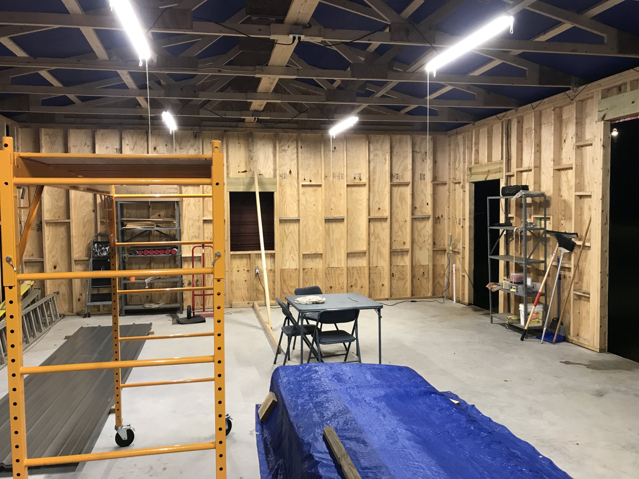

Decided to get a photo of the Taj MaTractor lit up at night. I'm affecting traffic on the nearby road. This thing is BRIGHT. IMG_2748[1].JPG

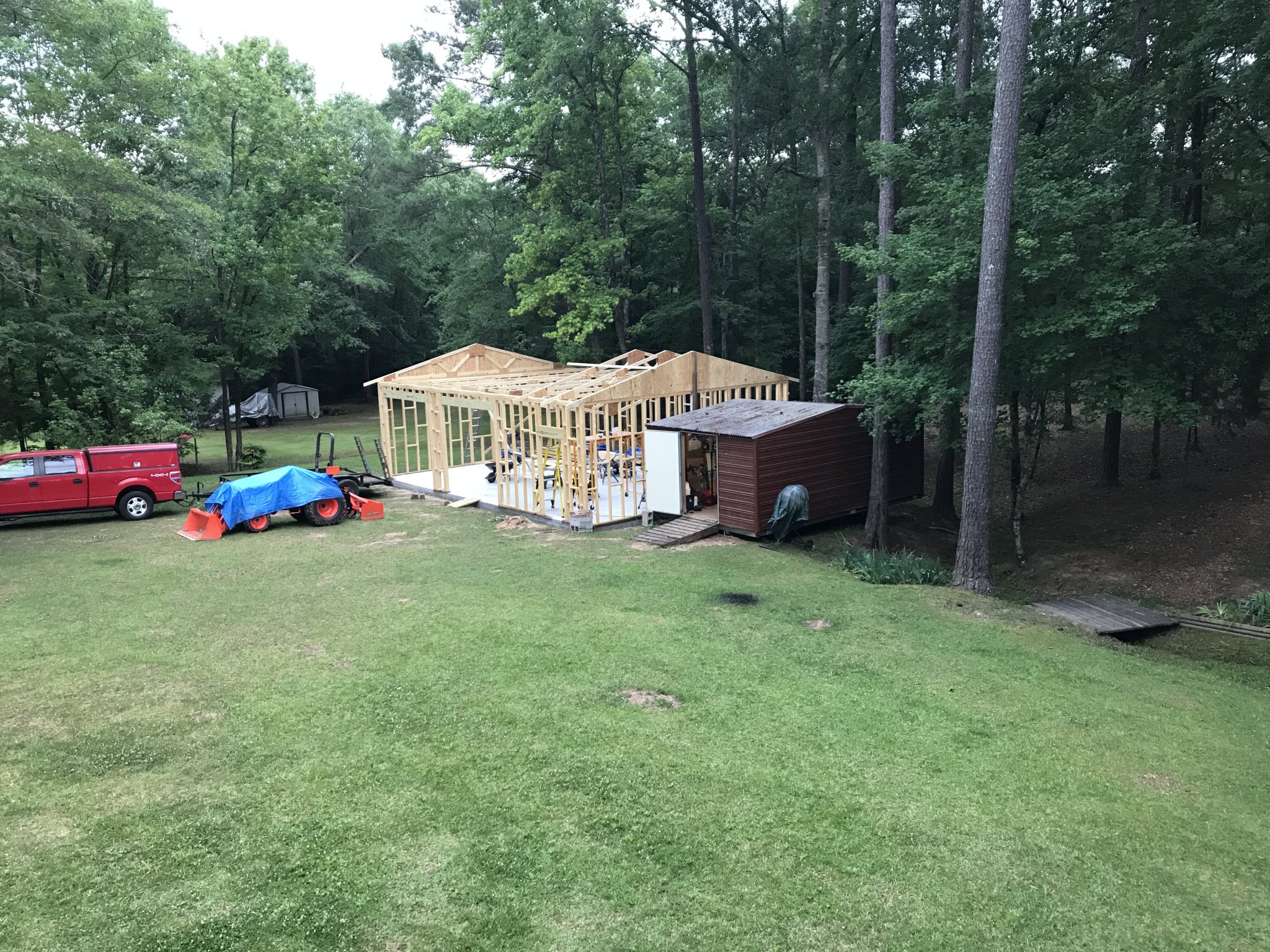

Another day with my bestest helper (my wife) and another wall covered with sheathing and felt. SIL decided to show up after lunch with half the sheathing up, but was still a big help getting the rest of the sheathing done and felt put up. The missus don’t climb. She does everything she can physically do for me, but climbing ain’t part of the package.
West end looking east. Front and east walls done. Decided to do the worst two walls first.
South side looking out the bay doors 38F598CF-1C00-4FF0-B95C-052DD0CB8608.jpeg
Standing in the yard looking in the front.
Will knock out the east wall tomorrow and move the distribution panel from the old shed to the new on and temp in the power from the old shed. Planning on having the inspector out next week for final.
