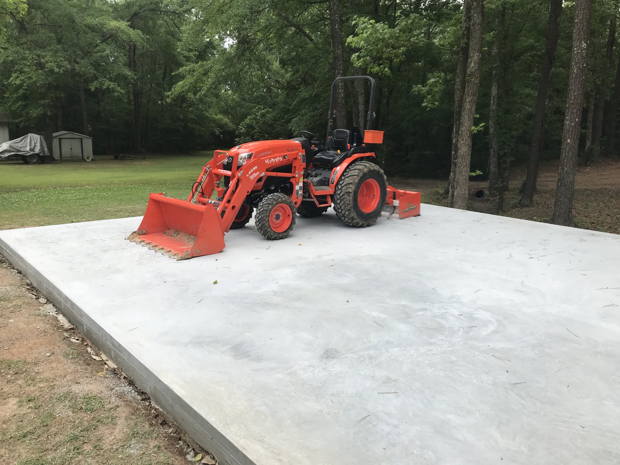

Well, the mud is poured, problem is, it really wants to stay in the mud state. We’re thinking the concrete supplier sent makeup loads with retardant in the mix to keep it from setting in the truck. Poor contractor has been here since 1030 this morning, and still hasn’t finished the glaze yet. Great guy, and will probably use him for any future concrete work, but I think he got screwed over by the supplier. Took just under 50 minutes for 2 loads, 9 yards and 6 yards, to screed and float. 10 hours later, still trying to get the finish complete. Either the mud was wrong, or I did a much better job on the moisture barrier than I thought I did. The missus made sandwiches for the guys and gave them snacks and water‘cause I know what they do for a living, and also what it’s like to be stuck on a job on Friday night. Everybody was expecting this to be done and over within a few hours. The mud just isn’t cooperating. Close, but not done. The supplier tried to say that my contractor hadn’t scheduled the loads, but somehow, they had the delivery address. Something tells me they were pissed about not getting a better price once they connected the dots between the delivery address and the quote they gave me at $160/ud. Duuuuuhhhhh. Pretty obvious we were duped by the supplier.

Yeah, the slab looks pretty good, but there is that hint of brown from too much sand, especially where they decided to finish by hand because the machine kept rolling the grout off the pour from the second truck. Very definitive difference in finish, but hey, it's a shop floor, not the Taj Mahal. Not like I'm going to be putting marble tile on it. I started to go with brushed finish, but the contractor recommended slick finish since it was an exposed floor that will certainly need some cleaning. Brooms last a lot longer and creepers and jacks roll better on slick floors. I'll just have to be aware of any wet spots or oily spots, and keep them cleaned up.
Now, pray for me. I'm about to venture into Lumber Land. Ouch.

The slab is finally finished. The contractor came back out this morning (how many contractors do you know that will come back on Sunday morning?) and put the trowelling machine back on the slab where they had to hand finish it. I was impressed that you could do that to a 'hardened' slab. I'm a lot more familiar with broomed finishes due to my experiences in swimming pool construction and the normal brushed finish on pool decks for slip resistant surfaces. Water on smooth concrete is slicker than greased monkey snot, and not a good combination around swimming pools. But without even casting any cement (which I would have gladly supplied) they just wet the surface and put the upside down helicopter on it and slicked it right up. I was very impressed. I let it sit the rest of the day while I brewed a batch of homebrew beer, then I pulled the forms. This thing is SOLID. I put a 12" deep footing all around the outside edge. I think you could drive an M1A1 up on this slab.
