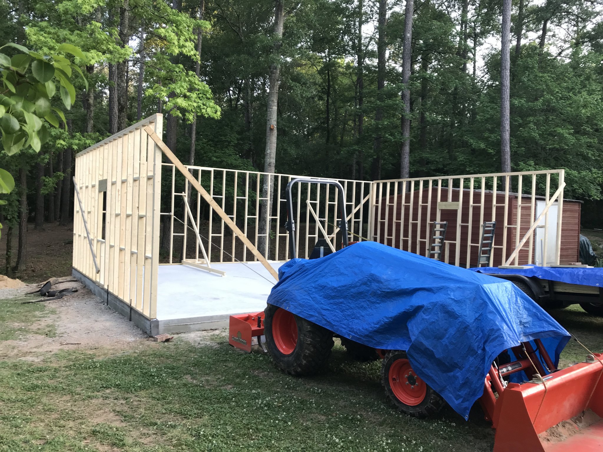

Got the lumber on Tuesday, and here's where me and the missus have taken it in less than 4 day's actual work. 3 wall framed with the exception of a few bits of blocking and the final top plate on the back wall. I'll get that tomorrow, as well as make the front corners and start working toward getting all the headers for the roll-up doors and the walk-in door. Most of the front wall is going to be headers. Geezopete!
Good progress, now that we can actually go outside without drowning.
We fabbed up the west (right) wall on Tuesday afternoon after we got home with the lumber. Finished it up including the opening for the window on Wednesday and built all of the back wall in 12 foot (two 11.5 and one 12 foot) sections. Stood all that up on Thursday and built the back half of the east wall on Thursday. Stood that up and built the front half, joined them and finished the framing for the east window today. Runnin out of sticks pretty quick, so maybe I'll get more of the lumber before the next increase. My luck, the bottom will fall out on the price after I drive the last nail in this thing.
The size of a 24x35 shed with 10' eaves starts to feel impressive when you get three of the walls stood up. 10 feet is a lot higher than I remember.

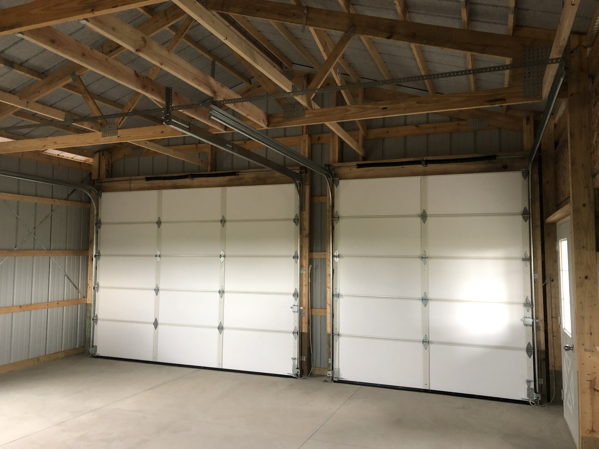

Looking good. If you have room, go with low headroom doors. I think you only need something like 6” clearance under your trusses. I was able to fit 9’ high doors on my 10’ high pole barn.

Looking good. If you have room, go with low headroom doors. I think you only need something like 6” clearance under your trusses. I was able to fit 9’ high doors on my 10’ high pole barn. View attachment 60277
Yeah, the 9's are what I want, but will probably go with roll-ups instead of panel style. Just don't like the tracks in the overhead, and any light above them will be blocked by the door when it's open. Another difference is your header doesn't have to be as thick as mine. The gable wall really isn't carrying much load. I have to have 2x12 headers for the big doors because of the length of the opening and that they're on a side wall (load bearing). Gonna be some pretty massive headers to put up. I think I can clear 8' with the ROPS, but I don't want it a micron shorter. Putting anything shorter in defeats the purpose of having a shed to get the tractor in if I have to constantly flip the ROPS up and down. It's there for a reason, and I prefer it serve that purpose without me having to remember to put it back up or destroying my building because I forgot to put it back down. Everything about this shed is to mitigate some of the security and safety issues of having a tractor.
BTW, is the bottom of your trusses at 10' or are they below the top of the posts? Can't really tell looking at this. I do like your barn, though. Very neat looking.
Did you build your trusses or have them built?
The bottom of the trusses are 9’ 10” from the floor. It’s a Morton building. All I did was install the doors and tracks.
The bottom of the trusses are 9’ 10” from the floor. It’s a Morton building. All I did was install the doors and tracks. They are 8’x9’ and 12’x9’.

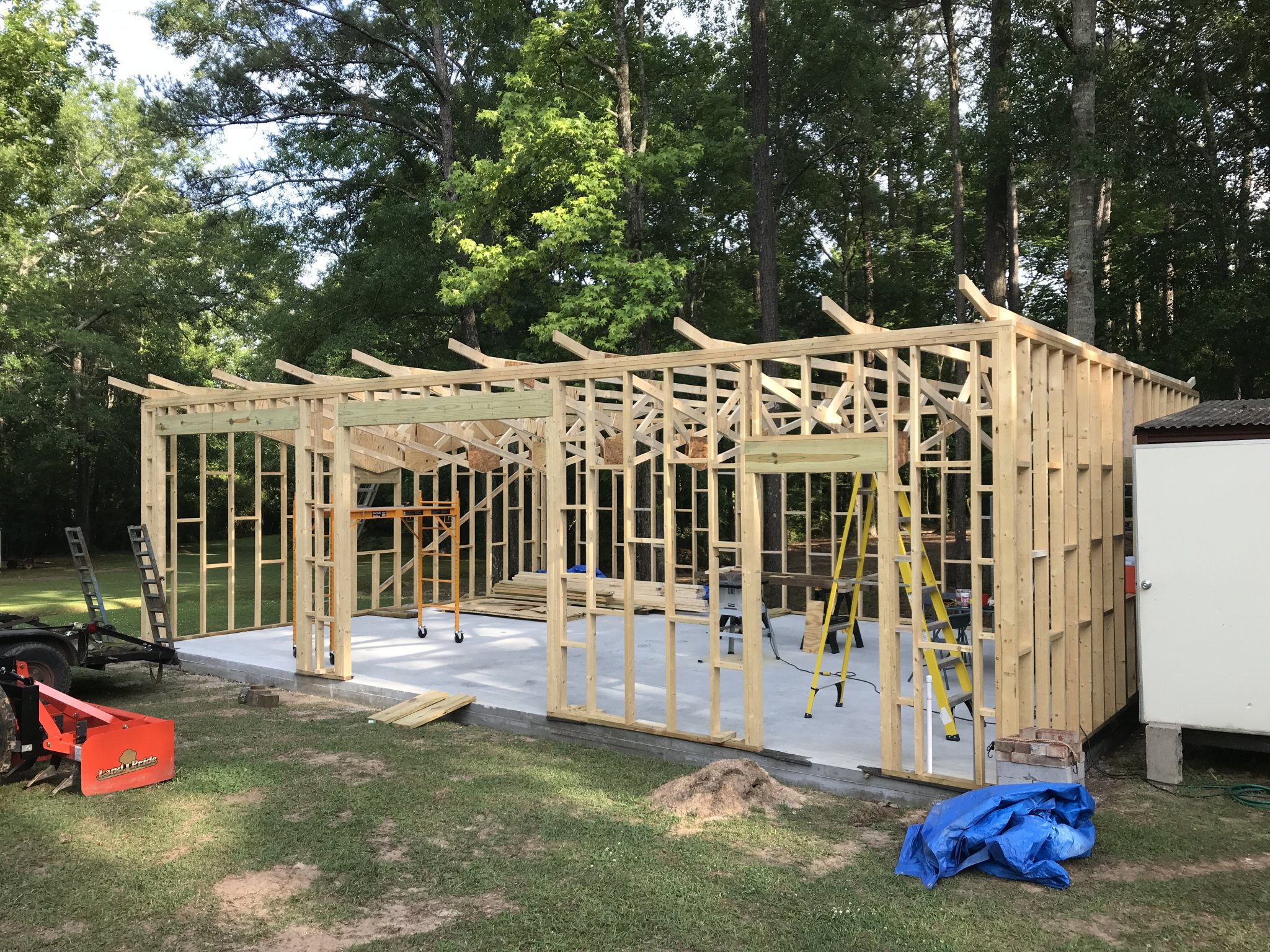

Wall framing: DONE!!!
Put in the door headers for the roll-ups today. Finished off the front wall had some measuring tape adventures that reminded me why I normally buy quality tools. Fortunately for me, it wound up being that all the cuts were too long rather than too short. There was one board, though, I cut it off three times, and it was STILL too short! Pretty sure this tape measure would classify as a board stretcher.
Picked up the materials yesterday that I needed to finish off the front wall (shorted myself intentionally, I think) as well as what I think I need to build trusses. Got back and started cutting king studs and jack studs and doing the lay-out with all the puzzle pieces laying on the slab. If this thing doesn't pass inspection, it'll be because I used too much lumber. Again, I overbuild. No way could I be a home builder. I'd lose my shirt on every job. Ennyhoo, a picture (or a few) is worth a thousand words.
Since half the front wall was openings for two 9' wide doors, I decided to use a triple thick plate to add to the strength of the headers. I overlapped all the 2x4's in the beam so that it acts as a solid beam and none of the joints of the 2x4's are aligned. I also laced the two front corners at the top to prevent separation. Lil' O did a bit of a photo bomb in this photo. I lifted the headers as close as possible with the LX2610 and LA535. Figured out real quick that the lift height of the 535 will just barely clear the height of the ROPS. I originally set the jack studs ate 8'10", but since I'm not a fan of garage doors in a shop, I dropped down to 8' 6" which left me with 18" overhead clearance, which is enough for the particular doors I'm looking at. As it were, I'll wind up with a 108"W x 102"H rough opening. That gives me just over a foot of clearance for the ROPS if I use a roll up door. The next three photos show the real deal......
Used double kings on every door, and double jacks on both roll up doors. Can't see this not passing inspection other than for having too much lumber in it.

Truss members cut (except for the 8 12' 2x4's I shorted myself). Gonna take a day tomorrow and bottle some home-brew beer, and maybe start assembling trusses tomorrow. Gonna need some screws, though. Still gotta cut all the gusset pieces. Used up some old scrap OSB I bought YEARS ago for the patterns, and have plenty 3/8" plywood to finish them off (after I go get more 2x4's) Gonna grab another forty 12 footers. Forgot that I needed 8 more for that triple thick plate on the front wall, so wound up 8 short for the trusses. DOH! Getting close to being done with the skeleton of this thing. Can't see it taking more than a day to stand up all the trusses once I get 'em up on the top sill plates, but that all depends on how straight the walls are and whatever else can go wrong. Found I had one of the short sections of wall that moved while I was drilling the anchor screws in. Just a PITA, but I can fix it pretty quick.
Gotta get it in gear and get doors and roofing ordered. Still holding out to see what happens with OSB prices. I'd much rather not have to skin this thing twice, but really want vinyl siding on it to match the house. I just can't force myself to bite the bullet on the sheathing. For crying out loud, OSB is nothing but the waste from making plywood. How can plywood be available and OSB NOT?
I sawed up a lotta lumber today. Made lots of man glitter. Only had about half a wheel-barrow of waste, though. I doubt I've hit more than 1% or 2% waste on the lumber, and did that with the first 2x10 that I cut wrong. None of the waste is over 3 inches long because a lot of the blocking I did was 4 inches, and I used most of the cut-offs to make that. The cripple studs above the rollup door headers are only 4 inches long, too, so they gobbled up a lot of the cut-off too. Rarely did I have anything more than an inch long or on a weird angle from cutting the W braces for the trusses today. My grandfather taught me well, I guess.
