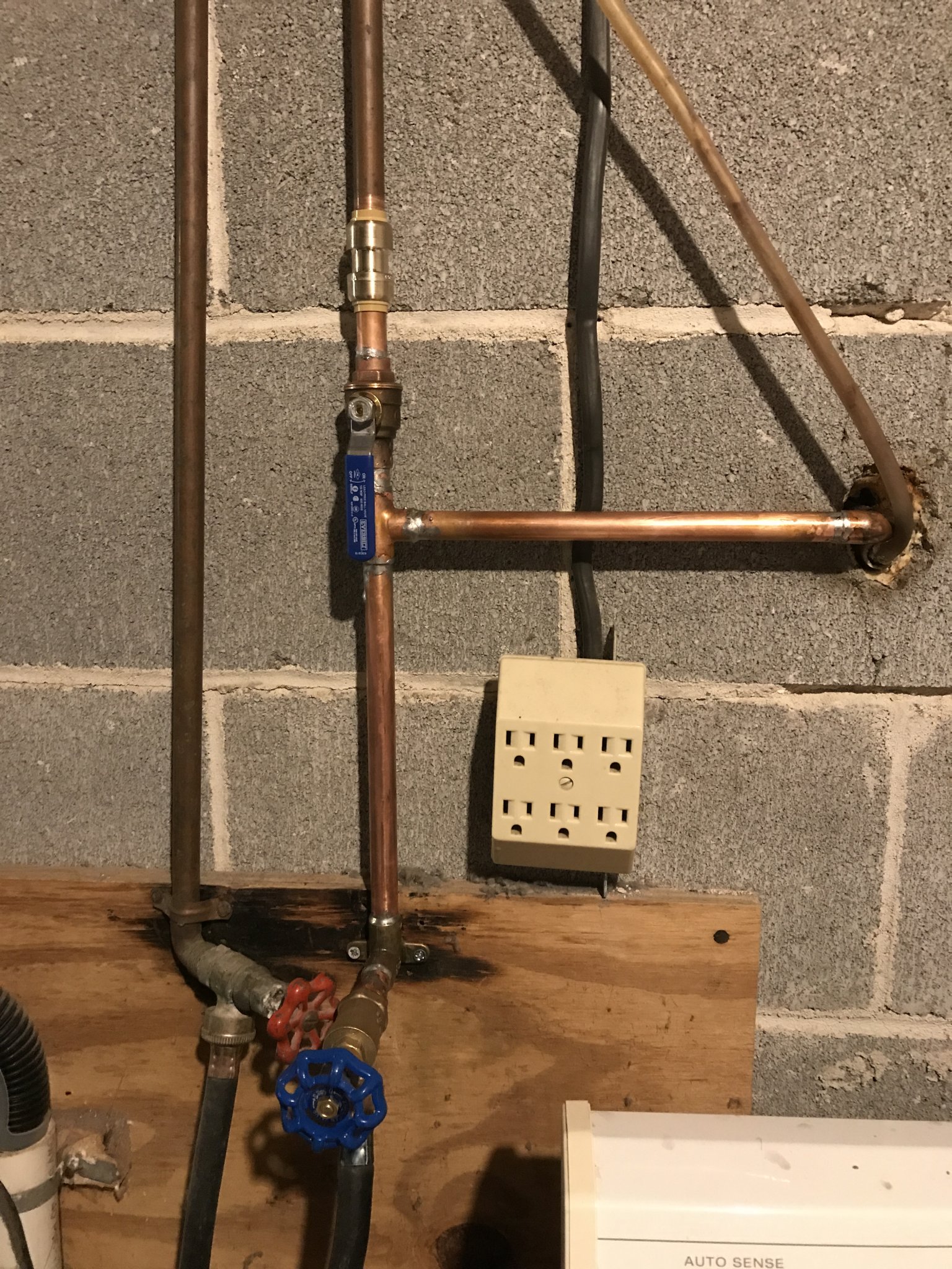

Easier way to couple up a repair these days is what I did. Doesn't matter if the water's dripping a little if the right fittings are selected. I used one Shark Bite coupling. I assembled everything before I turned the water off, and as it turns out, the part I had to work on was the lowest spot in all the plumbing. Again, the only luck I have is bad. But, I closed the high pressure supply valve, opened up the high pressure tap (before the pressure regulator) on the front of the house, valved off cold supply to the hot water heater to keep it from siphoning, opened the kitchen, and both bathroom sink faucets, and bingo, it was drained pretty quick. For good measure, I flipped off the breaker for the HWH while I was at it, just to make sure I didn't blow an element. I was more concerned about how much water was gonna pour out than having to sweat the old pipe. I'd already made my mind up to use the Shark Bite fitting for a quick connection. I made up everything except one sweat joint on the elbow to turn through the wall for the outside sill cock. I plugged in the 'header' I made up and shut the ball valve off to isolate everything downstream, sweat the elbow, and bingo, job done, water off less than 30 minutes.
You can see the Shark Bite coupling I replaced everything below that, including the sill cock on the outside wall. I'm going to go ahead and put another isolation valve and replace the hot water valve for the washer, too. That's another side project.
Probably saved myself $1000 by not calling a plumber. He'd have to make two trips since it was one valve outside, and one inside. Took a lot longer to get the materials than it did to do the work. I learned how to fit copper pipe in high school. Freaked out the swimming pool company I worked for in college that I could do something they'd been paying plumbers to do for them. They didn't pay the plumber any more. Any pool that got a new heater had my name on it for the heater installation because that needed gas an also needed copper for the heated water. I ran black pipe, copper, pvc, poly, you name it. Wasn't any part of a swimming pool that I had a problem with.

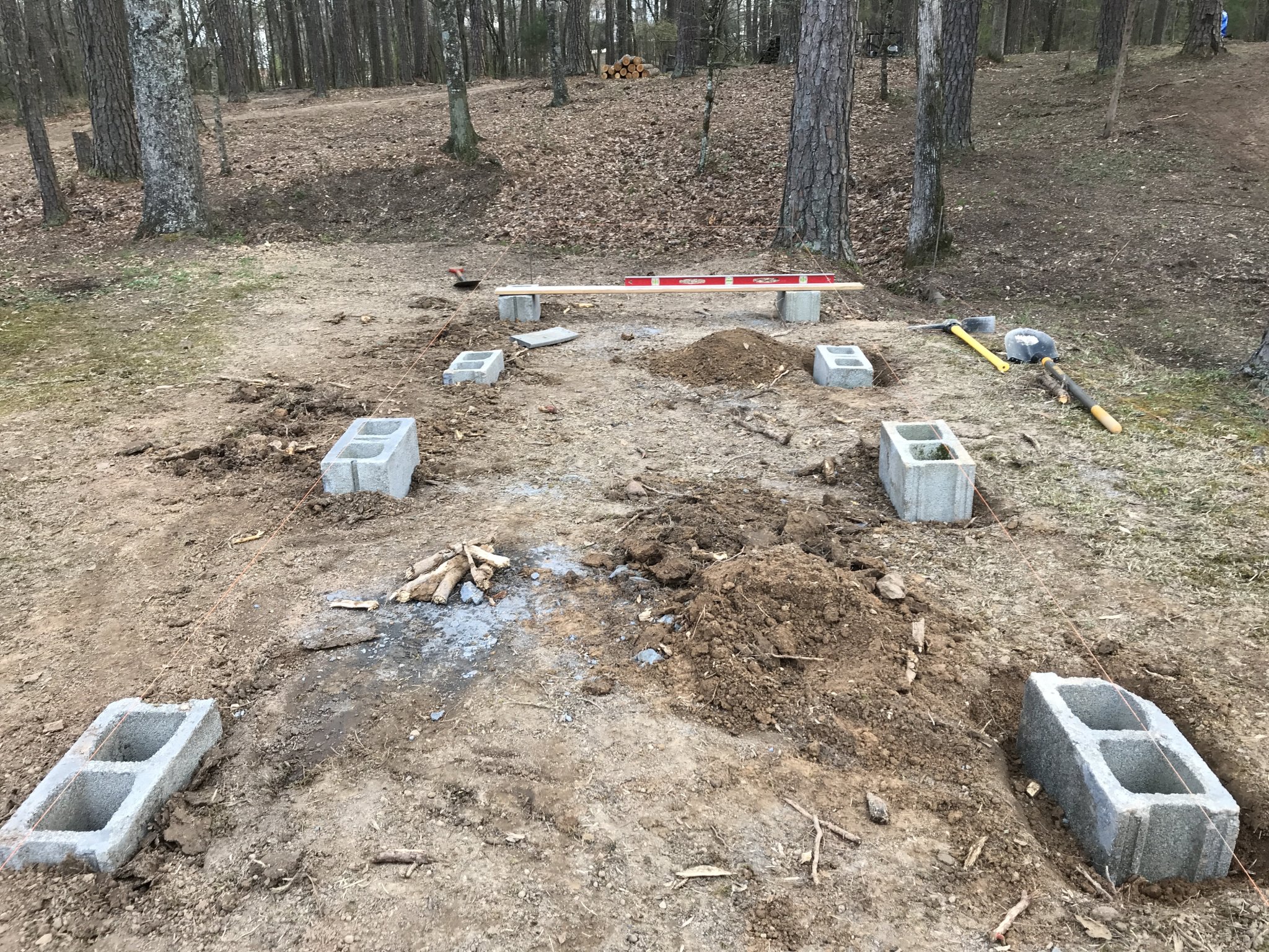

Managed to get a full day on the upgrade. Laid out and leveled the support blocks for the red shed relocation. The back two still need a little attention, but they’re close. The blocks are leftovers from my front porch overhaul project a few years ago.

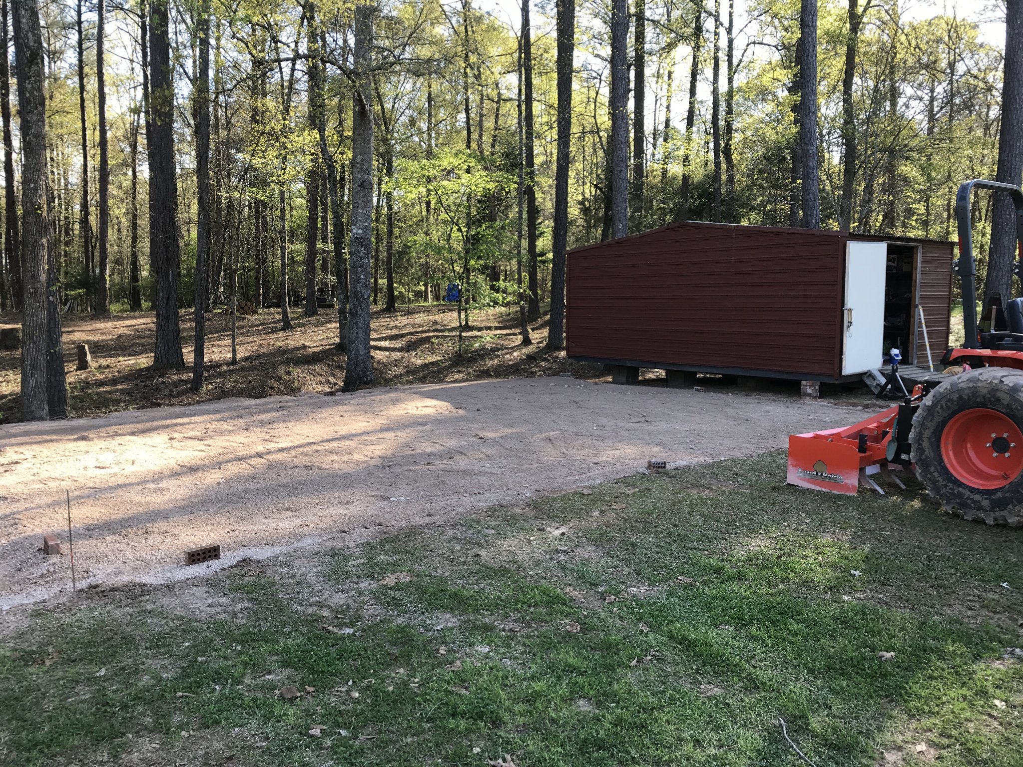

A bit more noticeable progress today, FINALLY. Been so soggy, not much way to do anything. But, called a gravel supplier today, and got the first 20 tons of rock waste (crusher run) delivered, and spread it in about 30 minutes. Found out a big dumper with 20 tons can actually cross my yard and not hurt anything. If it gets a little dryer, ANYTHING can cross it and not hurt it.
