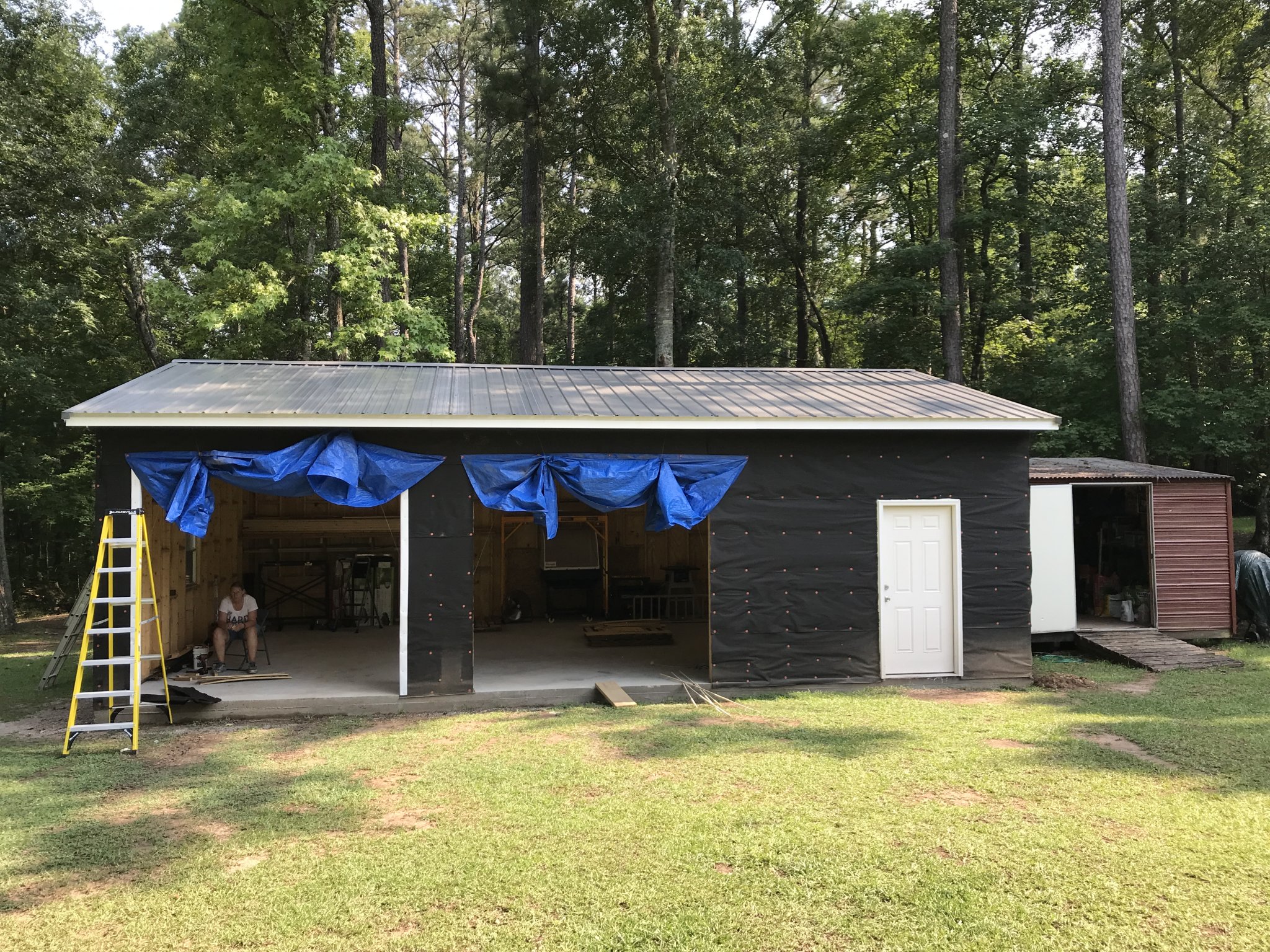

Got the west end faux rafters installed today, the trim boards on the west end, and about 2/3 across the front eave. Also put the drip edge on as much as I could cover with 10 foot sections across the front eave as well. This time I actually got a photo. 23EB3E76-29E5-49B2-B34D-171624ACB446.jpeg
Old_Paint
Dec 5, 2020
2,056
2,356
AL
Trim boards all up, drip edge done. Should lay some sheet on it tomorrow after verifying all my purlin spacing measurements and setting for 2" overhang of the sheet. Not real excited about getting on the new sheet metal to put the cap on, but not much choice in the matter. I'd welcome any advice anyone has about closing up the cap and rakes.
Old_Paint
Dec 5, 2020
2,056
2,356
AL
The son-in-law came over today and we put 24 sheets of steel up. 576 screws, two trips across the roof for 12 of the 24 panels (had to push the panels for the back roof over the front roof). All done except the rakes and ridge cap. I'll be glad when all the climbing is done. My back is so over all this nonsense. Too late finishing up tonite, so no photo. Will get one in the morning. Taking a day to let my step-daughter fix me a birthday lunch and rest up after a rather grueling day today. I'm just glad this global warming/climate change thing is giving us the mildest June I can ever remember. Could use a little more of this kind of change.

Roof: DONE. Ridge cap on, rakes on. Nothing else to do on top. All the work will start gettingcloser to the ground.
