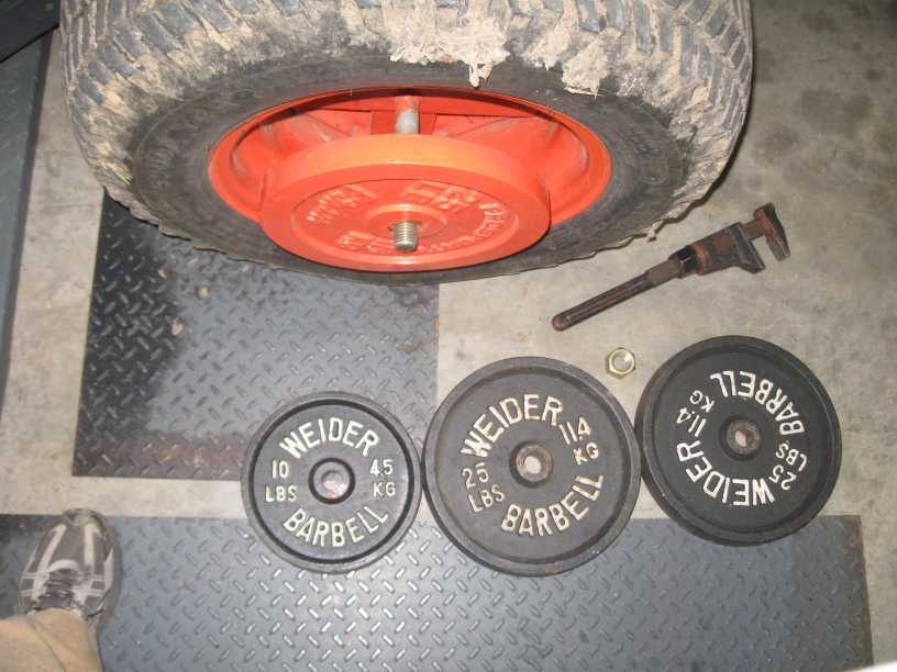

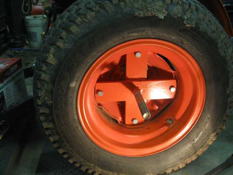

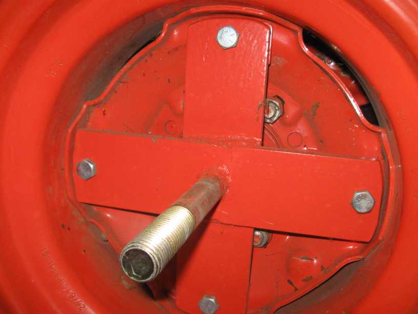

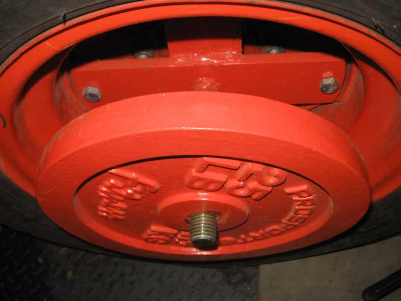

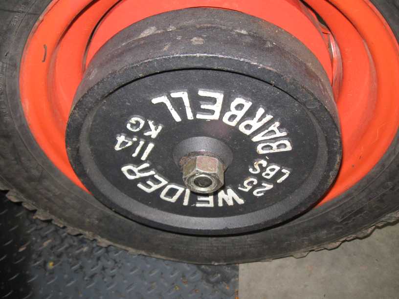

These may be able to be put on front wheels and use free weights.
http://lugghandles.com/
I made my own for the rear and would do the same for the front if I needed them, very easy to make. I got the weights at the scrap yard for 22 cents a pound. I did 100 lbs per rear wheel.
