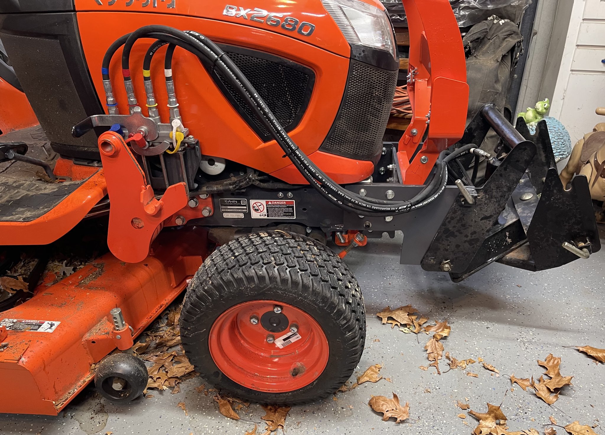

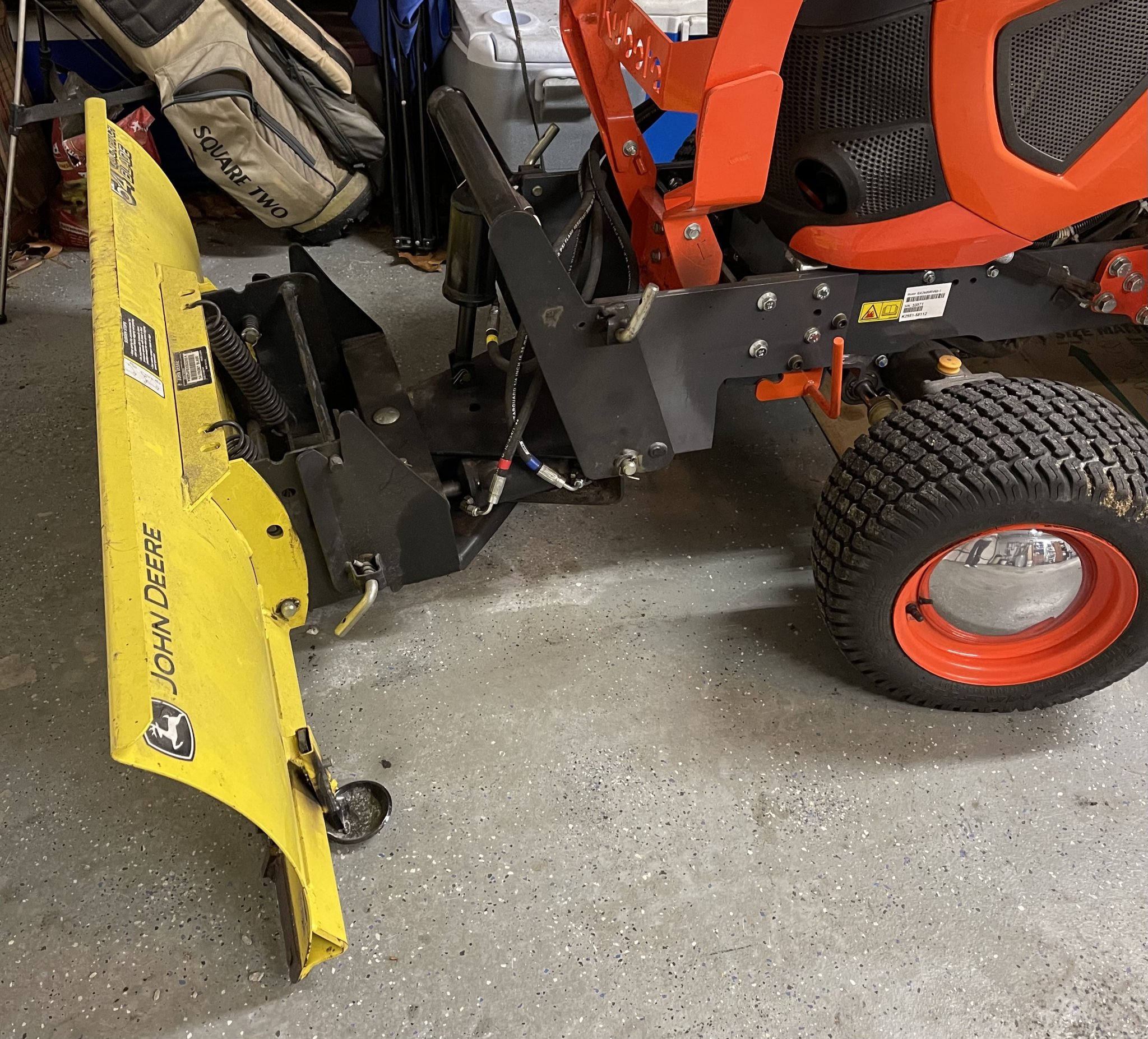

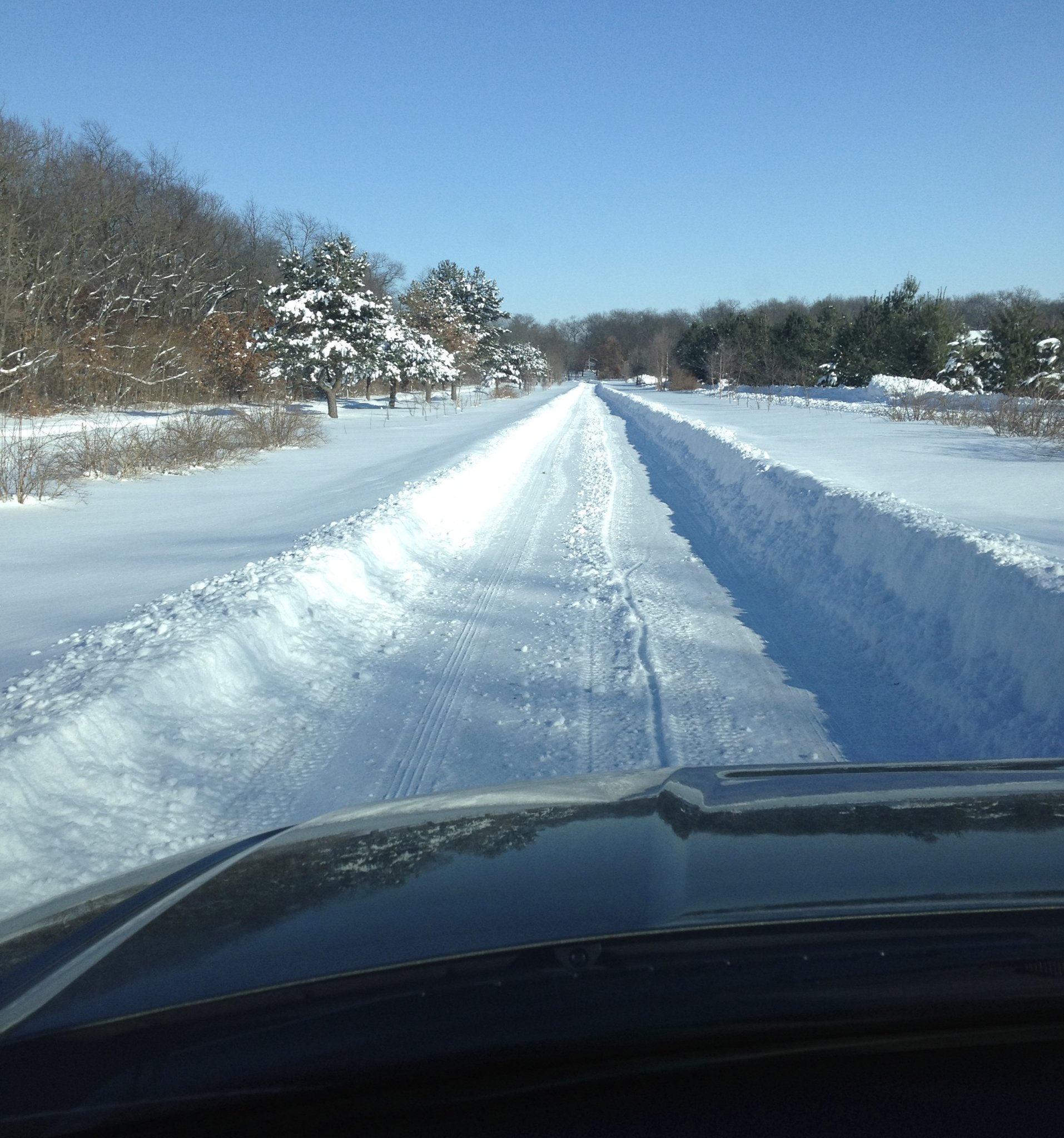

JD plow mounted on a BX 2680. By this time plowing became not fun!. The snow pic was when the plow was on my now gone Simplicity. Haven’t had any heavy snow seasons since we got the Kubota. A snowblower would be nice but having a blade already can’t see dropping the $$.

I'm trying to assess if my LX2610 has enough power and traction to plow snow off a 1/4 mile gravel drive in southwest Michigan. Been here a while but this is my first tractor.
The 54” JD blade in my previous post was originally on a 2wd JD 425 with rear ag tires, no ballast. It plowed everything I got in NW IN on the edge of the lake effect snow zone. 1200’ gravel driveway.
